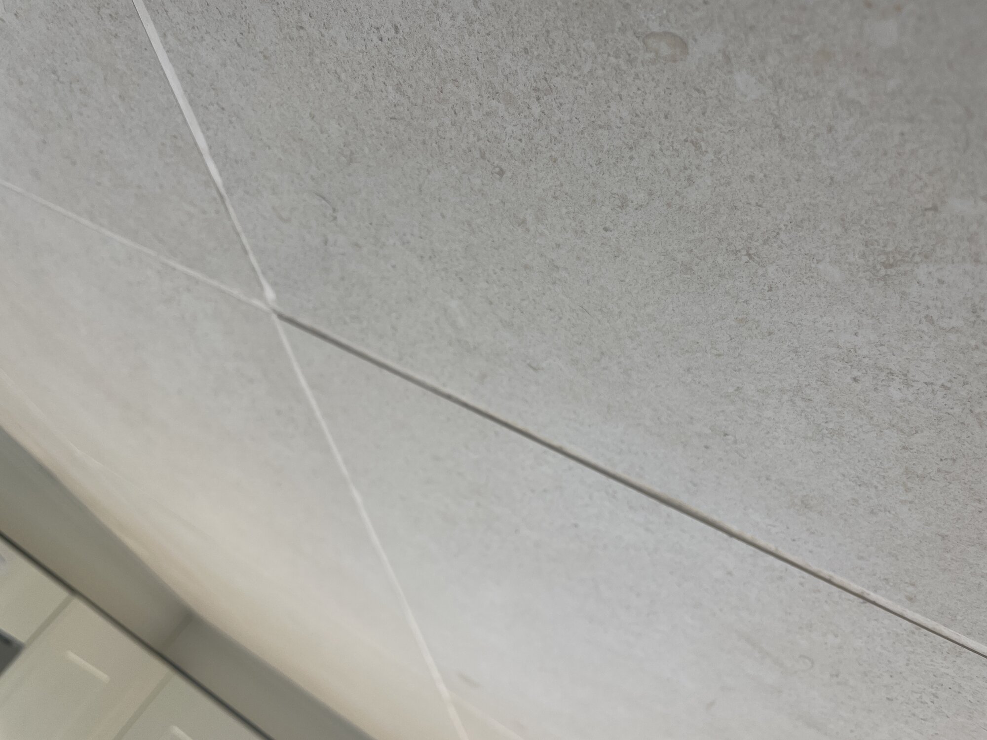

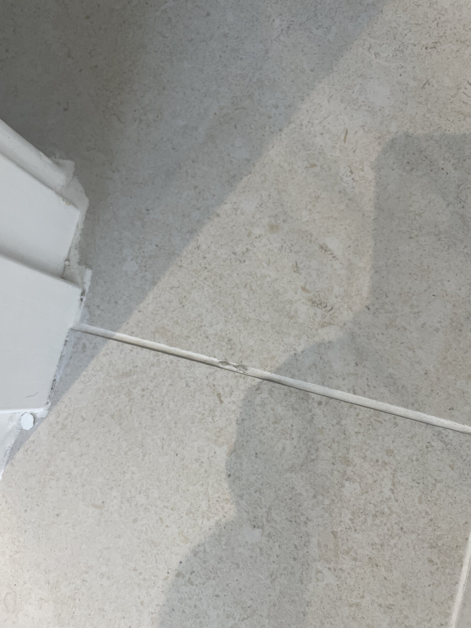

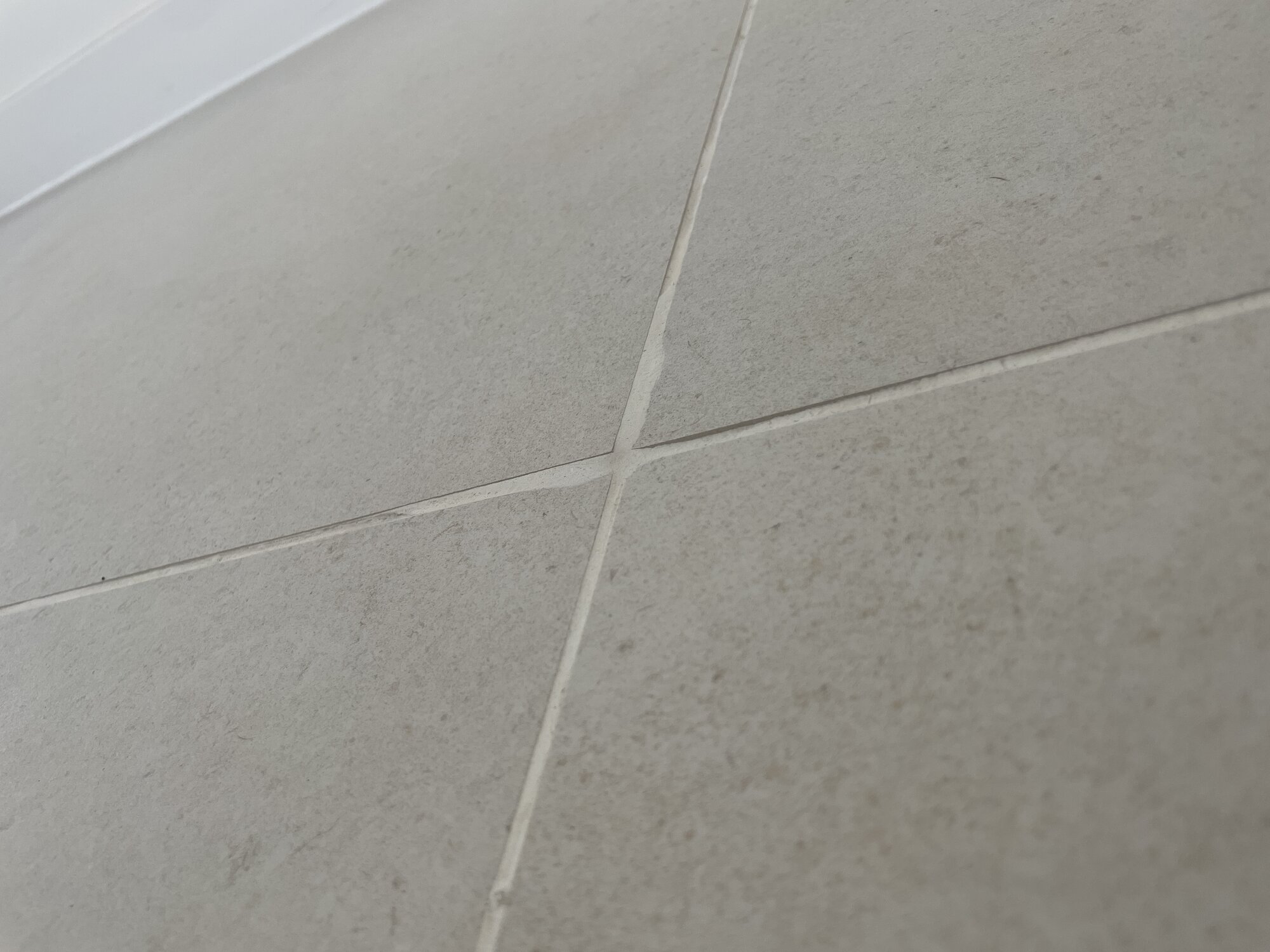

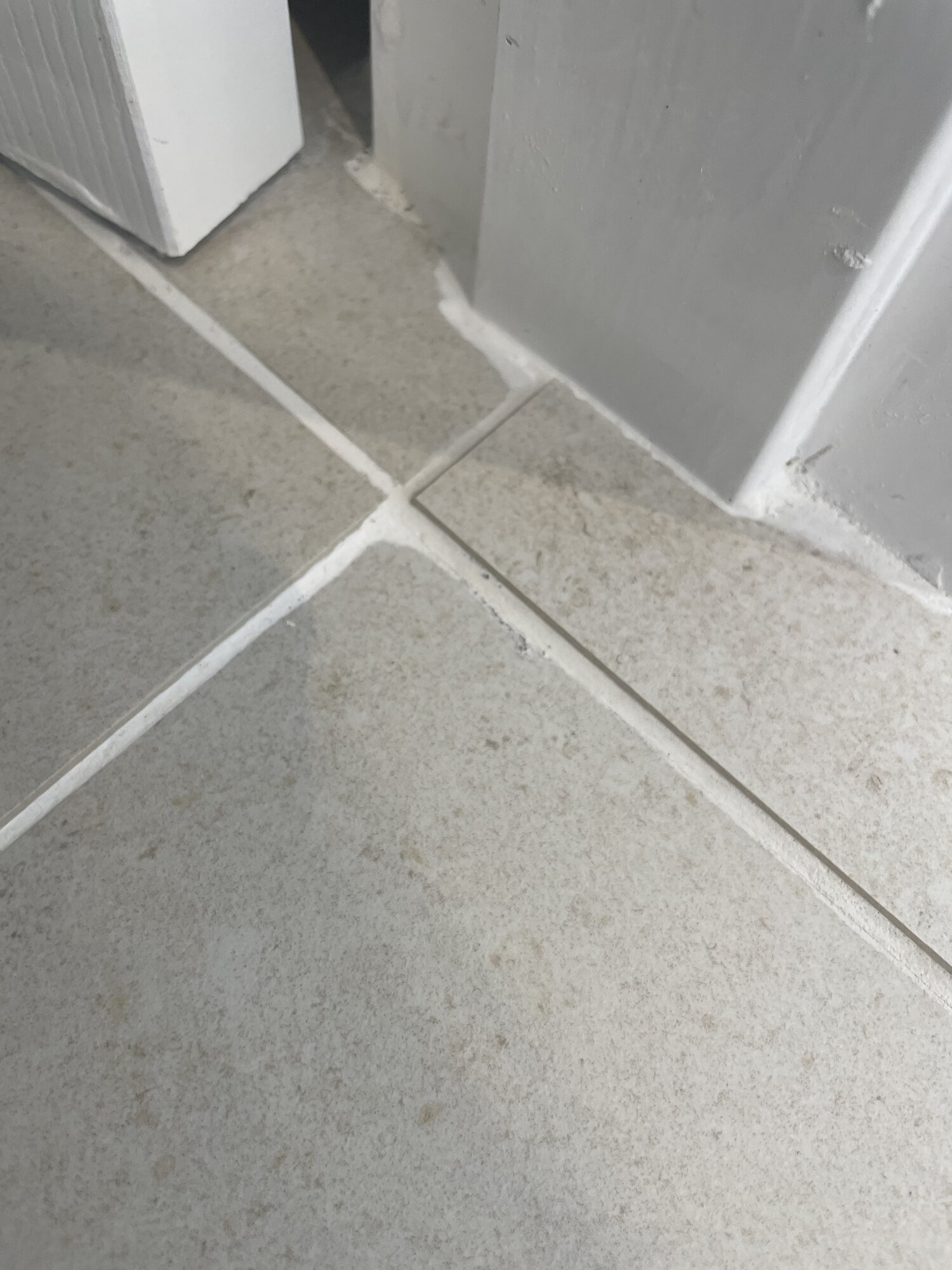

Hey so I have recently bought a new build house and wanted my floors tiled, I bought the tiles myself from Mandarin Stone and hired a tiler to lay them for me. The floors were in good condition and most importantly level prior to him starting. After 4 days he was done however the tiles were not level and the grout was not level either so between some tiles it was spilling out and between some it was extremely low. I had 5 tiles left over so I asked him to come back fix them. He used all 5 remaining tiles and re grouted them however the tiles are not level nor is the grout. He quoted me £1200 before stating the job and I paid him £900 purely because of how badly it was done (he had also reversed into our garage and damaged the wall without telling us) now that the tiles have been properly cleaned etc they look even worse and I’m not happy that I paid him the £900 because the whole floor will need to be redone. What can I do?
this is my first property so I was clueless about who to go with however multiple businesses quoted me £1200 therefore I assumed the price was okay.

Those photos were taken after he back to fix it…I’m not the type to critique someone’s work especially if I can’t do it myself but I can’t believe that we have spent £800 on tiles and then paid the tiler to absolutely mess them up

Your grout has already started to crack and lift in places which means tiles are loose. Try tapping them and seeing if they are hollow. I feel for you and you should have not had to pay for that as he’s actually cost you even more in the long run. This guy isn’t a professional and not even a good person to take your money. I would seek repayment and I would feel a responsibility to warn others. This is the dark side of this unregulated Wild West trade I’m afraid.

Definitely a bad job, no excuse for lips that bad using levelling clips or not . As for the grout cracking shows there are definitely some badly fixed tiles .

Sorry to see this , grout joint was broken and wasnt finished properply. The tiles are not flush.
