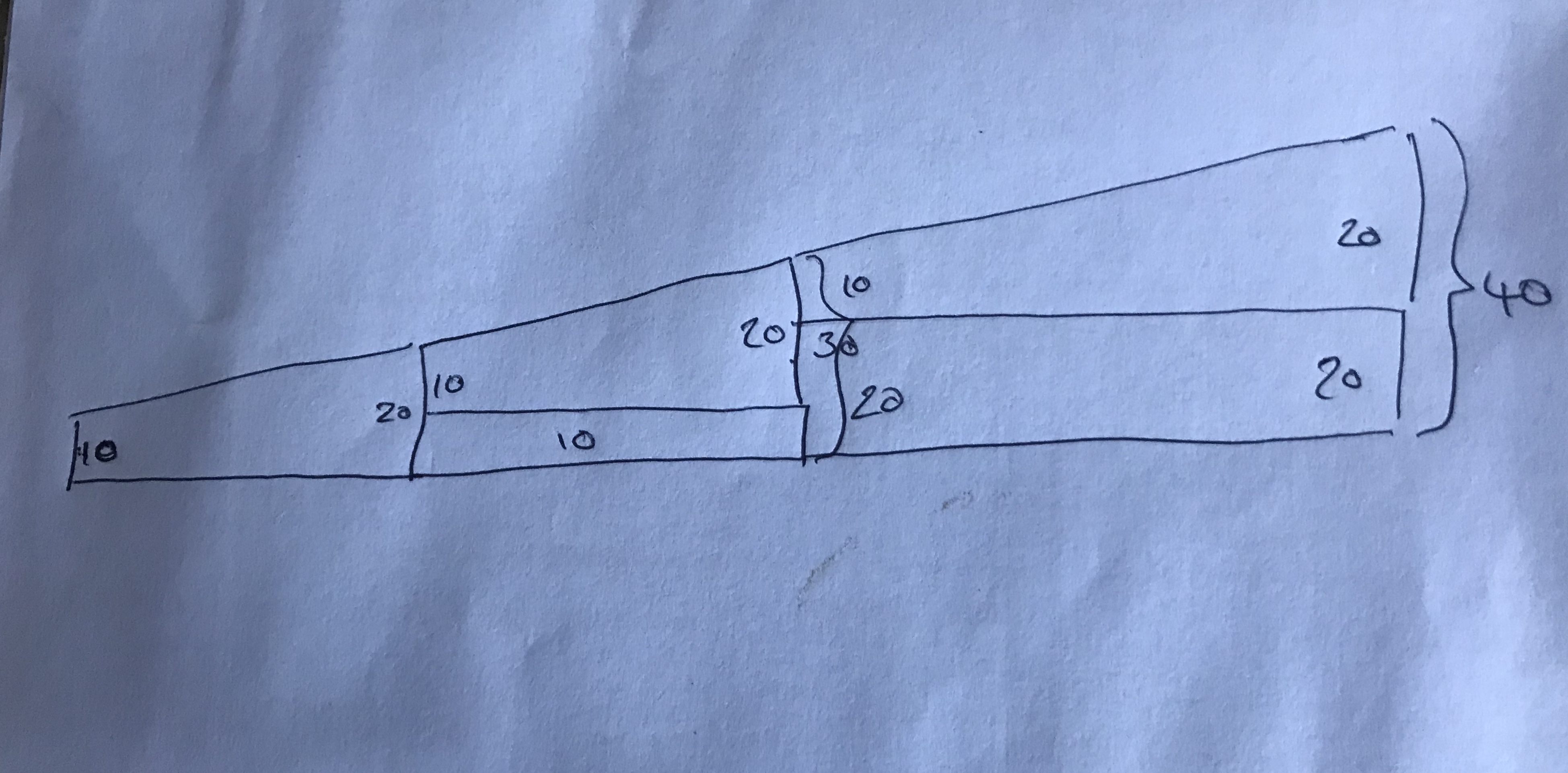

So the cogs have been whirring....as much as I would like to use the wedge boards, they are cost prohibitive. So would staggering the boards down in 2mm increments work instead?
