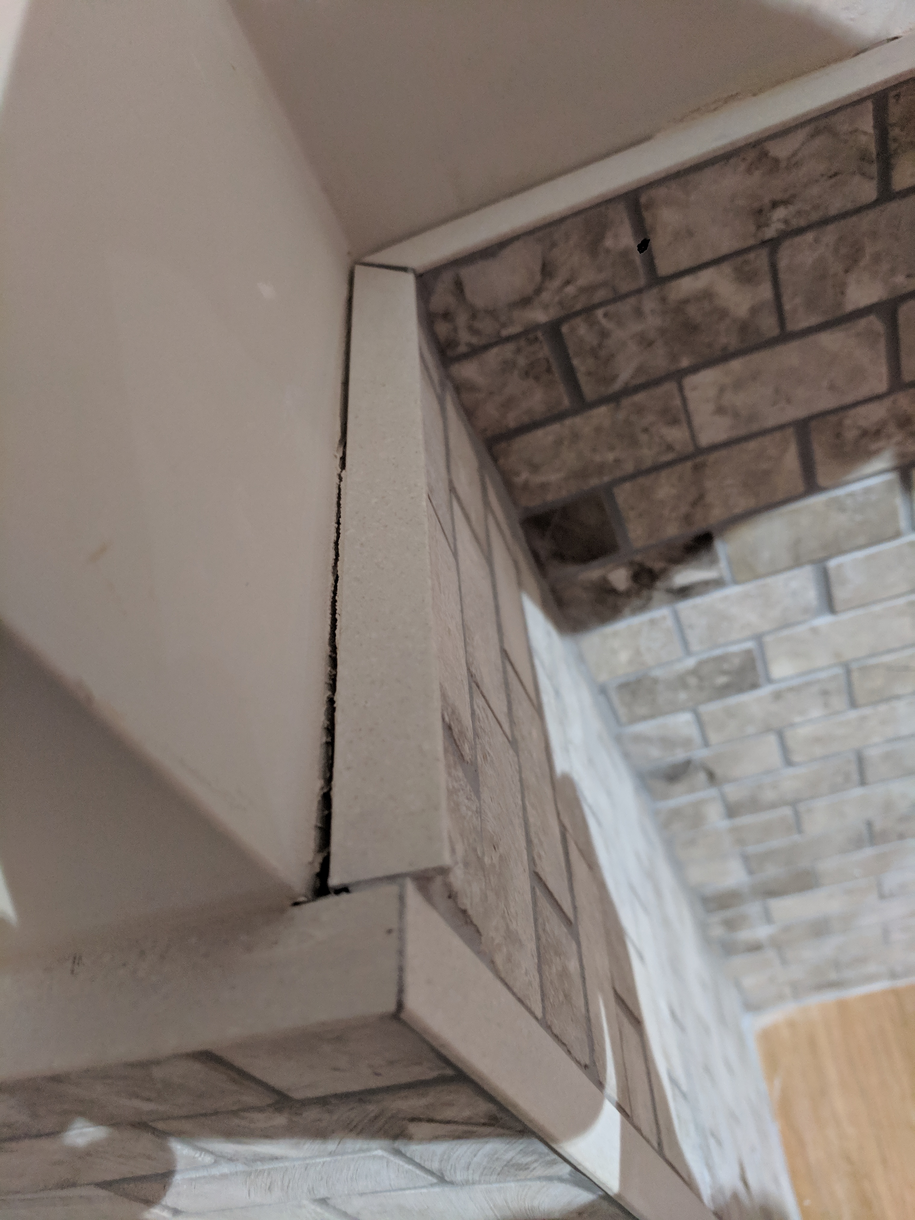

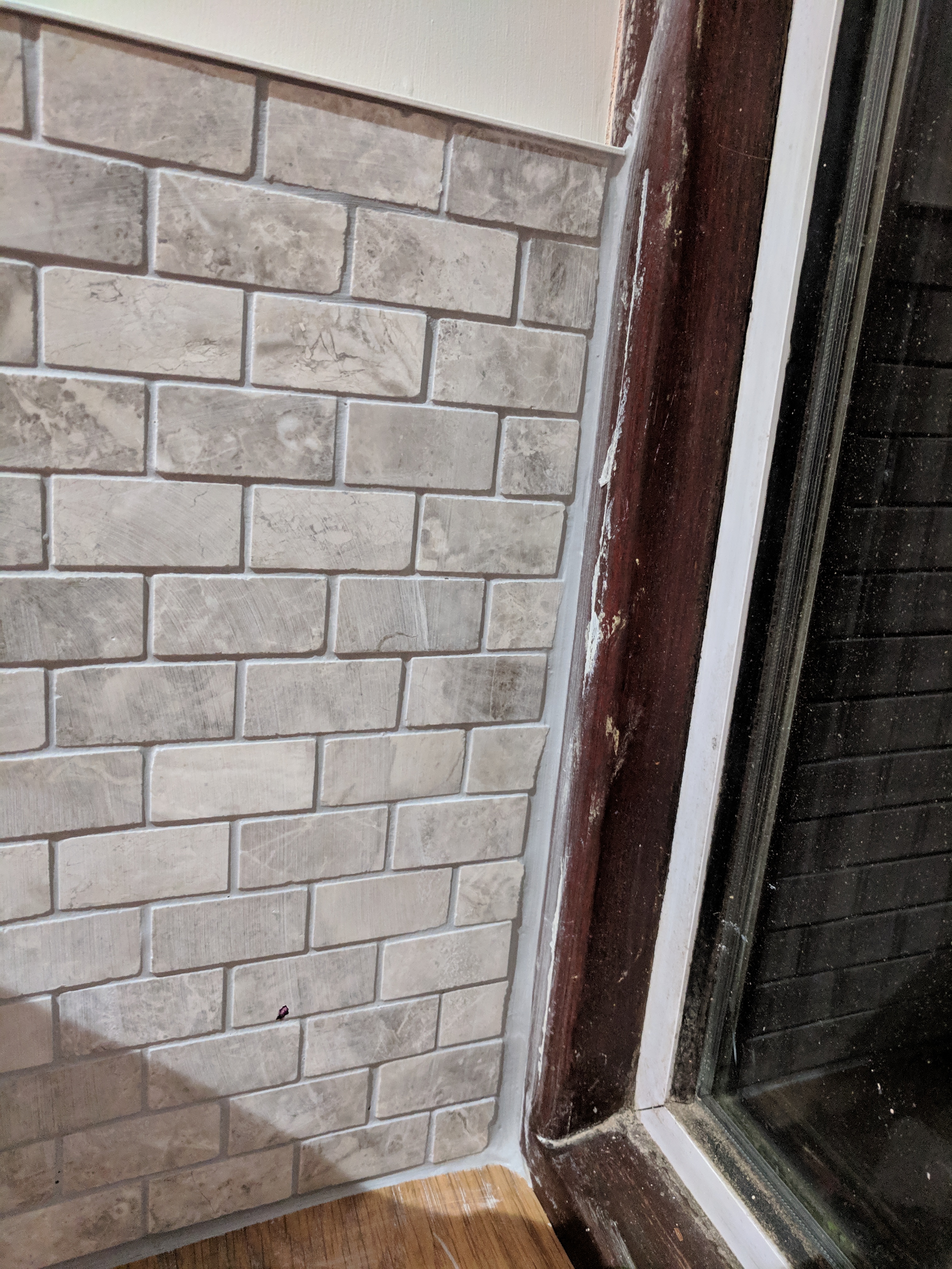

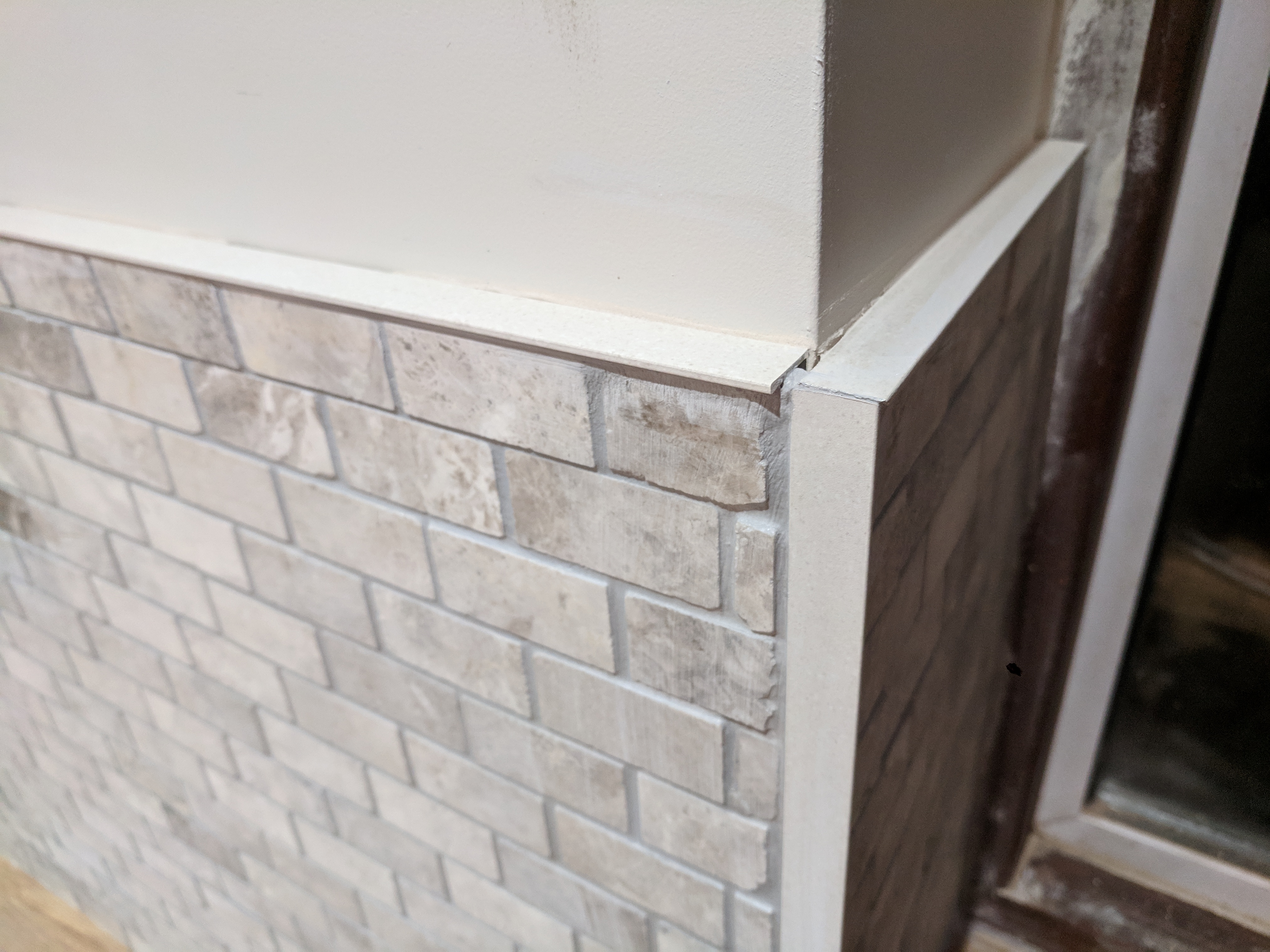

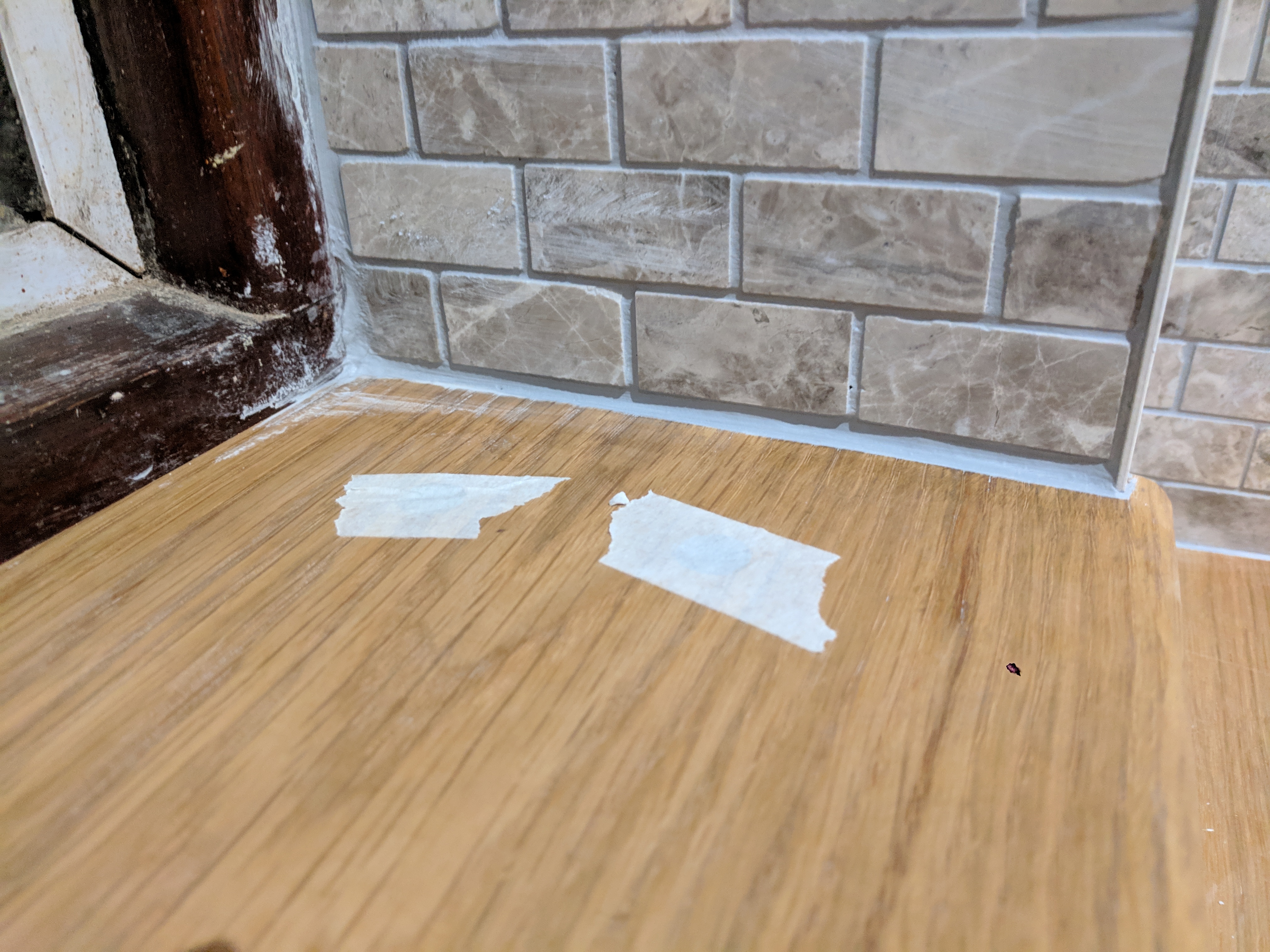

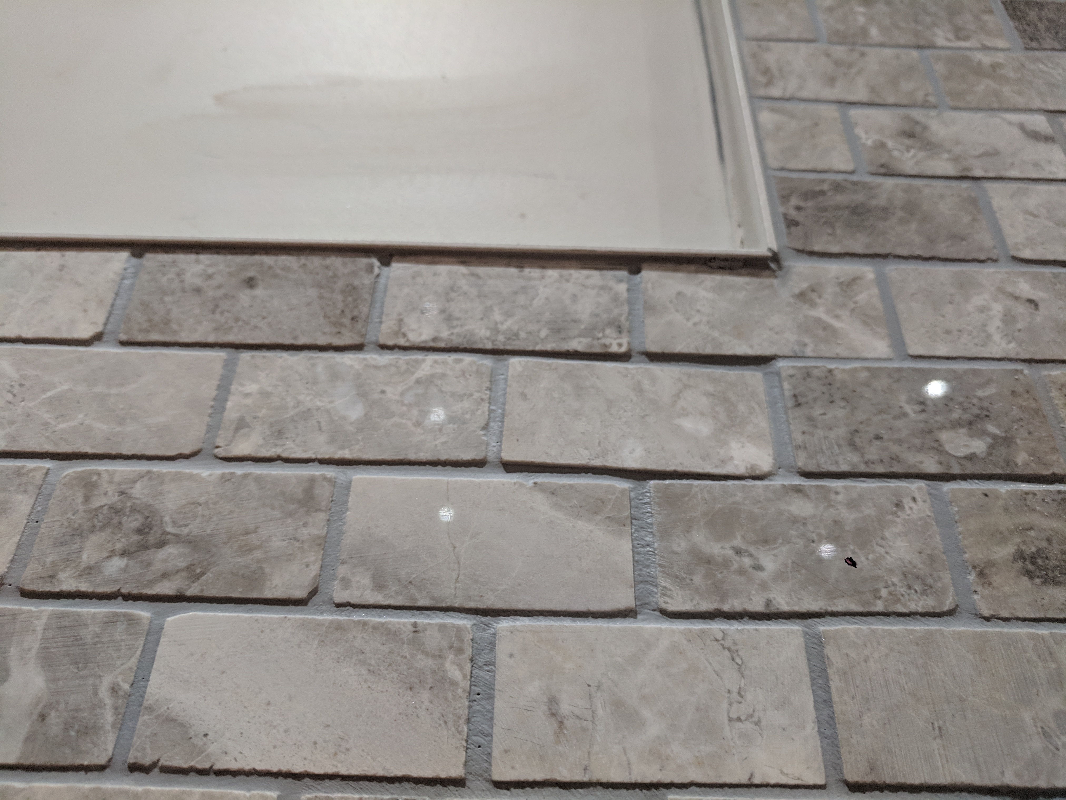

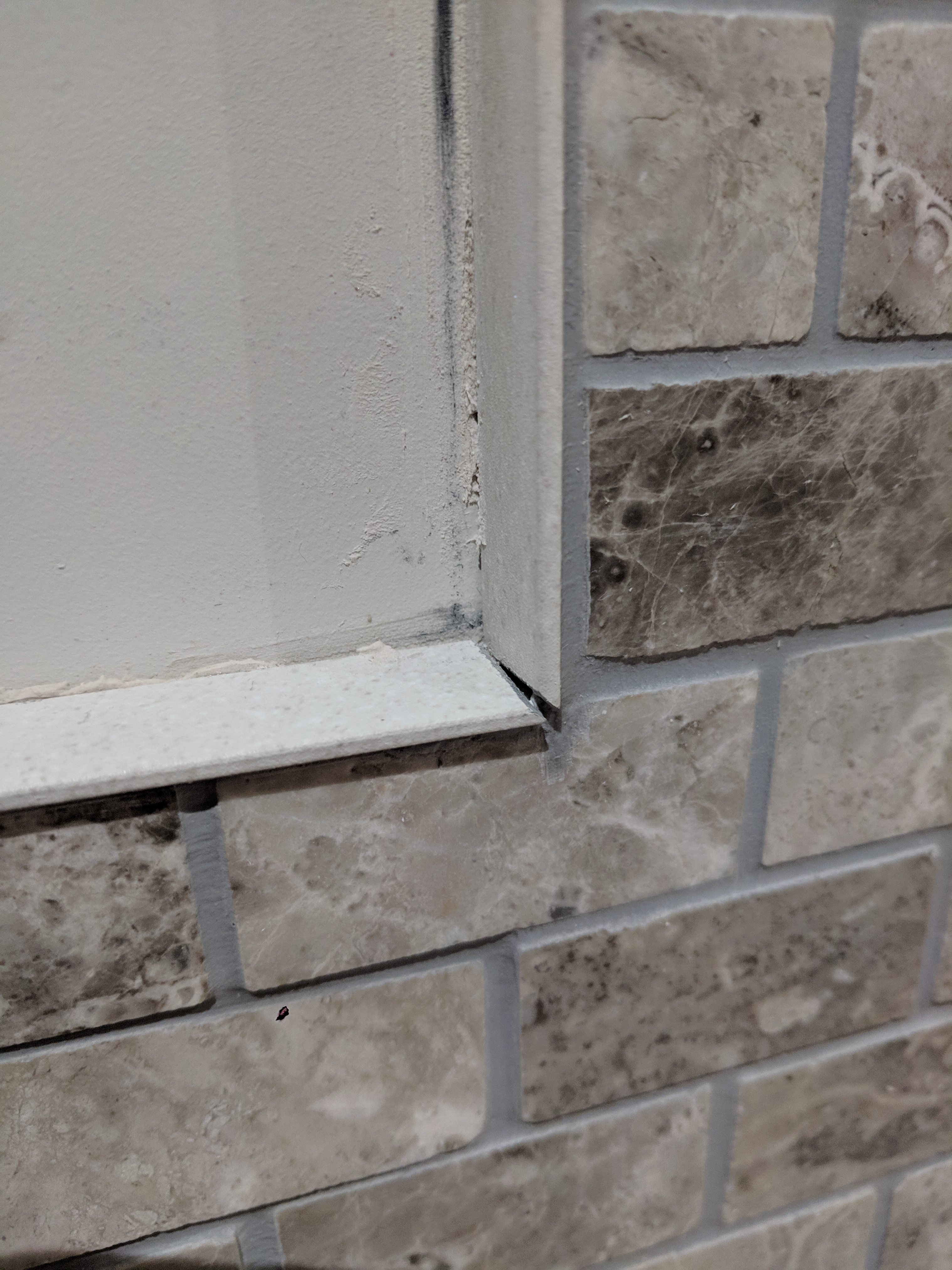

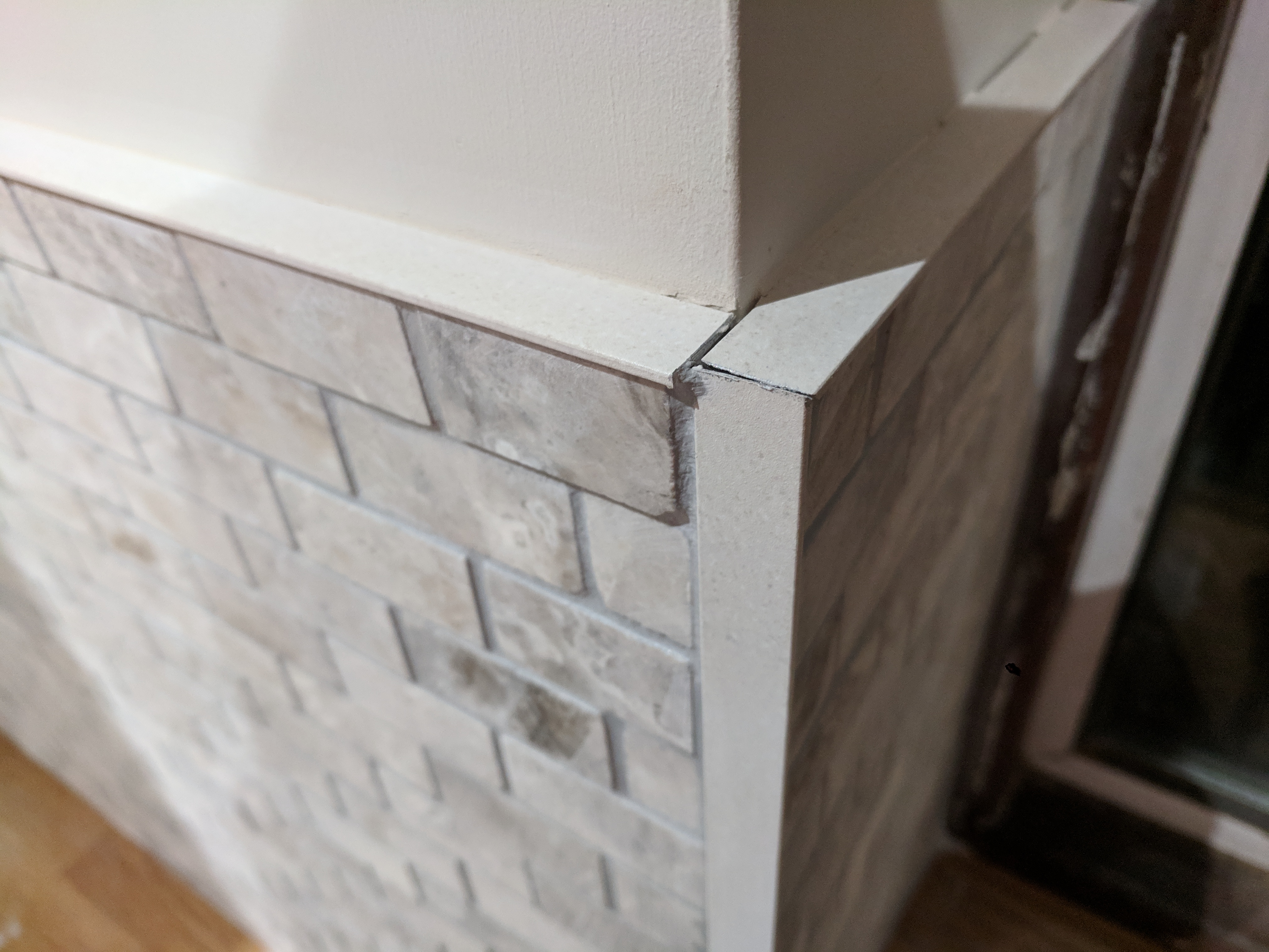

On Friday my kitchen plash back was tiled with 10mm thick marble moasics with 12.5mm trim by a tiler who had previously done my kitchen/dining room floor. Unfortunately, I feel the kitchen work is of poor quality and I need some honest advice on whether I'm being overly picky and/or what I should do next.
Key issues I have:
- Chimney stack built to 600mm wide and not 900mm despite specifically pointing this out

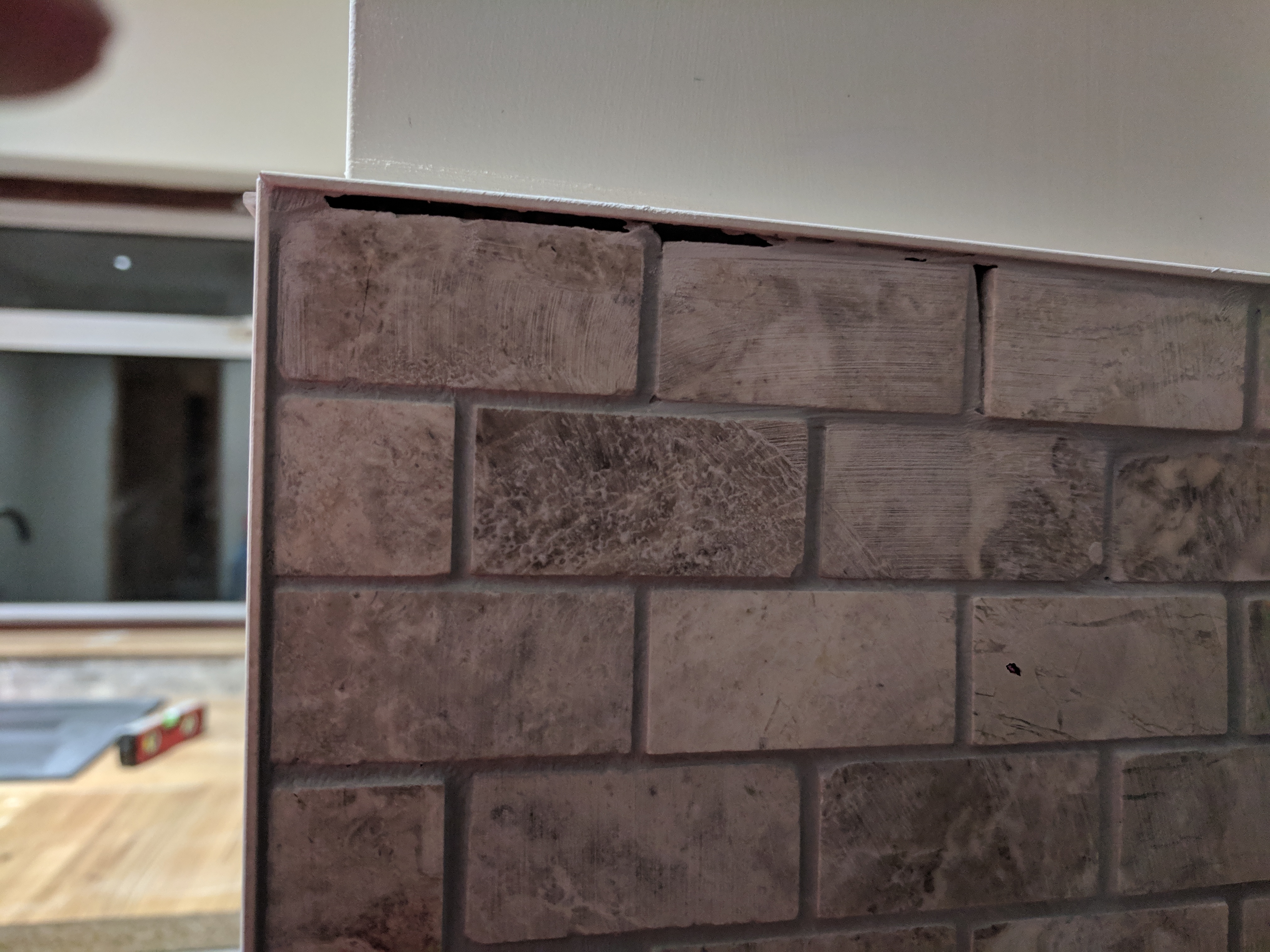

- Tiles are not flush with trim by 1-2mm despite being told by my tiler the size trim is what I needed (what seems to be a 1mm max cement bed)
- Large grout lines in areas
- Trim not very well placed in areas
- All corners of window reveal don't align

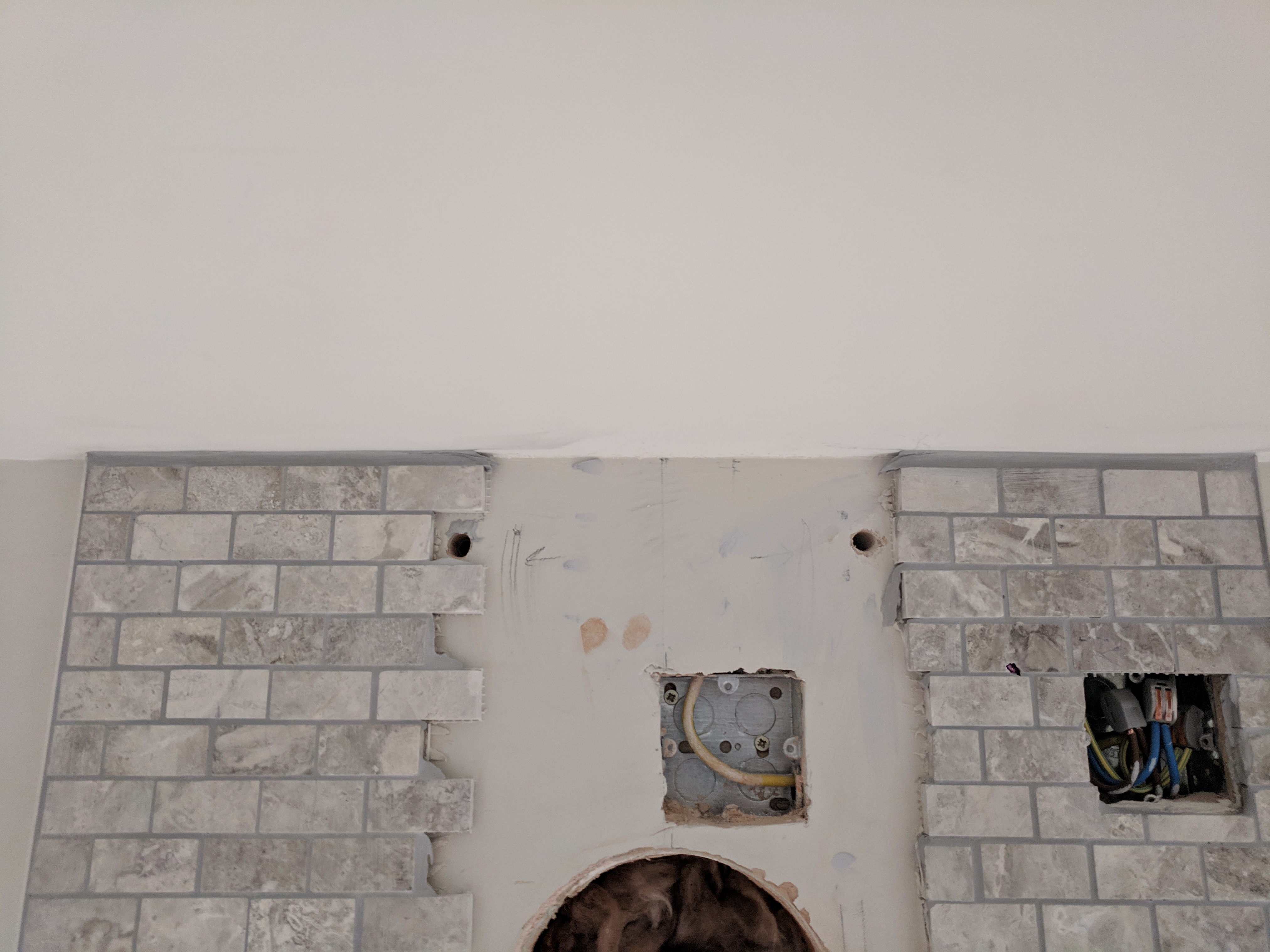

- Tile missing leaving a gap when plug socket is attached
There were a few minor things but the above is what I'm concerned about. So I have explained my concerns to which he got quite defensive about but he did say he would fix the issues to the of his best ability and within reason, and provided I pay 50% of the original cost upfront. I feel that if the quality was not on par the first time, he won't be able to fix the issues to the standard I had expected (this is where I wonder if being picky). I believe that anyone should be given the chance to rectify there mistakes (specifically making the chimney to the width originally specified) but unfortunately, I don't have faith the quality will improve.
A comment which put doubts in my head was that, when I pointed out the 1-2mm protruding lip of the trim he asked if I got the wrong sized trim. I then told him that I got the 12.5mm trim on his instruction, to which he then replied that there is usually a 1-2 mm lip on tiling like this.
I'm not sure where to go from here and any advice on what to do would be greatly appreciated.

There seems to be too many areas of concern for remedial work to be undertaken. The trim is protruding over the face tiles, corner mitring ( internal and external) poor, uneven grout lined, large gaps to worktops filled with grout, badly set out cuts to window frame. Lesser issues - missing grout, pointed gap under cill....
Not a decent standard really for a ‘professional’ - buts that just my opinion!

Full rip out and start again.
If it was just one area of concern the same guy might be able to improve but it’s a catalogue of errors- poor trim mitring, incorrect mitring method. Poor cutting against window, gap too large and grouted between tile and window sill, tiles jutting out, tiles misaligned, grout everywhere, grout missing and tile cuts missing!
That’s just off the top of my head. The guy can’t honestly be a Tiler.
One thing that is also worth noting- if the guy can’t get the visual stuff right by making so many errors, what hope is there for things you can’t see! Poor preparation of walls, priming of the wall and adhesive used.

To be honest i wouldnt of used trims on that job .
Gap beside socket is probably due to the fact there is a gap between the electrical socket and the blockwork/plaster so nothing to stick the tile to . He should of filled it first . Also looks like abutments have been grouted, they should of been siliconed .
Waluigi
Yes I agree with that. External corners no need for trims at all or the top of the tile. Possibly just the top of the tile people sometimes want.
