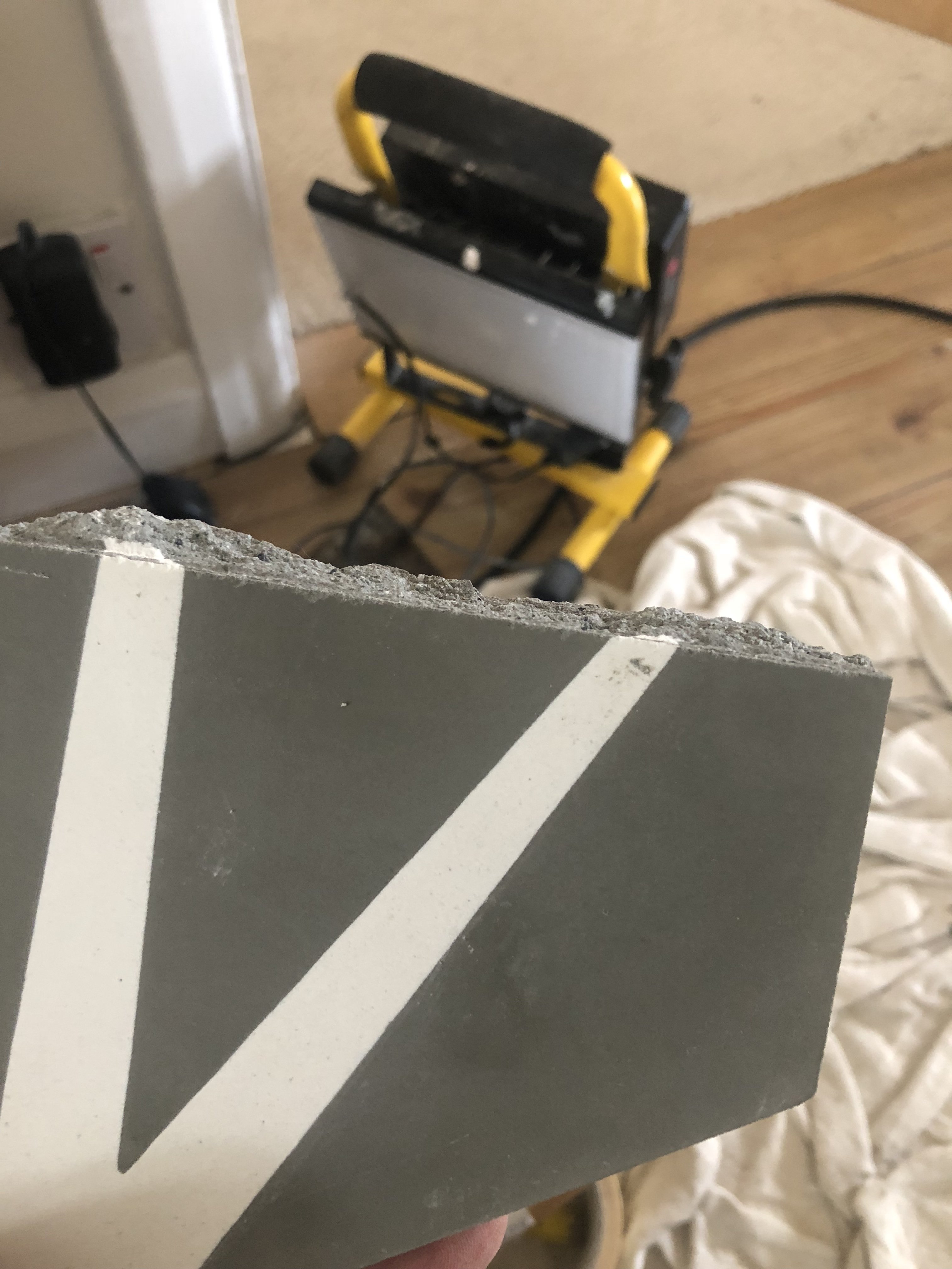

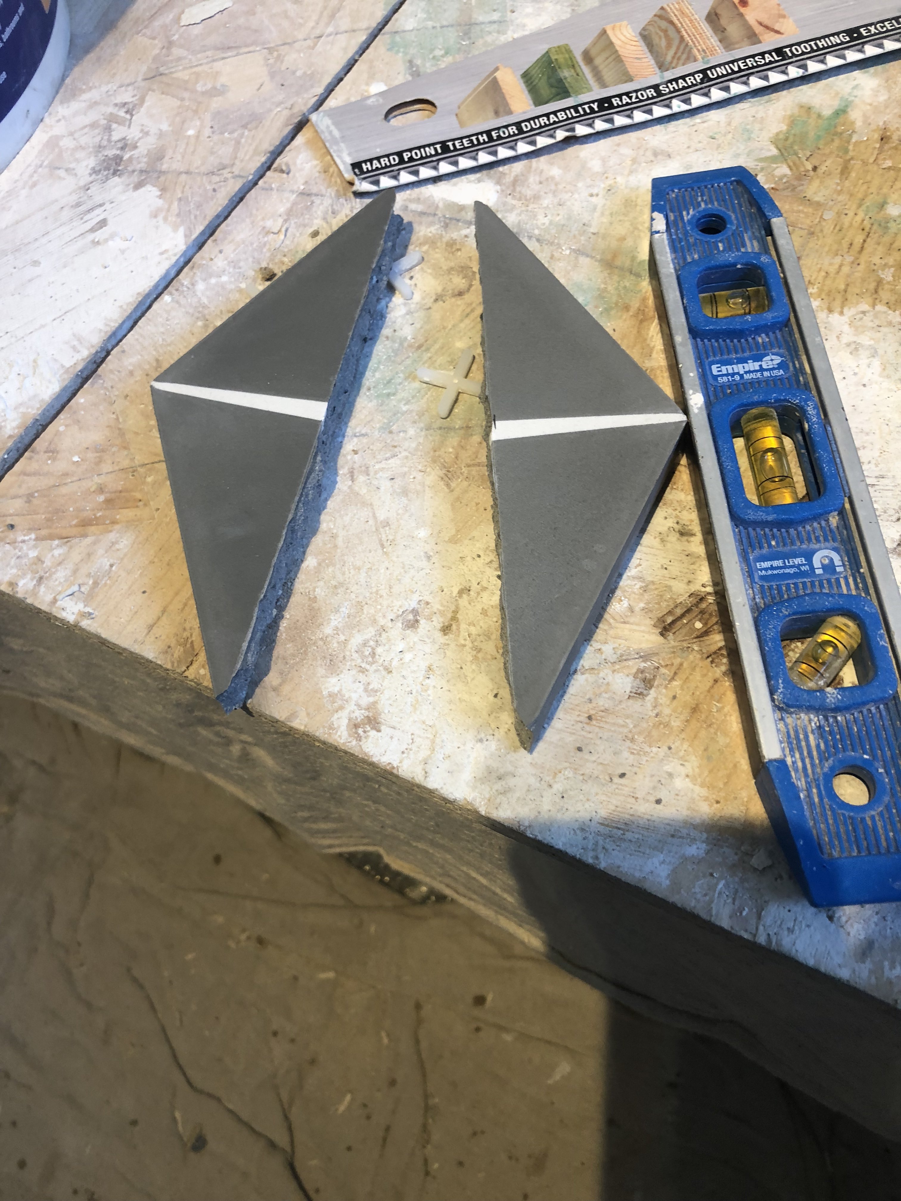

No joy with the score and hammer.
Even the tile that I broke cleanly along the line, left the tile with an edge that needed a grinder on it.
16mm tiles so the likelihood of it working perfectly were pretty slim. Worth a shot though.
That cut, if it was hidden, would be fine and if it is on show
then as you say it will clean by running a grinder along it. I
still think it saves a lot of work and a lot less dust. Just my opinion
I suppose if it was a wall tile and the cut was hidden then I agree it would be fine.
Obviously in this instance it’s not OK as it’s a floor so each cut has to be perfect.
I think the tiles are to thick for the hammer technique too. I’ll try it again when I install some thinner tiles. Thanks again for the tip.
I’ve always cut encaustic with the grinder, wet or dry, both work and leave a good cut. Having that amount of materials left on the cut makes it pretty much no good most of the time.

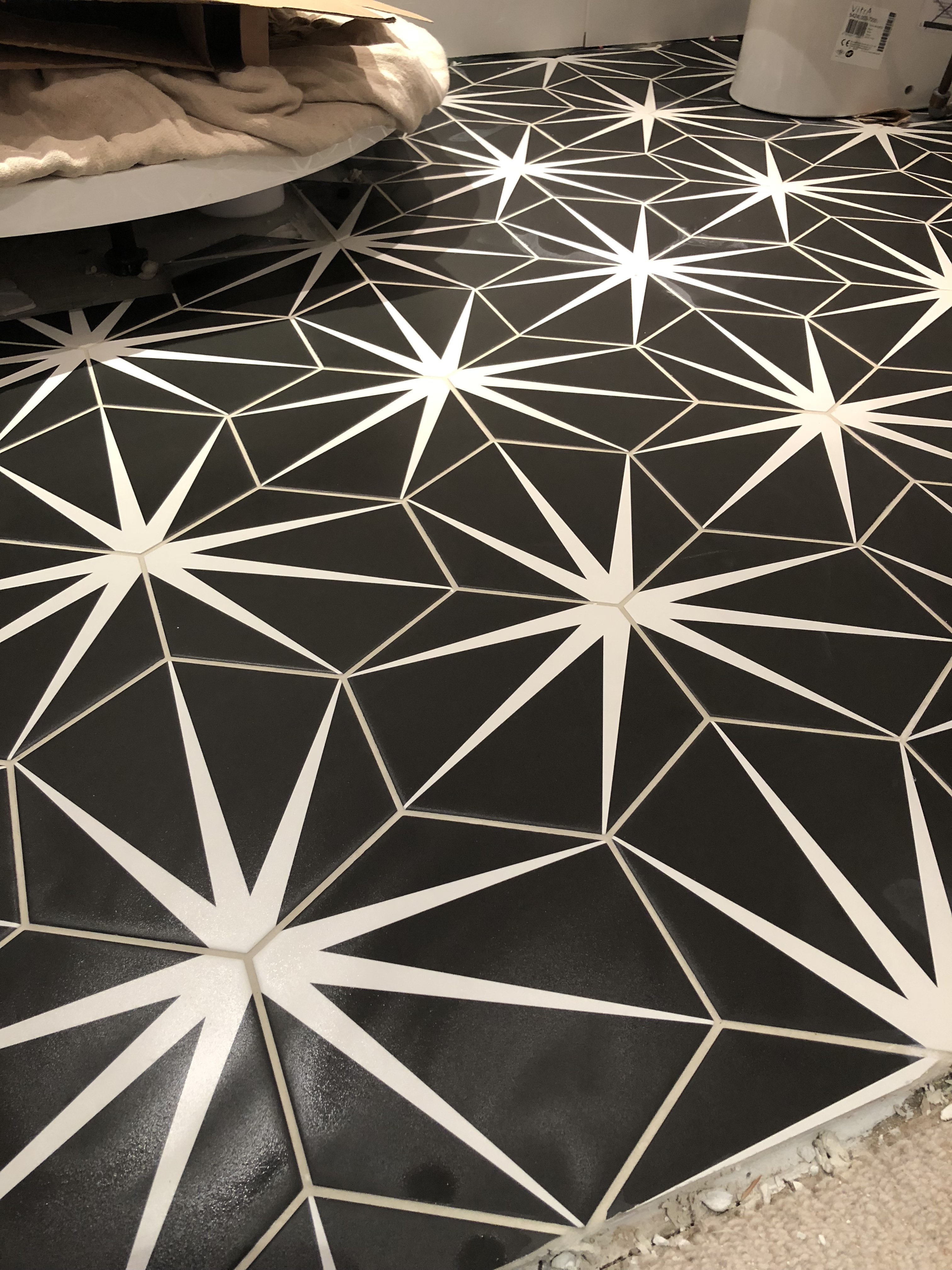

all done now. I shall consider a wet cutter next time. I probably won’t get any further than glancing at the extension lead.
I did 40 odd cuts today on two batteries. I just think I prefer a grinder. A sponge on the blade is the saviour.

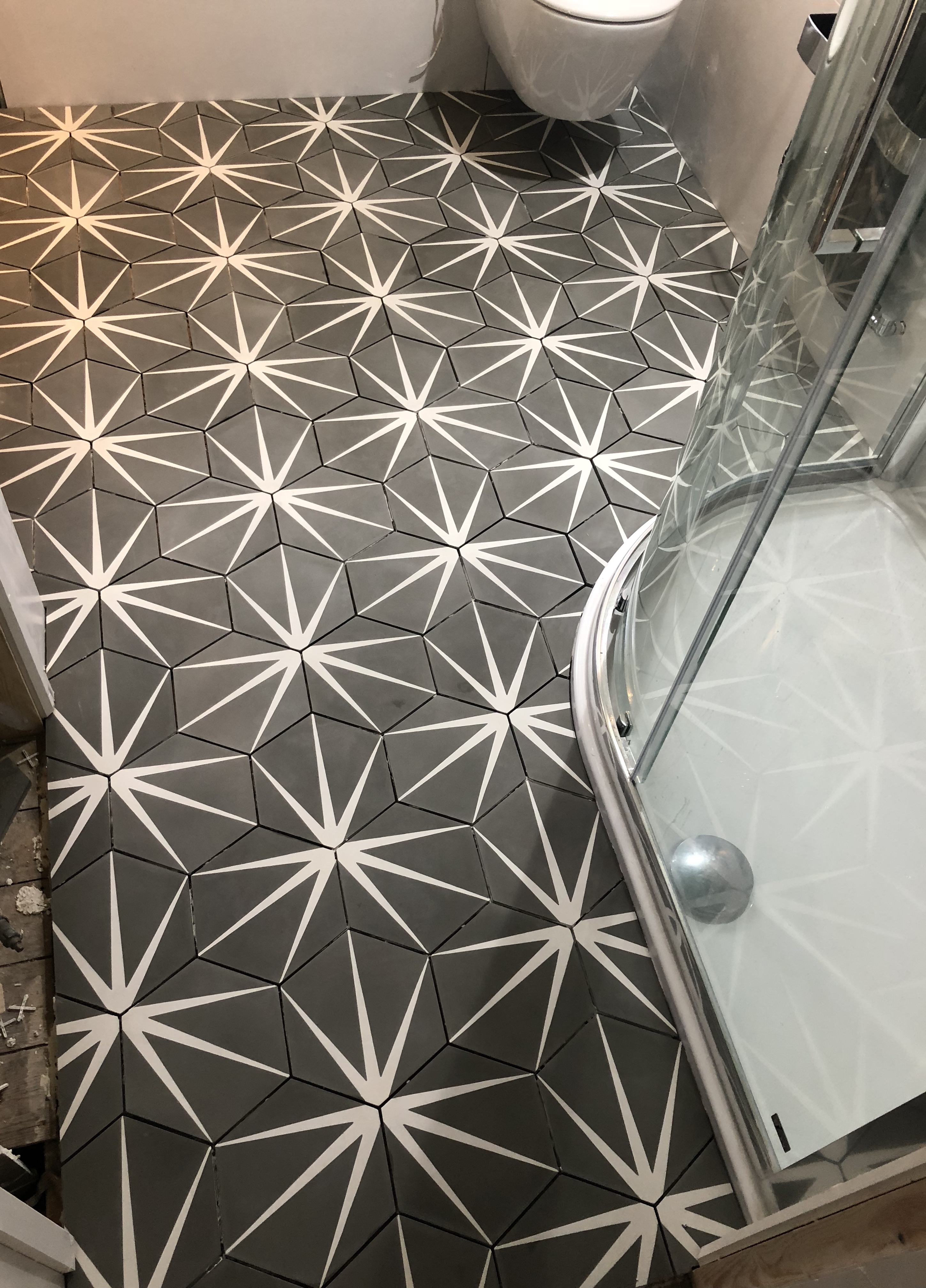

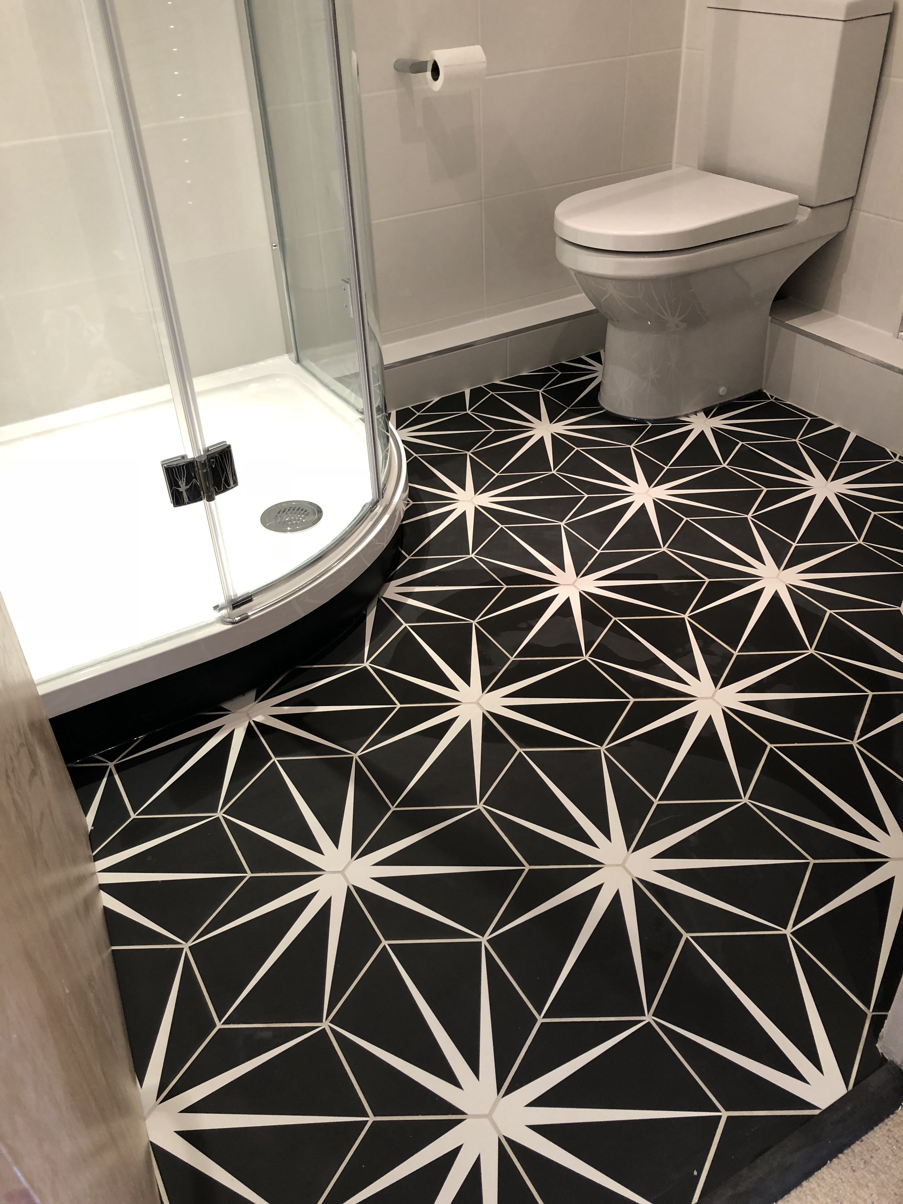

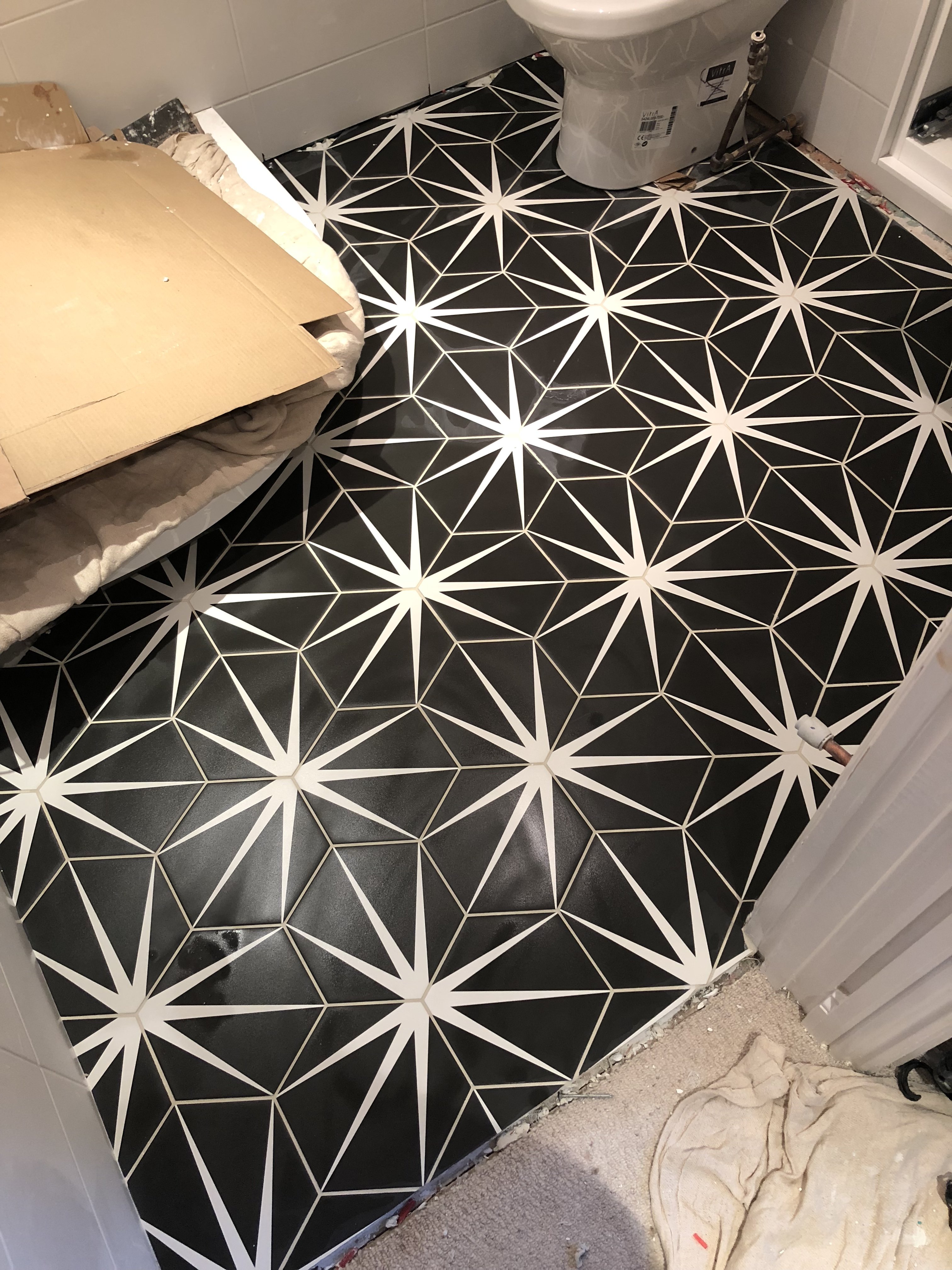

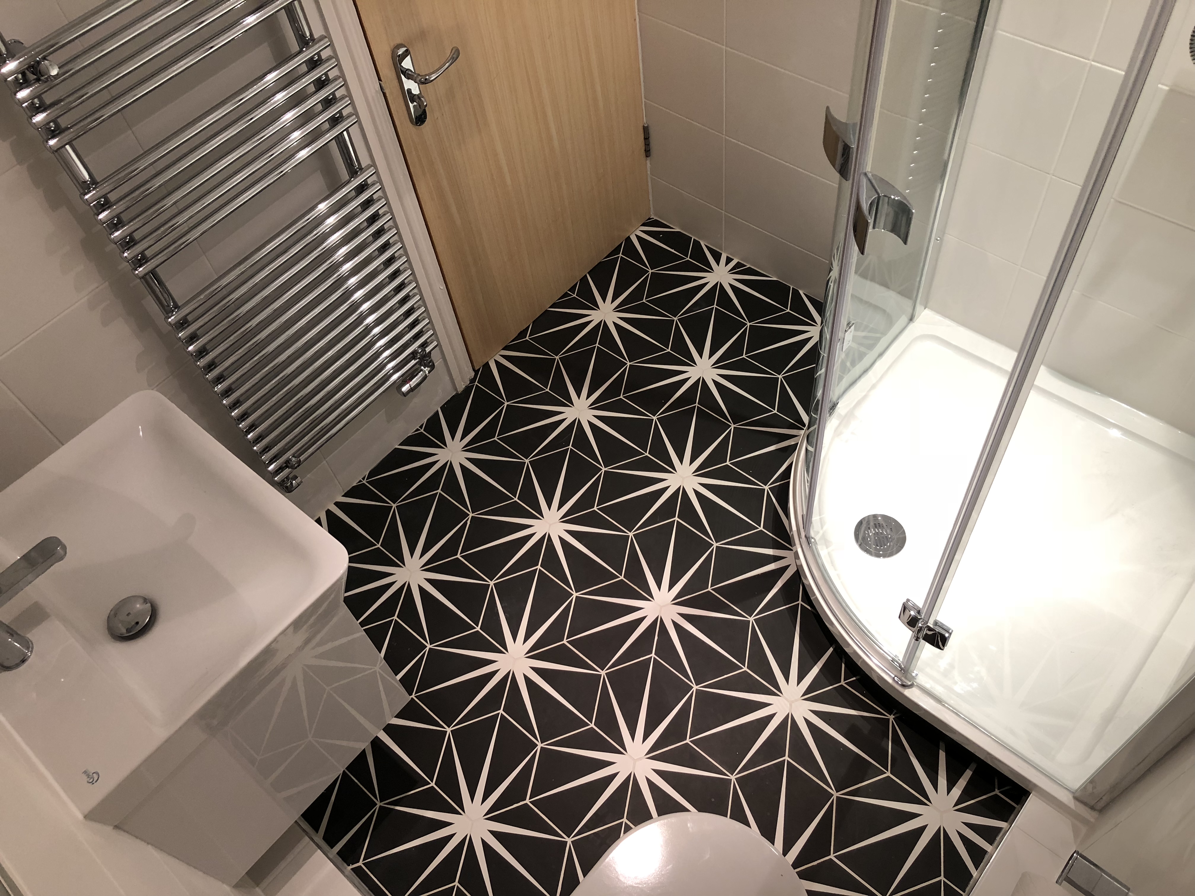

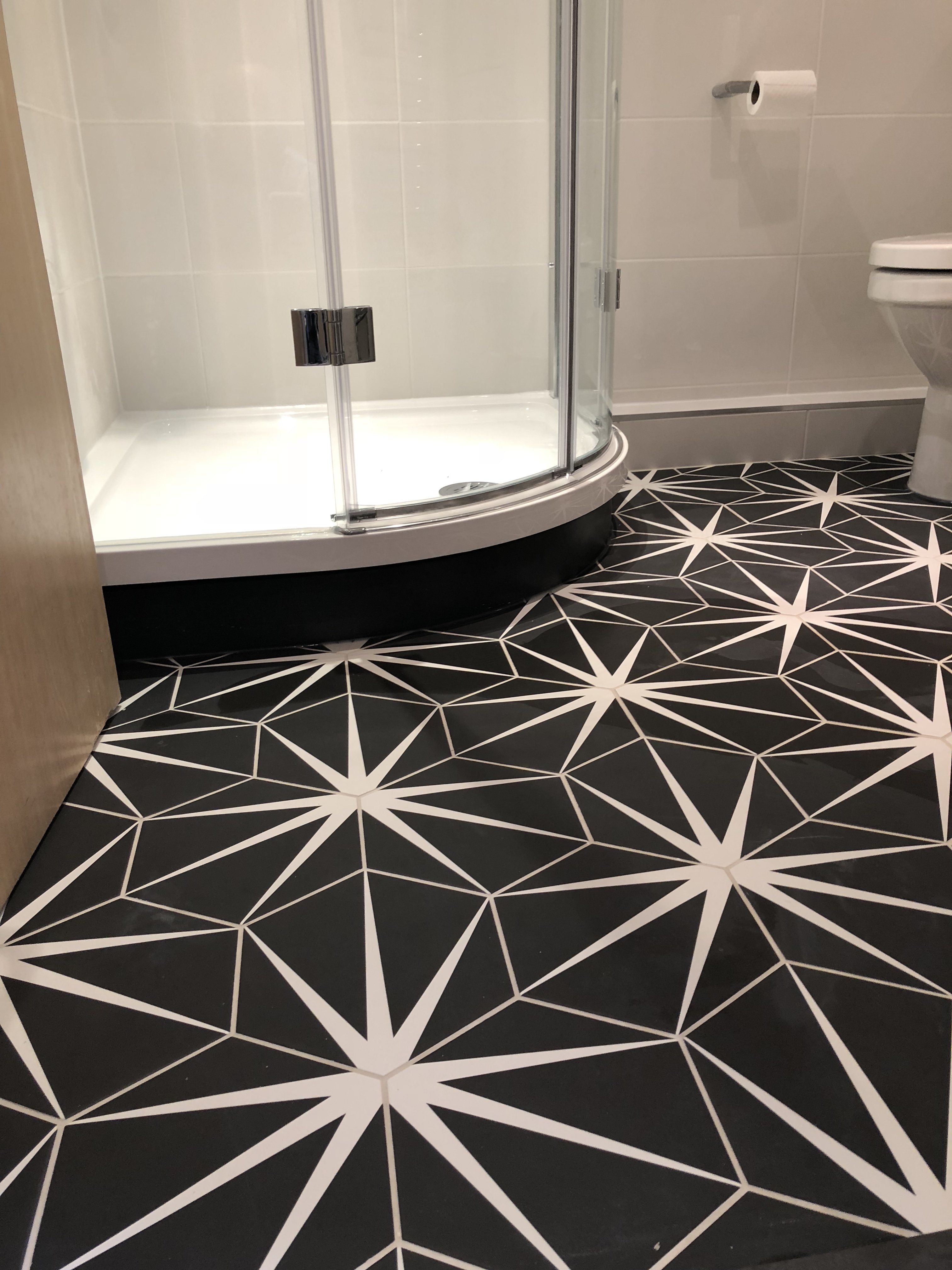

Nice work, looks sharp.

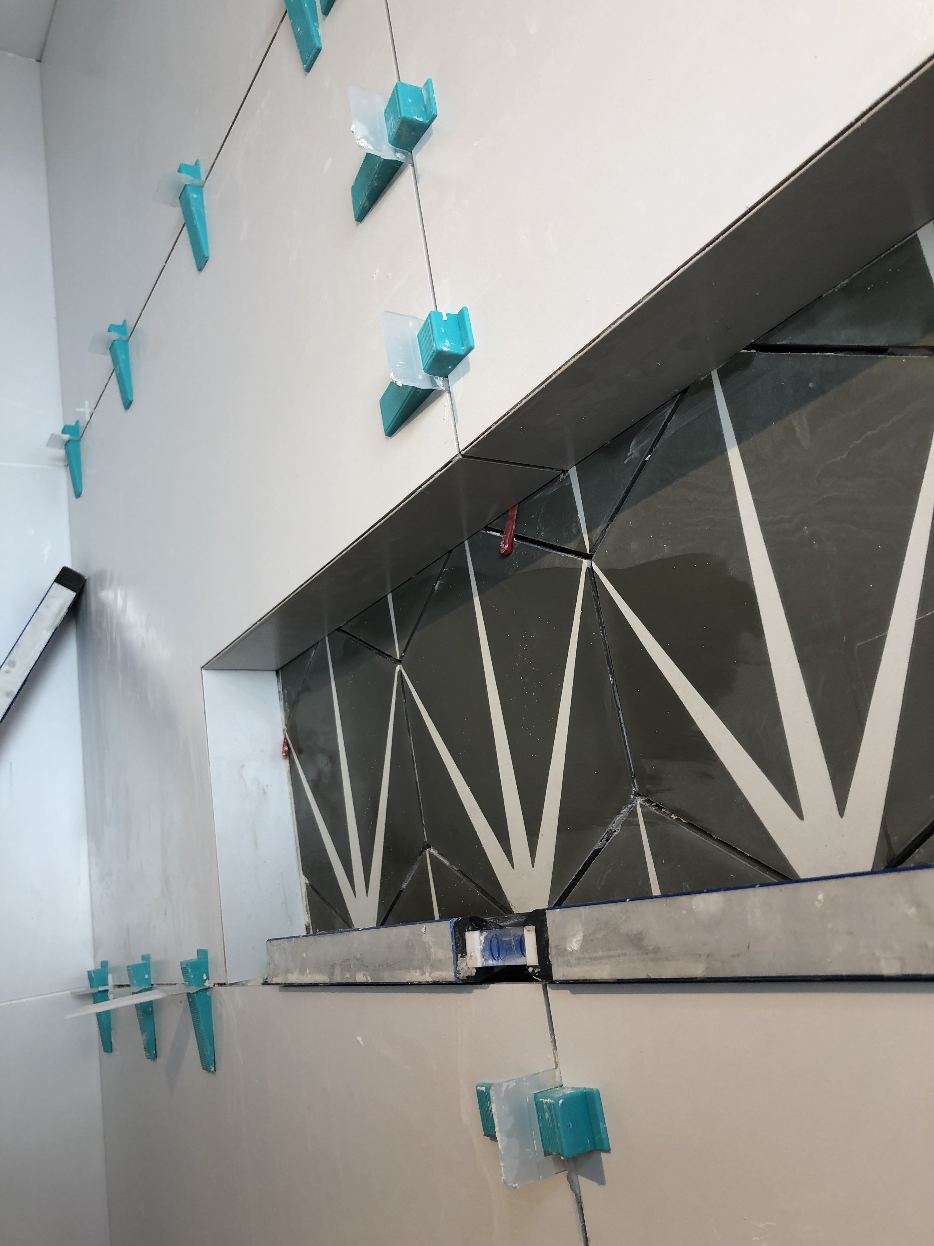

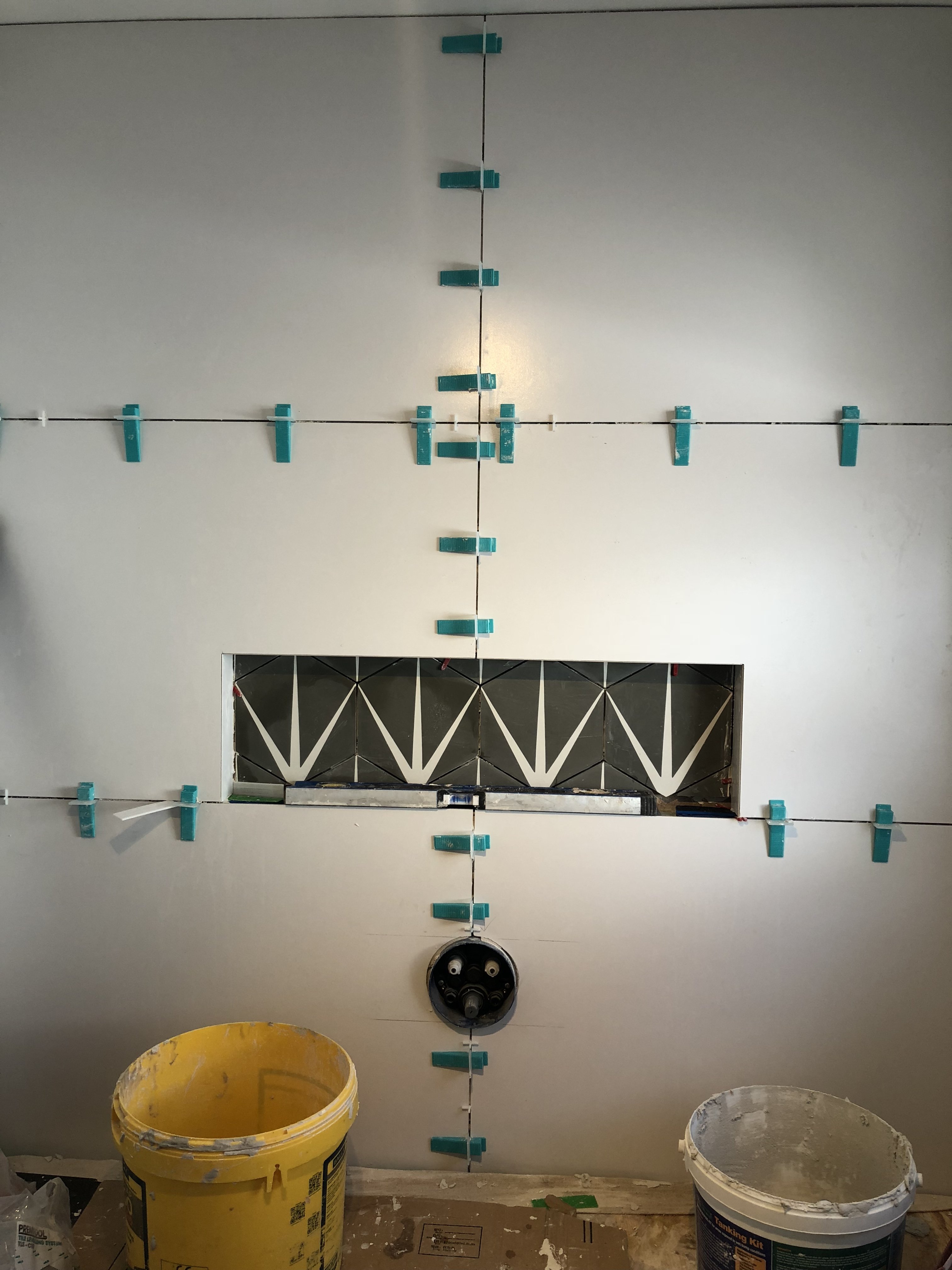

Cheers. I changed the orientation of the tiles compared to the floor as I couldn’t fit a star in as they’re enormous.
The top cuts should have the bottom of a hexagon tile in but that’s looked wrong so I put the same cut section of tile in both top and bottom.
This is what they were originally going to be like
Behind the WC there’s a Basin waste going in, on the adjacent wall there’s a shower waste going in. I’ll pipe it all up, pressure test everything and then box in and tile. Just a small low level boxing.
