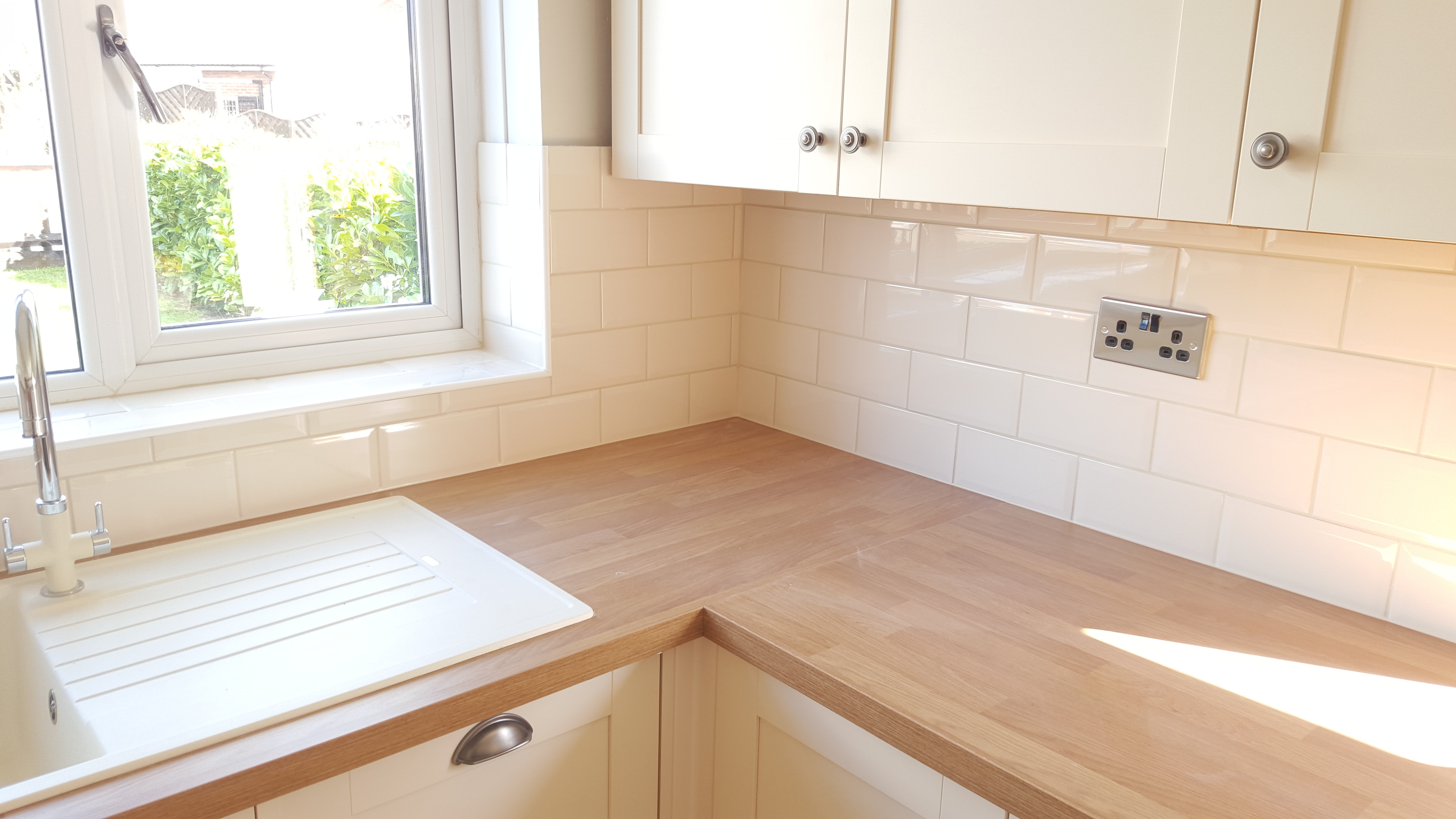

It's these (file attached) but I intend to tile them in a standard horizontal half brick way.
Thanks for your replies 🙂
OK cool........i would start a full tile from the work surface and try to keep the brick bond wrapping round the corners.
Sockets need to be loosened so you can tile behind them you may need to use extended socket screws to get them back and kill the power to them first.
If you have a hob it always looks best to centre the tiles between it as this is the main focal point.
Use a decent adhesive. Ready mixed is OK for a kitchen... Something like bal blue star or bal white star but use a powder mix grout.
on the window, if there is one, tile the face first then fit the trim and tile the reveals.

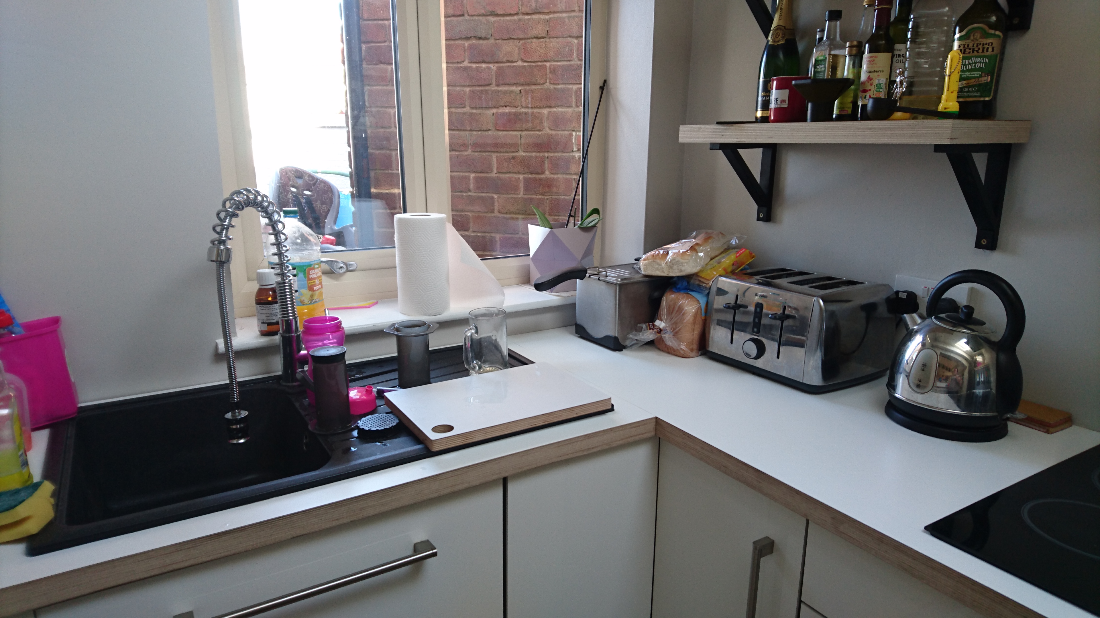

I don't have a tile cutter yet if that's what you mean, can you recommend one? It's quite a fiddly area I'd say around the window. Would you suggest leaving the wooden sill or tiling it? I'll put up a photo.. Thank you for your help.
Would probably leave the wooden cill but tile into the reveals on both sides.
