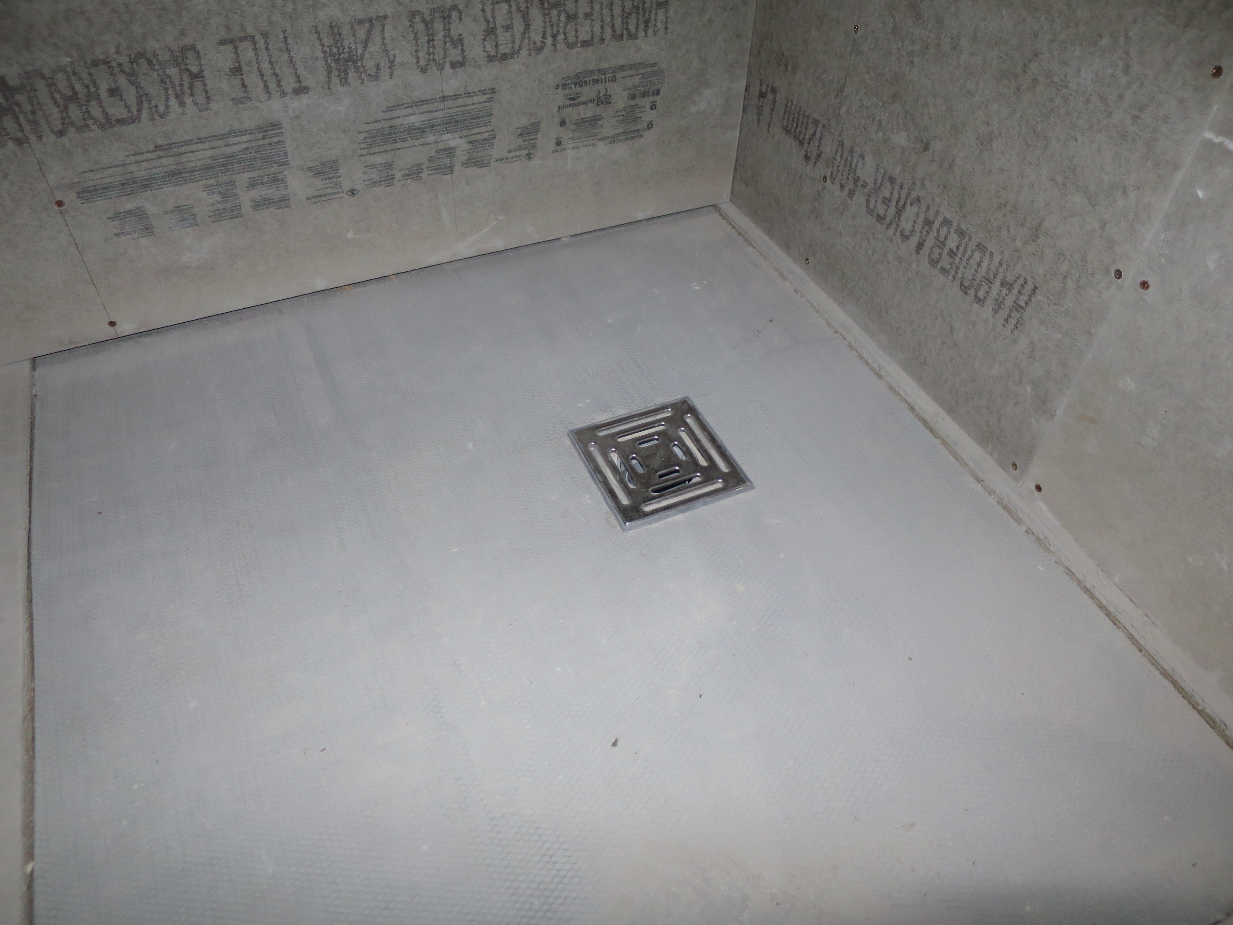

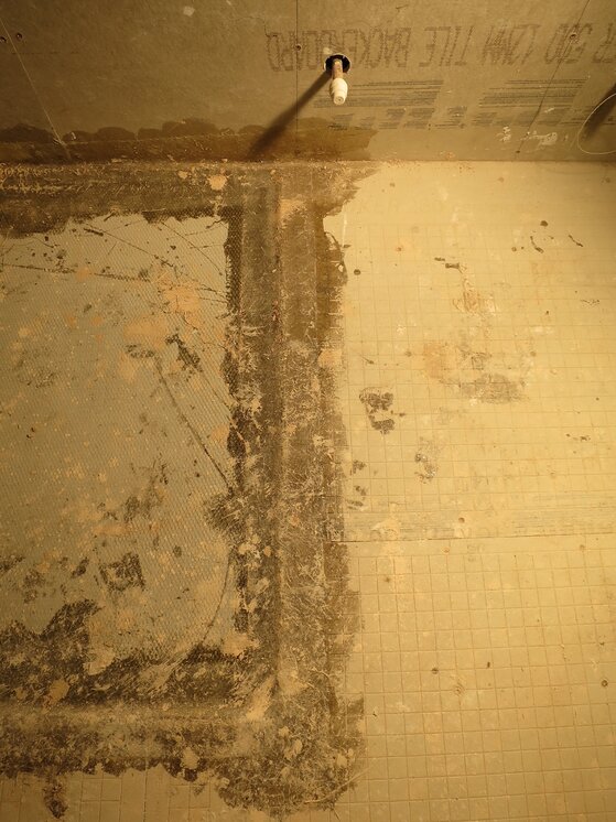

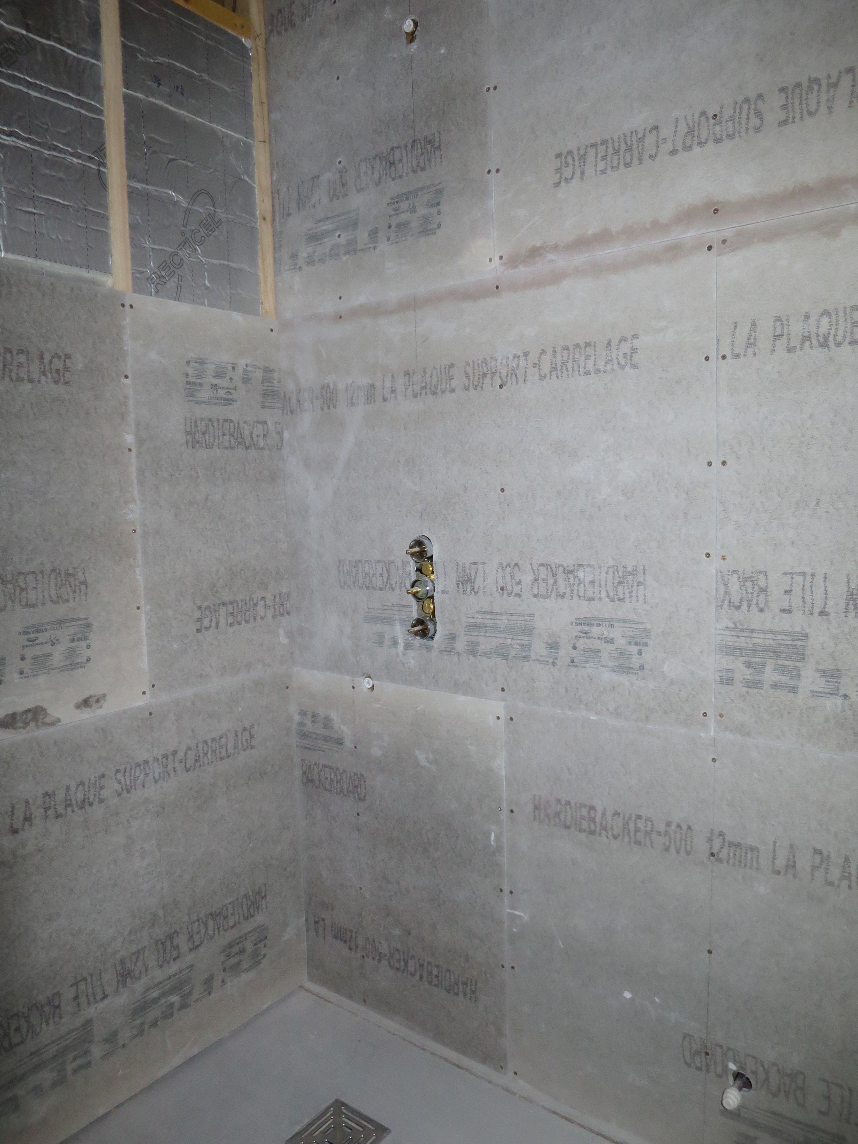

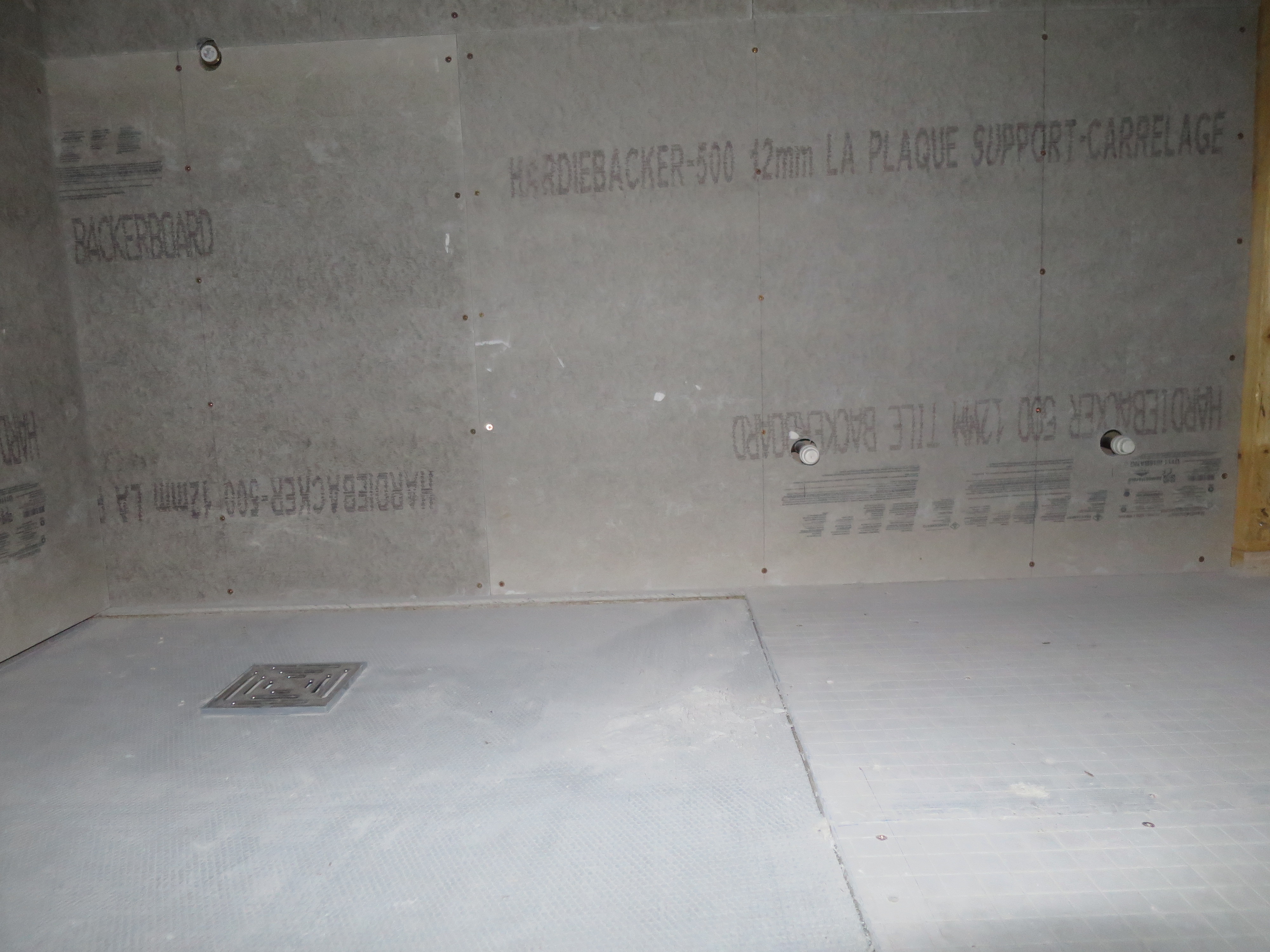

I would appreciate any advice you can offer on tiling this wet-room/bathroom. I have a little experience with tiling.
The room will be about 1.7mtr square and on the shower wall it will be 3mtr tall and on the shorter wall it will be 1.6mtr tall, it is fitted into a roofspace. The joiners have almost finished fitting it out with a water resistant backer board. The plumber has already fitted the wet-room tray.
My intentions are to use a BAL wp kit to seal the joins in the backer board, corners and around the edges of the backer board on the floor. Will the tape that comes with the kit be sufficient for this, particularly in the corners and where the board meets the floor/tray?
I anticipate a problem in that the floor has 6mm board on it and as such is 6-7mm higher than the tray. The tray will be tiled with a slate effect porcelain mosaic tile in 300mm squares with each piece being 30mm. I have sufficient mosaics to have at least 1 full mosaic tile on the floor level, outside the tray. The rest of the floor and the walls will be tiled with a similar full porcelain tile 600x300mm.

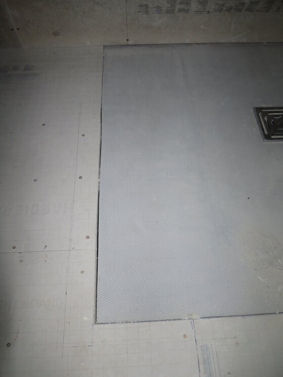

There is a small gap between one edge of the tray and the floor, about 3-4mm. I have in mind to fill this with some of the BAL SPF adhesive before tanking at the same time, I plan to create a fillet from the higher level of the back board down to the tray, over about 100-150mm using the adhesive as a filler, I hope this makes sense to you, even if its not the correct method for joining the 2 levels.
I then intend to tank the wet area, using the kit, tile the walls, starting 200mm from the floor, then tile the floor, starting with the mosaics and working out from them. Once all set, I will cut and insert the bottom tiles. Grout and then seal the corners with Silicon.
Here are some photos of the room and areas mentioned.
My questions are:
Does my plan sound feasible?
Will the tape that comes with the WP kit be sufficient for the corners and edging the floor to the wet tray?
Is my plan to fill the drop down from the floor level to the tray with adhesive ok? If not what should I use.
Thank you in advance of any advice offered

Chalker, thanks for responding, I believe the tray is foam core, I've just been looking online and it is made by Dallmer. I understand the mosaics may be too small, I'm not sure what too much contact point means, but what adverse affect would that have. What size mosaics should I be looking for as a minimum? Do you think that my proposals to level out "with a slope" if that makes sense, joining the backer board with the tray, using an adhesive filler is ok? Thanks buddy, I appreciate your experience.
Thanks Dan, those drain covers are miles better, I'll show my neighbour, who I am doing this for, I'm sure we will be looking for a quick replacement.
It's point loading I.e. The amount of pressure exerted on a small tile will be too great ok a foam core former. I think 50mm is smallest but not positive.

My concerns initially, were the difference in levels between the backed floor and the tray and also the small gap. And I'm not sure whether the tape that comes with the BAL kit is sufficient to cover this with the waterproof paintable membrane.

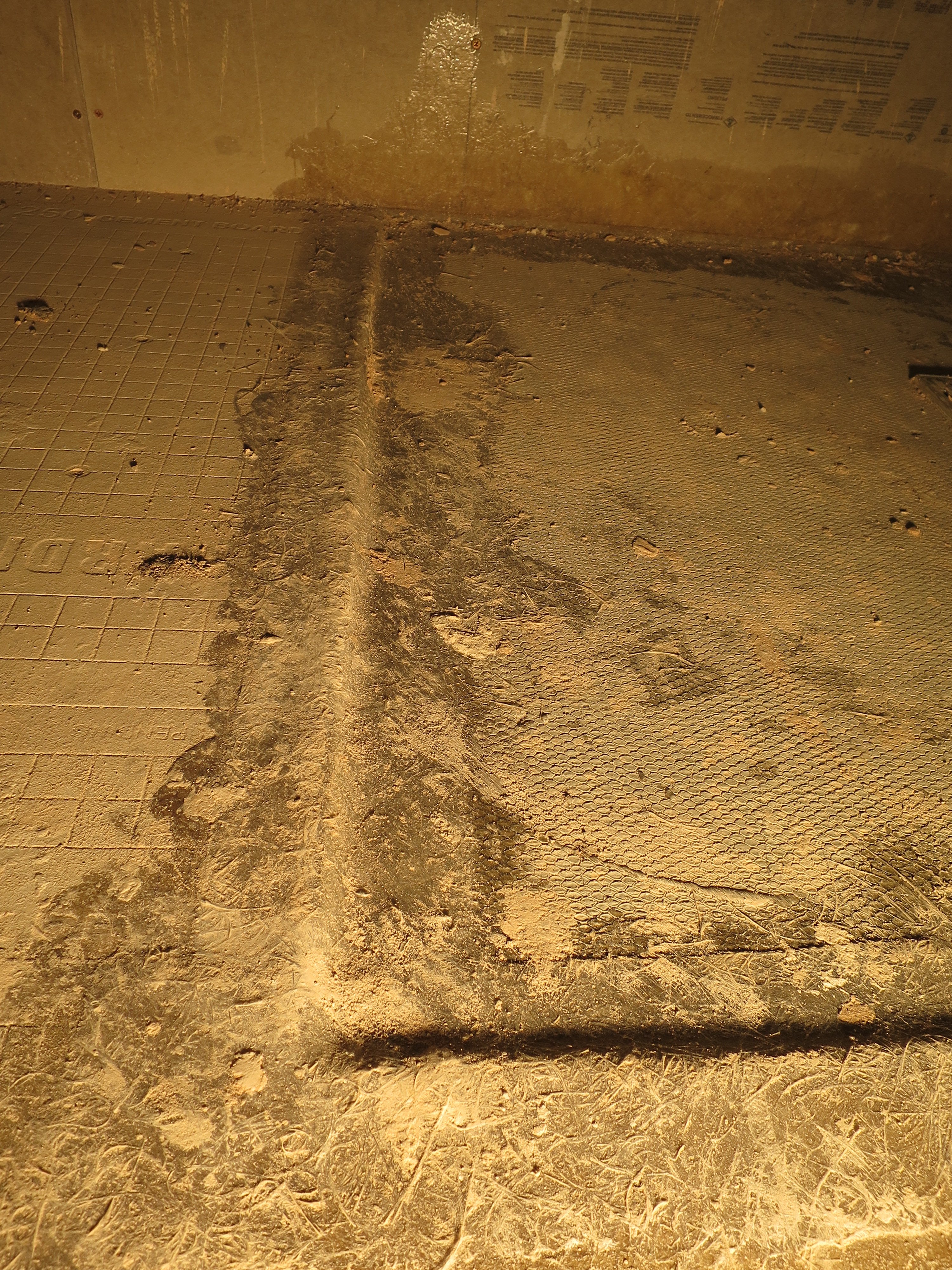

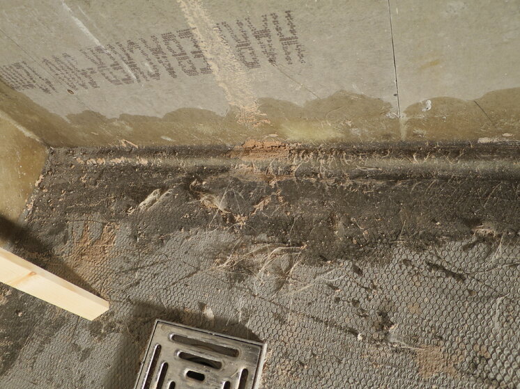

The plumber has been in again since the first photographs and he has applied a resin and fibre seal around the shower tray, it smelt like the stuff you repair glass fibre canoes with, I asked him about the gel coat and tiling over it and he said he has done hundreds of wet rooms and never had a leak yet! Is this common practise, and will the BAL SPF, I plan to use, fix the tiles ok?

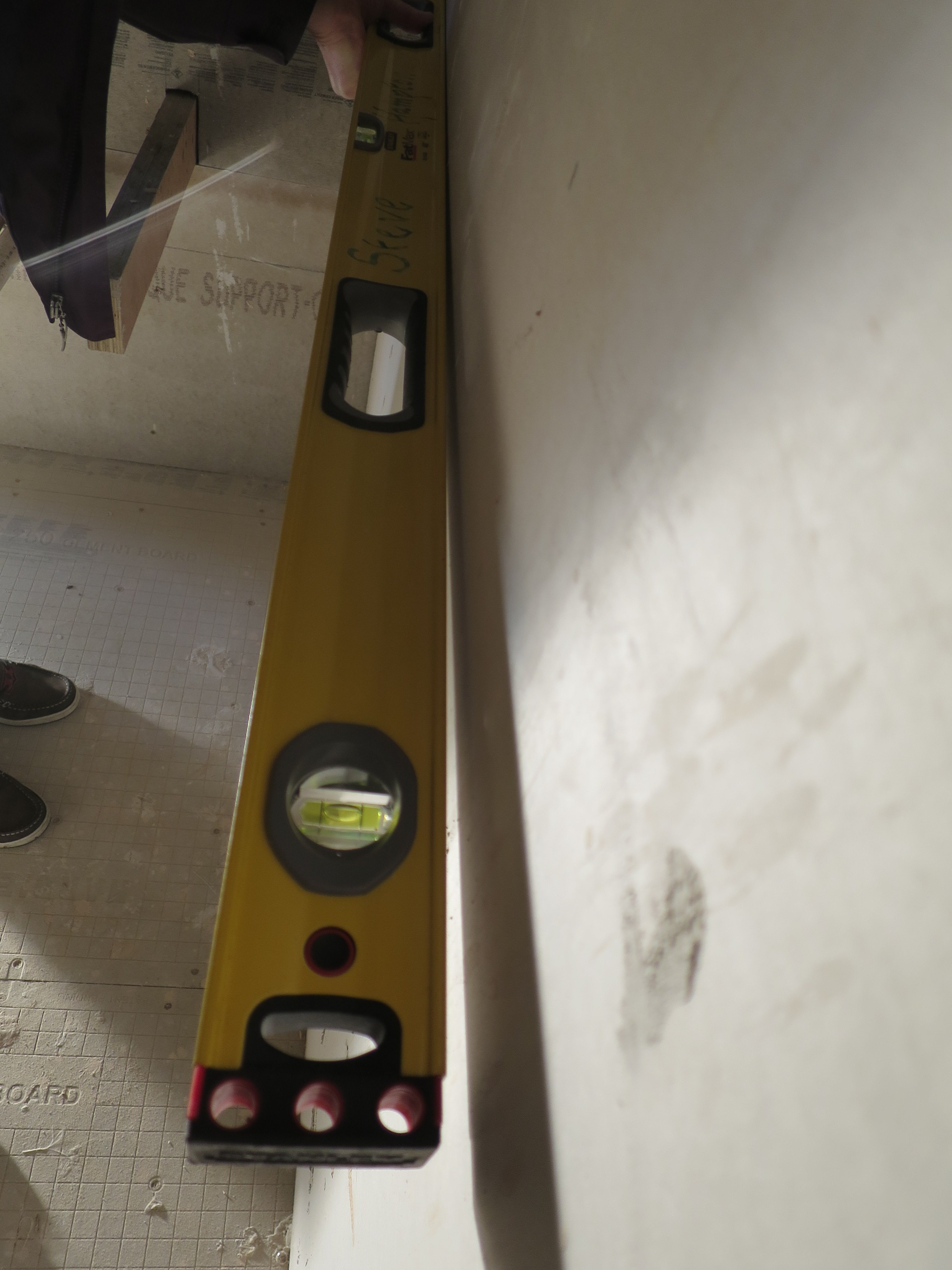

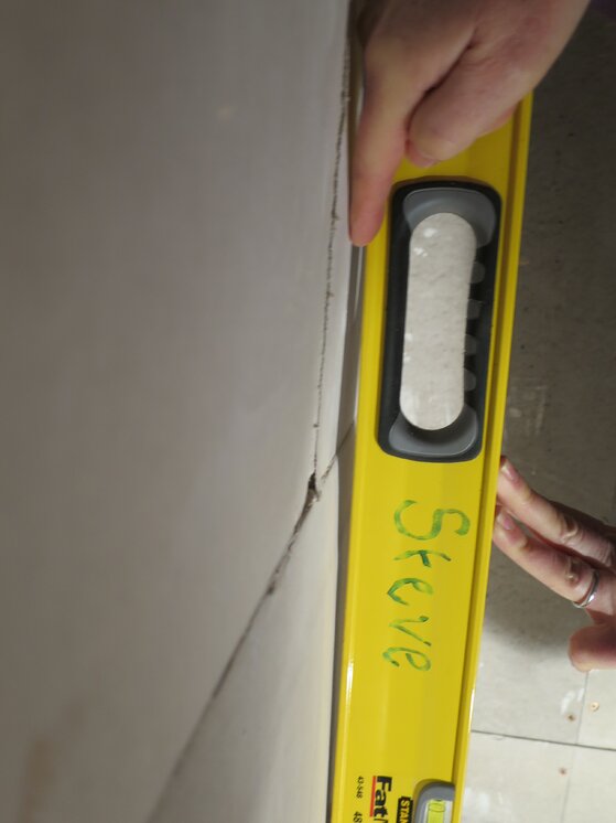

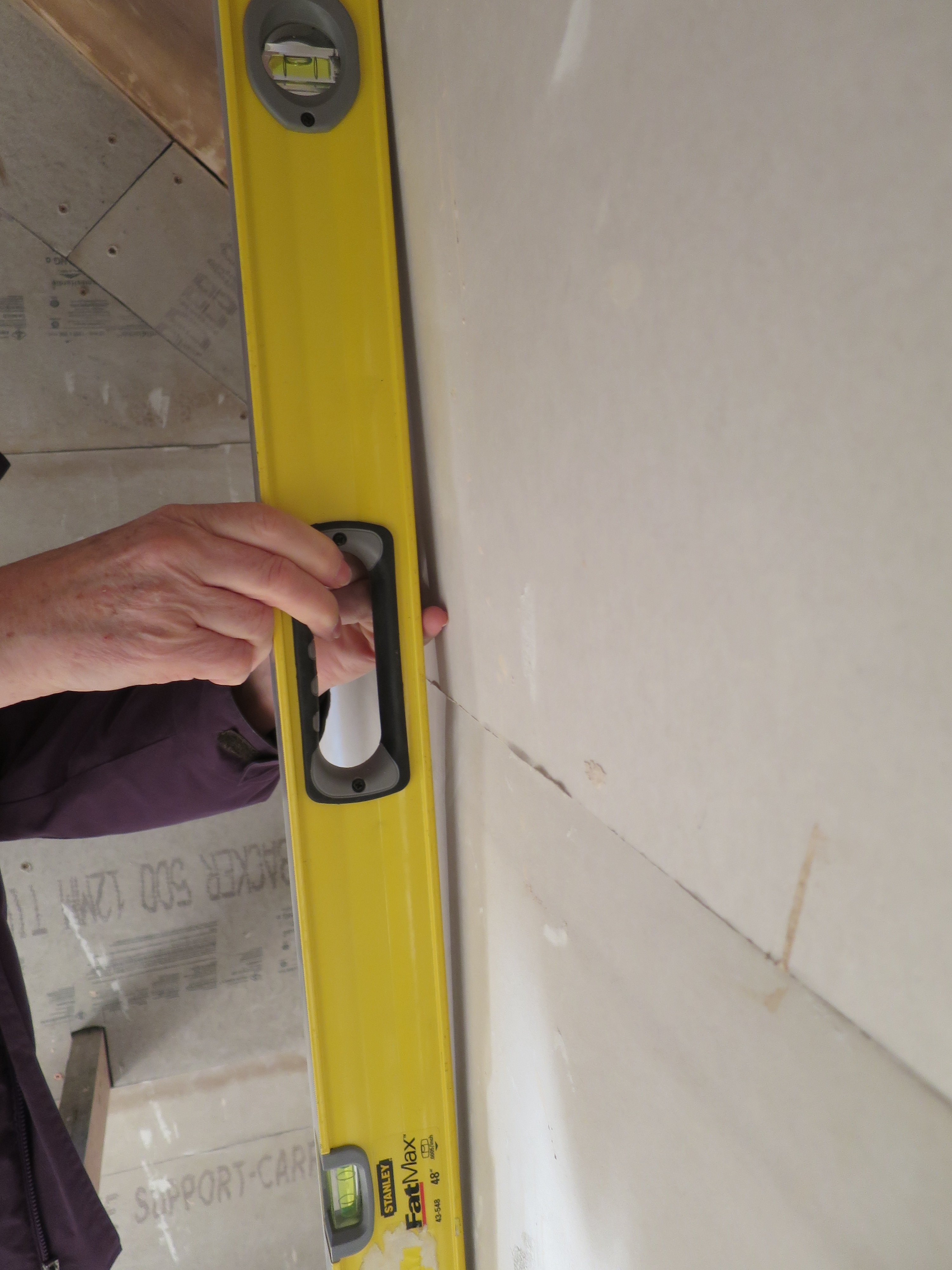

The joiner who built most of the wall has not been back and so the home owner had the plasterer dot and dab plaster board over the 1 unfinished wall. This appears to be badly warped, not plumb and with hollows in excess of 12mm when a straight edge is placed on it. Again is this normal for you guys and is it the kind of thing that can be sorted out with a variable thickness, thick bed of adhesive? eek.

I can't remember the exact measurements but British standards states that over a 2m length there is meant to be no deviation either way more than about 3mm or something like that, so no, that's quite bad. Varying thicknesses of adhesives that much will mean A) you have a lot more weight than is allowed on plasterboard in certain areas and B) your adhesive choice becomes more important and restrictive. As you don't want shrinkage which can crack tiles.

Thanks Geoff and Dan, I was beginning to think this may need taking apart before putting together again. Just to clarify Geoff, my intention was to tank the wet areas, tray and wall with BAL WP1 tanking kit, on top of the resin, but I have no experience of this type of finish and I am not certain that the BAL kit would adhere to the resin. The screws are 40mm brass (coloured).
You are thinking right. Wall so bad easier to redo it flat rather than try to plaster it flat. If the surface is so bad what is the fixing underneath like? To be flat enough to tile it must not be possible to slide a 3mm spacer underneath a 2m long straight edge placed anywhere on the wall!
You will need to know what the fiberglass resin stuff is so that you can check with the BAL tech help people if their tanking system can be applied over it. I wouldn't risk it without their say so.

Sand down the fibreglass well with a rough paper, to aid keying.
Get 2x Ardex WPC kits and tank out the wet area. Scrim tape the corners and board joints and go over again with Ardex WPC.
Drill some weep holes into the little plastic upstand around that marmox tray, and don't use less than 50mm mosaics on it.
Good idea too to use an epoxy grout on the tray.

Fill the walls out with tiling addy and as for the 3mm rise between floor and tray, youll take that out with tiling addy aswell
Why would the op do that? It's all brand new studwork and boarding.
There's no excuse for it to be like that at all!
Should be made to start again. And do it correctly.
And parts would fall beyond sensible capabilities of adhesive, and it's not good practise anyway.
Whether or not it actually works, it'd also void any guarantee from adhesive manufacturers.
And there is the little matter of it being a wetroom, not 3 high around a bath.
No i understand. Probably cheaper to board it again correctly.
