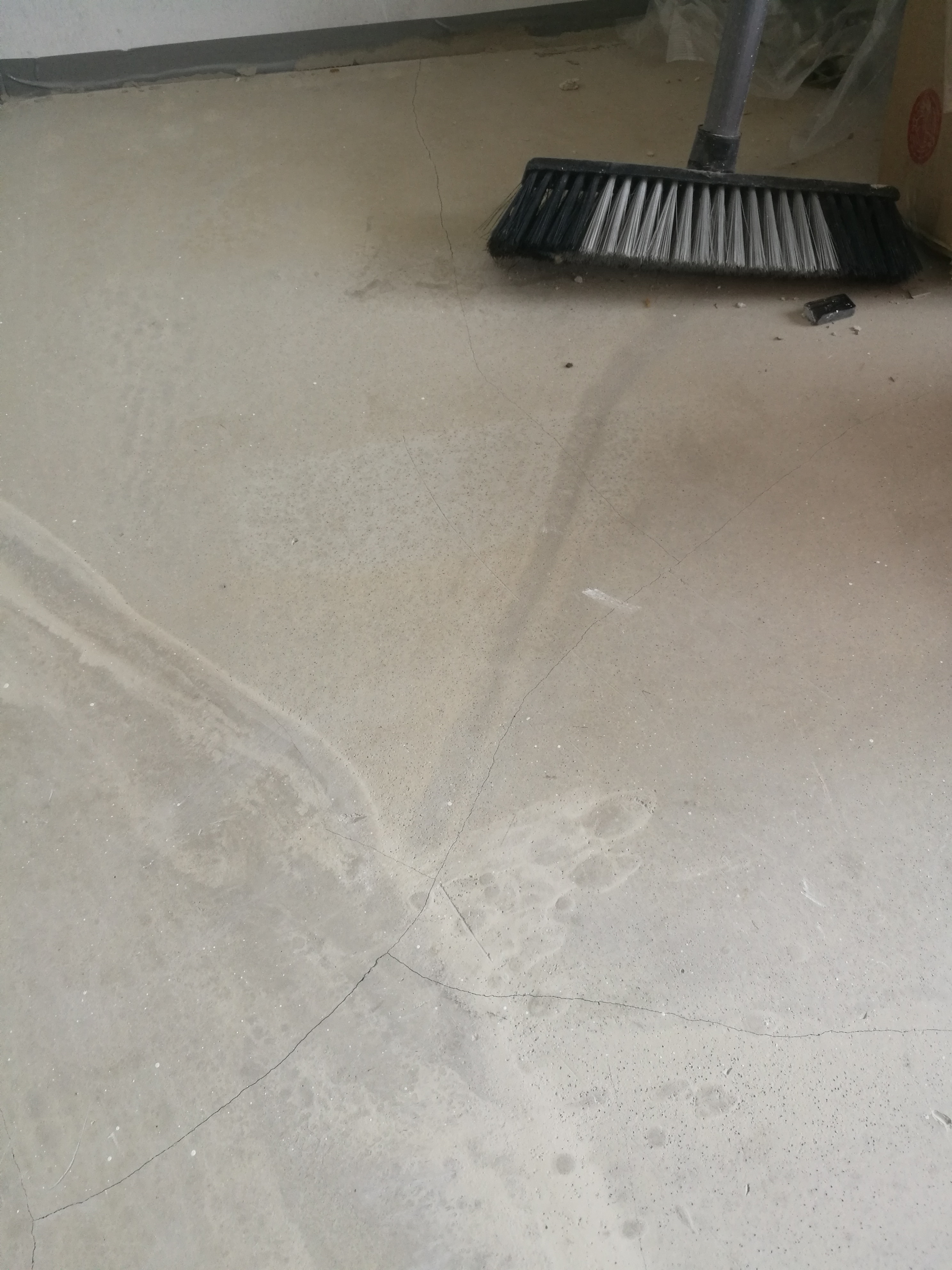

We had self leveling compound laid about a week ago by our builders in our shower room and through to our kitchen/diner, i`ve been cleaning today and i`ve noticed cracking and breaking at the edges near the patio doors. It was laid onto plywood boards (in the kitchen area) , concrete in the shower room. Underfloor heating cable was stuck down to the subfloor.
I found an empty bag of the product and it was non-flexible , it says not to use with underfloor heating and wooden flooring!

That's a complete failure. A flexible leveller must be used with ufh to cope with the contraction and exspansion that occurs when the temperature changes, normal leveller will eventually turn to dust. The same problem will occur over the timber floor also. The whole lot will need to be removed unfortunately.
Thanks, Heres some photos of cracks and the bag they used.Sealoflor Floor Levelling Compund - Sealocrete - https://www.sealocrete.com/sealoflor-floor-levelling-compund/
Notice the important section of the bag...
IMG_20180512_150614.jpg IMG_20180512_150625.jpg IMG_20180512_150630.jpg IMG_20180512_154428.jpg

The scenario is i can see the builders arguing that these cracks are normal and theyve done this before without any problems at other properties. I know builders.
Should an option be to ask the underfloor heating to be turned on (gradually) and see if any problems arise. If they do , bring it all up.
Otherwise if it seems ok leave it and try and get some guarantee from the builders that should it fail in the future they will fix it?
