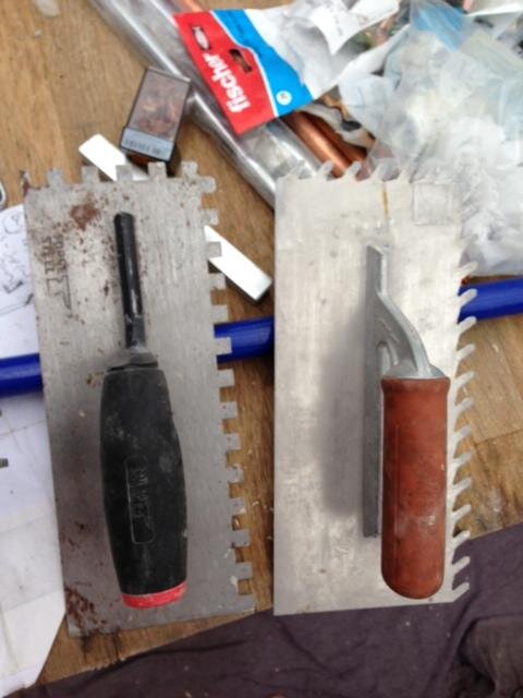

I need to calculate the thickness of adhesive once wall tiles are laid (for corner basin mounting)
Tiles are 305 x 305 trav, 10mm thick.
I have these trowels from my bathroom job. the square notch is 10mm and i think the slanted notch is 12
EDIT, i also have a 6mm notched trowel.
If 8mm is reccomended, ill go out and get one when i pick up the bag of adhesive
Question 1 - Which one should I use for the trav wall tiles? 6, 10 or slanted
Question 2 - What would the thickness of adhesive be once tiles are on the wall using the correct trowel? (I will be back buttering the trav too)

Dependant on the state of your walls it could vary. I use a selection of trowels sometimes.
Personally id be using a 10mm for stone on the walls.
The finished depth wil sink to 4/5mm imo.
How many m2 are you tiling?
Re: Trowel notch size for 305x305 travertine & calculating adhesive de
If the walls are flat , then an 8mm is good to go and a light back skim for contact , bed will be around 2mm to 3mm if you bed in tight.

Hi gents, its only a 4m2 job. (half a cloakroom WC)
might stick with the 10mm. Nothings ever been straight in this house 🙂

I use 8mm for trav that size. Youll be ok with your 10 though. Set in well and if you butt the stone together before adding your spacing you can mop up any excess as it squeezes through.
Im sure you know to back skim the stone and use a white adhesive.

I use a 10x10 sq notch "almost" all the time these days.....
back butter the trav (white addy) and the finished bed after rubbing in will be 4-5mm IMO
