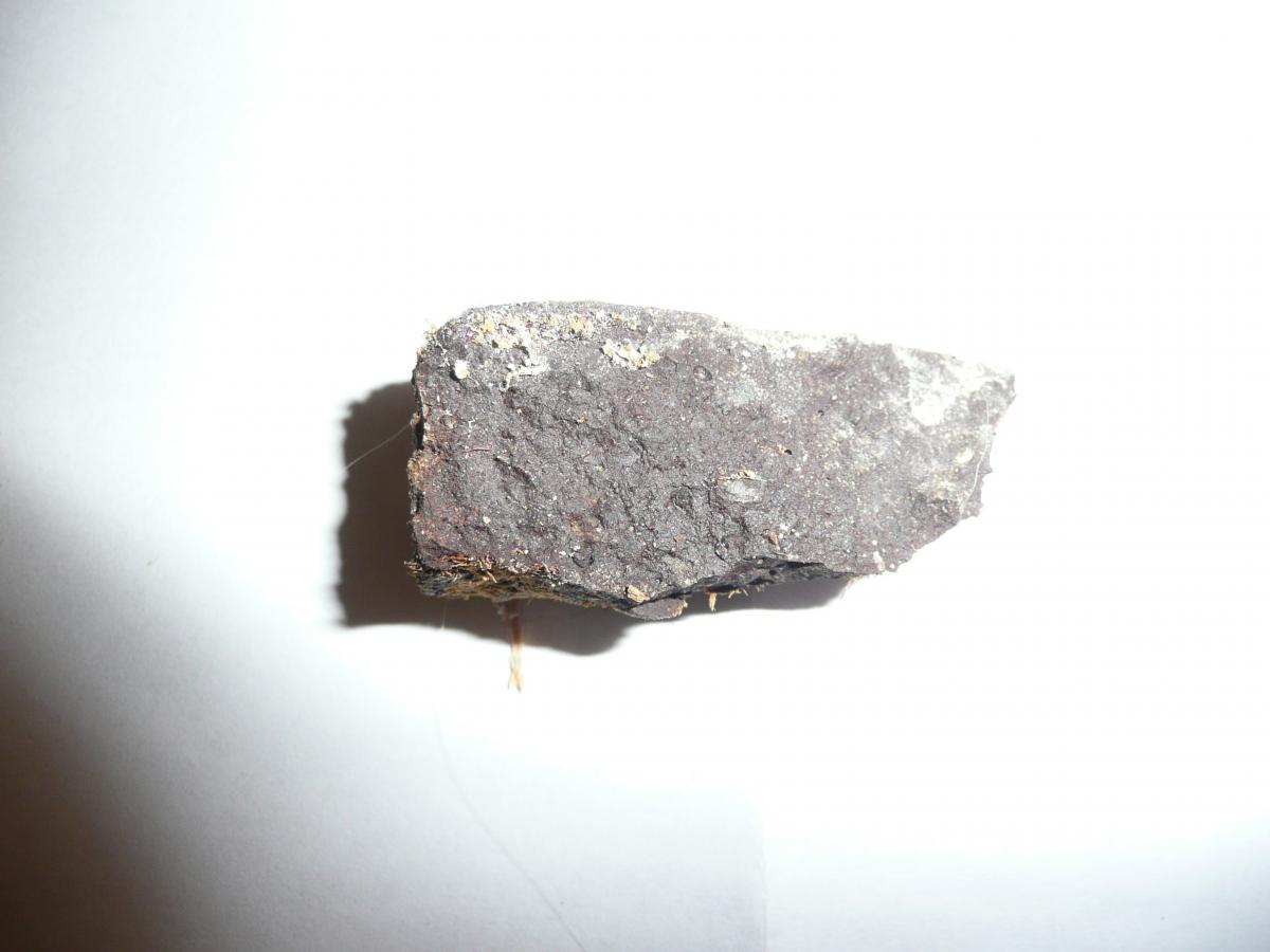

Not easily and safely. If it smells of bitumen it could well be that. If it were me I would SAFELY use a heat gun to see if it melts. This is Hazardous though as it will potentially catch fire if it is Bitumen based. If you do this be flipin careful. Safer way might be to pop to B&Q and buy a moisture meter. They are not too expensive. You might be able to "borrow" one from who ever you are buying the tiles from. Post some pics as well that might help to id the stuff.

Asphalt Screed 004.jpg I have just tryed to post pics as requested i think the files were to big, it has only let me add this one.
This is the small piece that i broke out from the floor, what you can see is its cross section (depth about 20mm) i have taken your advice and heated a small amount with my heatgun on a brick and it becomes quite soft when heated, then when cooled it is hard again, it also smells like bitumin.
Do you think this is conclusive that it is definately asphalt screed?
DHTiling
It doesn't look like any Asphalt i have come across, and my own floors are Asphalt pours..and are very black in colour.

Oh thats worrying thought i had sussed it, it certainly smells like bitumin when heated and goes soft with heat also. it looks as if it has been poured down. i think it is what was done as a dpm back in the 50s.

melting and smelling of bitumen is pretty conclusive I would say. Magnesite would just get hot and with a blow torch would give of a bright yellow flame. As previously said though it don't look like asphalt. My opinion use epoxy to seal whatever it is then use uncoupling membrane.
