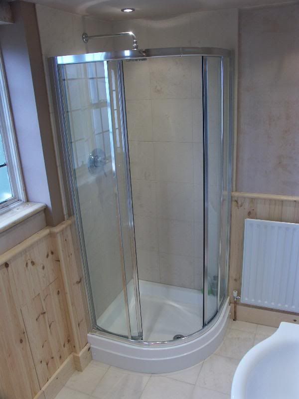

I never used to tile the front of raised shower trays, I always fitted a piece of uPVC flat board which then looked like part of the tray and provided access to the drain in the future if required.
Being white it doesn't look like an afterthought.
Then just fit the skirtings to the wall and don't worry about "skirting" under the tray.
This is one of the last jobs I ever did before I packed up tiling. Actually I did the entire bathroom fit, everything bar the plastering, I could never master that at all.
I know it's a curved tray but it gives you an idea of what I'm trying to describe. The curved board around the front of the tray is flat soffit board from a roofing supplier.
That looks really impressive! Ive just been having a search to find something suitable size wise. Width is about 130mm so looks like i would have to trim something down. Im wondering if that would look messier than tiles, especially with my sawing skills!
Don't try and find something to fit the gap perfectly. I would use plasterboard to pack out the underside of the tray then fit a white upvc board over the front overlapping the bottom edge of the tray. A 150mm deep board would work perfectly.
Then a bead of white silicon along to the top to seal the gap makes it look part of the tray.
I used to fit the upvc with a pair of screws and white screw caps to make it easily removable rather than glue it in position.
It took me a while to understand what you meant but i get it now 🙂 Its a really good idea and sounds like a much simpler and quicker job! This would leave me with just 6 tiles to cut and apply for the rest of the room 🙂 I will have a look for suitable size tomorrow. Im guessing the thinner the better to make it more subtle?
It's generally about 6 to 8mm thick or so. You'll find it at window wholesalers and such like.
