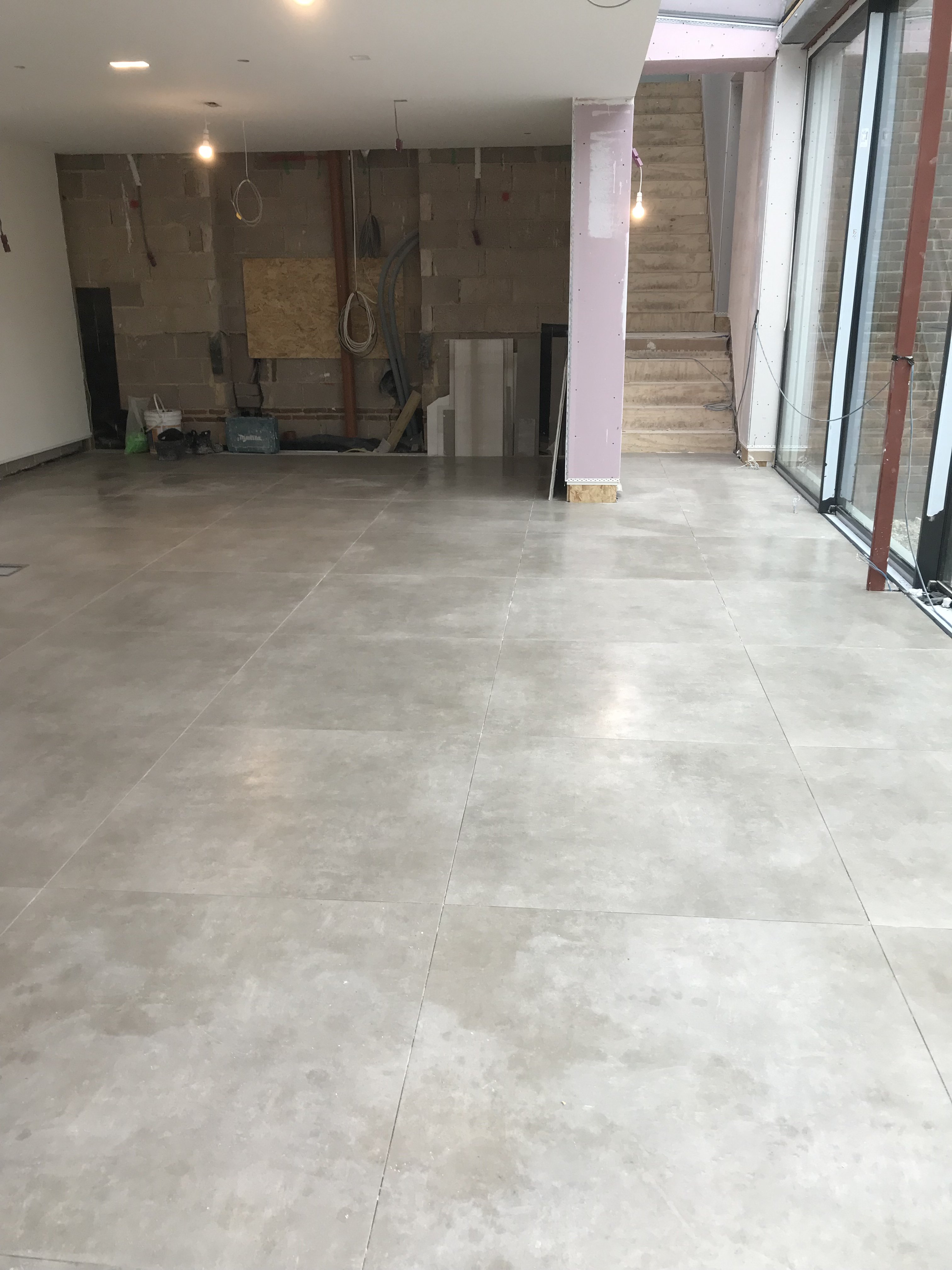

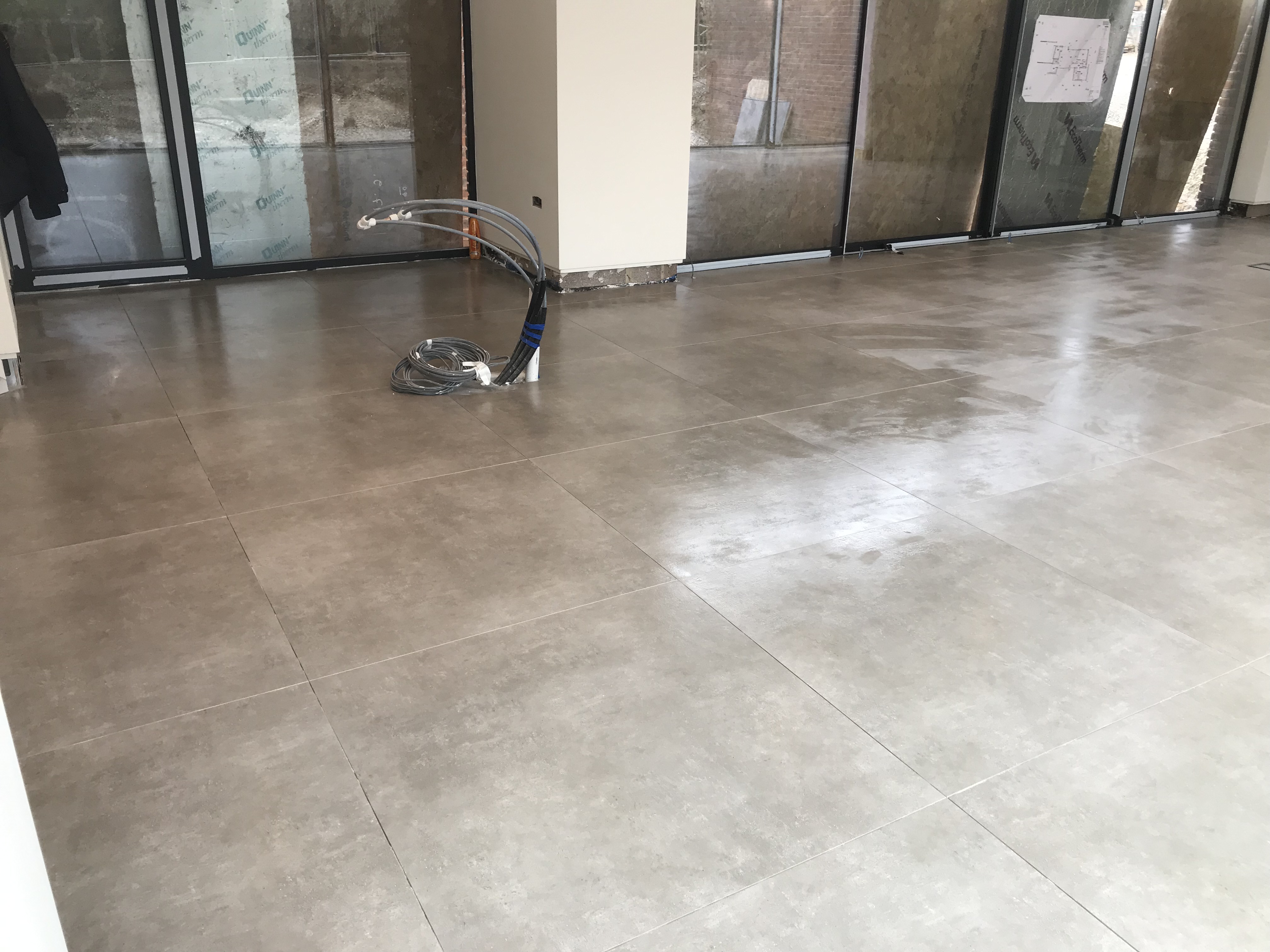

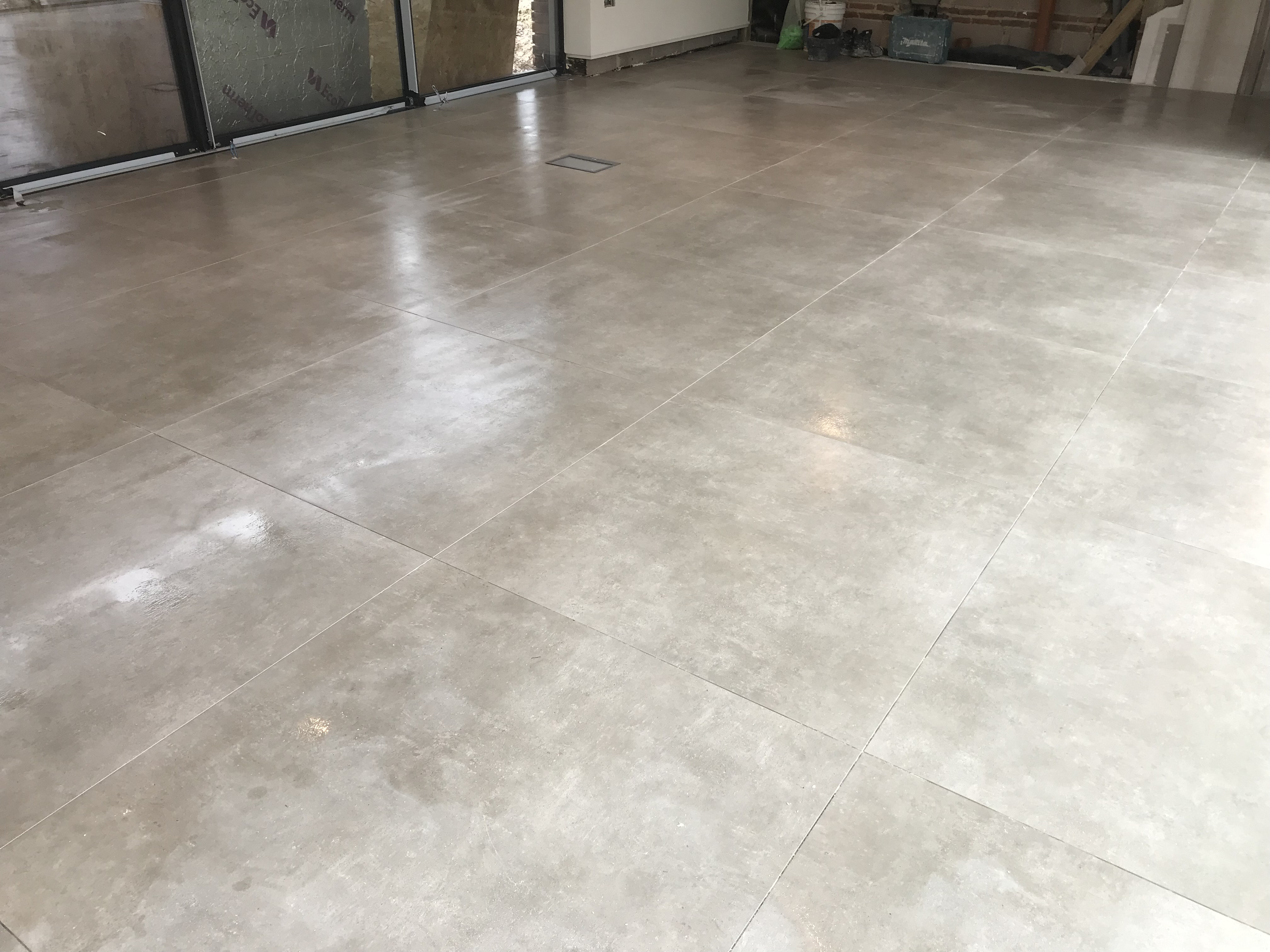

1m x 1m 6mm concrete effect thin tile from uncle Ray.
Installed on to cemfloor liquid s/c screed.

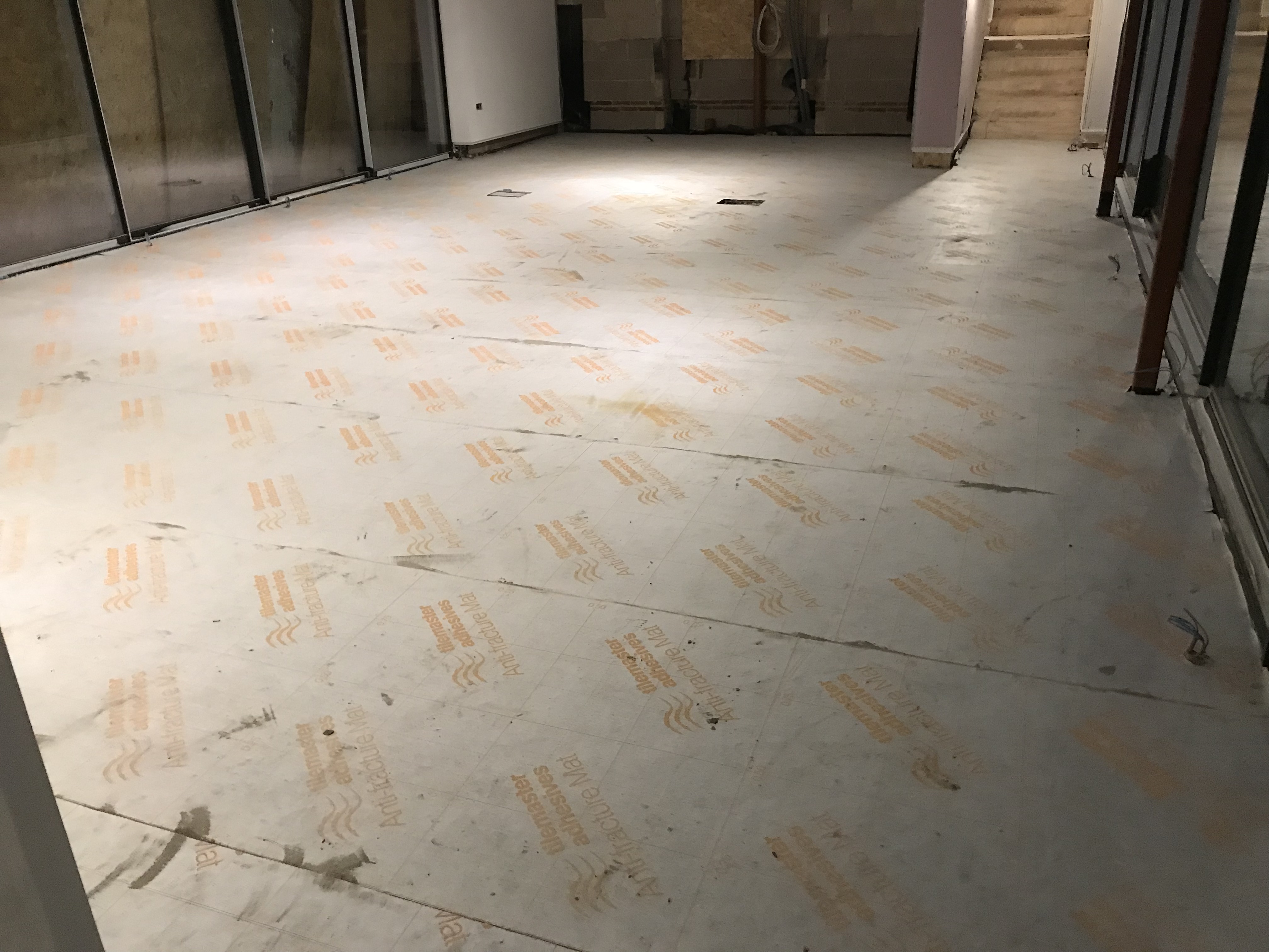

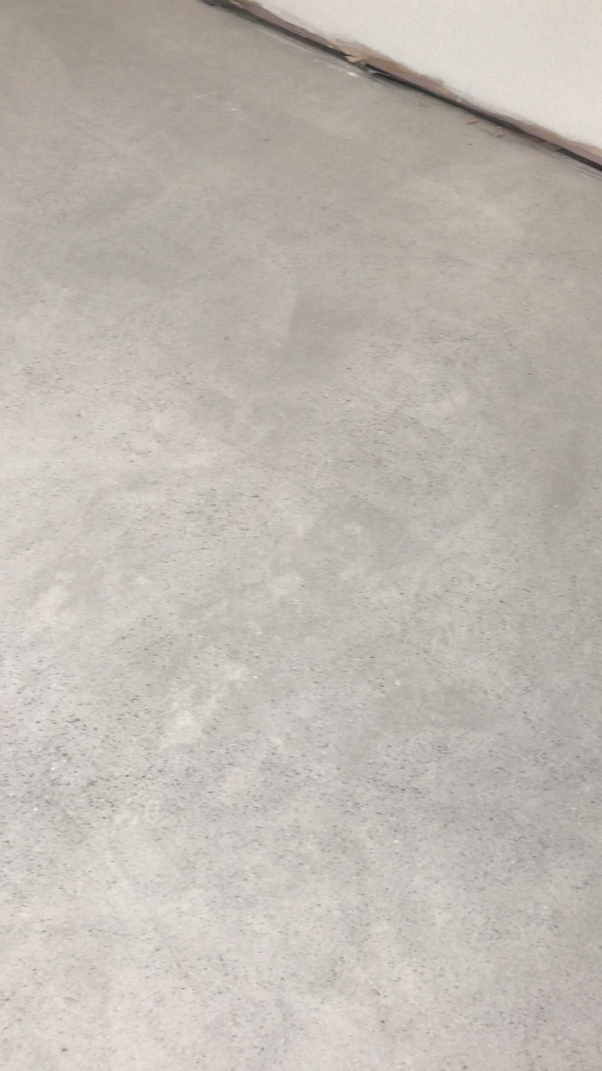

The screed was installed too dry, subsequently not great levels and cracked everywhere.
Floor was sanded even tho they maintain it didn’t need it, judge for yourself!
Cracks opened more to accept epoxy resin repairs.
Tilemaster antifracture mat and tile installed.
Approx 110m2.

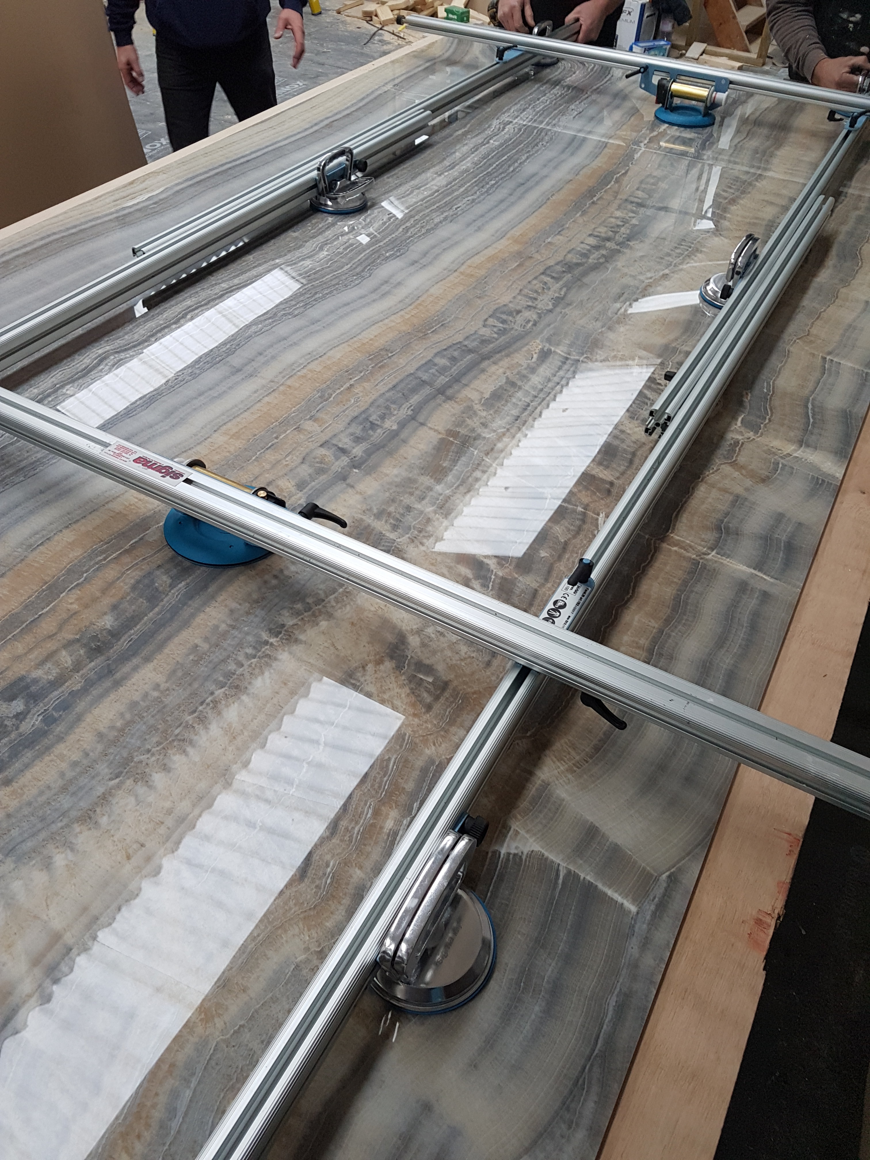

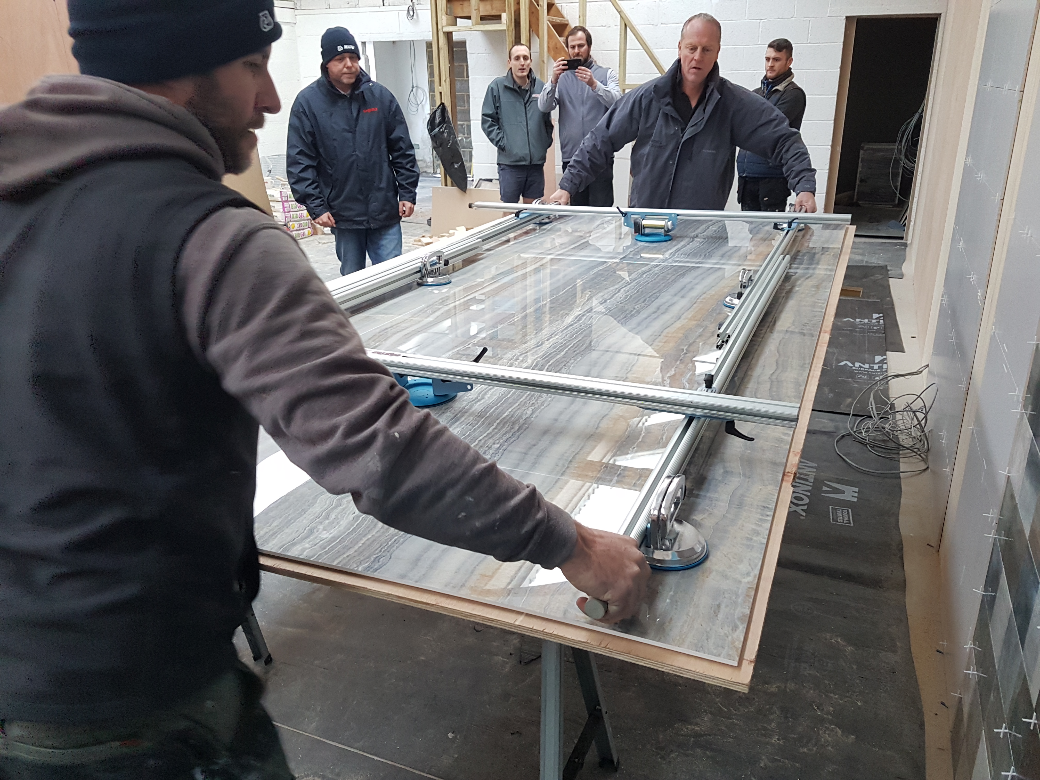

Put up some monster 3m x 1.5m 6mm thin porcelain in Tile Superstores Ringwoo
So how did you actually find working with them Geoff, fabricating and lifting and so on?
I’m always interested in others point of view, not only about the material but how they find working with them.
What do Mapei teach?
I’ve never been to any of their demonstration days.
Any breakages, you can tell us, we won’t tell. 😀
I’m truly interested mate.

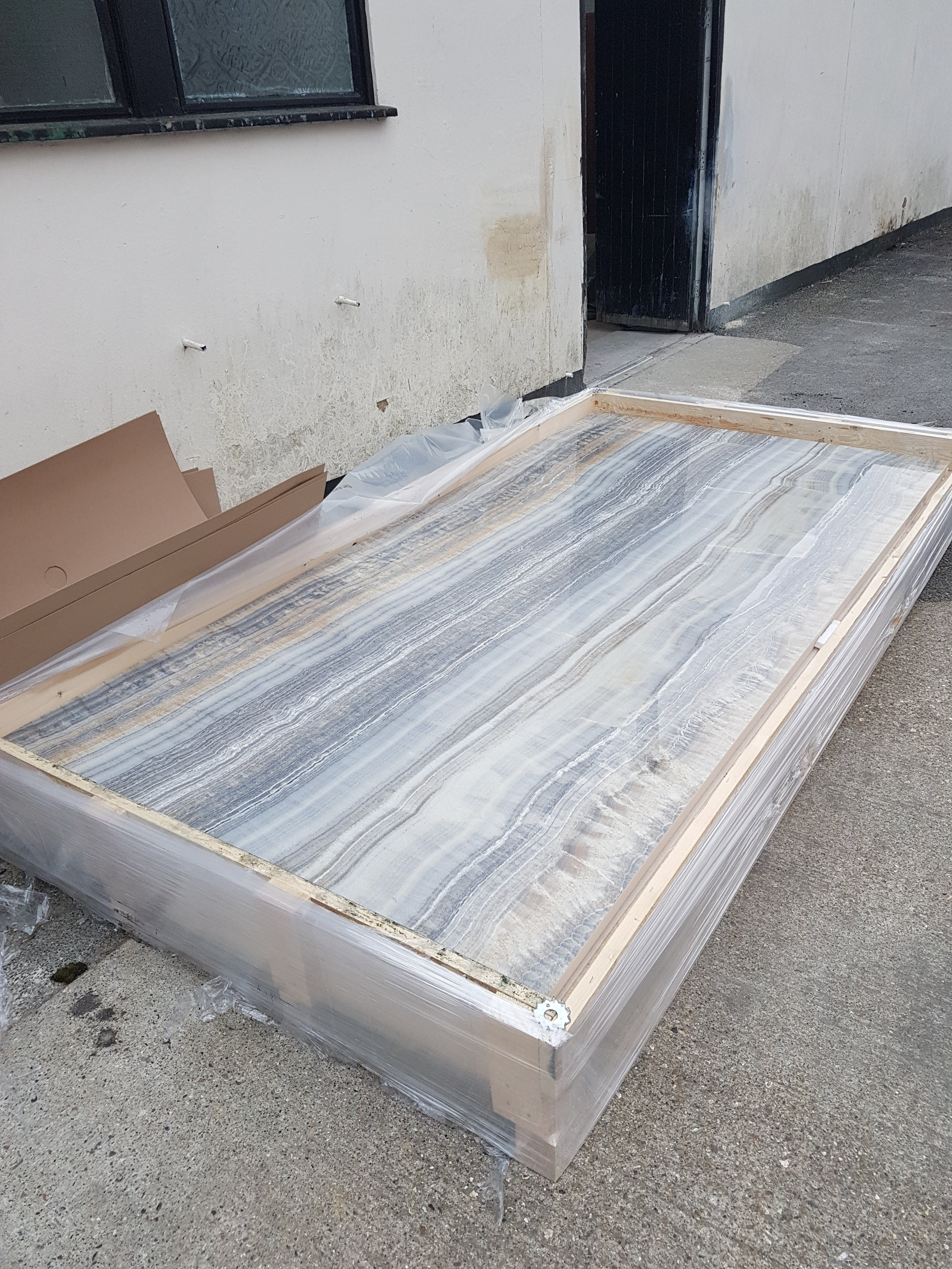

Haha you’re not using the same tile as me are you Mark?
I’m using the Florim Calacatta Gold, 2 sets.
Unfortunately I had to cut a large part of the design off! There’s no internal wrap.
Because I have to have a joint in the centre
Of the diverter.
All the vein on far left of the slab bad to be removed. Easy wrap, crap effect.
