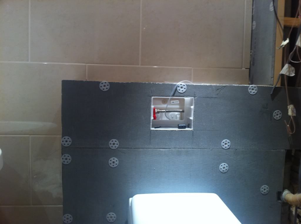

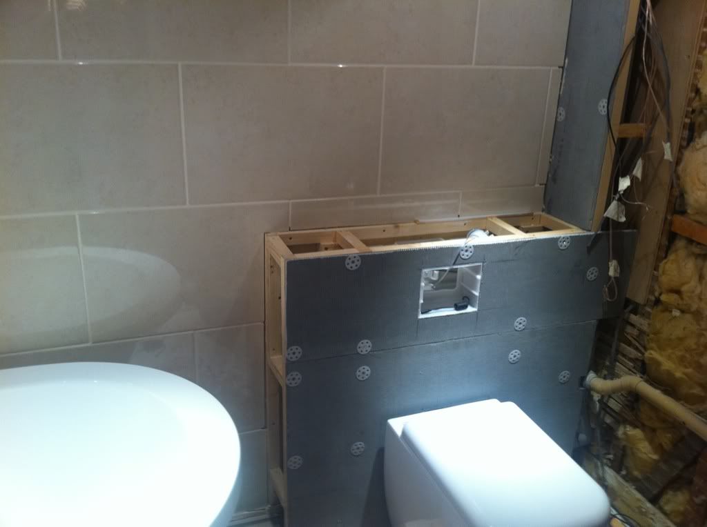

Guys, quick one...
should I continue the brick bond patten on the back of the toilet frame? or should I centralise the flush button and ignore whats going on, on the wall behind?
the top of the boxing in and the left side will be done in mosaic if that helps
heres a few pics of what I mean
I reckon keep the tiles in LINE with the walls.. but doesnt necessarily matter about where the brick patten starts? So to be neat, I should centralise the flush button.. I mean the damn thing will be glowing! so everyones attention will be drawn to it!
I would match the back, so when looking at it from the front, it's like the box isn't there.....

I'd match the back wall, too.
A quick question Dave....what have you overboarded the frame with? Are you confident that the substrate will not "give" when someone sits on the toilet? You don't want any flex and hence tile cracking mate.
Regards,
Daz
frame boarded with 12.5 marmox
how will that affect the substrate when someone sits on the loo?
started 😀
started 😀
Even though the pan is suspended on 2 threaded bars there will still be a force applied to the rear base (where the back of the pan meets tiles). No matter how strong the tiles this will result in pressure on the substrate. IMO, a cement lined polycore board (i.e. Marmox, Wedi etc.) are not strong enough and will compress with the exerted pressure over time.
I hope you don't experience any issues, given that you have commenced tiling, but Marmox is not a substrate that I would have used.
Regards,
Daz
** Just looked at your pics again and it looks as though you are not using a wall hung pan, so ignore everything I said :mad2:
Gotcha, im sure it will all be fine :thumbsup:
Edit, nope its floor mounted and just a concealed grohe cistern!
I see what you mean now if you thought it was suspended! hahah, yes I would never suspend the loo off this thin frame / marmox :lol:
