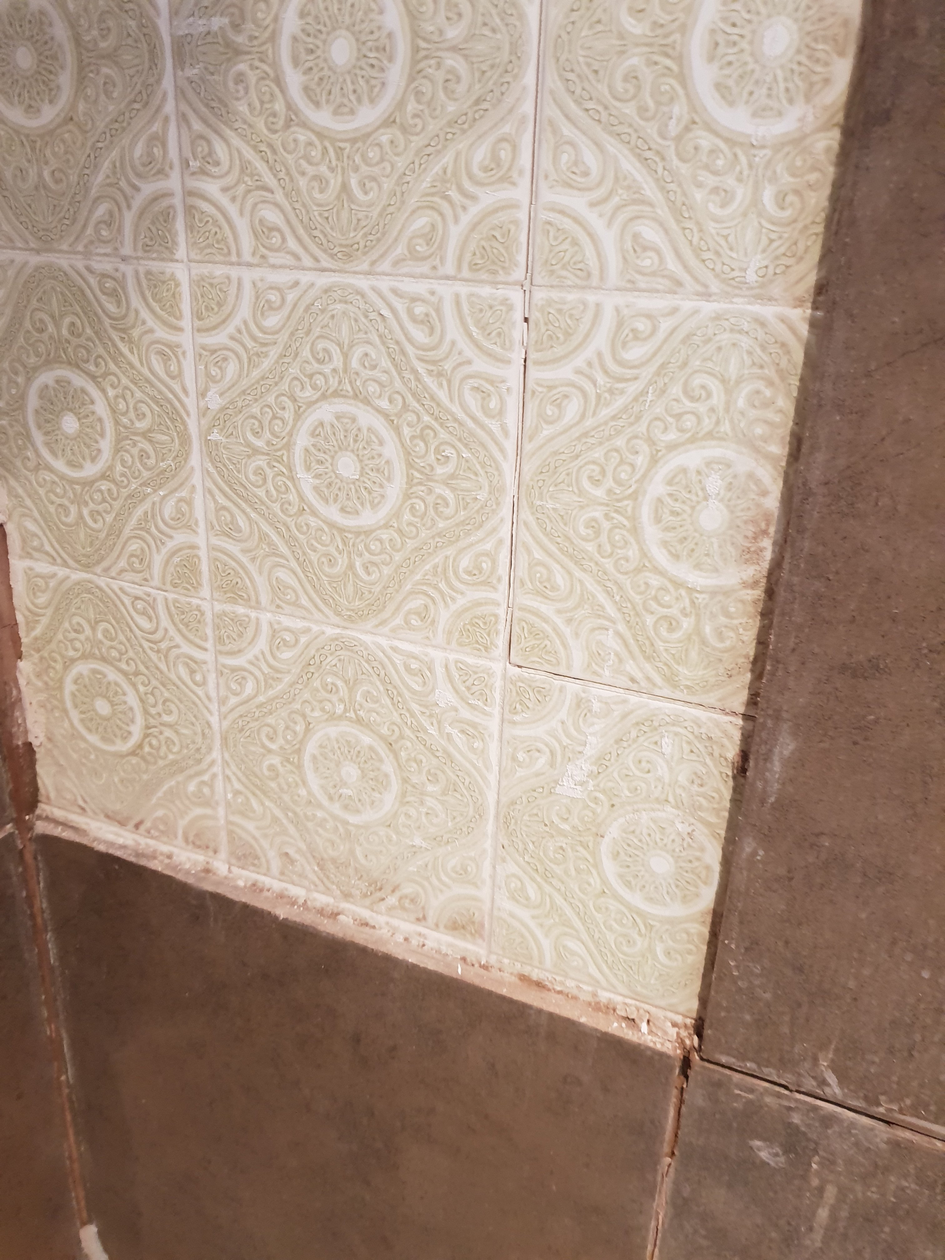

Depends what’s caused the crack. Sometimes they occur when extensions or alternations are done or subsidence.
Provided there is no further movement, I would dot and dab either plasterboard or tile backer board. Depending on weight of tiles.
I'd be chiseling out those cracks and repointing, don't want them ringing me back with cracked tiles.
If the they used thermalite blocks for the extension about as much use as an ashtray on a motorbike for tiling on.
As already recommended dry wall would be the best option.
