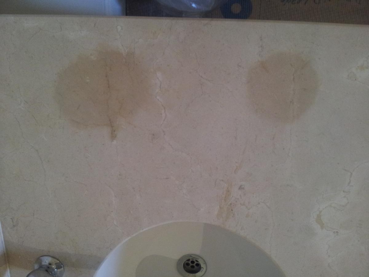

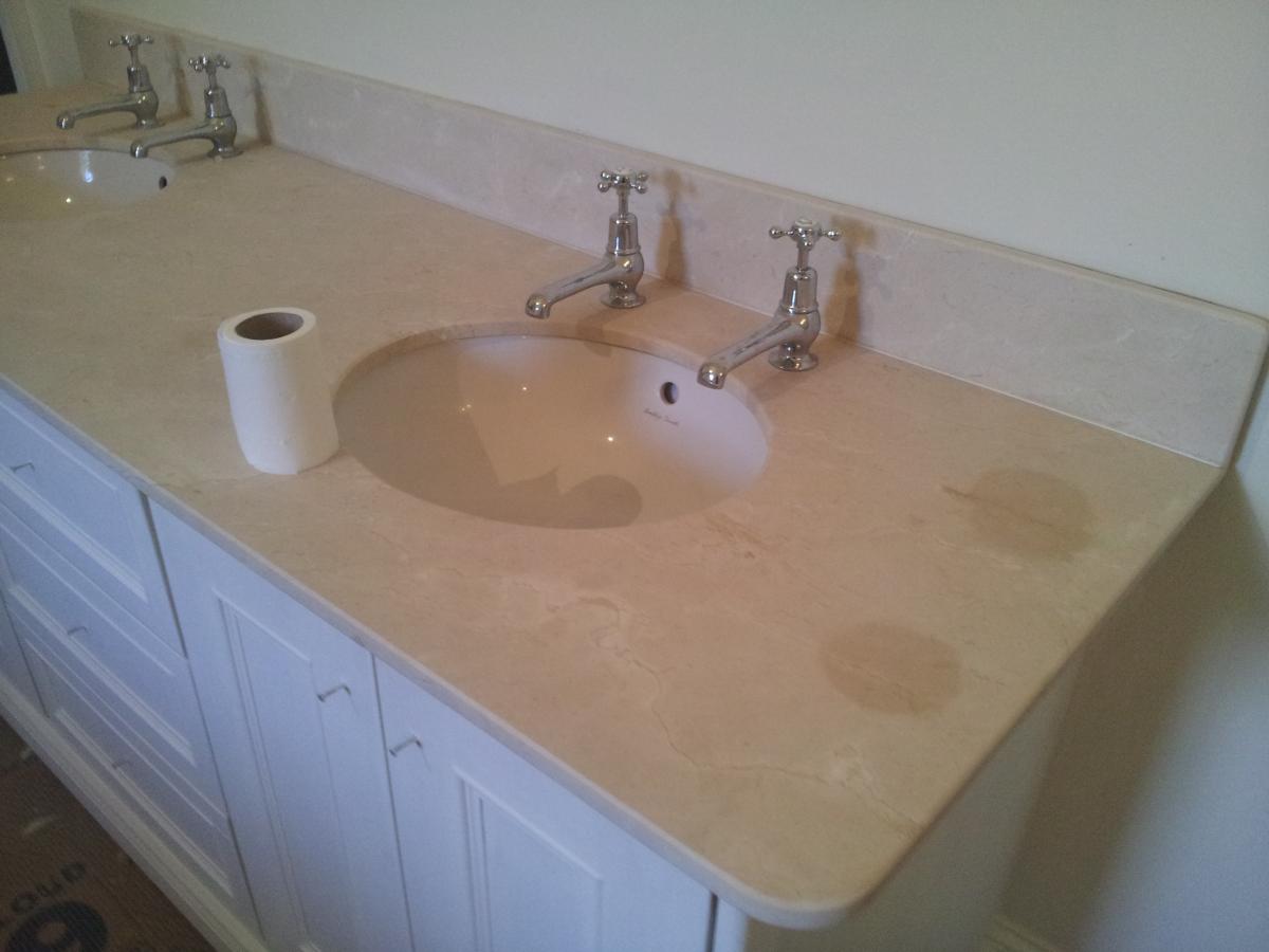

Can these stains be removed or is buggered!
Looks like it hasn't been sealed after the plumber fitted the vanity unit top and has been stained. Don't know what has stained it,wether it was something the plumber laid on it or something the lady of the house has placed on it?

That's crema marfil by the looks of it.
You'll need a poultice on there to draw out whatever has soaked in.
yep, fullers earth would be my first try. 😉

Today's update..........Fullers Earth didn't work,so after speaking to LTP we progressed to Grimex. Started at 1:1 with water and then neat Grimex.....still no better.So back on the phone to the very helpful lady at LTP and await a call from the head honcho.
Meanwhile after a bit of digging.....I found out the stone was originally delivered as polished.....the lady of the house didn't like it and was sent back to the suppliers and returned to the job in a honed finish and fitted by the joiner/plumber, and apparently all manner of items were placed on it before I got there.
So could the honing process have removed enough mm to remove the sealer?(assuming it was delivered sealed)

Can I just post something here, I had a similar problem with a limestone vanity, and it turned out to be the glue the joiners had used, it had a small amount of oil in it and the stone started drawing the oils out. I think this could be the problem.

Hi Pebbs, I can see where your coming from with this one. The marks are only in these two round areas and not any where else ie not in straight lines similar to the wooden carcase. The stain has penetrated from the top,as there is no staining visible from underneath,but that's not to say the joiner didn't leave his tub of glue on the top though!

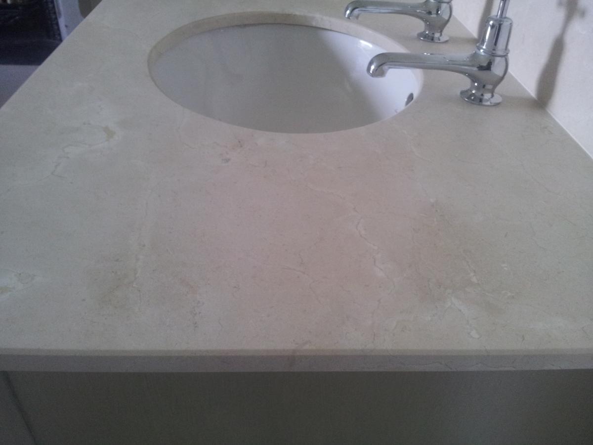

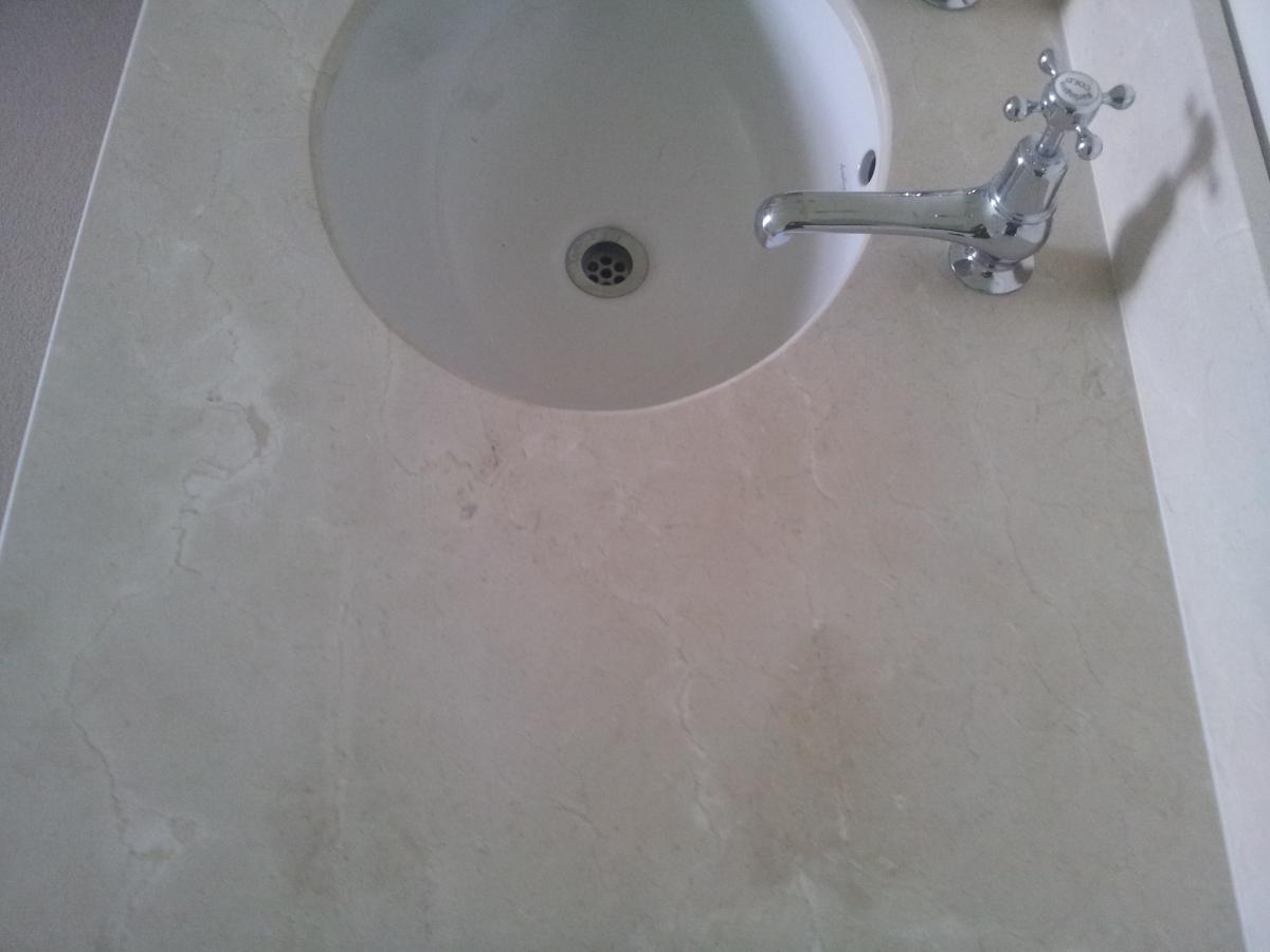

Hi All. Just update this thread. The stains below are nearly all removed,not a 100% but a marked improvement,that the customer is happy with. LTP Grimex failed to do the trick,but 3 treatments of LTP Stain and Spot remover with Fullers Earth sprinkled over the top and covered with plastic gradually improved the vanity top.
