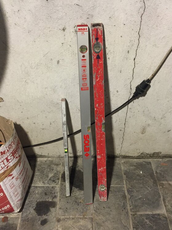

Levels !!!! Best And Worst ?

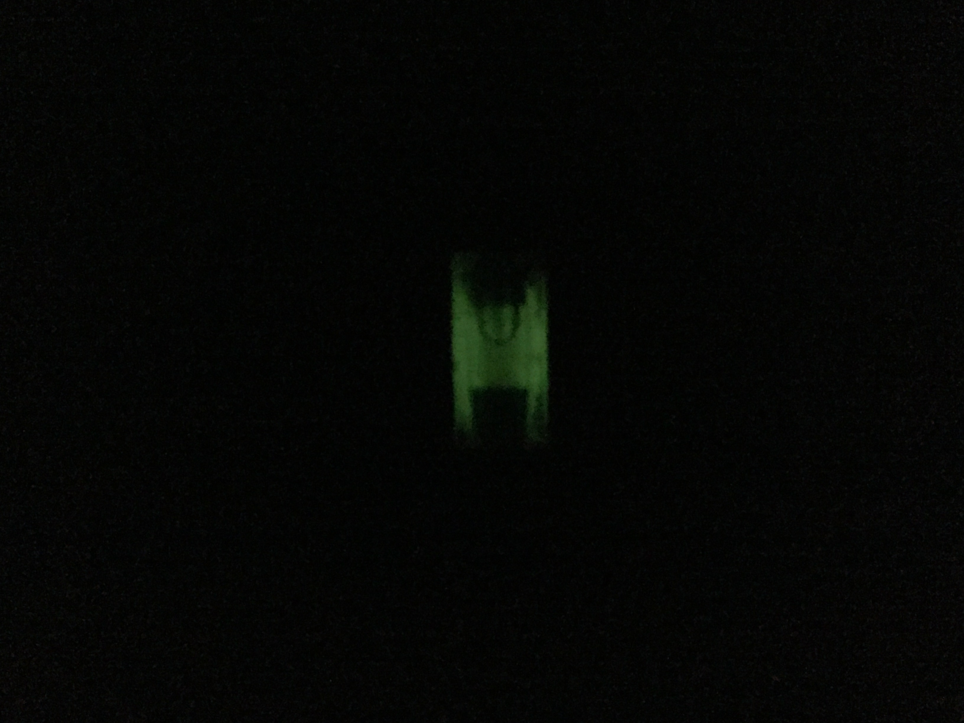

My collection SOLA ,SOLA you see in the dark
the word SOLA in parts Italian, a meaning
SOLA= one counterfeit product
or,SOLA= take a rip OFF.
ahhahah

[QUOTE = "Andy Allen, posta: 799.147, membro: 19139"] Antonio costruita che con la sua sola levels..lol [/ QUOTE]
with SOLA I cando better 😉
