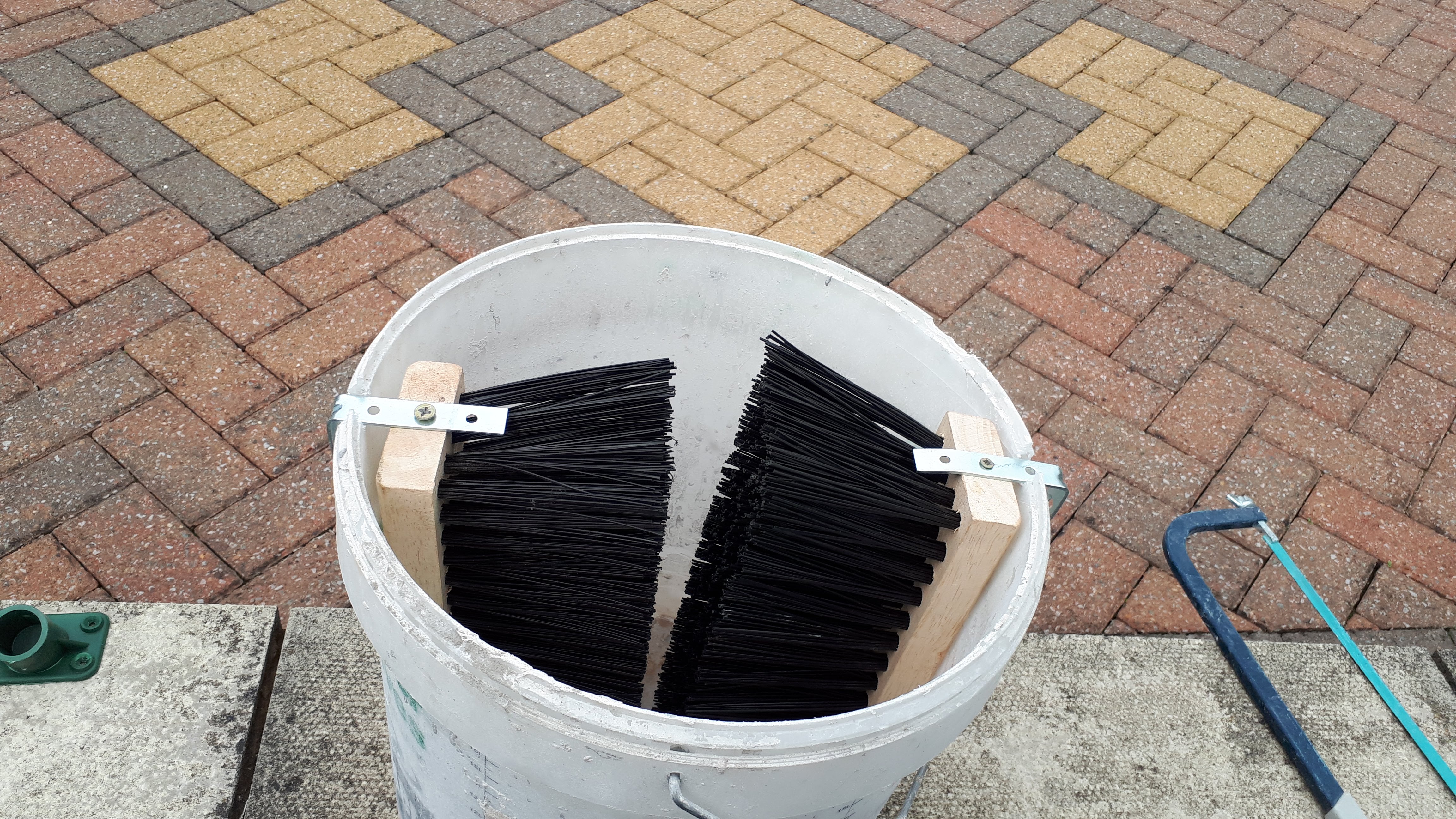

It's not the rinsing. It's when you pull it out of the adhesive I like to spin off the excess before it goes in the washing bucket which I can't a the bucket is pretty full of adhesive
Yes I did
I put an empty black builders bag in an empty plasterers bucket and put a couple of tile cuts at bottom to weigh it down then after mixing adhesive to the brim (know what you mean) I spin in there full speed first before washing whisk just find it’s quicker to clean that way
