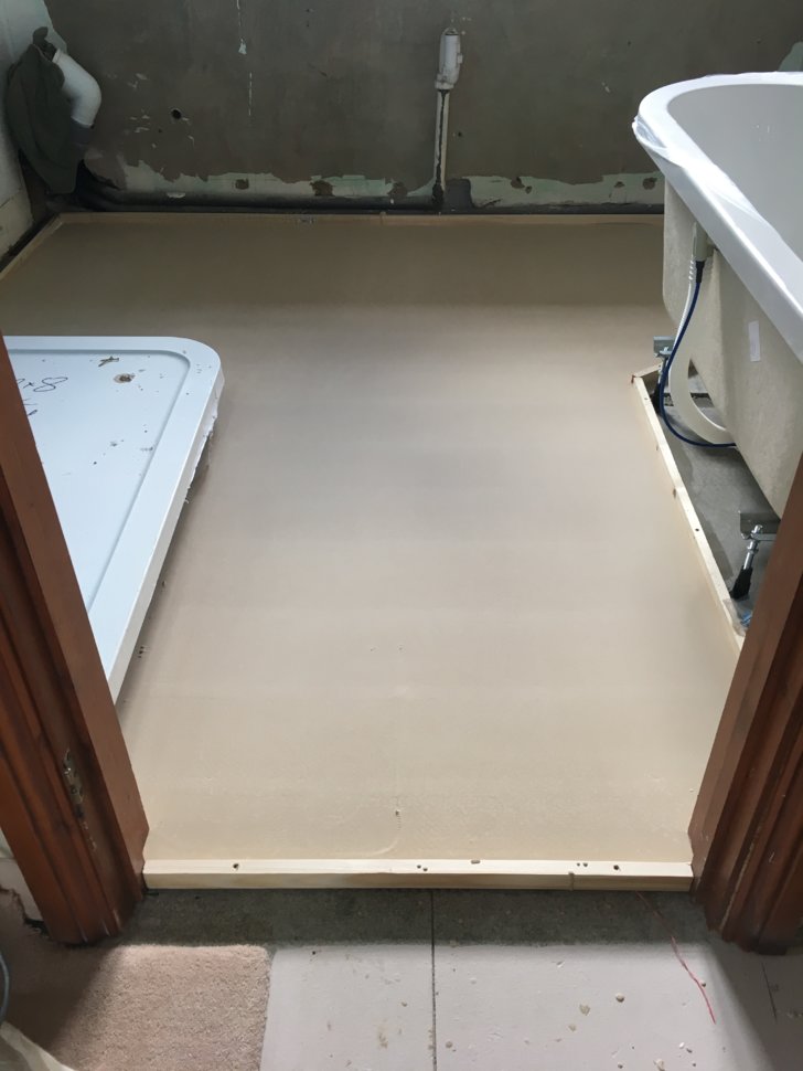

The tiling doesn’t look too bad, but his prep is terrible and his finishing could of worked wonders to the eye.
The trims can be sorted by taking all the top course off.
Usually floors we get flat as level sometimes can’t be achieved due to certain factors.
Does it run down to the door, if you level it, especially with EUFH ,could you have a few inch step at the threshold , sometimes a big step looks awful and a few mm gap under a unit looks better.
Your property is probably over a hundred years old, and a level was ‘rack of the eye’ in those days 🙂
Saying all that, it’s not a brilliant job
Thanks for the message. We are having the family bathroom done at the moment by new fitters. The floor was 16mm out and they have totally levelled it by ripping it all up and basically re-doing it. The walls are also being sorted with plasterboard. Such a thorough job by comparison. We also discovered last night that this has happened....this radiator has been on the walll less than a week.
