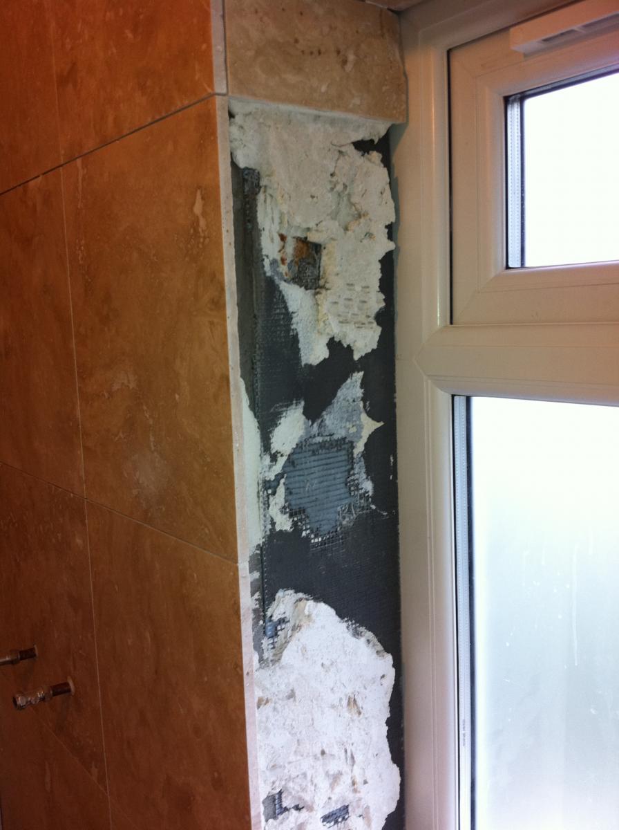

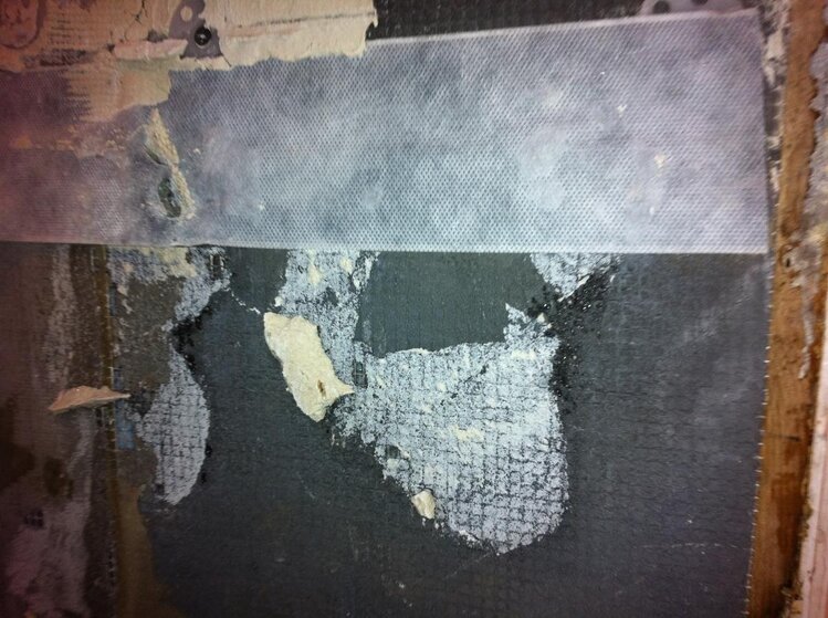

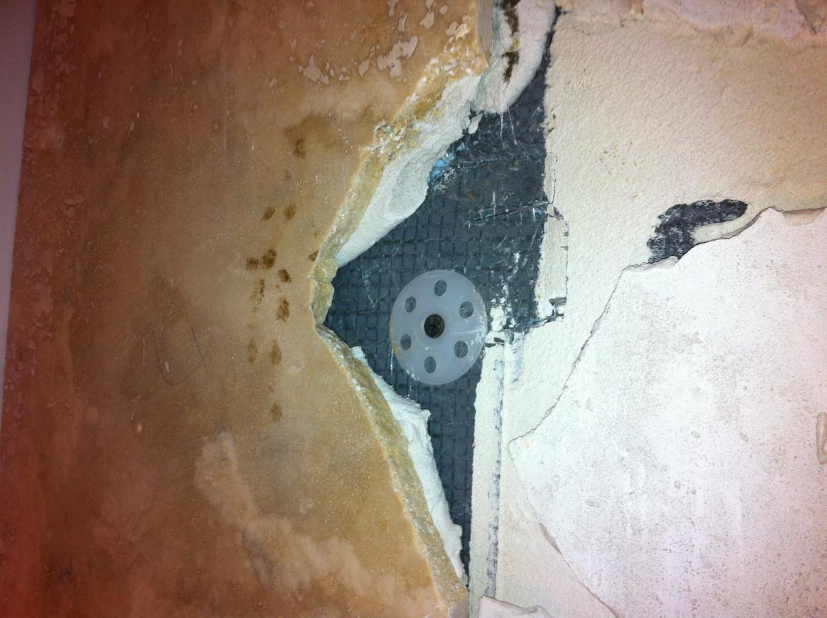

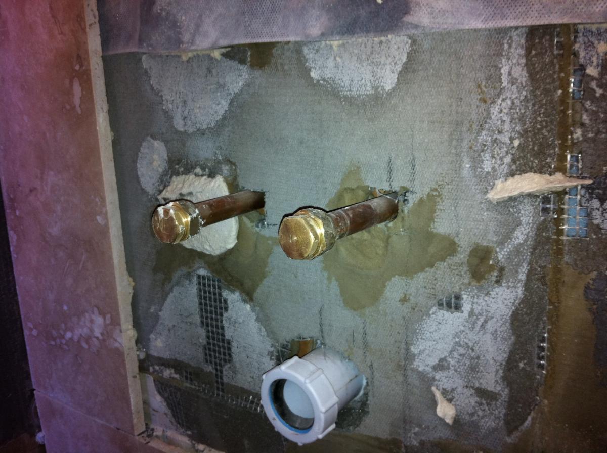

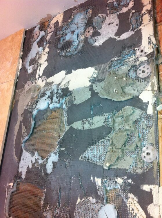

The situation today is that the bathroom contractor began removing the tiles and Marmox: revealing the extent of the dot and dabbing behind. It is disturbing.
However, the contractor has decided that all is well simply because the tiles are difficult to remove. He is refusing to take down any more, saying he's now convinced everything is safe and sound. This response contradicts the views of the various bodies and experts I've consulted, as well as the views expressed here.
Below are pictures of what was found behind the tiles. You can see the light grey and dark grey of the Marmox is untouched by adhesive in many places.
Your thoughts are welcome.
i am sorry but that job is as bad as it gets every thing that can be done wrong is in your bathroom. now i would be questioning the integrity of the bathroom contractor if they are willing to leave you with a job that is substandard.*
If that is what we can see after the tiles have been removed, the rest won't get any better...
As mentioned above .if the adh manufacture wont give a guarantee with the way their product has been used on your job that says it all .best to remove and redo
