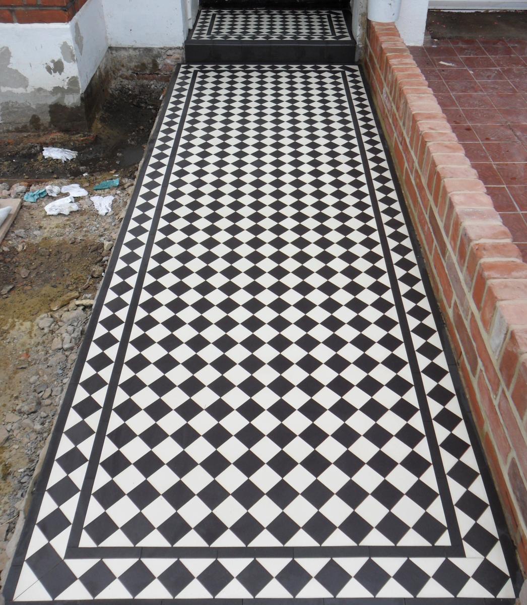

Cheers Phill,I must say there was a good few hours head scratching before I began.But I will deffo do that in my next one.
how would you 'pull' the tile phil? i tried working it out with no success. it looks like the only way to avoid the double header is to extend the width of the path by a full tile? nice work by the way, bang tidyNice job mate, just one question, the double header on the front left could be avoided. On a long run you can pull a lot, in short runs sometimes you can not do anything else. But if you have enough length on a border you can pull loads, just a little constructive criticism. Still nice work
