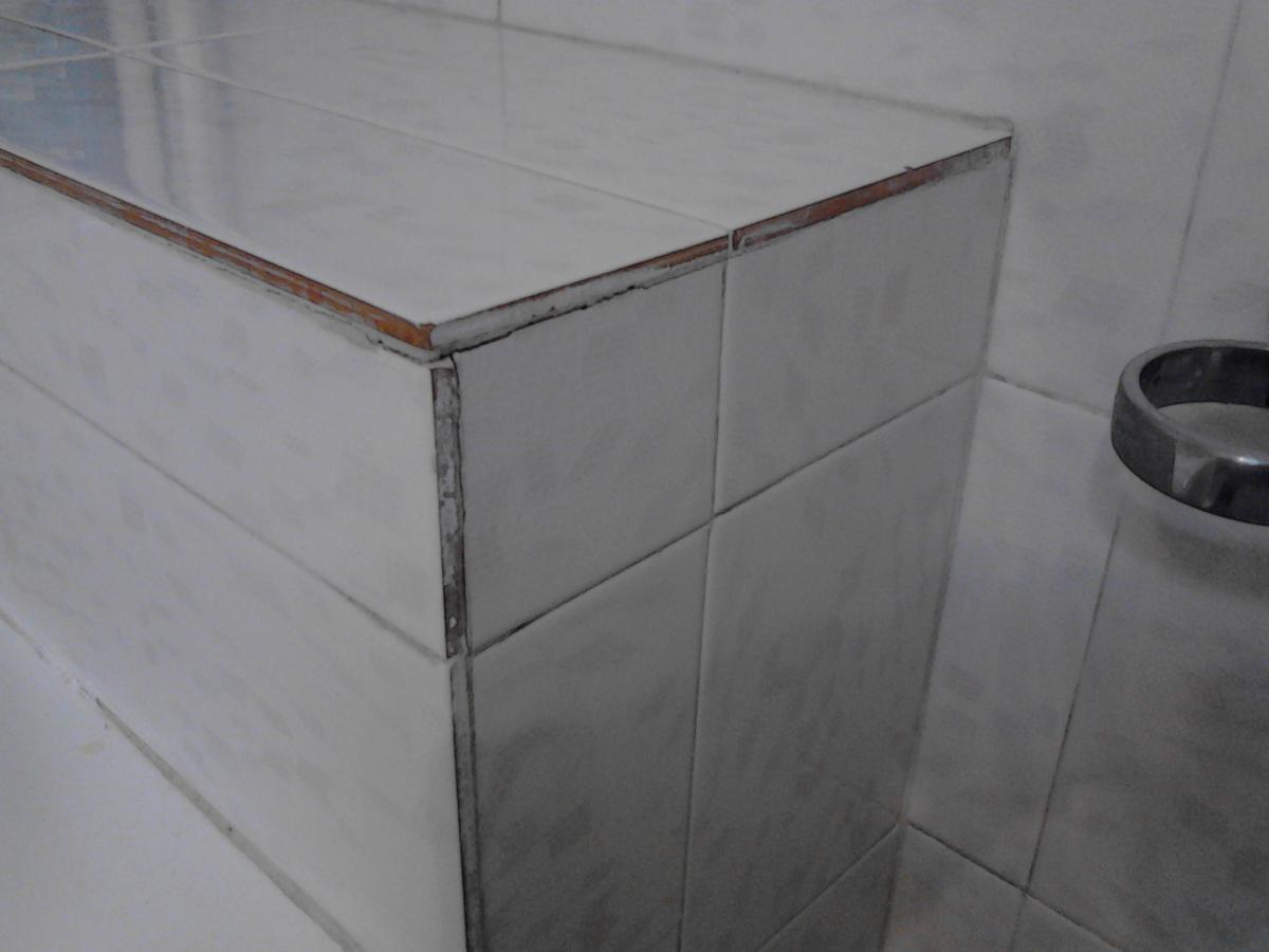

marioscs
White Room
Hi and welcome......looks like it may lift off quite easily, if it does clean the tiles and re-stick.
marioscs
Ok thanks for the answers.It may seem ready to fell off but its pretty stabilized.It barely can be moved if i apply pressure and only on the edge?I dont think i can get if off easy.If i clean the grout and apply some new will it be ok?
White Room
You can only but try and see how it goes, try using a good grout that may allow you some flexibility.
Gazzer
I hate to say it but I would be inclined to cover the edges with some plastic L shaped trim. Regrouting may work but will not hide the tile edge.
marioscs
Ok i will try to regrout it and i will post pictures again.Also i will renovate the bathroom soon there are other problems also but i want a fix until then so that it doesnt look so ugly.
marioscs
Ok here is what it looks like after regrouting.What do you think?And after how long should i apply silicone?Thanks a lot for the help.
