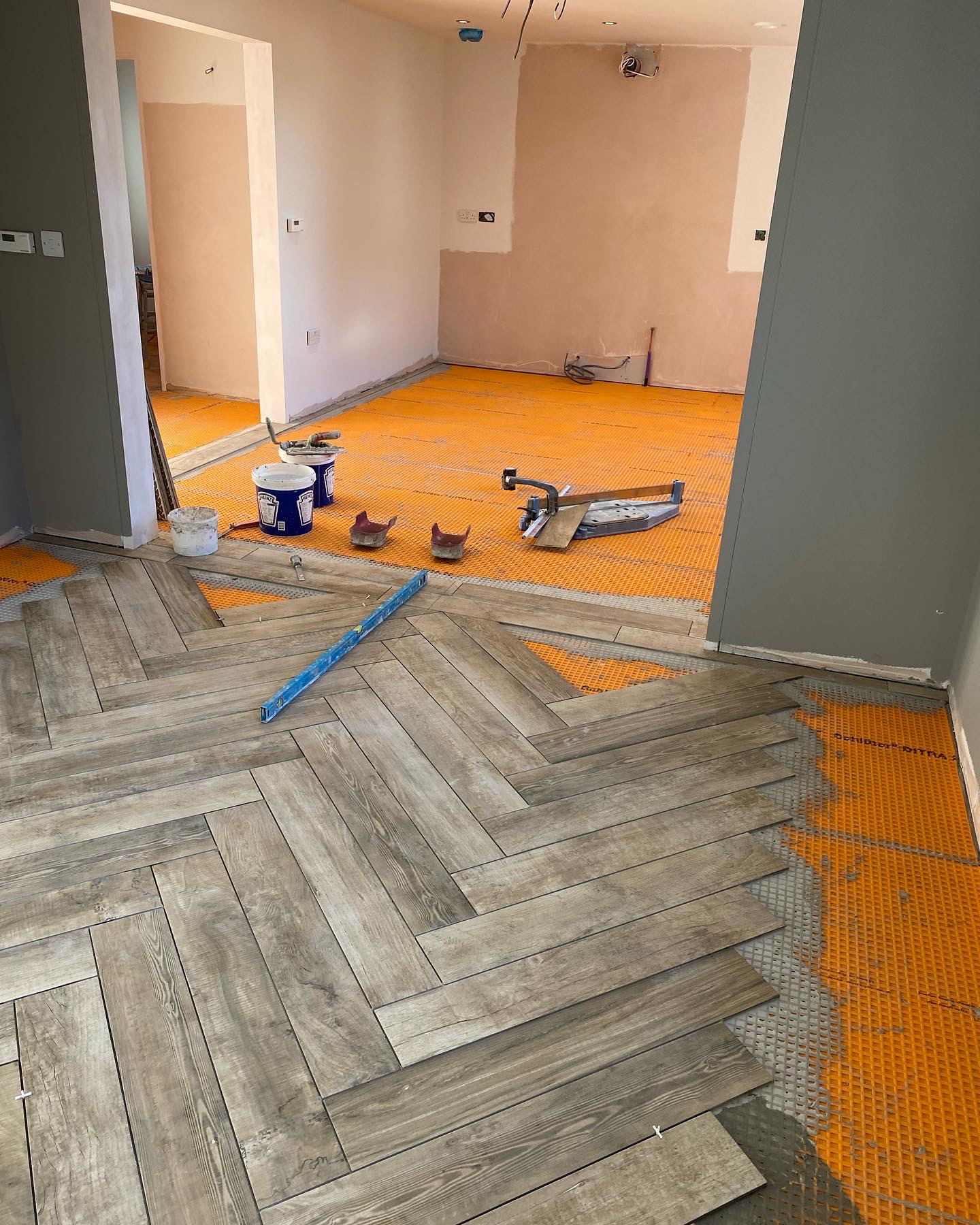

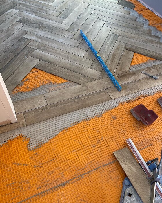

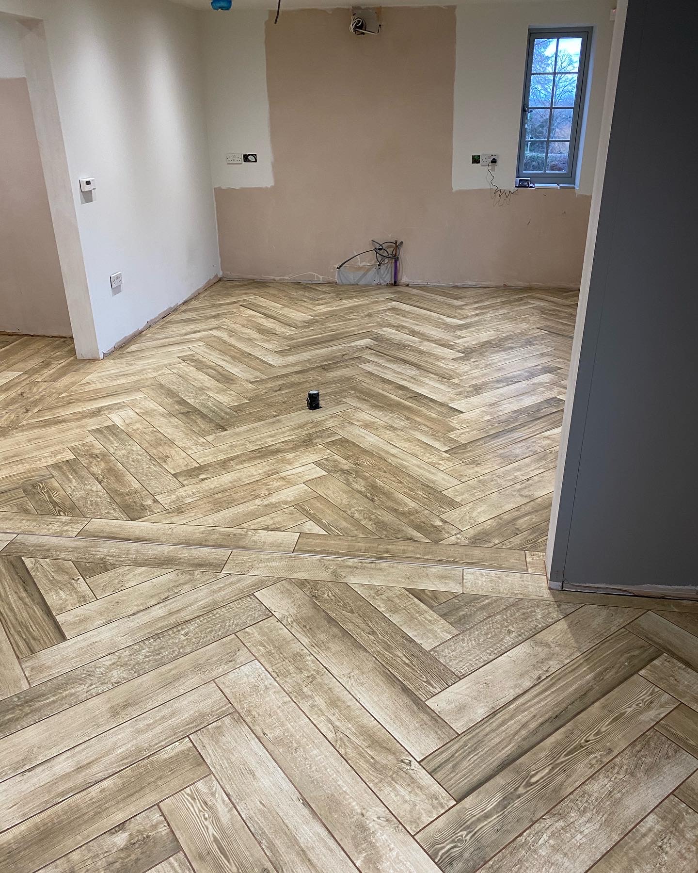

Ok. Which way are you laying the planks ?
I’ve just done one with 2 heated zones and incorporated an expansion joint as a feature as suggested by the customer/builder.
The problem you have is the different rates of expansion between the two substrates and the point of deflection where Timber meets Screed.

That's a really nice floor that is mate.
