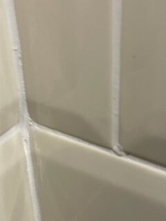

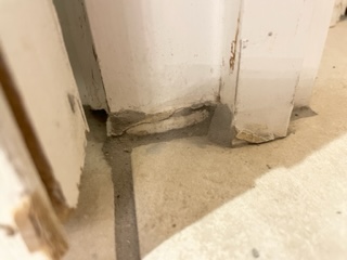

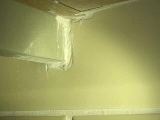

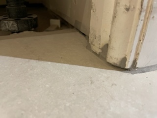

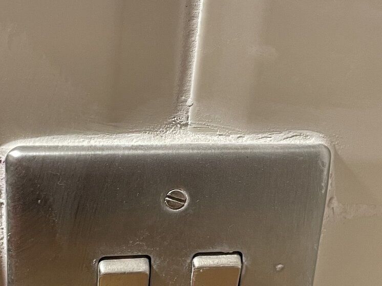

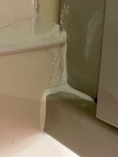

Thoughts on quality of this tiling?
This isn’t my timing but a professional installation.

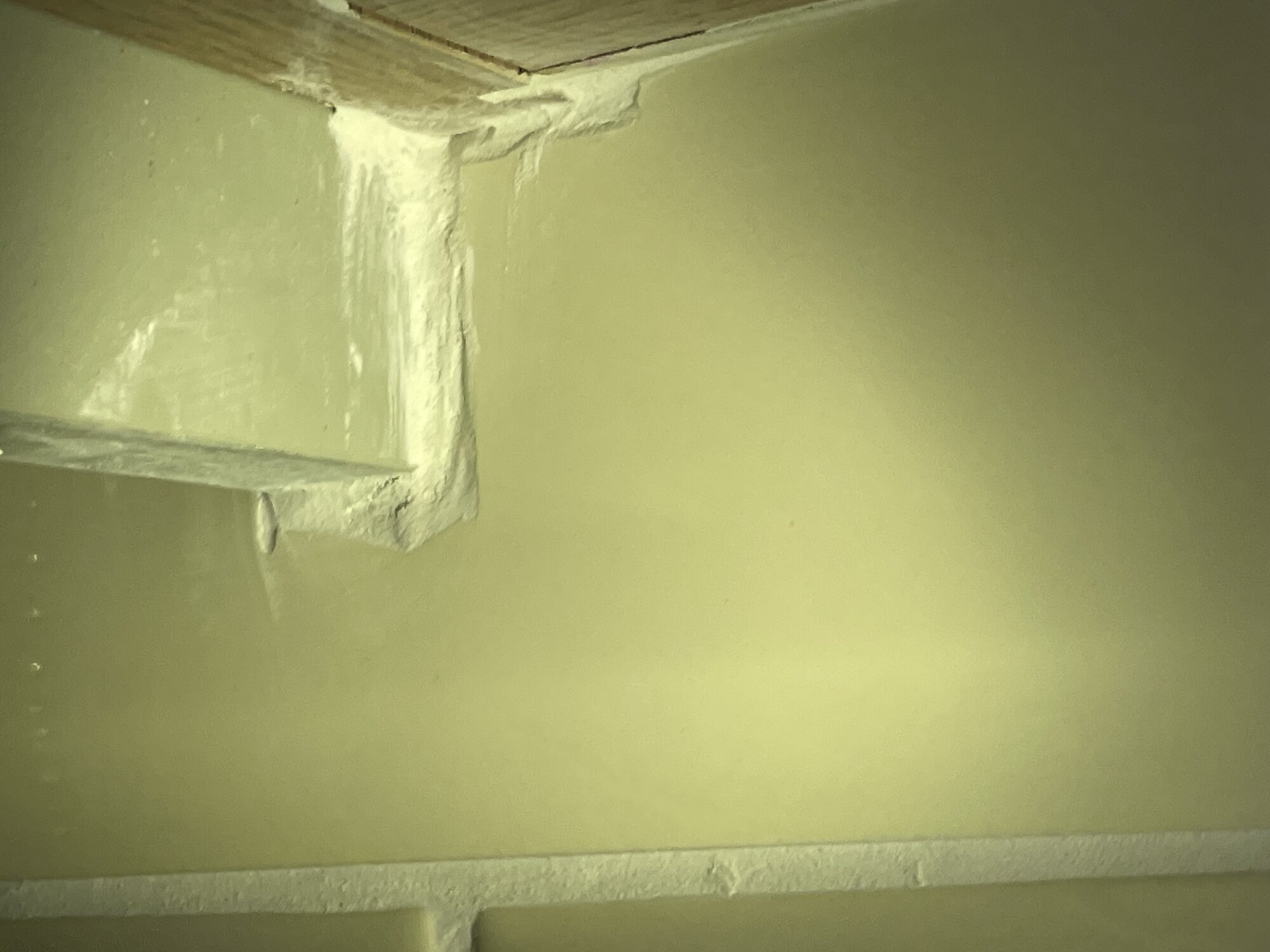

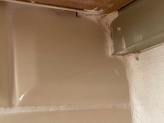

I’ve cherry picked the worst parts, but I’d love a view if this is acceptable or not? The wall tiles overall look pretty even, but up close some areas look like they have a poor finish, and in some cases the grout looks rough.

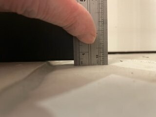

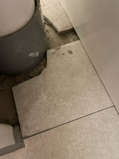

On the floor it’s pretty even, but some times have lippage up to 5mm, and some of the finish doesn’t look great.
What does the forum think? Is this OK (I.e. not great but minor finish issues) or is it something I should kick up a fuss about? 4037313D-1CF9-475E-9ED0-325823C55F66.jpegCF64CDE2-8388-4800-98A3-5A65EED118D8.jpegIMG_8727.jpgIMG_8741.jpgIMG_8747.jpgIMG_8723.jpgIMG_8698.jpgIMG_8721.jpgIMG_8732.jpgIMG_8743.jpgIMG_8733.jpgIMG_8746.jpgCF64CDE2-8388-4800-98A3-5A65EED118D8.jpeg

Im with Jimbob! That's really rough and looks like a rushed job to me. Would be good to see a couple of pics of the job overall mind you and not just those up close shots.
