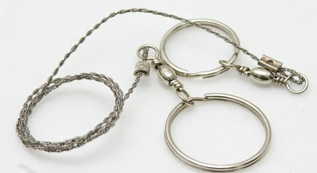

Have come across this in the past, where mirror has been silicones or similar onto tiles, have used hardpoint saw to cut through Silicon/ adhesive to separate. Good luck.!
We actually still fit mirrors in new builds and the glue they will have used will be mirror mastic trust me that will never let go! the only real way to get it off the wall will be as said above. Roll and stroll the glass then get some long sleeves on hammer and chisel and just slowly break it away. Unfortunately to date we haven't come across an easier method, we have tried wire saws but they tended to take way to long.
