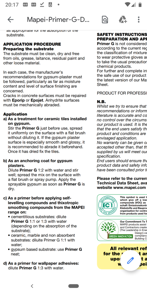

More than enough I would say directions posted below .

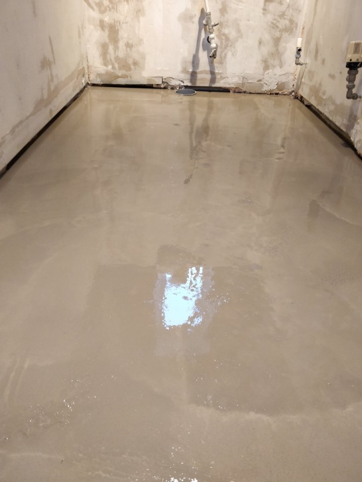

Thank you for everyone who's helped me so far. Just an update for you. I've just poured my self leveling compound. The majority of the floor has about 4mm, but as you can see there are a few high spots where obviously the level is below the minimum of 3mm recommended by mapei. Shouldn't matter though should it? Because its only in a few small patches.
