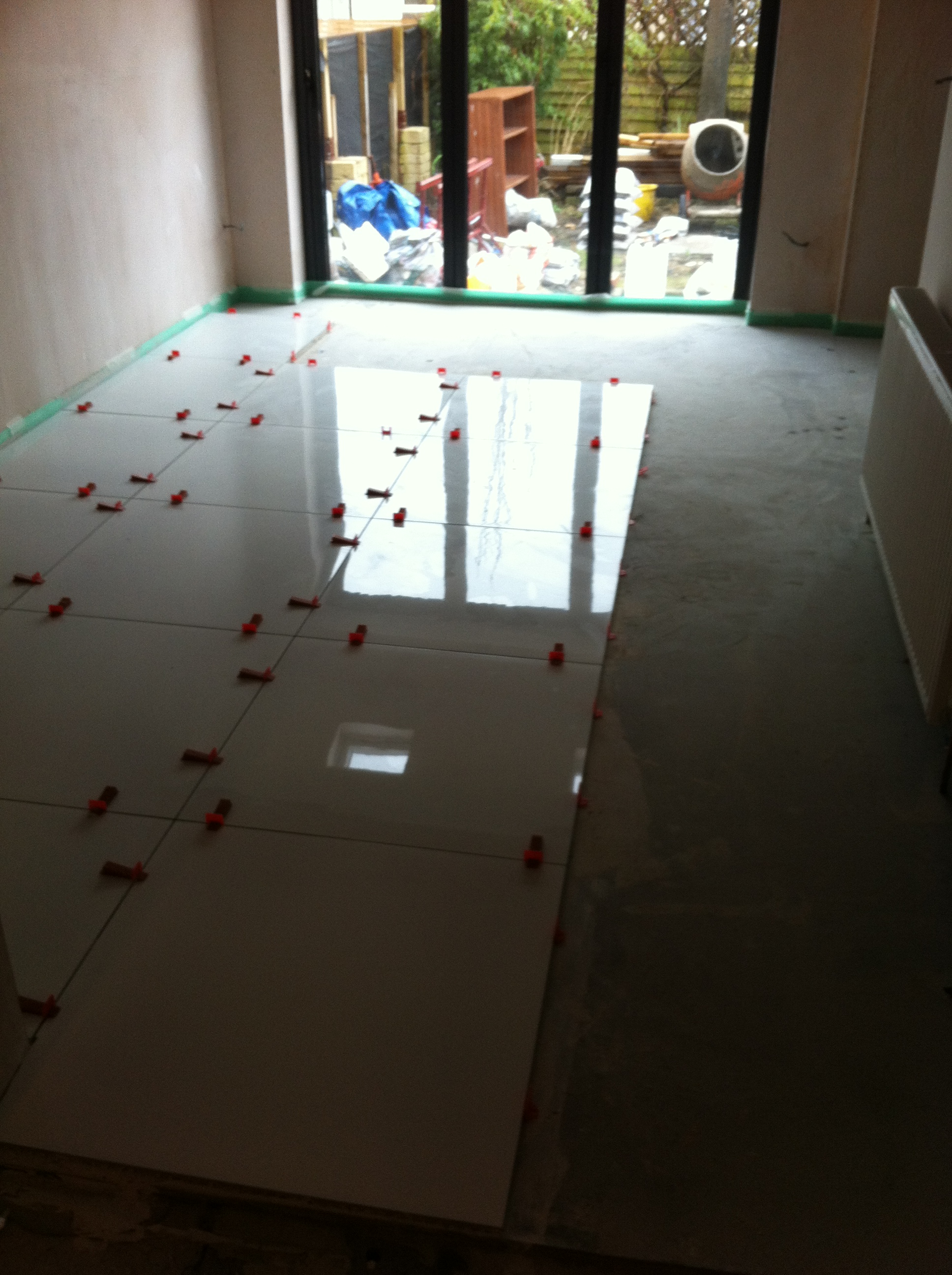

Op, please post more pics of where your at now. I know it wont be much but id like to see how your gettingon. Dont worry if youve not did it exactly how these pros do it because thats not what we expect. I hve confidence in you that this will be a decent enough finish.
Hi Average,
Here's where I am at, I started from the third row on the right working my way to the bifolds, then moved along to the wall, on the left are the cuts, and the 4th row that's due to go on the right will be full sized tile.

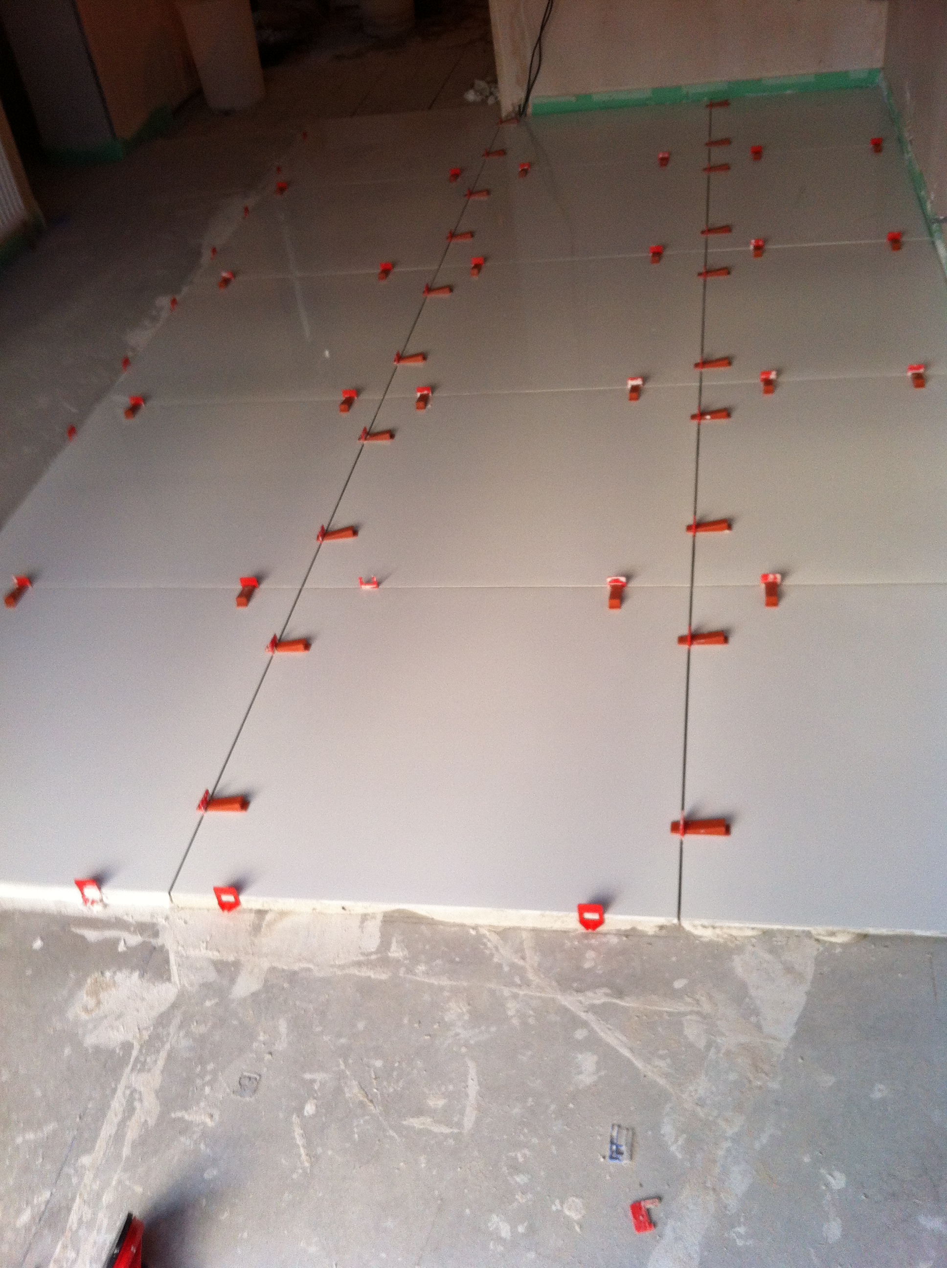

no I've just been pushing in by hand, maybe you'd like to supply me some free of charge for demonstrating your system as this thread has almost 9,000 views!
thanks, there's been plenty of obstacles and I'm sure there's much more to come so I'm not counting my chickens just yet, but I believe the amount of effort I've put in to ensure they line up and avoid lips by measuring with level, adjusting, even taking certain tiles up 3 times to adjust the bed of adhesive has resulted in a good finish so far.
yeh it's a thick coverage

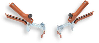

large sizes, it would be useful to use the pliers, otherwise rls, become almost useless.

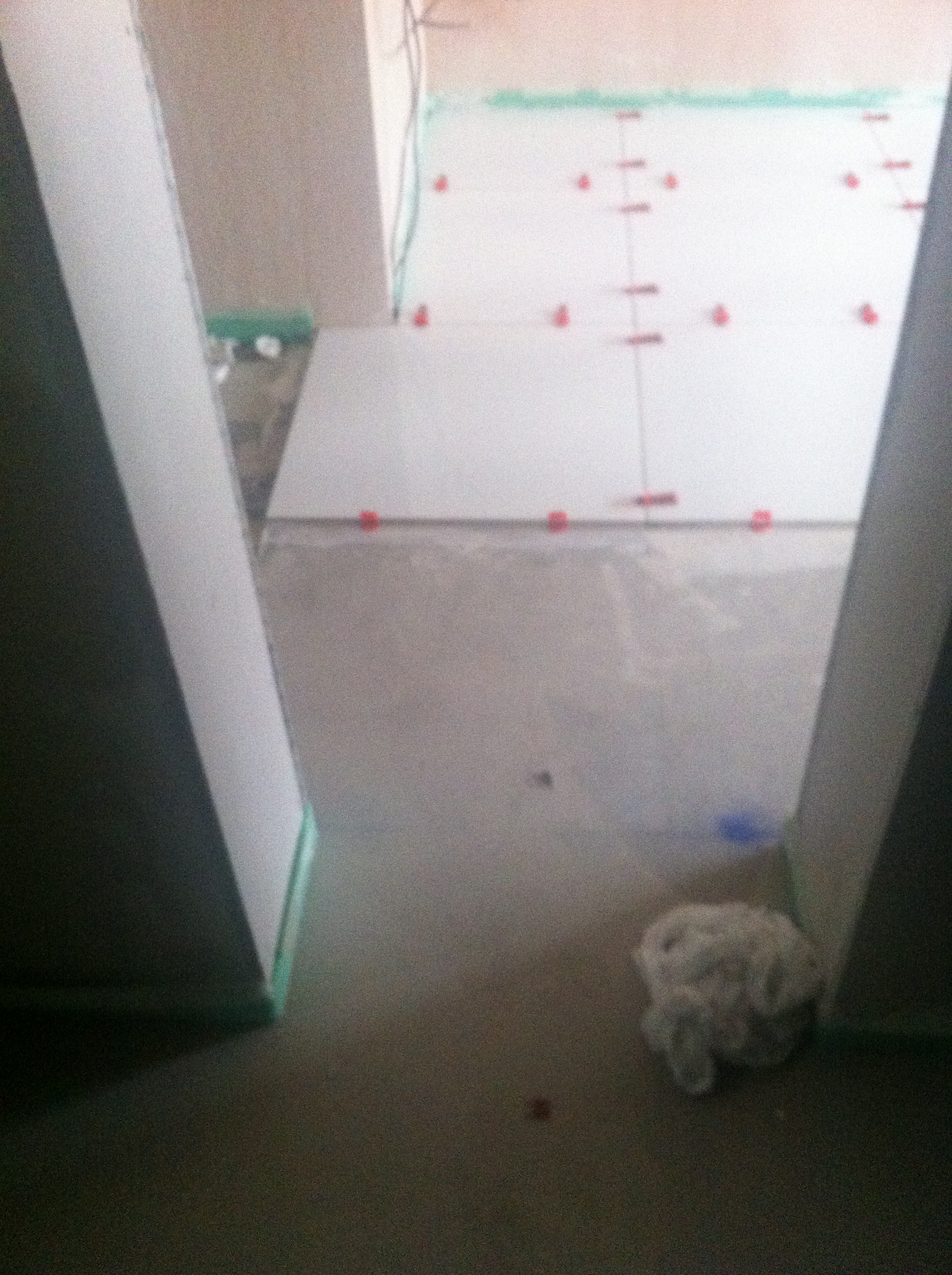

I could do with some advice on tiling the bathroom, I understand that it's best to keep the grout line the same going into the bathroom, as you can see from the photos this will mean a cut and also a small slither next to it, this then will leave me with cuts on every row entering the bathroom which isn't ideal. I was thinking if it would be worthwhile, ignoring the grout line going into the bathroom, cut a tile just covering the entrance, then I can run full sized tiles as you enter the bathroom and majority of next cuts will be hidden underneath bath etc. What do you think? what would you do?
cutting the tiles on the door, keep the line and departure with a whole tile.?
Well there couldn't be a tile placed in doorway as it wouldn't fit and it's a very small bathroom, not even enough for 2 full tiles in width so in this instance I don't believe putting a few tiles in there would benefit unless you were to cut them all out.
So basically what your saying is cut in the doorway to keep the grout line, that would be 1 big 1 small tile tile, cut them both until it reaches the wall, and then I can run a row of full tiles, is that right?
Yes, you have a short tile, if you will.
But keep the other joint running through, even tho it's off centre, it won't look right any other way.
But make sure you bring it through far enough to give you a few mil at your perimeter in the bathroom, or you'll still have to cut every tile against the wall.
By method I meant are you putting any adhesive on the back of the tile or just using 10mm trowel on the floor
That makes sense thanks, yeah I've been back buttering tiles, I've had to build up adhesive on some tiles and i even put another bag of slc down as the floor was sloping off near bifolds and the adhesive was getting too thick.
If you need to build up more, I would advise combing the floor and the tile to double the amount of adhesive.
thanks, yeah it started off with a normal amount of bed & backbutter but the futher along the room I got the more thicker it had to be, especially on the right handside, so what we did was keep a more flat edge on the trowel on certain sides to build up, the information on the adhesive bag said it's limited to 15mm, so it was getting excess of that so I decided it's best to put some more slc on that section, I'm surprised the levels were that off after using the packers as a gauge, very difficult to get right.
I've read from others that sometimes the levelling system creates hollows underneath, but it's definitely not the case here, it's a thick bed, and it's been more of a case of pushing down and wiping the excess coming threw the grout line several times until it matches the next tile rather than it being pulling up from the adhesive bed, I doubt those clips could pull it up anyway, my brother is a builder and is fairly butch and it took all his strength and a few seconds to pull them up to re level.

Hi Average,
View attachment 87715 View attachment 87716
Looks like you have taken the correct advice and centred the room ish and not gone for a little cut ?

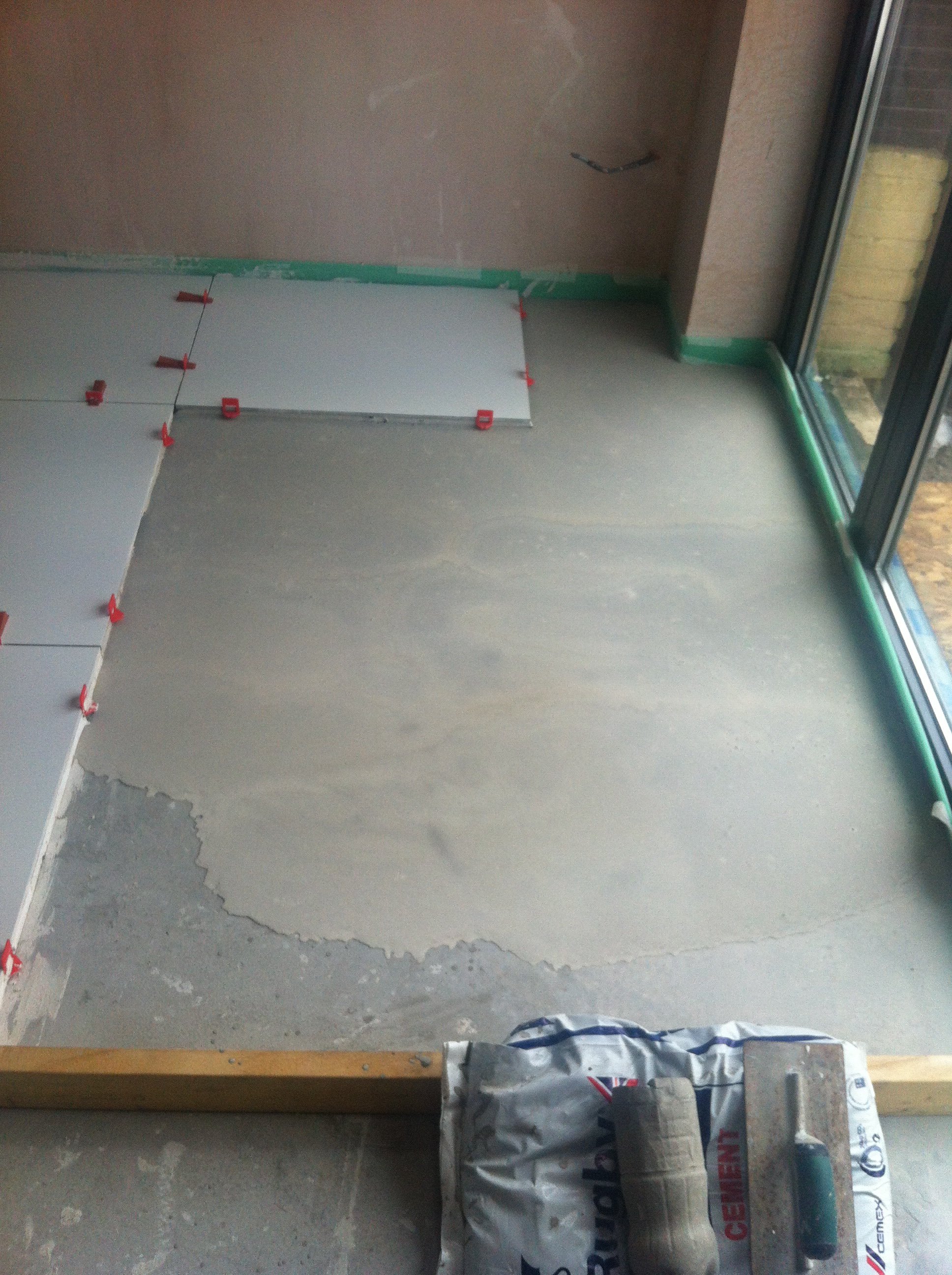

View attachment 87730 That makes sense thanks, yeah I've been back buttering tiles, I've had to build up adhesive on some tiles and i even put another bag of slc down as the floor was sloping off near bifolds and the adhesive was getting too thick.
Has happened to me more than once and I'm sure there'll be a lot on here afraid to admit it its happened to them as well. It actually happened to me in a wetroom once where I ended up having to spread a 20mm trowel onto tile onto large bed of Addy. 12 years and its still down. Worked with tilers and have seen them stick half tiles under tiles to fill under. I know it'll be frowned upon on here but that's been over a decade bd still down so don't worry about you needing to use more Addy. Just make sure it aint to dry thou
