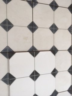

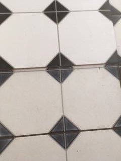

Here's some photos of a spare tile we have alongside the faded tiles.
The make of the tile is Realonda and the name is Victorian Nero Floor. The initial purchase was made with a local bathroom and kitchen company and the replacement floor was supplied by the tile supplier in Bedford.
The excuses that they have given us are that our dogs could be bringing something acidic in on their feet (how this would harm the tile and not the dogs I have no idea). They also said we are bring gravel in on our shoes and this will wear the tile over a period of time ( The fact we are a shoes off household has been explained to them plus the tiles started to show signs of fading after two months). They have said that when they removed the previous floor there was a 'pungent' odour coming from under the tiles and that therefore we must be using strong cleaning products on the tiles (If we were using strong cleaning products, which we are not, how this would cause the underneath of the tile to smell is beyond me), we did ask them if that could be the adhesive used to affix the previous tiles but they have ignored our query. Then they have said that the wear is on the most trafficked area of the tile so that could be a cause (Which would mean the tiles are not fit for purpose if they fade so quickly).

Definitely ceramic and not polished porcelain? And where are you? As @Albert says, images would help as a starting point.
Tile Shop
Ah... Piccys weren't there when i posted.... Anyway, glazed ceramic shouldn't fade for any reason.
Quick test, in an out of sight area, on the black square, drop a little bleach on one and vinegar on another. Leave for 5 minutes and rub with a kitchen roll. See if the colour fades any, and to see if any pigments come off on the tissue. Let us know the results. At work i may have an email address and number for one of Realondas agents who may be able to help. They tend to be very helpful when you suggest you might put your problem on social media for the world to see :)

I'm about to email our contact with the images. However, having looked at the pictures again, I notice the white part of the octagons have darkened from the original look.
The test you did, if the tile was naturally faulty or the glaze was fading/bleeding, either the acid in the vinegar or the bleach, from past experience, would have had some kind of affect.
Now please please please don't take this the wrong way, I'm not saying you are dirty people and I also have a dog that likes to get mucky in the garden and bring it in and staying on top of the cleaning can be a nightmare. But my only other thought is if there is dirt showing, obviously more visible white tiles, this would also pose as a risk for surface abrasion. You may have clean indoor footwear (or no footwear) but this dirt will contain grit and it can still be dragged across the surface by any foot traffic creating like a fine, almost sand-paper like effect. This will abrade the glaze over time and the more surface dirt there is, the quicker it will happen.
The surface of glazed tiles is hard wearing, but not indestructible. So this could happen on any tile to varying extents.
However, I would be questioning the wearing grade, as grade 4 (according to the only reference to this tile I could find on a foreign website) "should" be able to withstand this type of abrasion/scratching dirt if that is indeed the cause of the problem and especially if this dirt is minimal:

Wear isn't visible on the white parts of the tile, only the black but based on how yours have worn, the same test (ISO10545/7) conducted on the black parts of the tile, I would have thought have shown the abrasion significantly quicker, thus reducing the wear grade possibly to as little as grade 2 and therefore unsuitable for kitchen use.
I will send your images to the factory and ask for a datasheet to confirm the abrasion resistance and we can at least look to see if the tile has been mis-sold for your situation.
