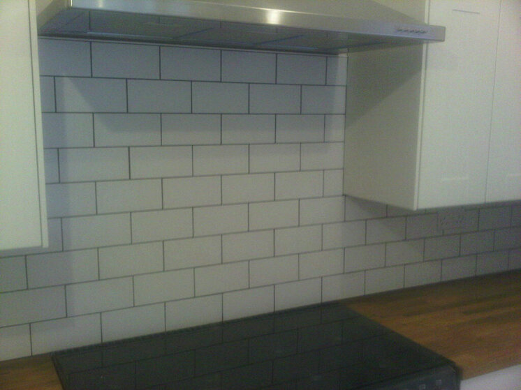

The Laurels, Sevenoaks 002.jpg Did these with grey grout and they were cheap tiles and had no problems.

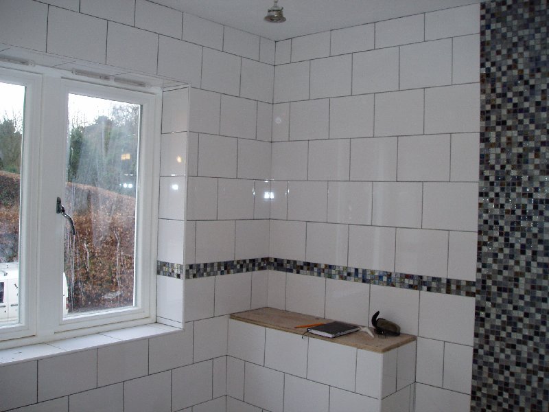

Ha ha..funny you should say that, as in my photo the customer wanted grey grout...and just as i had finished she said she did not like it and wants white grout now.

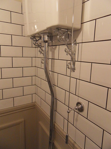

and I did these without issue :lol:, can't remember who they were from, but not expensive in the £15-20 range I think
