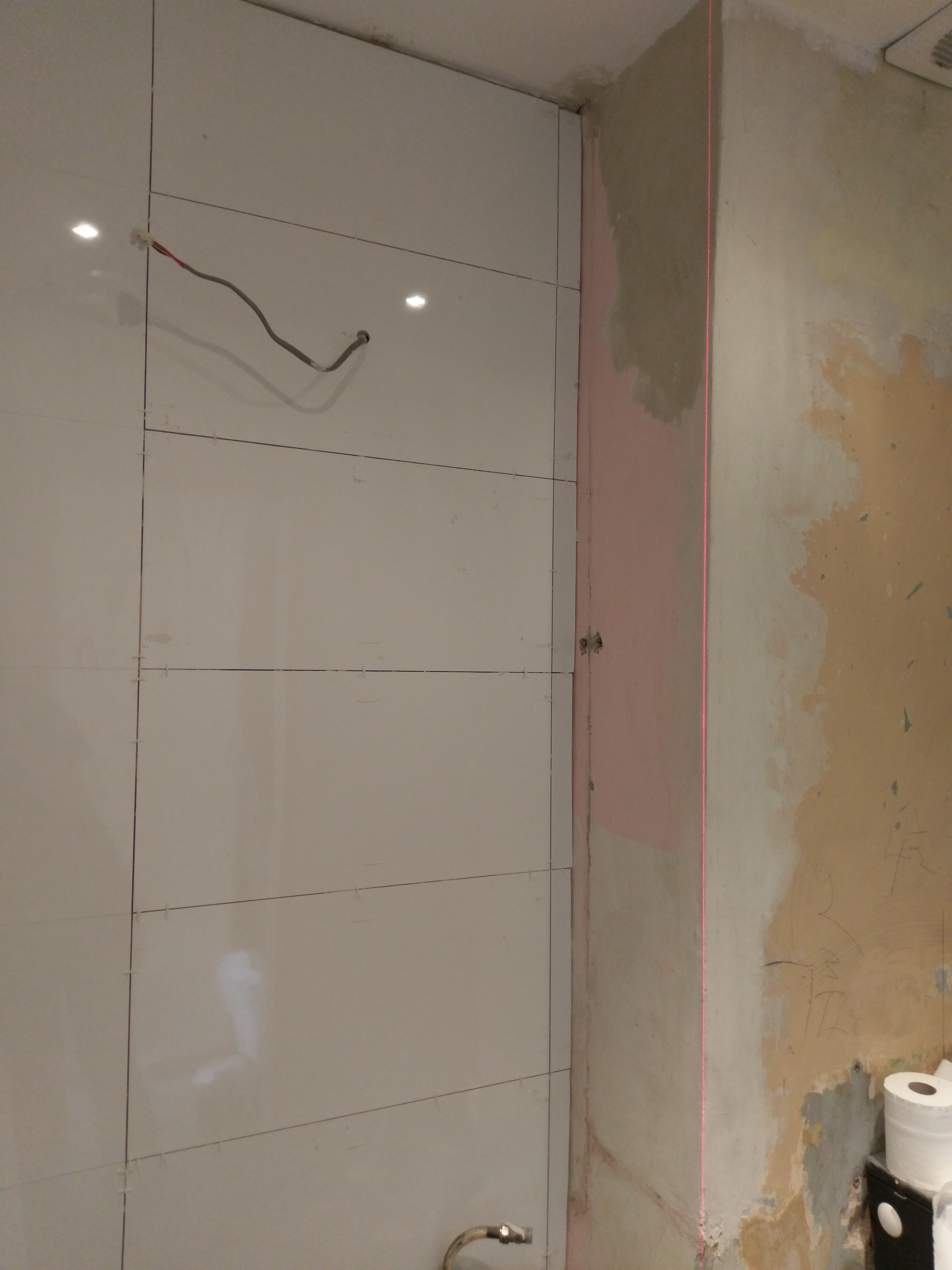

I'm a first time DIY tiler and have almost finished tiling my bathroom walls with 600 X 300 floor to ceiling, but I've hit a snagging point... I've got a floor to ceiling external corner which isn't straight by quite a long way. I want to use straight edge trim, but am really not confident about what to do to get it looking reasonable.

Tile it level on one wall, then build the other wall out with the adhesive, let it go off then tile the other wall.
How far out of level is it..?
Thanks very much for the reply. See pic attached. About an inch at the top.
Hi, thanks very much for all the replies. I've sanded the plaster right back in places and it looks like the metal corner bead used to reinforce the corner of the wall is not at all straight hence the dodgy plastering over it.
If you cant get it back any more...
Set your vertical laser line to the widest point at the top and cut all the tiles to that line, fill in the return behind with plasterboard and rapidset..
OK, thanks, will give it a try. Just out of interest... Is there a type of tile trim which is more forgiving on non straight walls? Would you say the straight edge stuff is more difficult to get a good finish on?
Thanks so much for all the advice.
Schluter trims can be ordered with slits cut in the part that sits under the tile allowing you to curve it a lot easier they also have a tool for continuous and uniform bends
I do however thing you would be better of doing all cuts on a guide and just building out the corner as mentioned above
