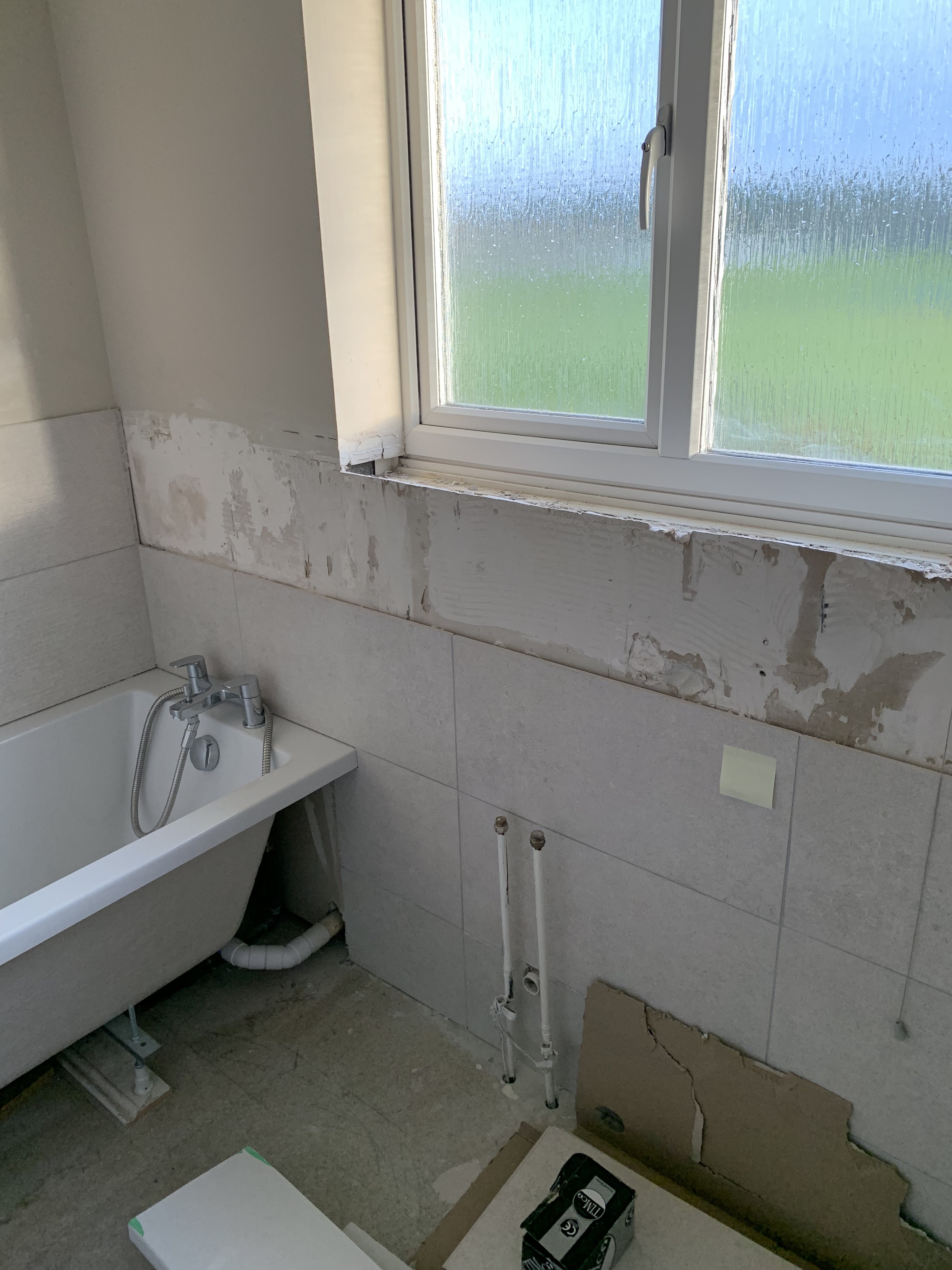

The tiler has done an awful job on our bathroom. There are lips, poor grout lines, poor cuts, poor layout, poorly finished and mismatched trim with the main issue for me being around the window.
Yesterday he came back to finish off but we came to an agreement for him to walk away as I wasn’t happy and had no faith in him to rectify any problems. We settled on an amount of money whereby he paid me the purchase price of my tiles.
However the plumber I have used knows a tiler and he came to look at it yesterday afternoon. He was shocked at the quality and has suggested at least one plasterboard wall is cut out, re-boarded and re-tiled but the window is tricky due to the height of the top row.
The new tiler has pointed out so many issues that I had not noticed I just want the whole lot ripped out, re-boarded and started from fresh. They both said this was a big job but I really don’t know if I can live with the mistakes.

Forgot to mention. The new tiler said the adhesive is powder, cement based so will destroy the walls if we try and remove. There are 2 stud walls and 2 dot and dab walls.

To be honest I'm looking at that and all that seems wrong is the trim work . That could be sorted . That gap by the door would immediately look better with a clever piece of silicone work . You have one lippy tile . The corner would look better if the grout was raked out and it was siliconed .
I thought that initially but it looks worse in person. There are loads of lips.
