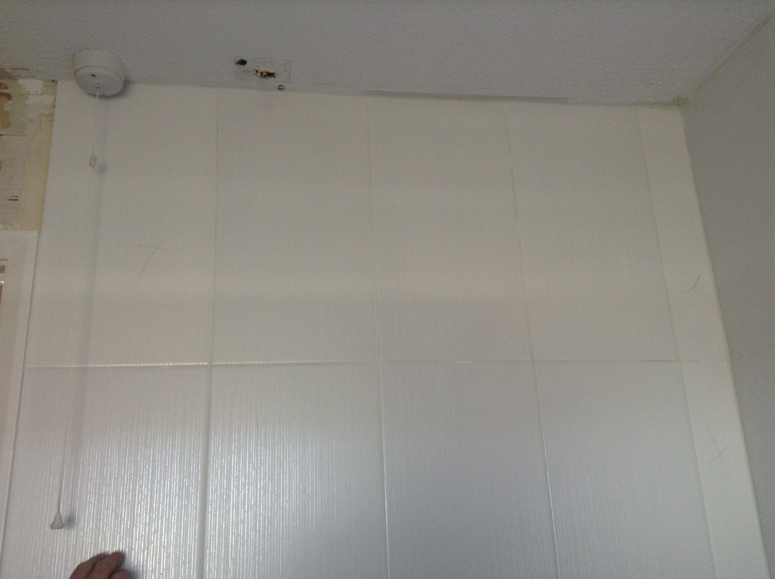

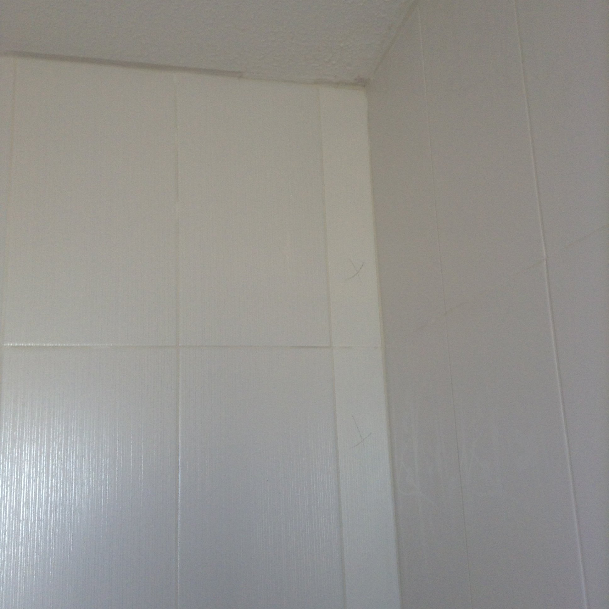

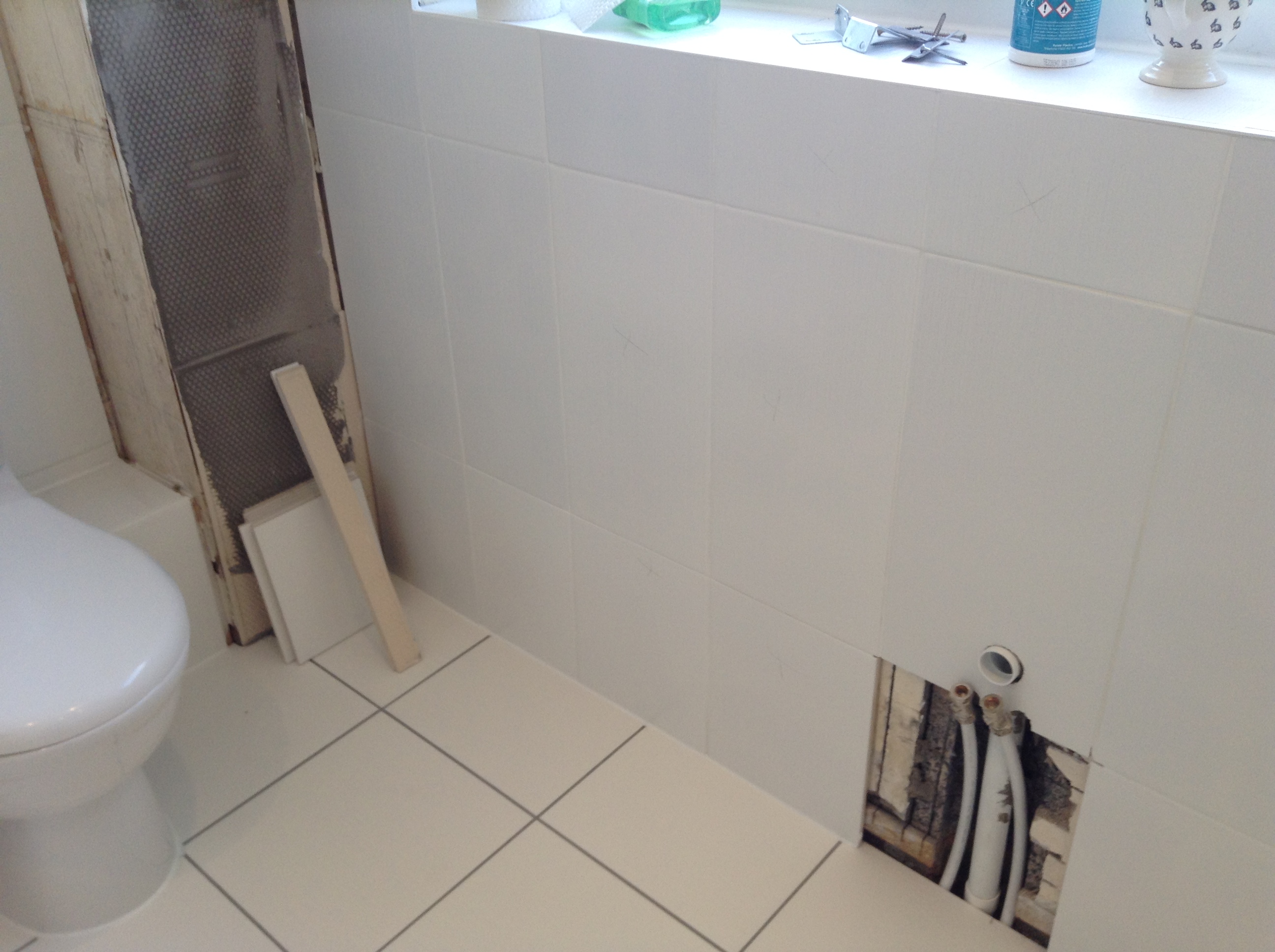

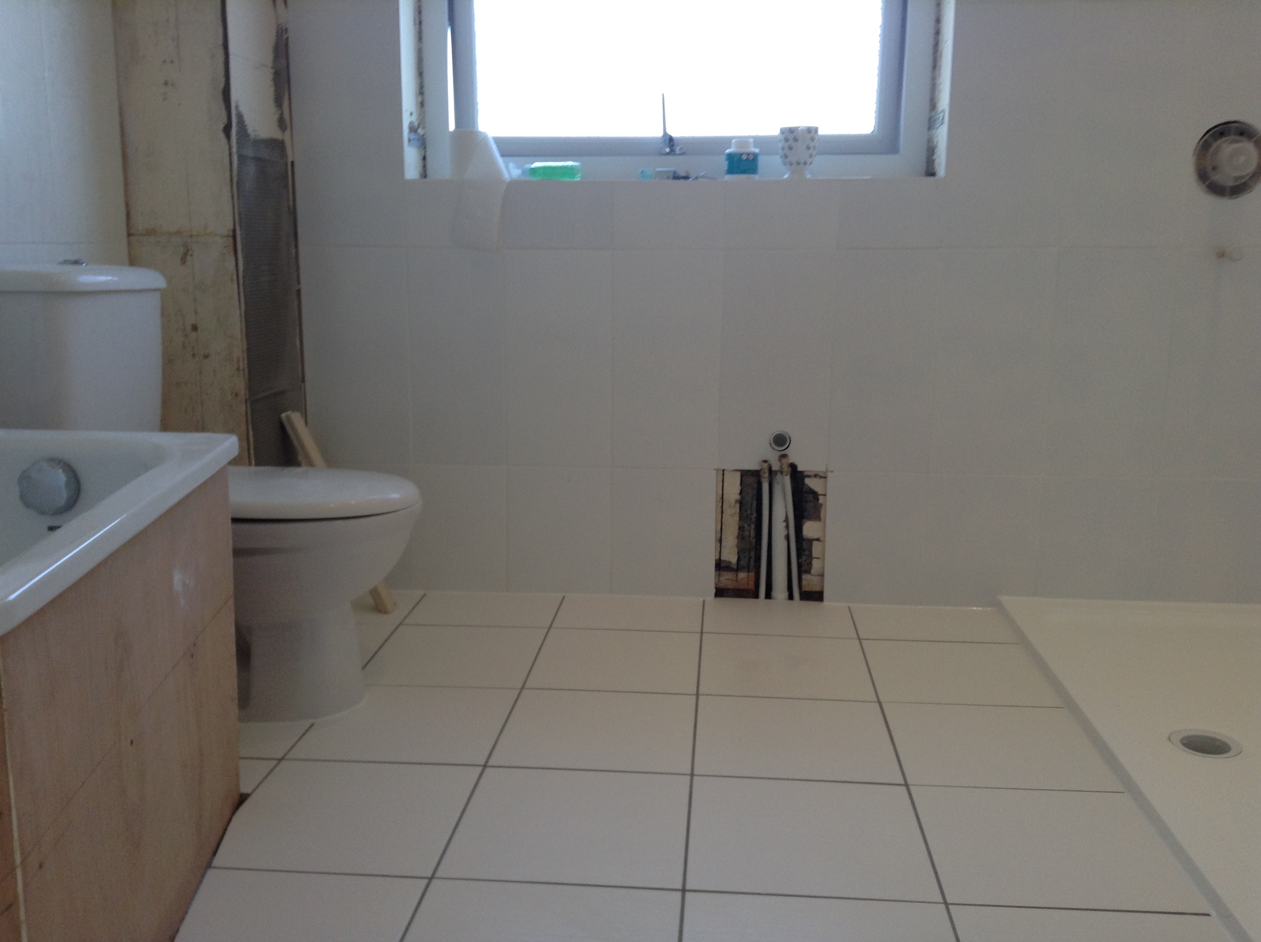

Hi guys. Bit of a strange one this.
Had a query from someone who has had tilers fitted by a "pro-tiler". All the tiles were supplied from the same batch. They have been fitted over a couple of days and grouted on the third.
Apparently they looked fine when they were first laid but since grouting have drastically discoloured by varying amounts.
I think its moisture ingress, with a few "buts".... You will see from some of the pictures, dark blotches down the sides. Faint but definitely there.... so dot and dabbed (pro-tiler my.....*). But that would mean there wouldn't be a lot of moisture to go into the back of the tile. This would also mean plenty of air contact for dispersion. Yep.... ready-mixed on a 500x250 tile (pro-tiler my.....*). Onto plastered walls but he will not say whether its primed. He keeps dodging the question when she asks him.
The tiles are BCT Cottonwood so I know they're not the greatest quality, but the stock has been checked (same batch as was supplied) and there is no variation in the colour as we expected. So it has to be something to do with the conditions of the fixing. When they were delivered, they were stored in her garage for 2 weeks and the tiler has taken one bo, fitted it, gone to get another from the garage, fitted it and so on. Could it be down to atmospheric changes?
So I realise its been fitted incorrectly, and it has got to be ripped down and started again. Whether it will or not is up to them. But I can't see any reason why this would happen, so I'm wondering if any of you have seen this before or can suggest possible cause.

The way the forum displays the images means you can't see the faint dabs.... you'll just have to take my word for it that they are there.
So, safe to assume not primed then if he won't answer. My guess is, he did the main (field?) tiles one day, then did the cut tiles at the end? Maybe he used a different adhesive for the cut tiles than the whole ones, but yeah, apart from ripping down nothing can be done.
Not sure just ripping out the affected ones would help either, who's to say that the ones that went up first aren't discoloured and whatever you put up next to them would again look different.

We recently had an issue with this in our showroom, white bodied ceramic wall tiles. Powdered adhesive, standard set, grouted the next day. Three tiles in the bottom corner (the last three to be fixed) plus one in the top where a cut had to be made for some wiring.
After a lot of discussion with our tiler, he admitted using a bit of the rapid grey from the floor he was doing in another display, rather than mix up more white!
We tore out those tiles and replaced using white powder and no issues since.

Hi , I had a problem similar to that when you could see my trowel marks comin threw the face of the tile , called the tile rep and he said the tiles were fine , so called the adhesive rep and it turned out to moisture migration with house been so cold , no heatin in the bathroom , so before I grouted I got a storage heater in for a few days and dried out fine , but yours have been grouted so not sure whether that would work or not
