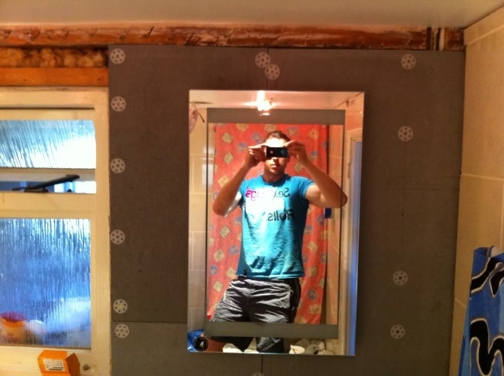

Finished boarding the last wall today.. ready to tile!

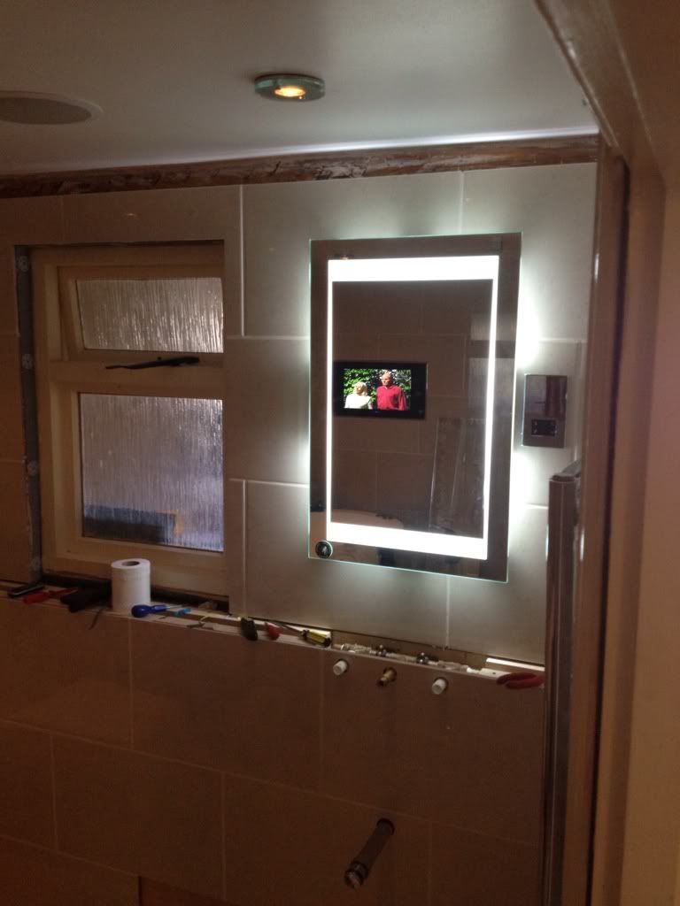

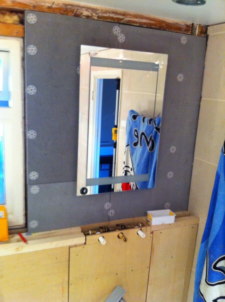

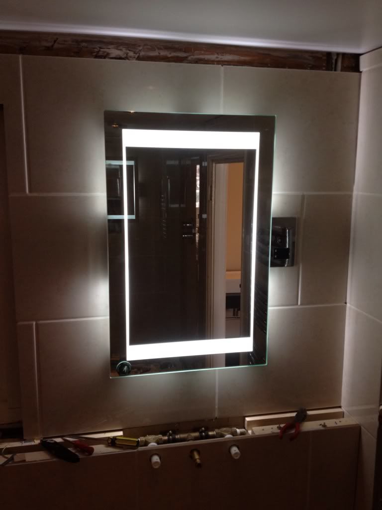

Mirror arrived, its a infrared touchless one.. just wave a finger under the unit and it switches on lights and mood lights... its also heated so should never steam up!

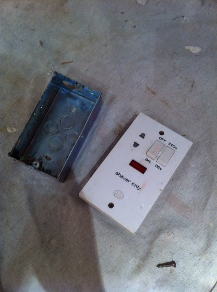

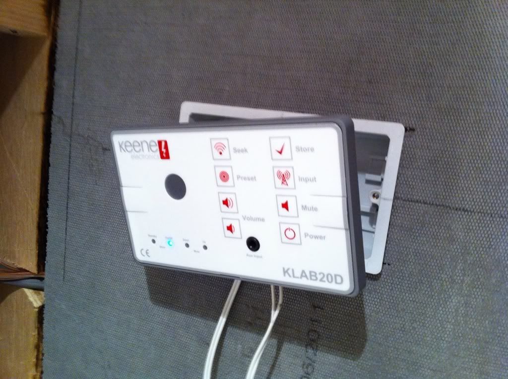

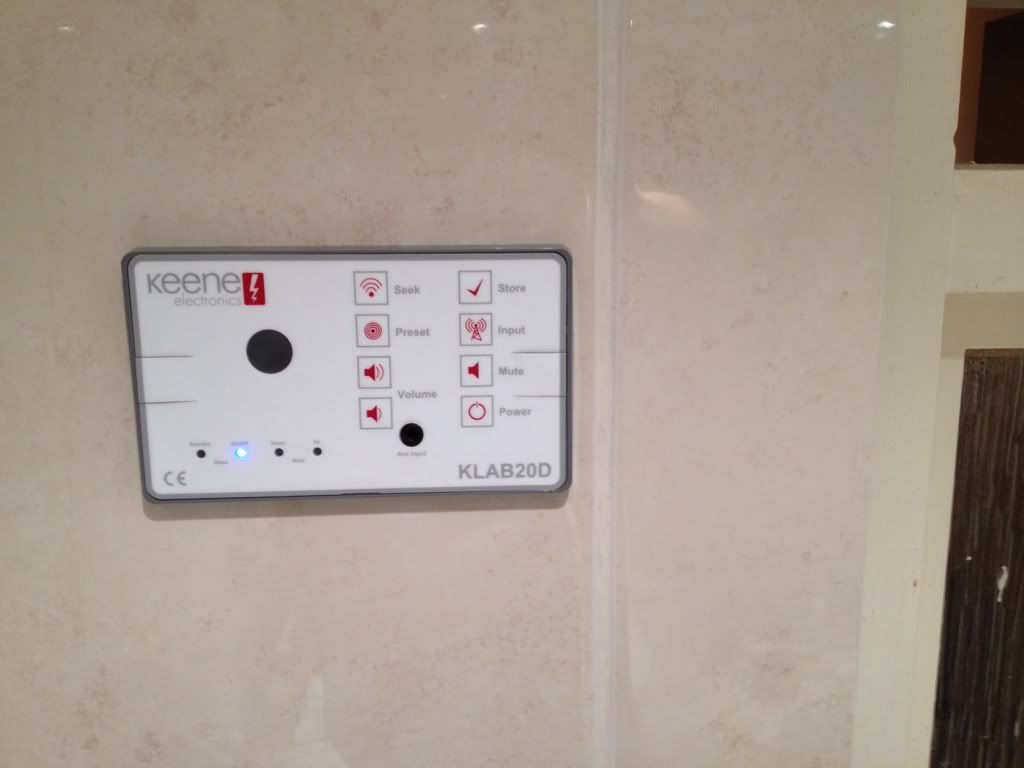

New shaver socket to get rid of the PONY old one.. oh and also test fitted the bathroom stereo amp/radio/ipod dock.. its uber cool... also wirelessly links to my iTunes library so have complete access to all my tunes! all controlled by my iPhone or iPad! (or the supplied remote)

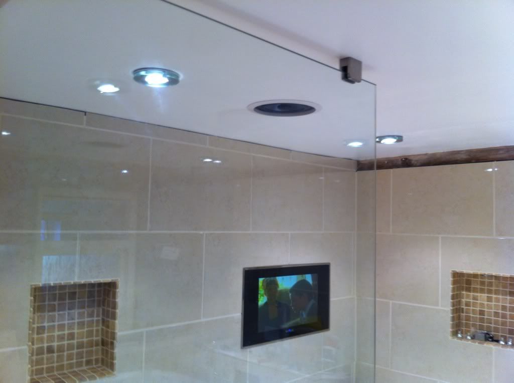

Had a bracket made on a CNC mill also to fix to ceiling to add additional support for the wet room screen
Done for today!
CNC Milled

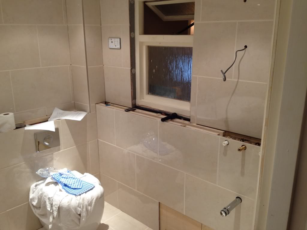

Slapped on a few tiles today and installed a couple of thermostats to start the UFH running in marathon! for the bathroom and kitchen.... will do conservatory when its decorated / clear of all my tools!

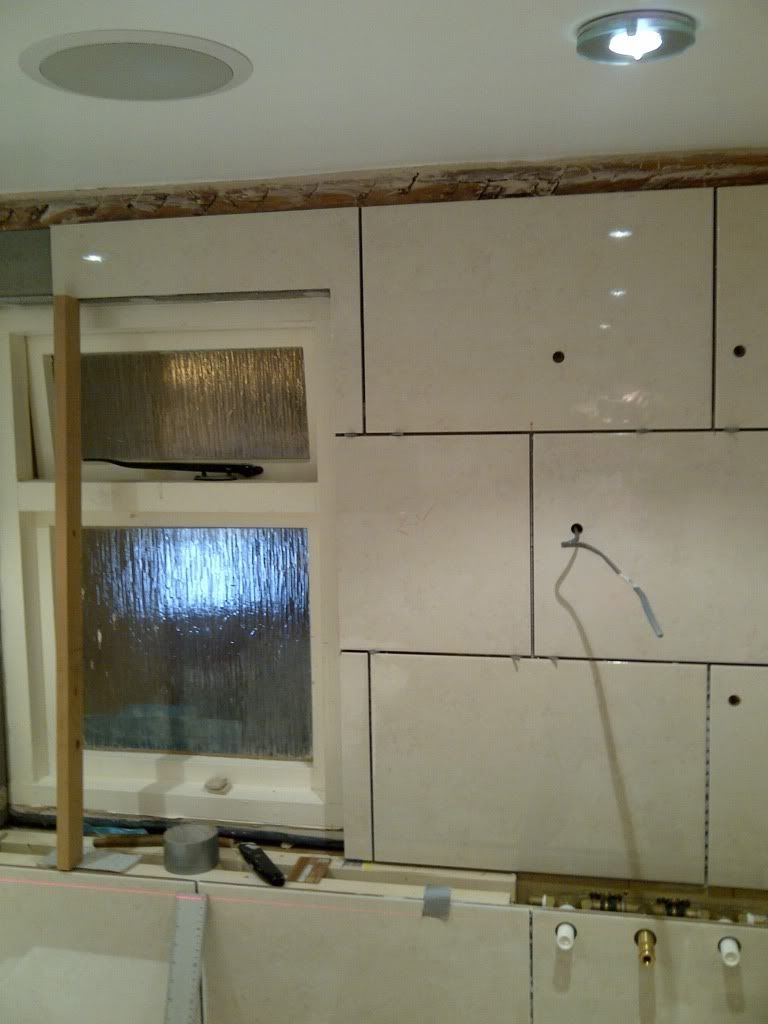

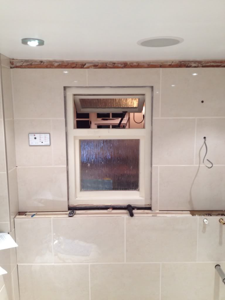

NEARLY FINISHED TILING!!! just two tiles to drill and lay... then some mosaic panels...
off to get some more kerapoxy tomorrow (urrgh!)

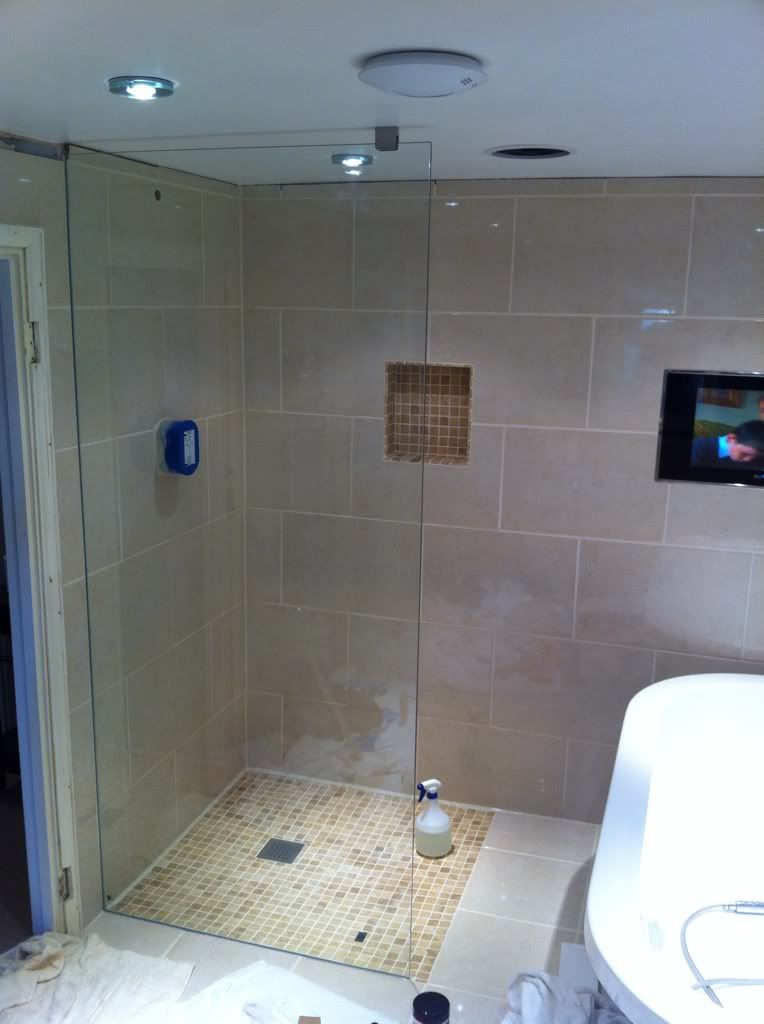

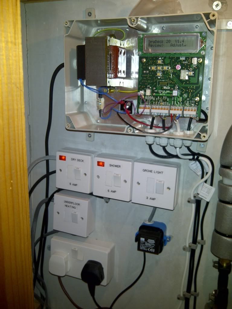

Mike, its a pumped system.
2 sensors one on each supply pipe to shower
measures the flow in Litres p/m.. the system is mapped from low to high flow. Auto adusts suction of water from drain gulley depending on how much water is used.
Also switches on at low voltage/suction 15 mins after you have finished showering to clear any residual water that may be in the gulley.
