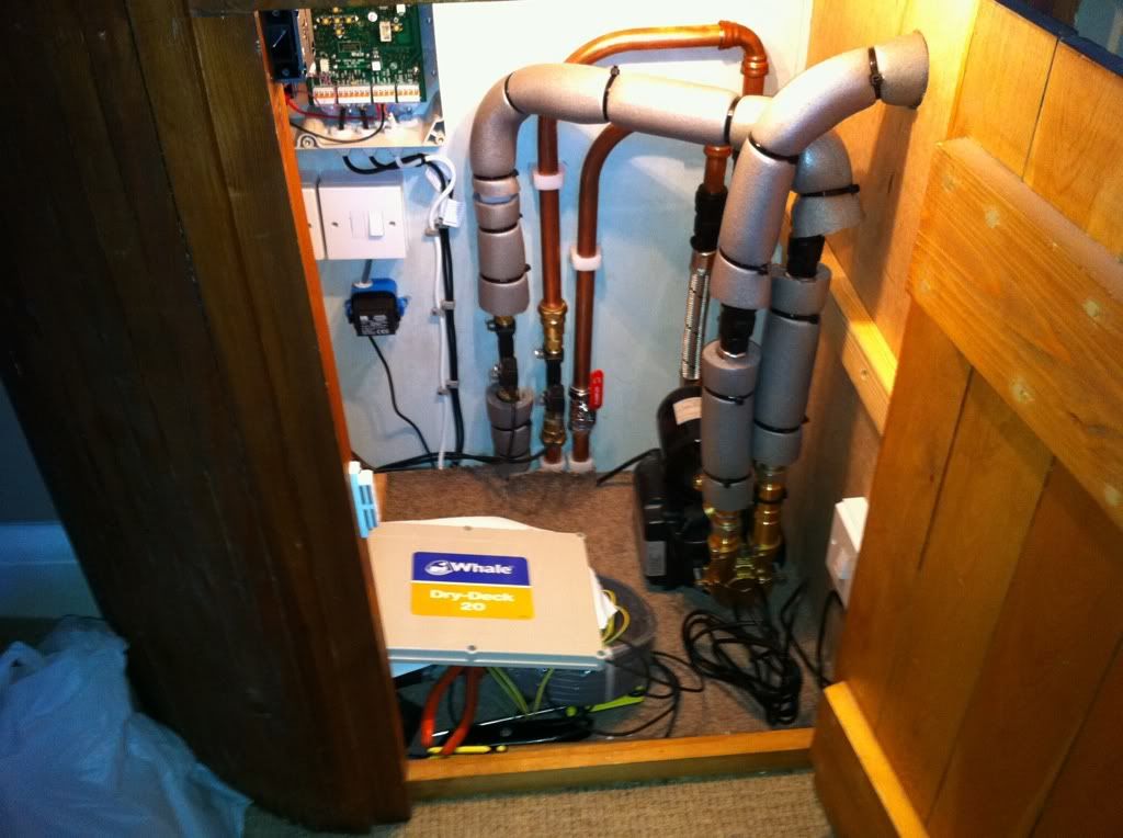

First task was to move the hot water cylinder from in the bathroom to a new cupboard outside the room (thanks to Scruff from ultimatehandyman.co.uk for the advice!)
Now you see it...
Now you dont!

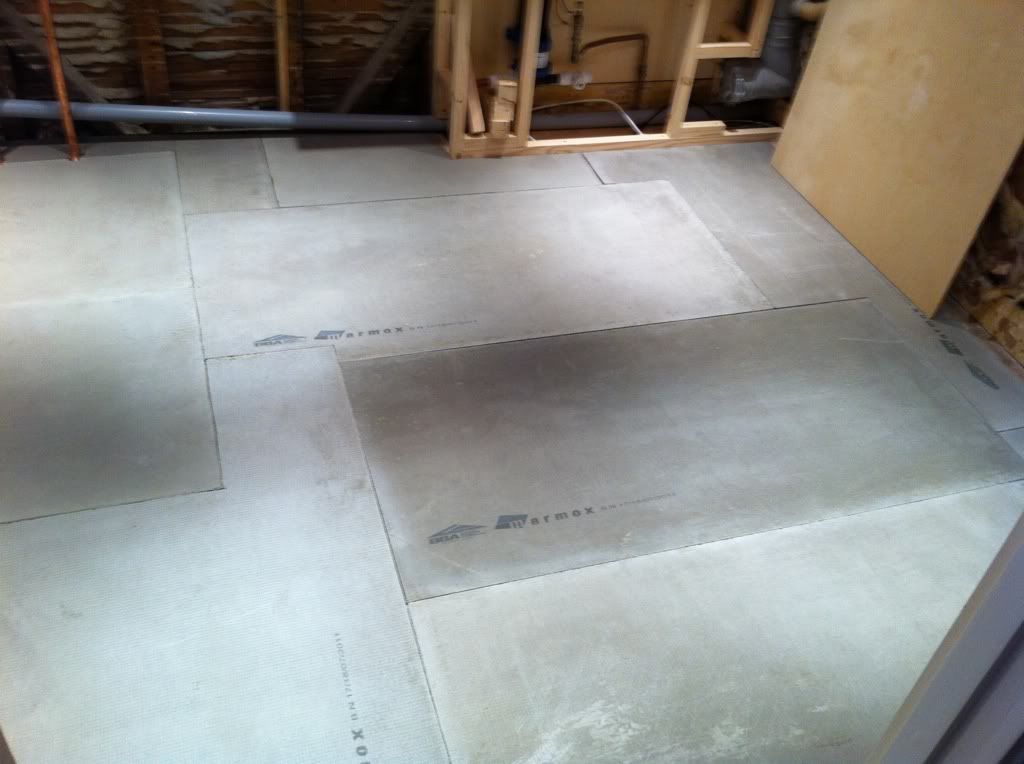

Well, I picked up a load of bits today..
Marmox goods and tiles!

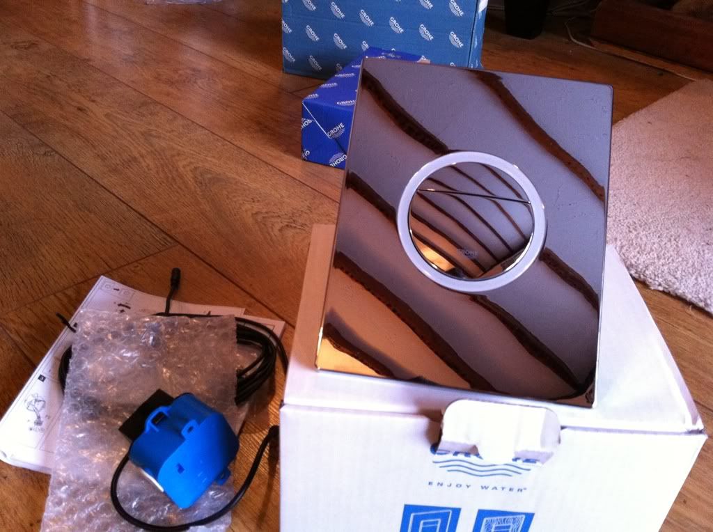

and the most expensive toilet flush ever.. dont ask me WHY! I just thought a flush button with a light ring would be cool!

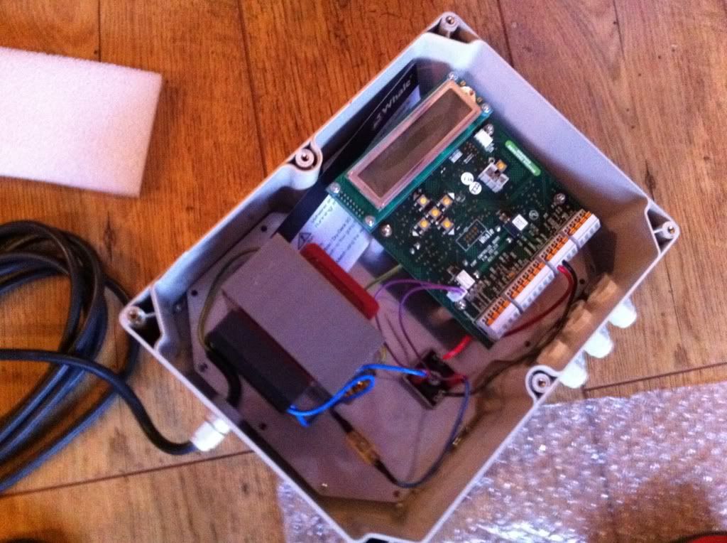

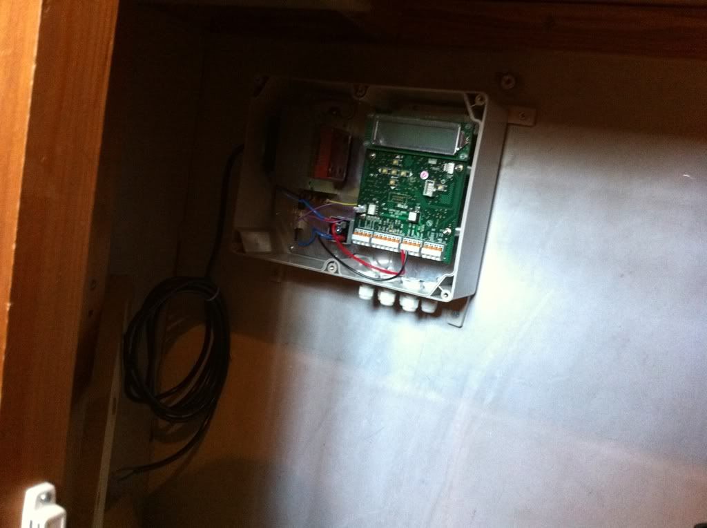

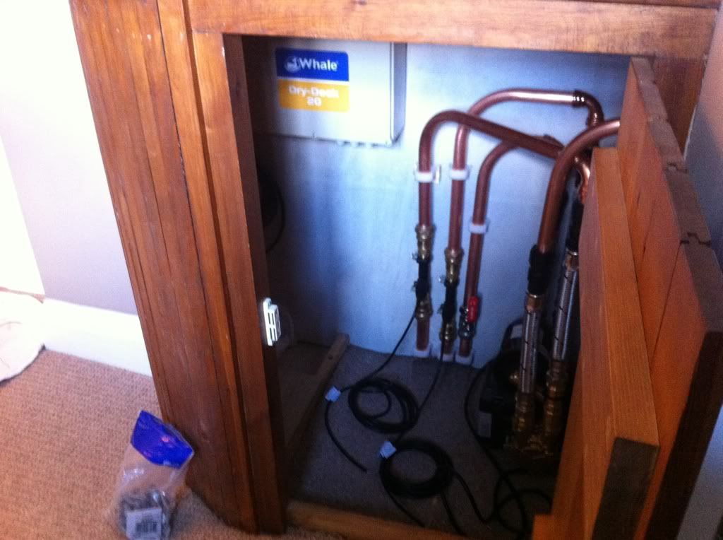

Oh and the dry deck 20 pump system turned up. Gravity drainage would be a bit of a prob so I thought id get it all pumped away. Kit looks pretty good. Very smart stuff check out the website The New Dry-Deck 20 from Pump Technology

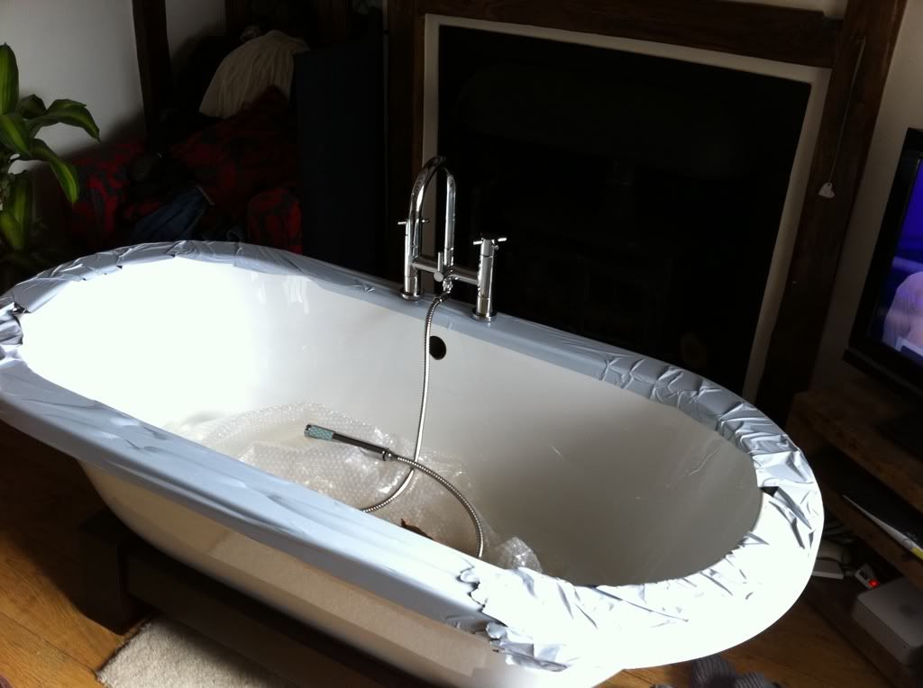

Woohoo,bath has arrived.

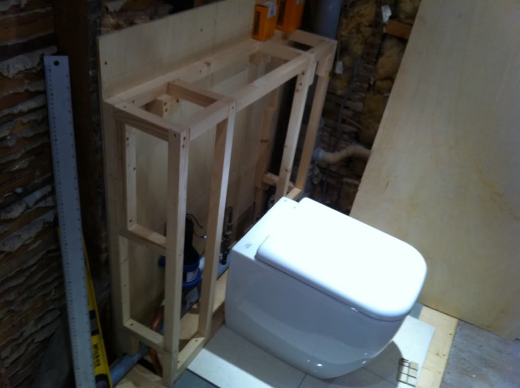

I also did a bit of boxing out in the downstairs cloakroom ready to tile/fit concealed cistern loo/sink

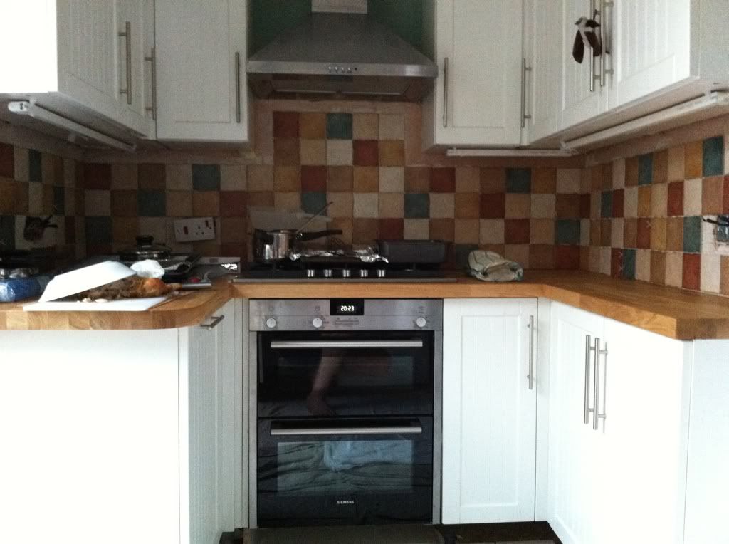

AND.. I decided to tile the kitchen! First ever time tiling a wall... not too bad I hope!
absolute nightmare as no walls were straight! im just about to finish the window surround today, then i'll grout in a few days once fully dry!

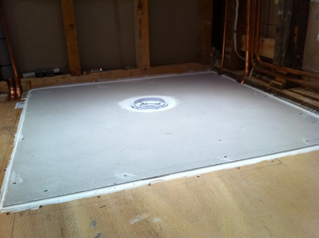

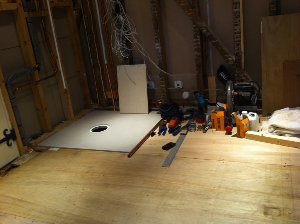

Hi Davemul,

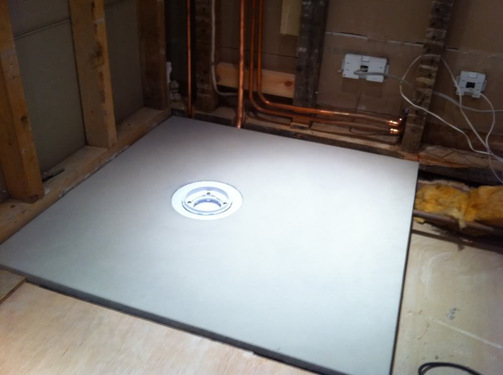

Nice project, curious as to what shower tray former you are using. Have you put it straight onto joists?
PHG Dave
Good one..
I was slightly concerned when i saw the pic of the underside of the tray with the cut-out for the pipe that it might of been foam cored as per the Showerlay tray and would need full support.
Look forward to seeing the ongoing pics :thumbsup:

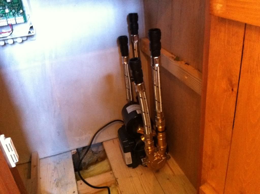

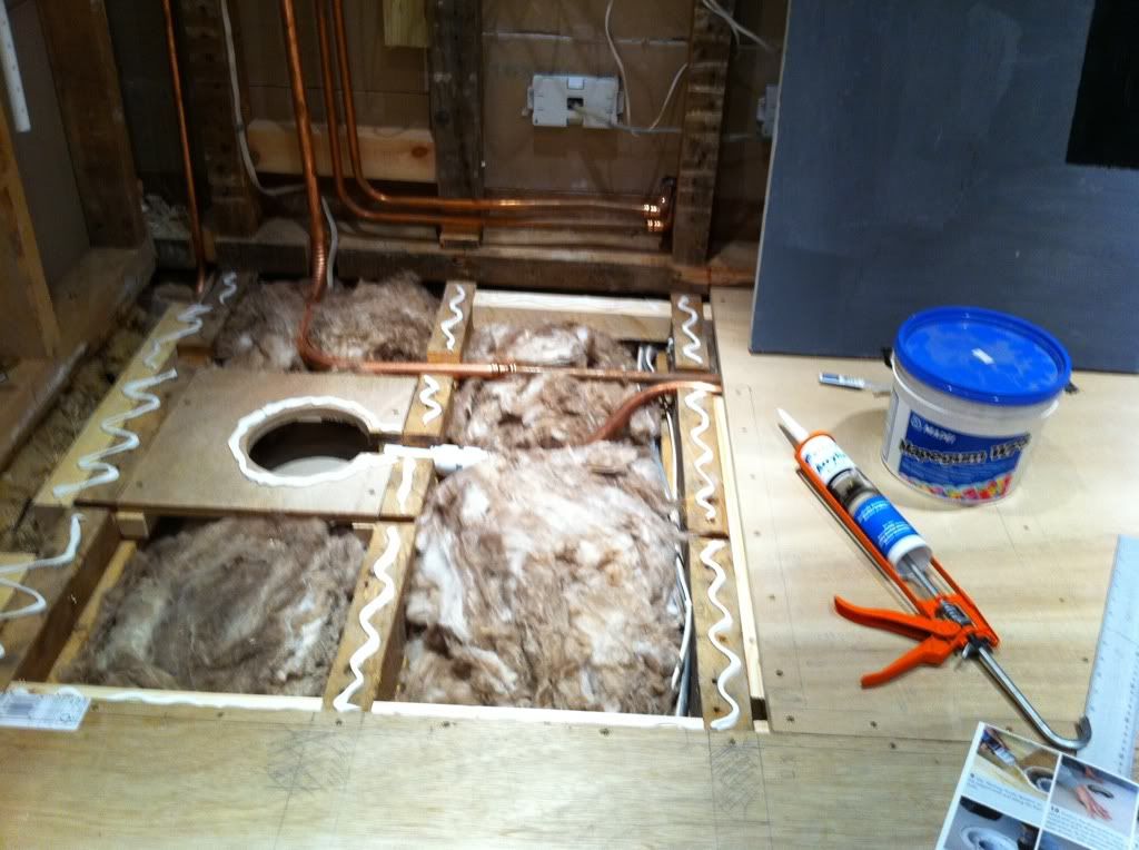

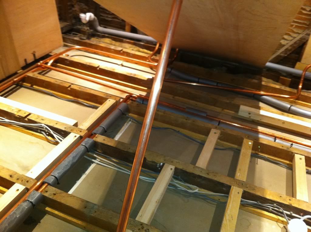

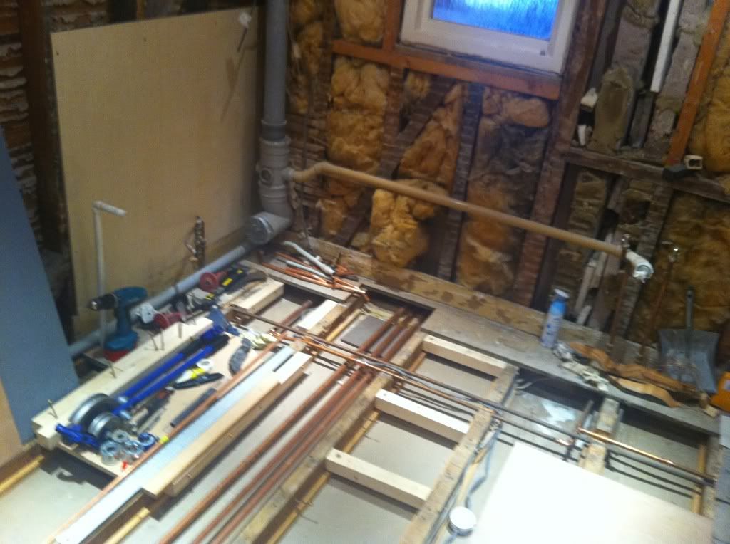

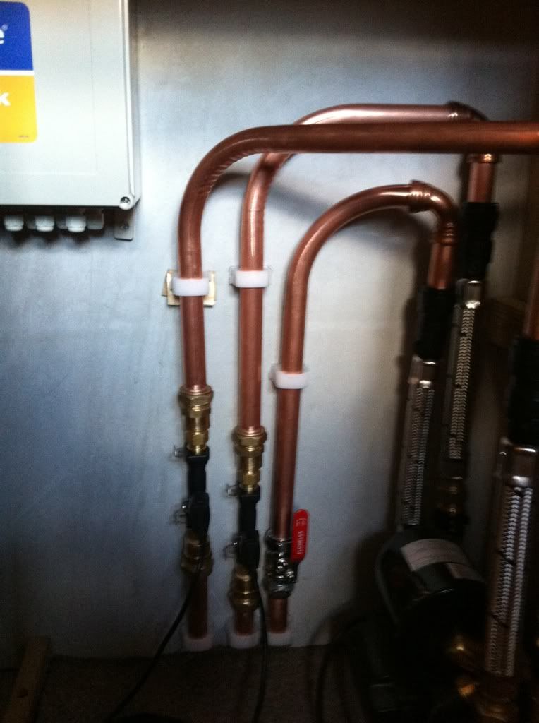

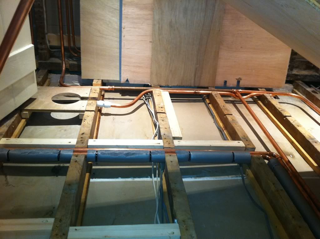

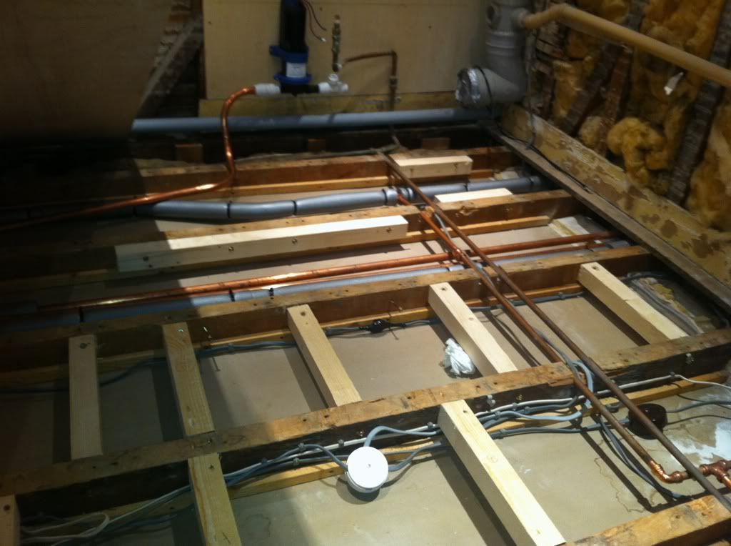

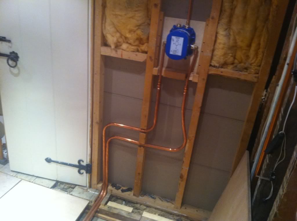

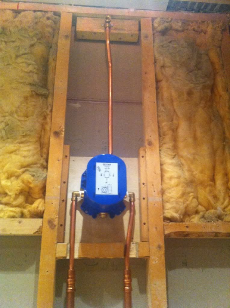

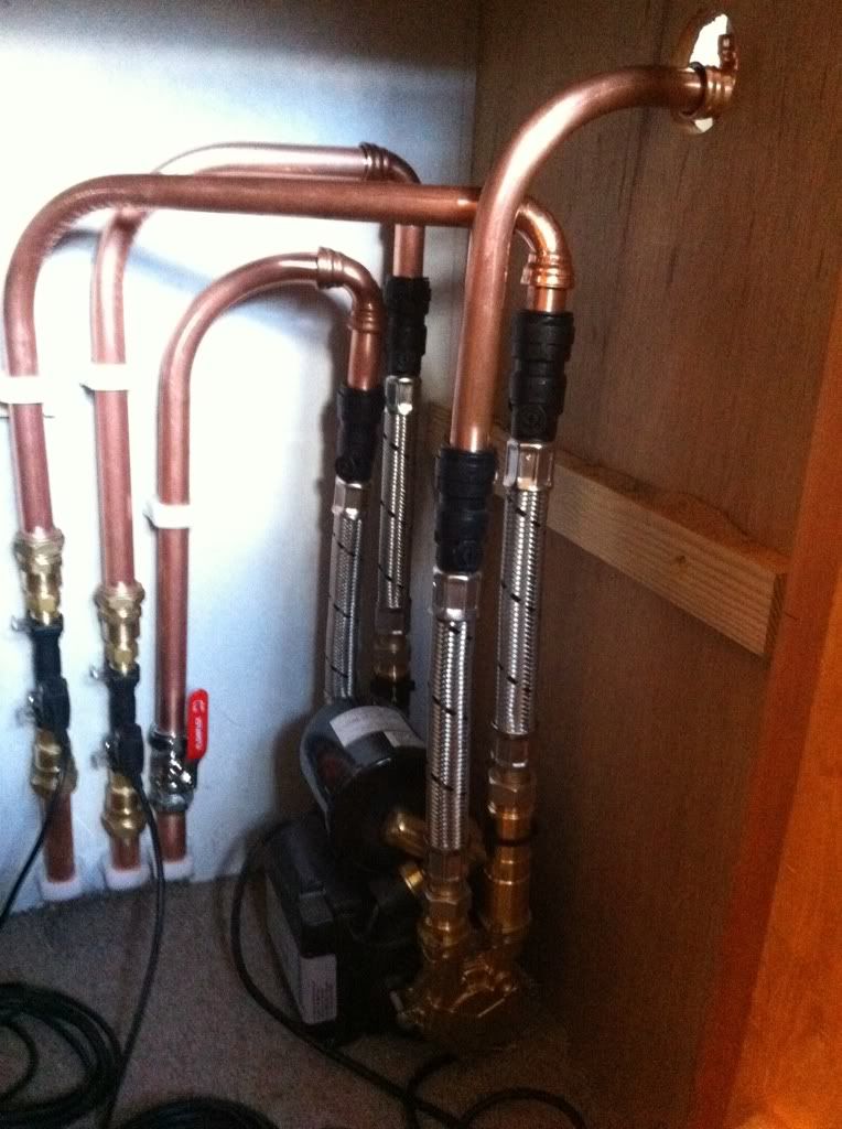

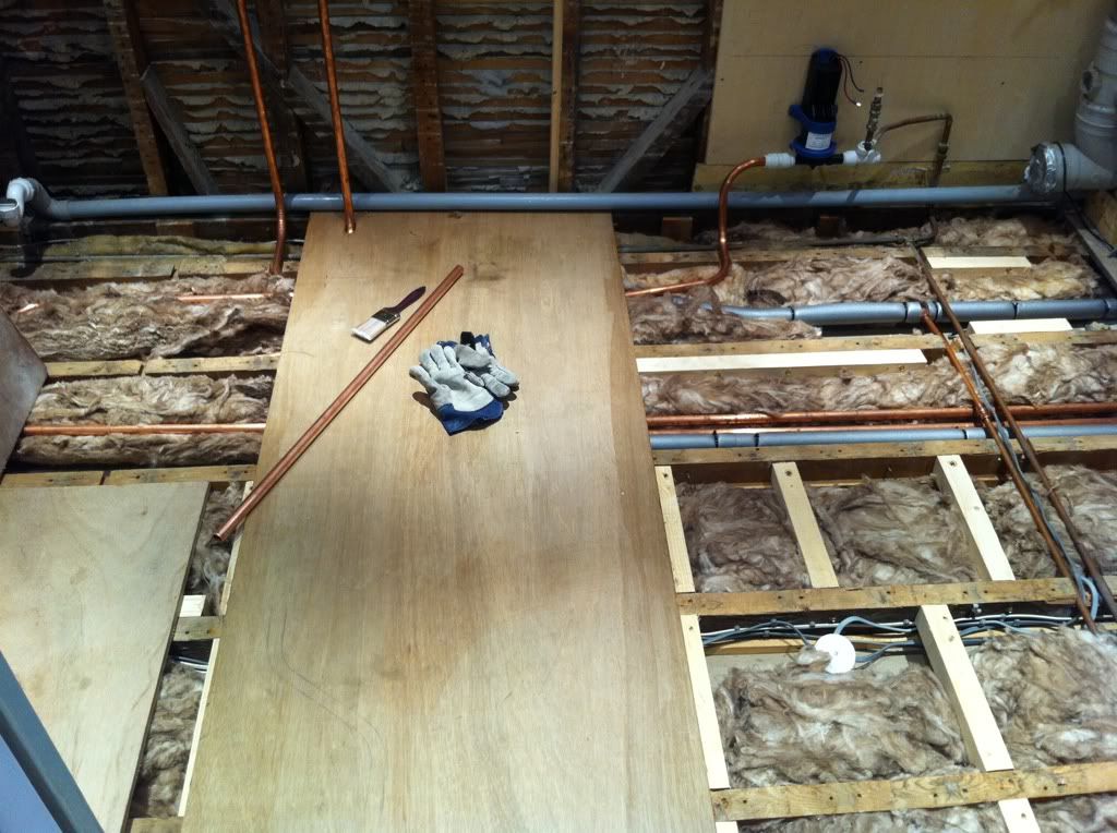

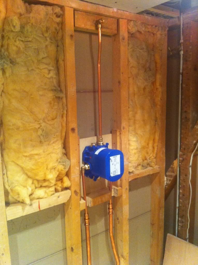

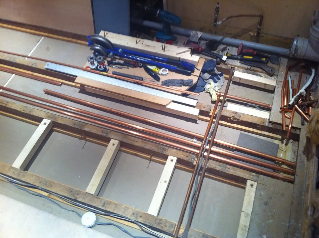

Started to plumb the shower pump and flow sensors for the dry deck today. Better not leak!

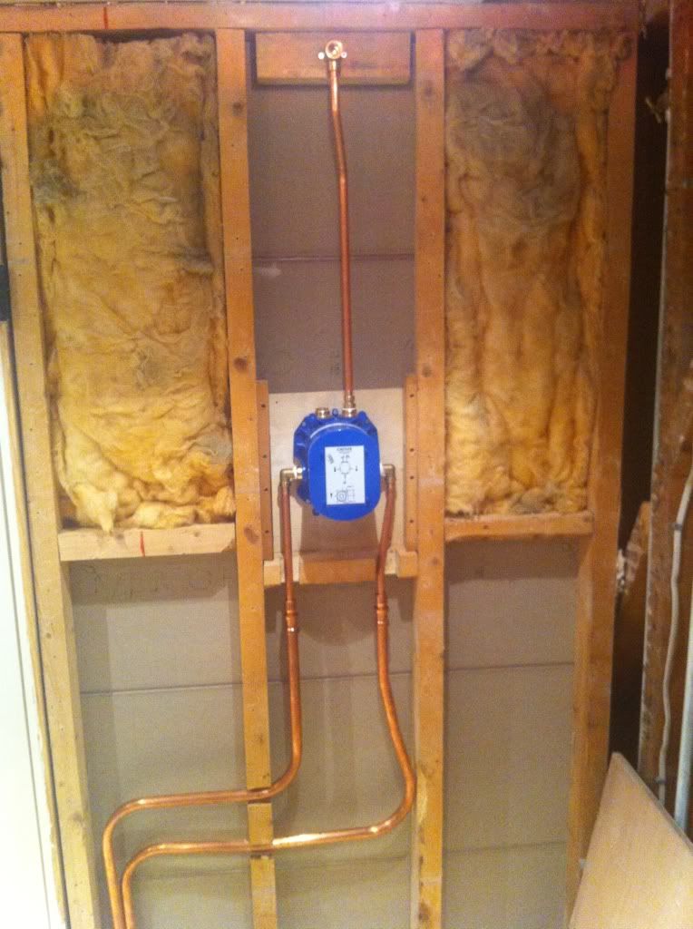

did some plumbing for the shower mixer and some electrics also... more pics tomorrow
this bathroom lark is stressful!
One Day
Have to say I'm impressed with the plumbing!
Do you opt for push fit over soldering for the same reason I do: insurance?!
davemul
Pushfit for ease in my situation. I'm only using compression where its a last resort and im no plumber so am not going near solder! :)
Only problem is copper pushfits are so expensive! I reckon ive spent £800 in fittings and pipe alone so far!
