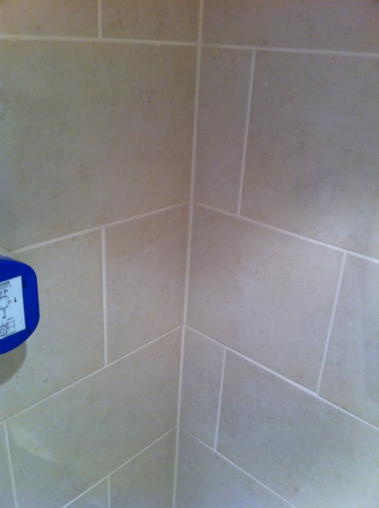

some sealant shots for all you deviants that asked
