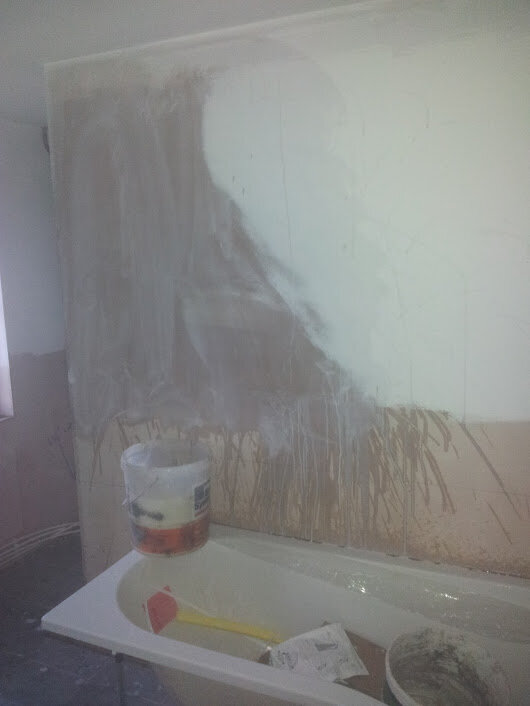

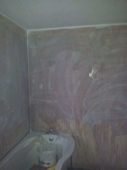

Hi all,
Having my first attempt at tiling the shower room.
As you can see from the pics, ive boarded it throughout and a mate has skimmed it for me.
Got my level for first tiles and have battoned out.
But where do i start, ive checked lots of sites and watched loadsa videos, with lots of different opinions.
As my shower going in corner, do i put full tiles from right and work left or find centre of wall and have small cuts either side.
How do i work around the rest of the walls making it look easy on the eye.All of shower enclosure to be tiled with rest of room going 5 tiles up to just where paint begins
Any advice would be really appreciated.
Was told to get tiles on wall, and fit tray afterwards.
Got him to skim cement board cos plasterboard had bee skimmed and wanted a level finish.
painted the whole room once it was plastered with a cheap white emulsion, I have also applied adhesive ready for tiling

Ok, what are you all goin on about.
All I've done is paint the plastered walls with emulsion.
Ive added an acrylic bonding agent for tiling area.
why on earth are the tiles going to come off.
i have tubbed adhesive for tiles.
the acqua board which has been skimmed 4 weeks is absolutely fine, with no plaster even showing any signs of cracking or blemish.
why have I not prepped correctly, are you telling me tiles will not go onto a painted wall ?..
I have just asked for a little advice, no sarcasm please, it don't help me in completing my project.

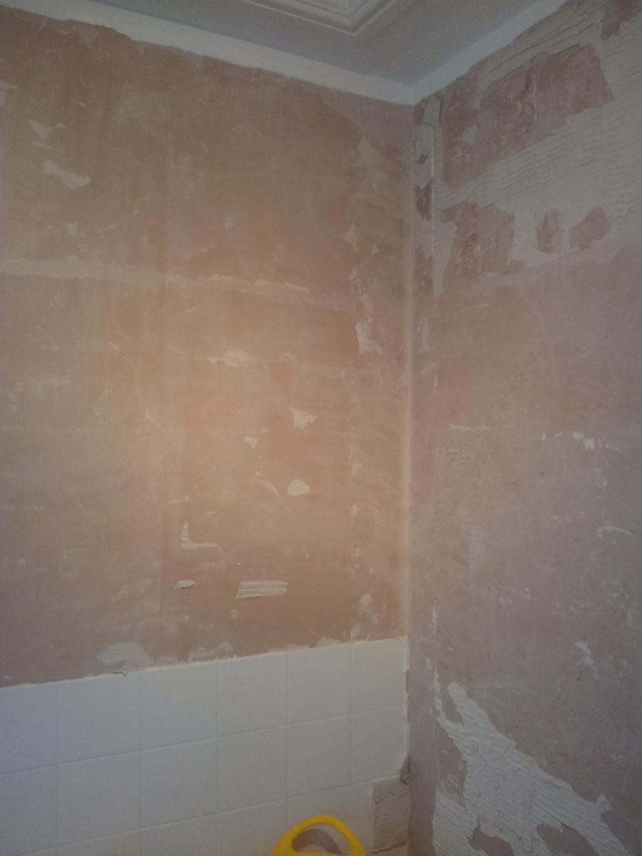

Tiling onto "cheap emulsion " ?? take a sponge to it and wash it off.....dont believe me ? Here was one I did last year when client painted the walls ?? Can you understand now why you shouldnt hang tiles on a painted wall now ?
You're being given LOTS of very good advice, and choosing to ignore it. The whole point of using cement boards, is that they don't deteriorate when wet. So if water gets behind the tiles, the instillation won't fail! The plaster has completely negated that. It's also not a suitable substrate for plastering, as already said... There was no need to skim the walls to begin with!?! Plasterboard is a good surface to tile onto (unless the boards were all over the place, and needed bonding out first?)...
Paint.... Shouldn't be tiled on, because the only thing taking the weight, is now a thin layer of paint, rather than the plaster.
Good luck with it anyway 😉

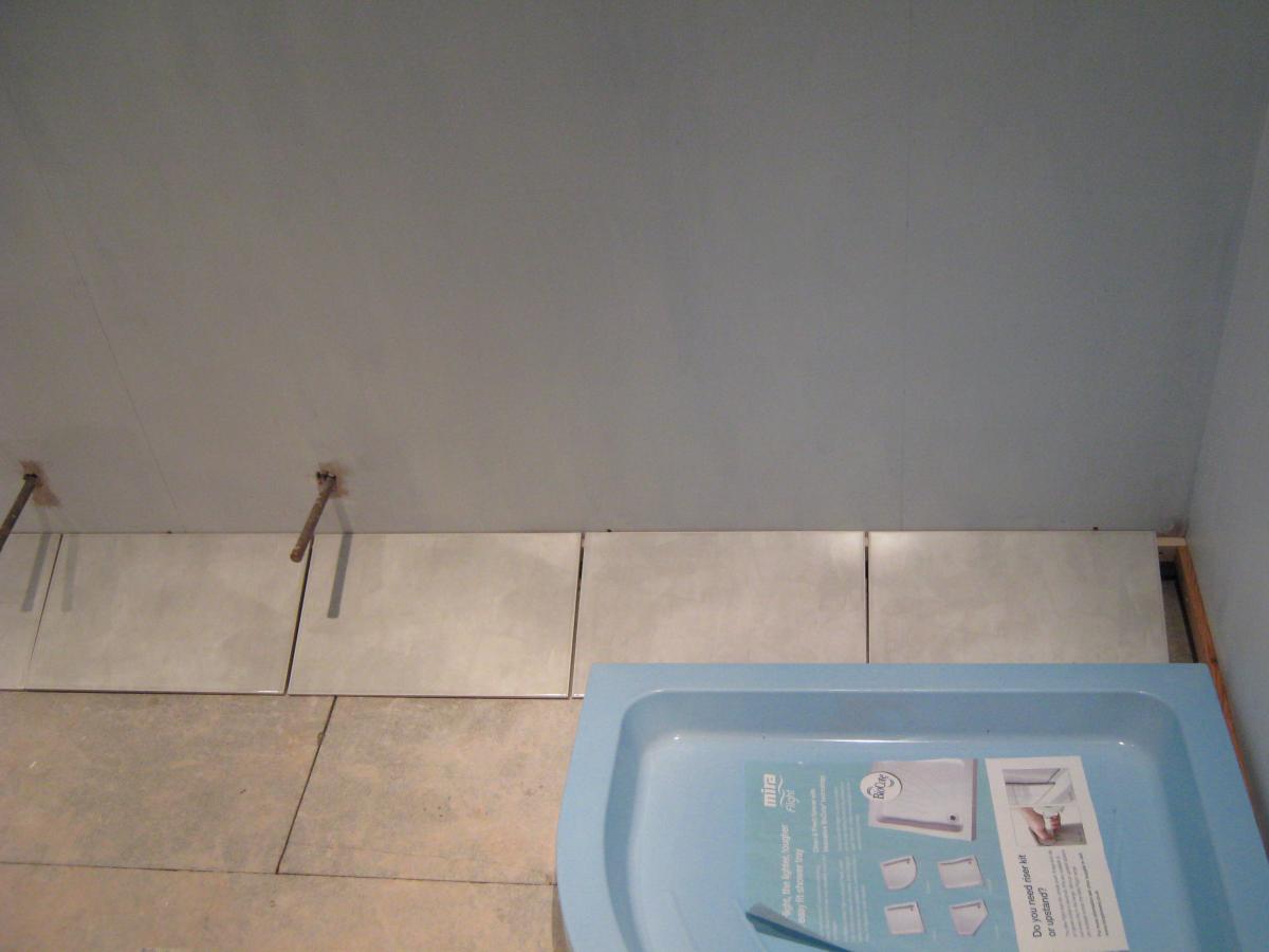

And why you should fit the tray 1st ?
Fit tray and Silicon the area where tray meets wall...SEALED !, Tank the wall, slightly overlaping tray. Extra insurance against water damage !. Tile walls with Cement based adhesive and then seal the gap between tile and tray again. Sorted.
Why not to use tubbed adhesive ?
View attachment 55604View attachment 55605
Neale, you think he's going to be tanking? Did you read the rest of this thread!?! :lol:

Do appreciate the advice, aint got a problem rectifying what will make a sound job, but initially wasn't explanations as to why I should not tile, just sarcastic remarks.
Ok, so now I realise I only needed top half of wall plastering, to late now and advised badly.
so if I remove skim off aqua board and scrub down to plaster on painted walls, this will benefit my tiles staying on. Also when I meant leaving the tray until last, I meant just leaving the lower tiles out, so I don't have to work around the tray.
