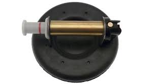

I believe help but frame with suction cups.
120x240 quite six hands and three suction cups (double).
the problems you might encounter. It is when you have the wall to the right or left.
exhausting tile backing to the floor.
problem also found with frame.
images
if rough. uses vacuum

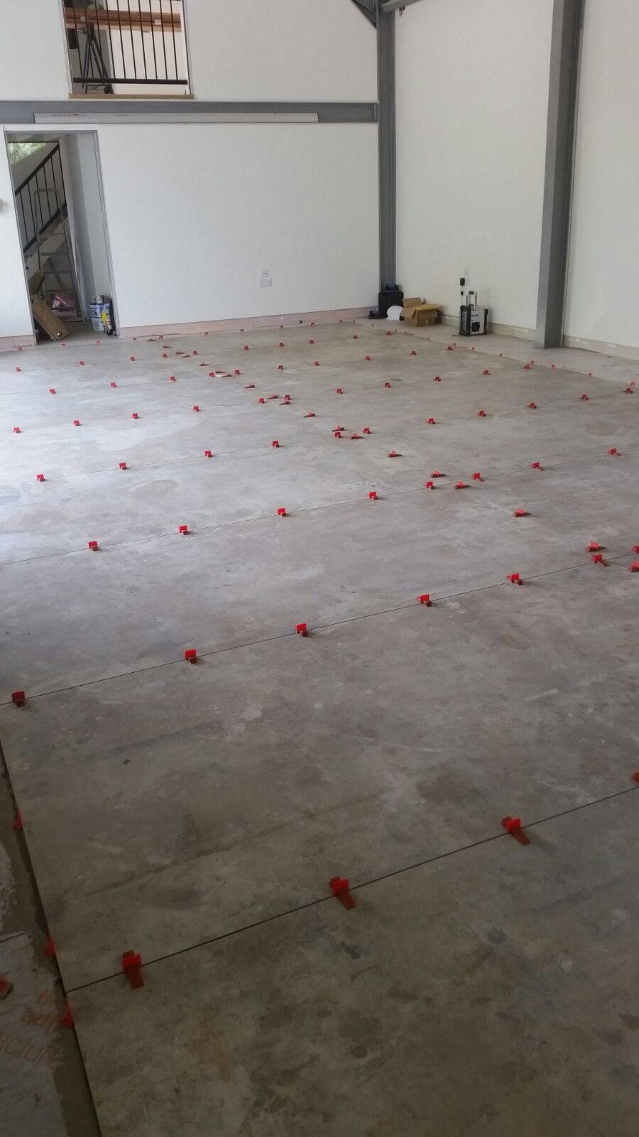

well, i'm a couple of weeks into the job now and it's going very well so far. a steep learning curve for me but i'm just about coping. should be wrapped up next week if the replacement tiles arrive in time. many thanks for all the invaluable advise with this so far. pictures to follow.
