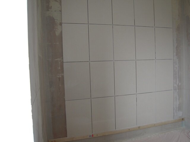

Hoping to get a bit of feed back from those who may have seen this problem before. Just completed tiling my bath/shower area and after this first shower noticed that one tile has got damp (see photo attached). Now then, just one entire tile has darkened down, so I know water has got in, but my question is why and how?
If the grout was not good/failed, why haven't the other tiles around it darkened or show any sign if the water getting in to them? If it was a bad batch of tiles, why hasn't it happened to others? My guess at the moment is that this one tile has a bad glaze on the front and this is how water has got in? Has anyone seen happen to just one tile before?
Specs of the install are as follows:
Tanked with a Dunlop tanking system. Allowed one week to dry.
BAL GRIP adhesive, flat bedded. Allowed one week to dry.
Tile is a ceramic, Piamonte Beige from Topps. 3mm spacings between.
Grout is a BAL microflex. Allowed two weeks to dry.
So where do I go next, allow to dry out and seal the grout/tile or remove the tile and replace?
Thanks in advance.
