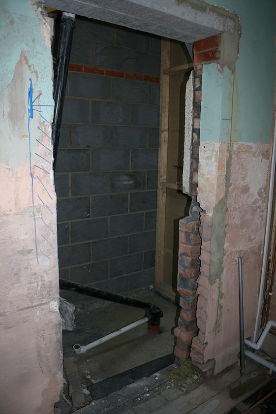

Hello, ok I have read alot of different views over them past few months on wetrooms and it seems to me that there is no golden rule here. Just make sure your walls , floor, are all waterproof... hmm.
Well this is my scenario:

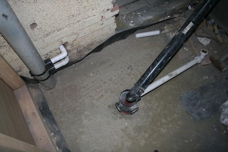

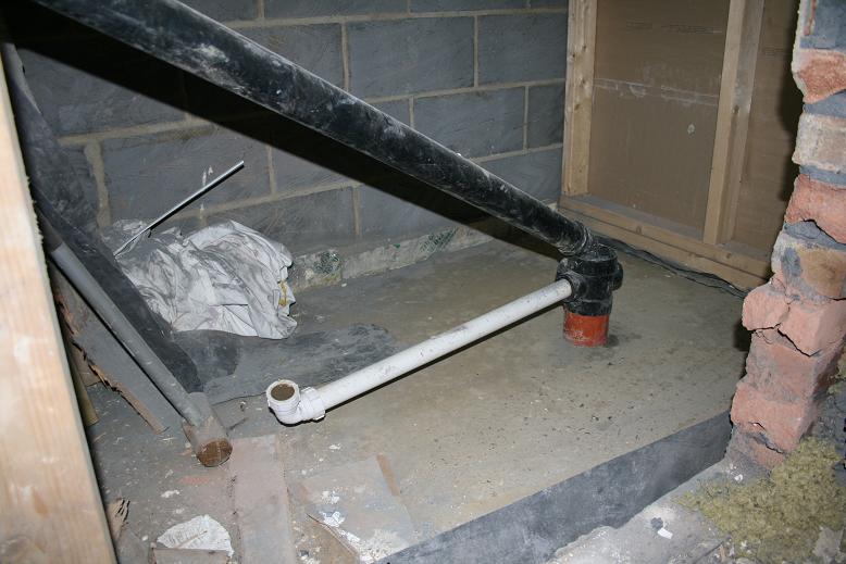

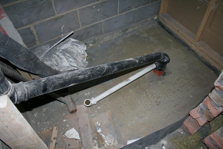

I am now on the second part of my house extension and I'm on the new ground floor bathroom (prevously kitchen). I have had an exterior wall part knocked through for entry to the new side build which will be my new wetroom. Ths consists of a concrete floor (not yet screeded) which is 187cm x 127cm. The change in depth to this floor from existing is 13cm (inc tiles). I have just bought the Impey Aqua grade unit (1050x1500) to go in before I screed the floor. This should give me a consistent tidy slope for my drain. A drain has already been constructed under the sub floor at time of build. This is using a standard waste pipe.
So my dilemmas now are what to use to build the wetroom. Do I need a membrane like the Dura over the screed? Shall I plaster the entire wetroom with normal board and tank the lot or go for aqua panels with waterproof taping? Do I go for the Tilux solution? Does the floor need any further treatment? If I have already got a standard waste pipe in the ground how would the Impey gulley fit into this? Can it be just screeded into place when I do the floor?
I have uploaded some photos to help illustrate what the wetroom (will) look like.
Any help appreciated, cheers.
