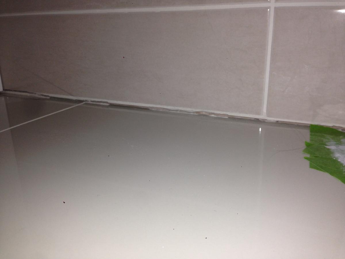

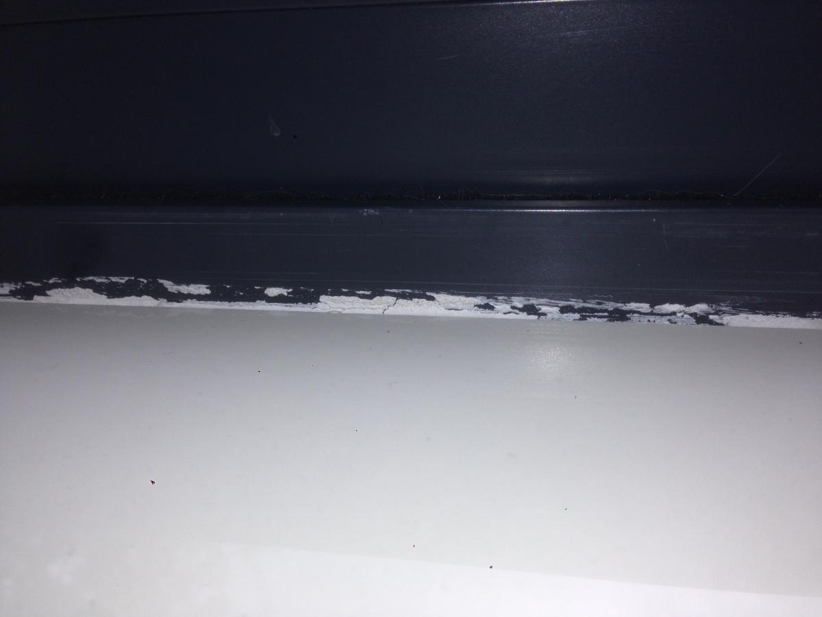

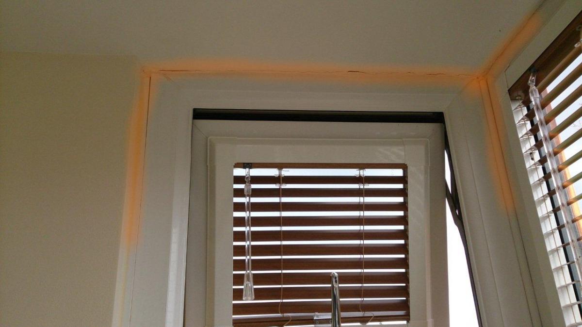

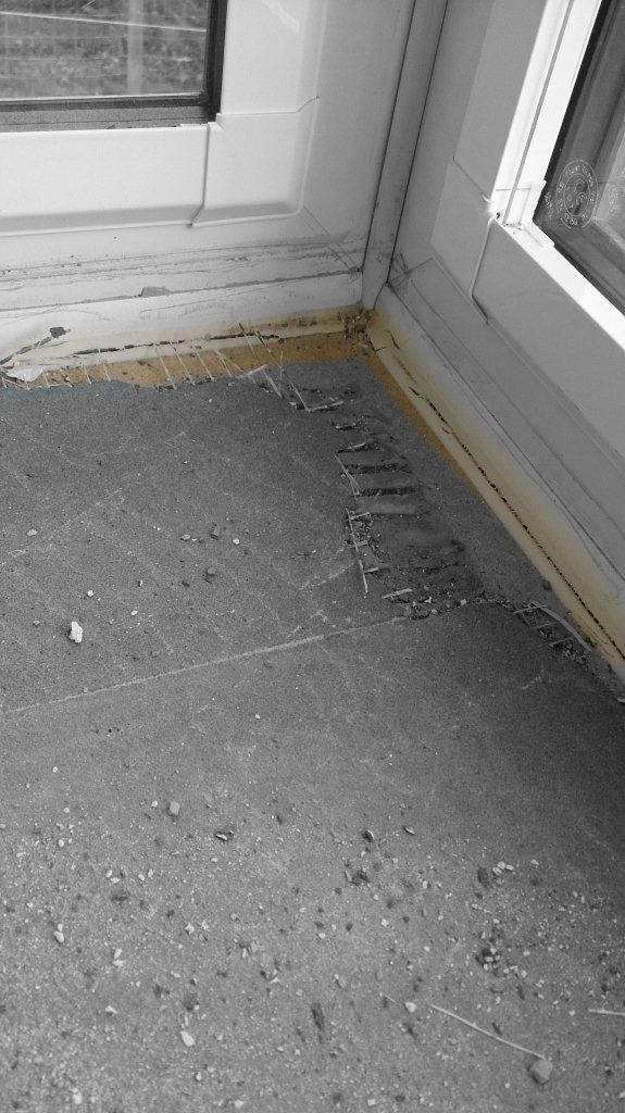

In March time the customer contacted me to say they had a clicking noise coming from the tiles which they suspected I hadn't put enough adhesive under the tiles. I went over and found that the noise was coming from 6/7 tiles by the front door and upon inspection it looked like the floor had dropped 2-3mm by the front door as you could see my grouting had 'split' (pic 1 & 2) I assumed it to be an issue with the sub floor and the customer didn't want to remove all the tiles so we decided to leave it and see what happened.

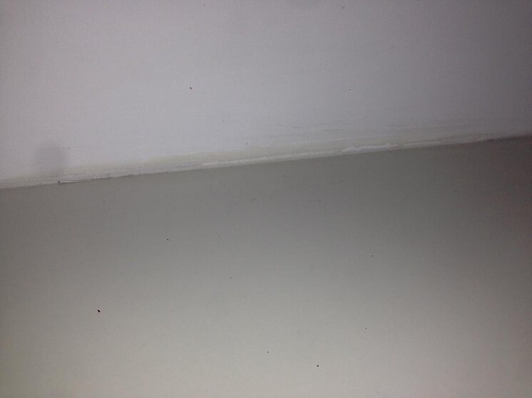

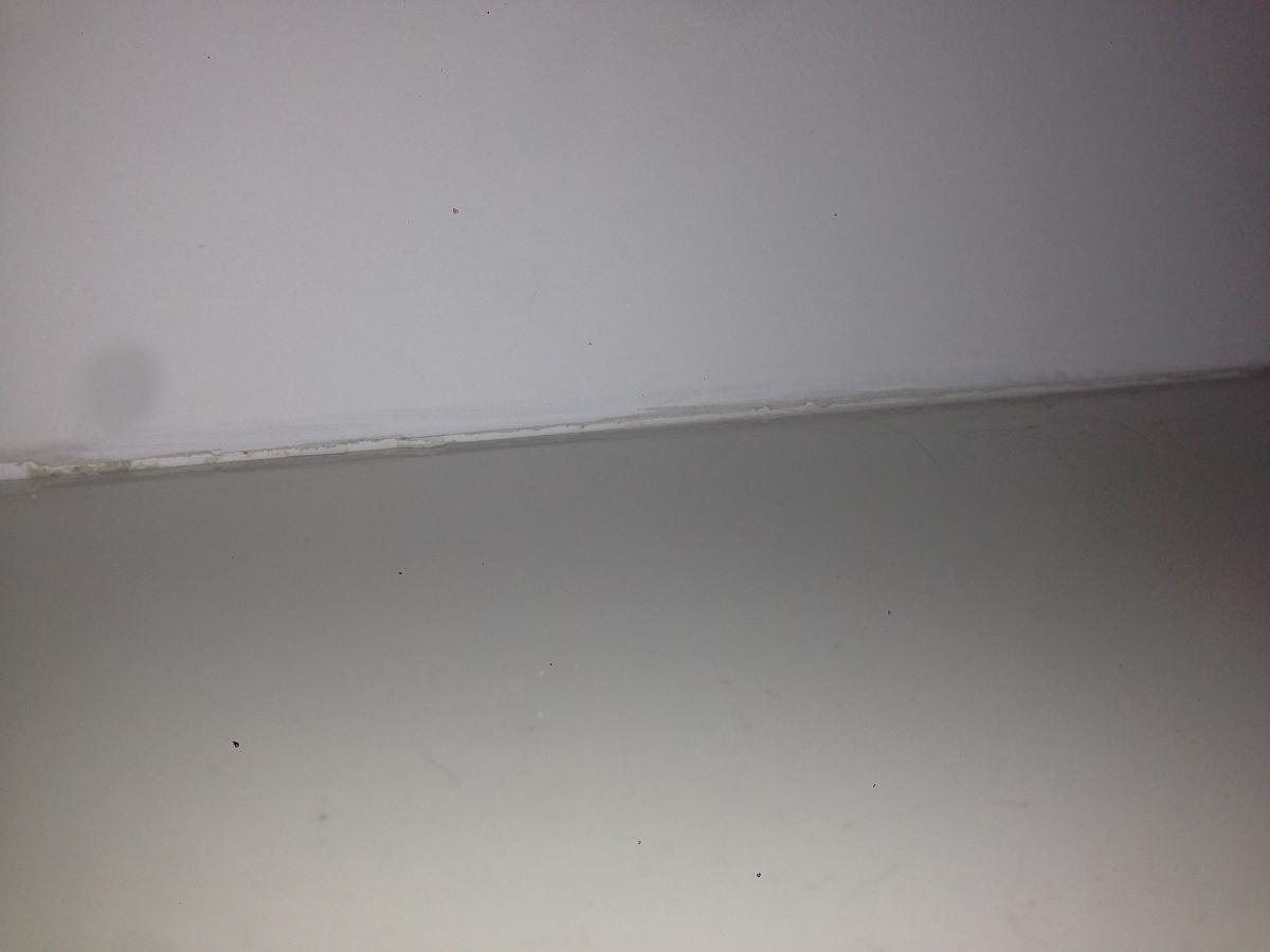

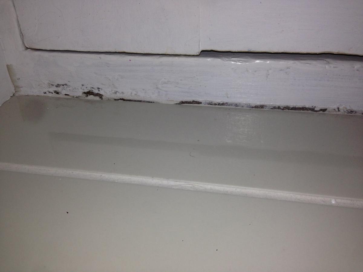

The only thing that doesn't quite make sense is that in areas where I have grouted up to something it looks like the floor has dropped 2-3mm please see pics. In the WC which we fully tiled it the wall tiles have come away from the floor tiles by 3-4mm??
