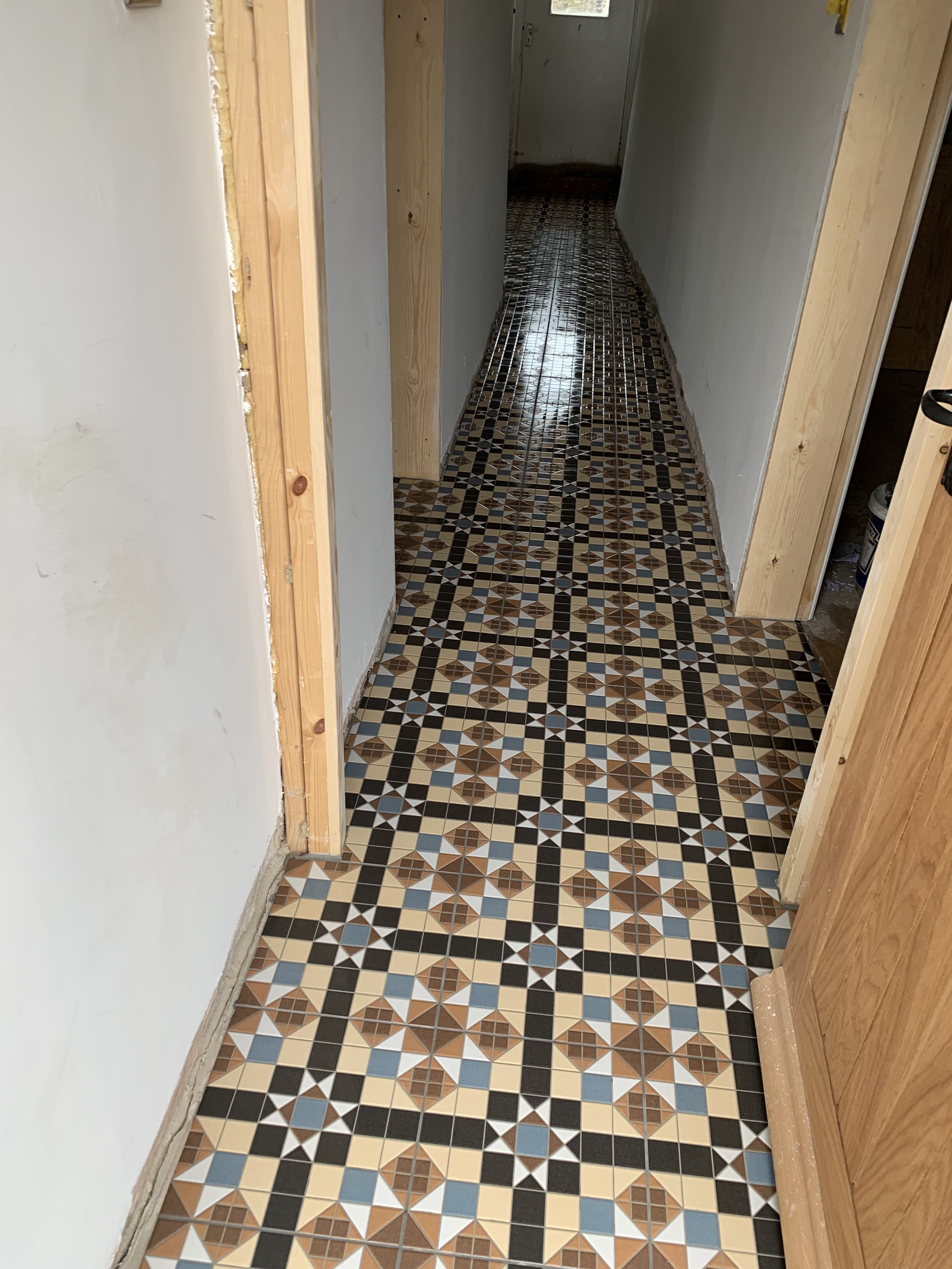

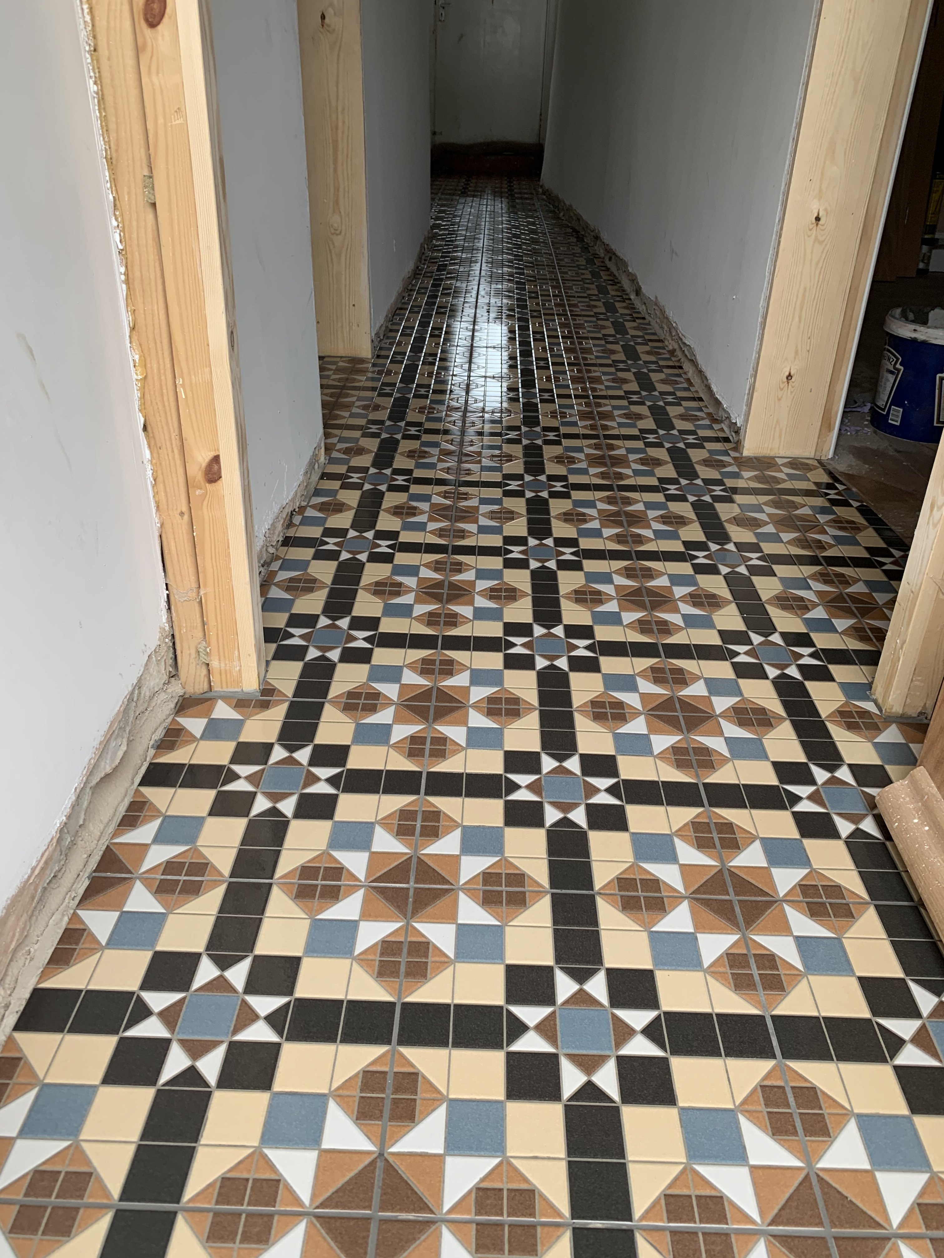

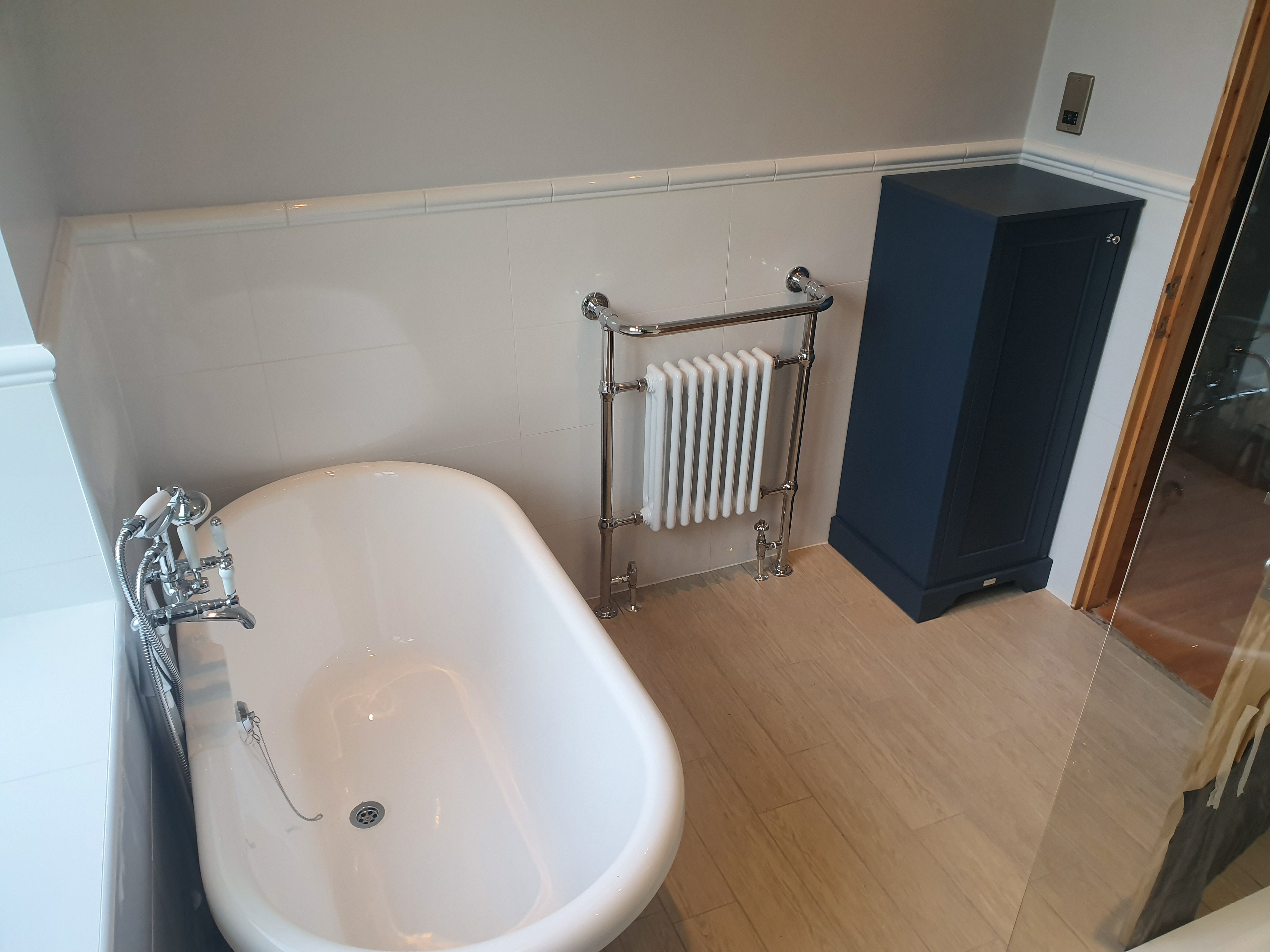

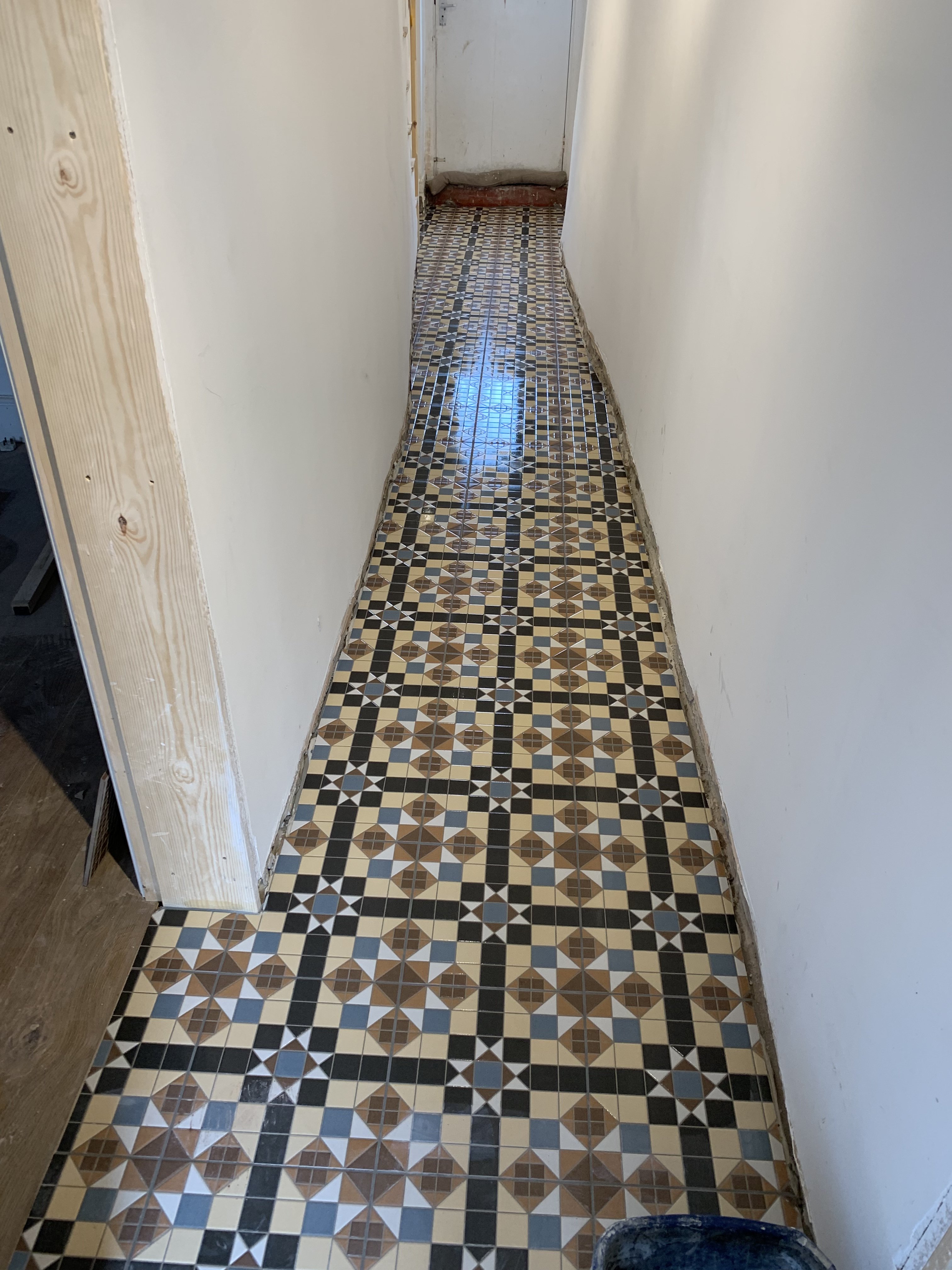

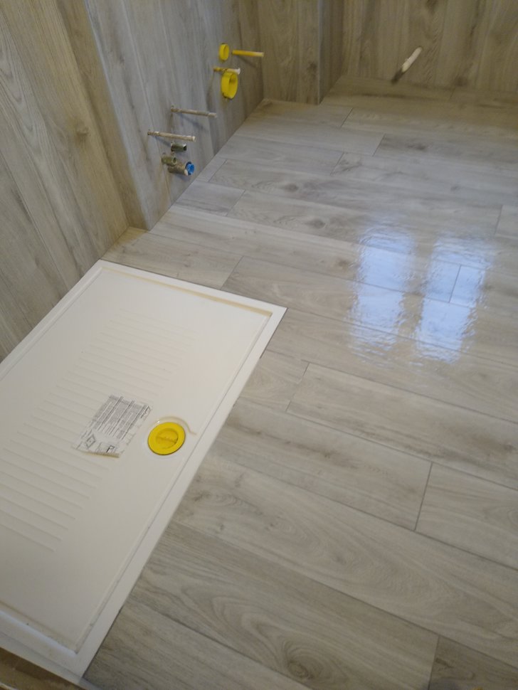

Few pics from a recent bathroom completed a couple weeks ago. I like the units more than the tiling 🤣
P.s I didn't spec the pvc quad trim, customer changed it from a white flat alu trim despite my advise is it not meeting the border tiles right 🤷‍♂️
I apologize because it's still wet, I was in a hurry to go home.

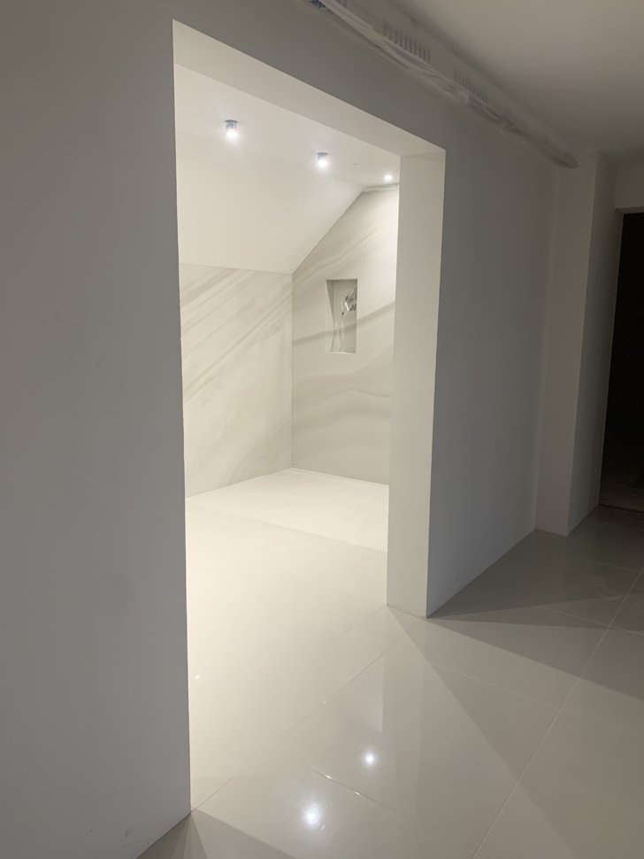

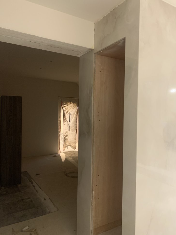

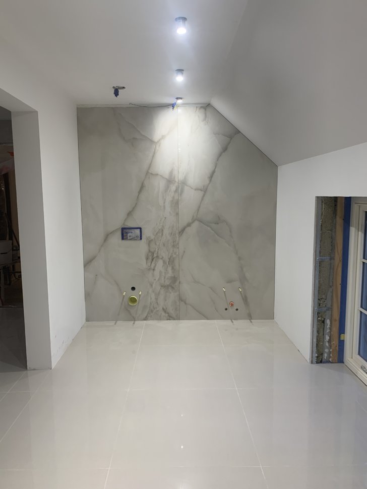

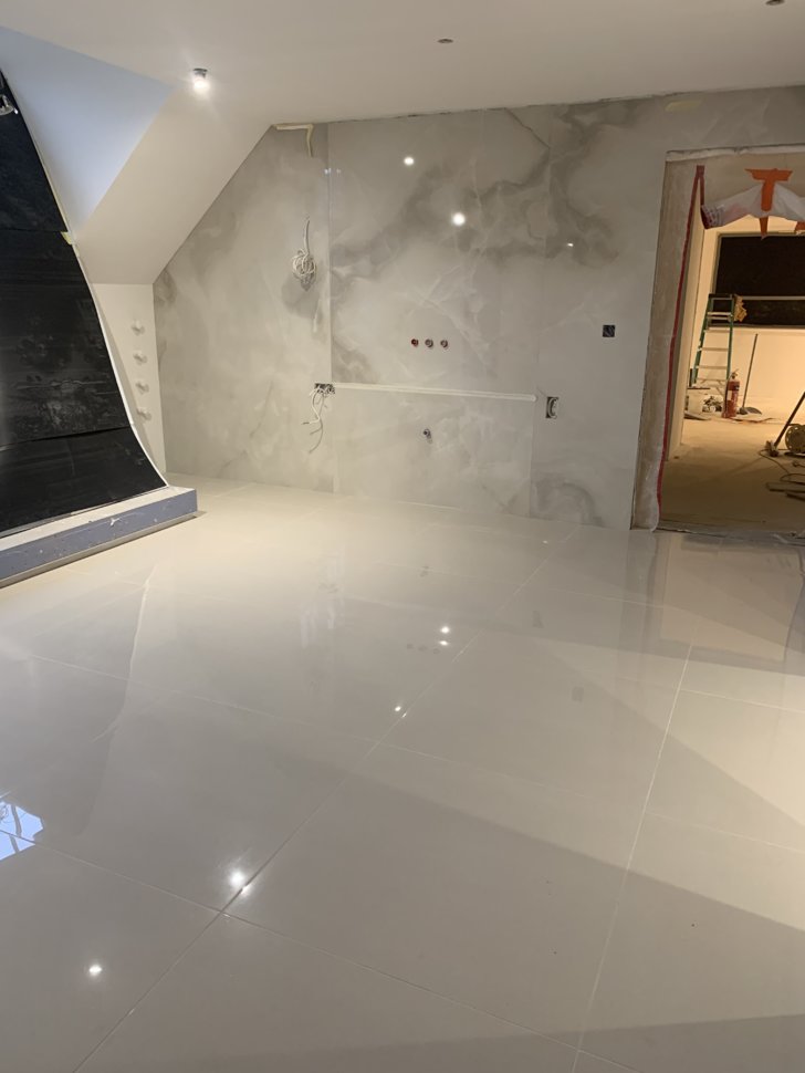

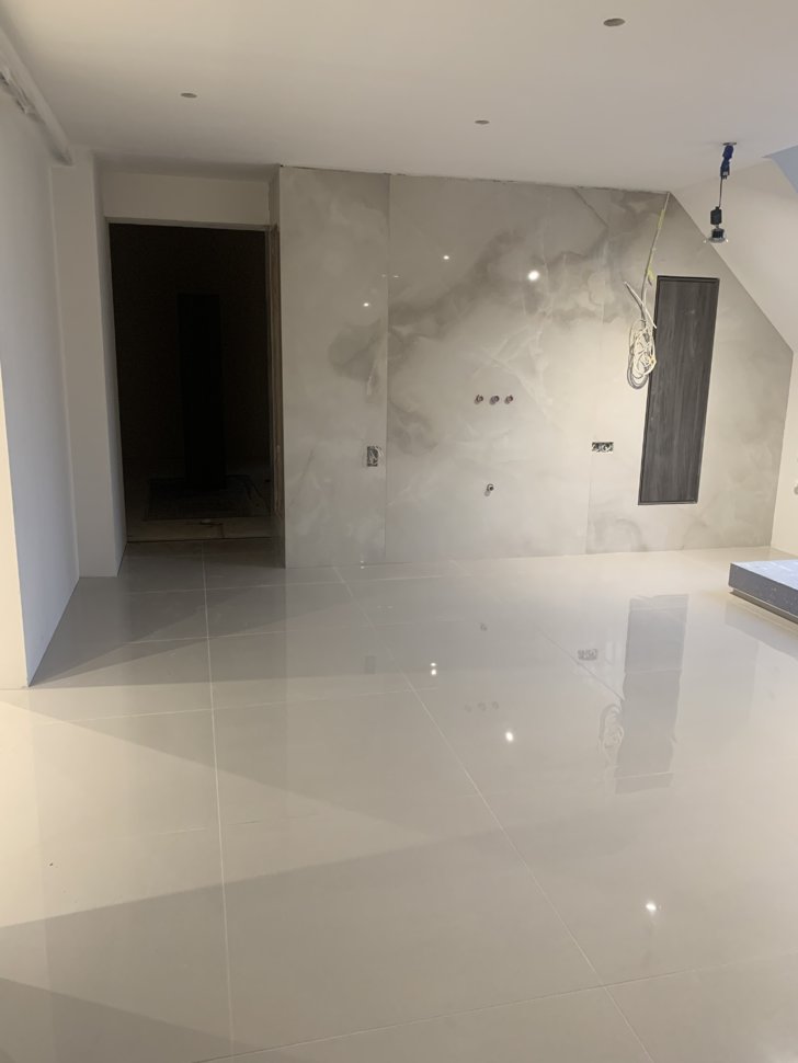

So here’s a bathroom I’ve just completed in Surrey, it’s part of a much bigger project which has been running for a couple of years now, and will be several more months before it’s completed.
This Is the master ensuite and probably the largest bathroom I’ve done to date with a footprint of approx 6.5m x 7.5m
The material is a Florim 3.2m x 1.6m, it was an almost total solo install and was quite a challenge.
Obviously I had help taking material up to the room and I did have help for fitting of four of the panels, the rest however I completed on my own.
All adhesives and grout were supplied by Isomat.
AK25 on floors and AK22 on walls.

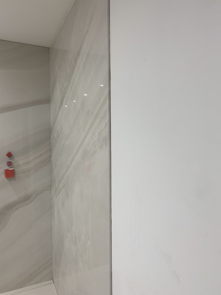

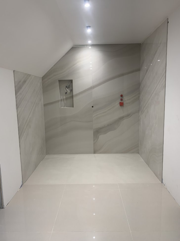

The two ends of the shower side walls are 8mm wide mitred pieces full height to avoid the use of tile trim.
The shower is 2.1 x 1.4m and is enormous, it’s fitted with Kerdi line linear shower gulley.
Floor tiles are 800 x 800 and having four different floor levels to work to made it challenging, hence not all floor reflections are exactly perfect.
