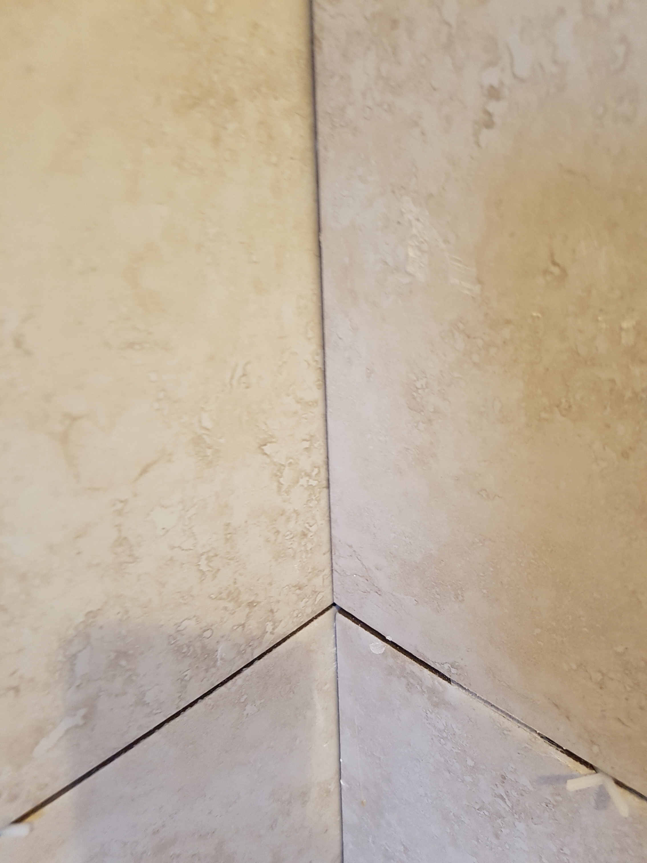

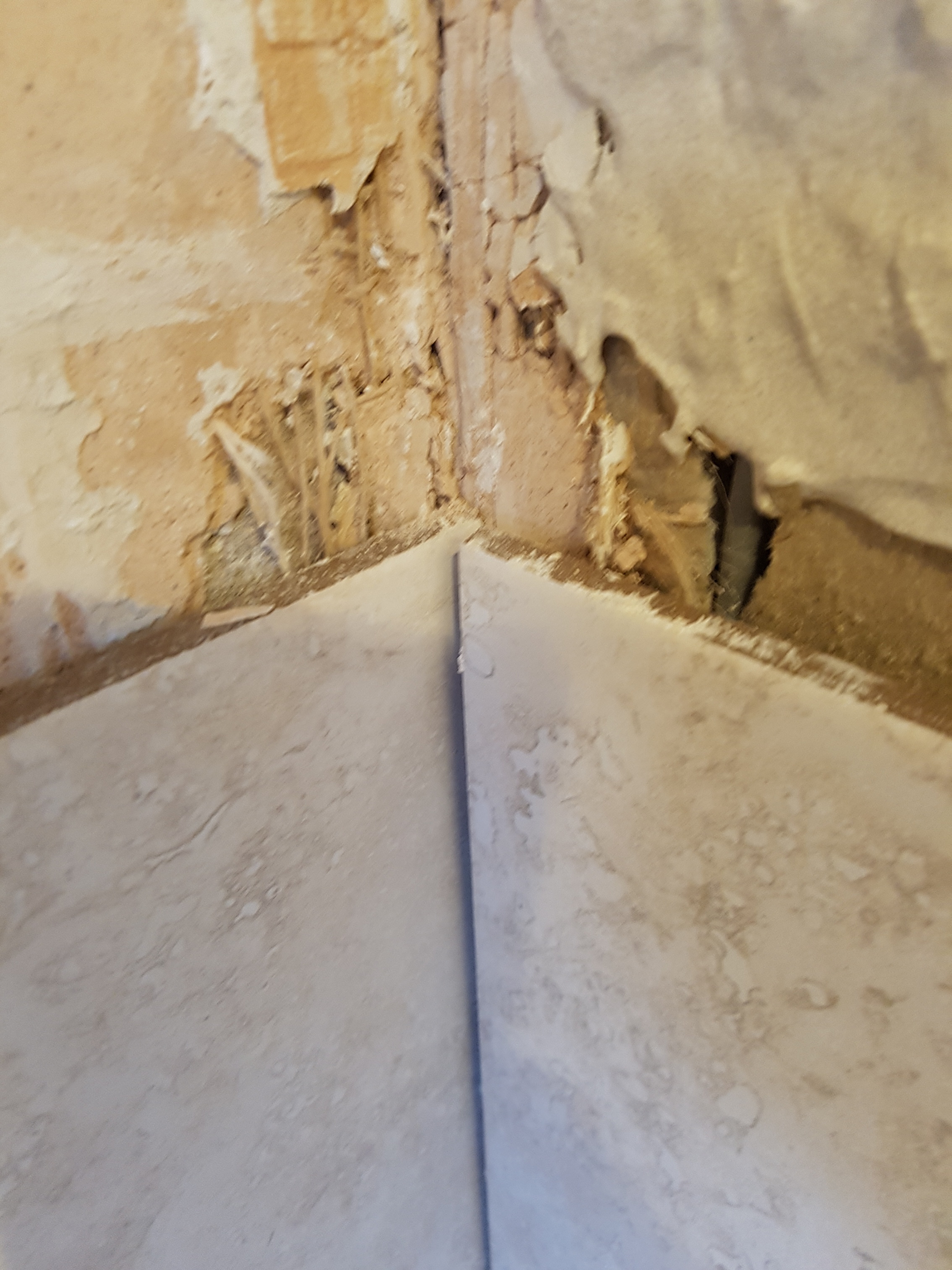

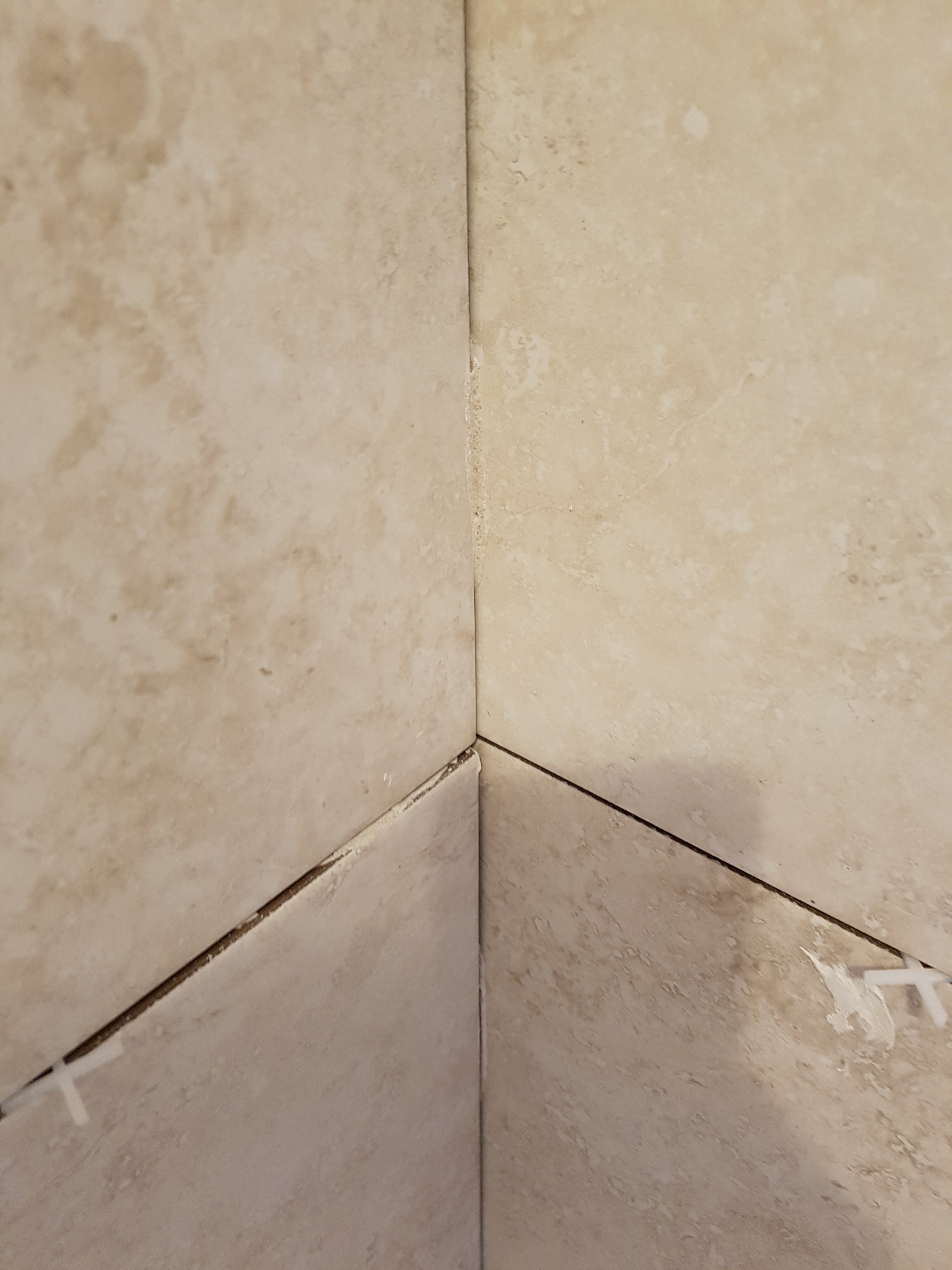

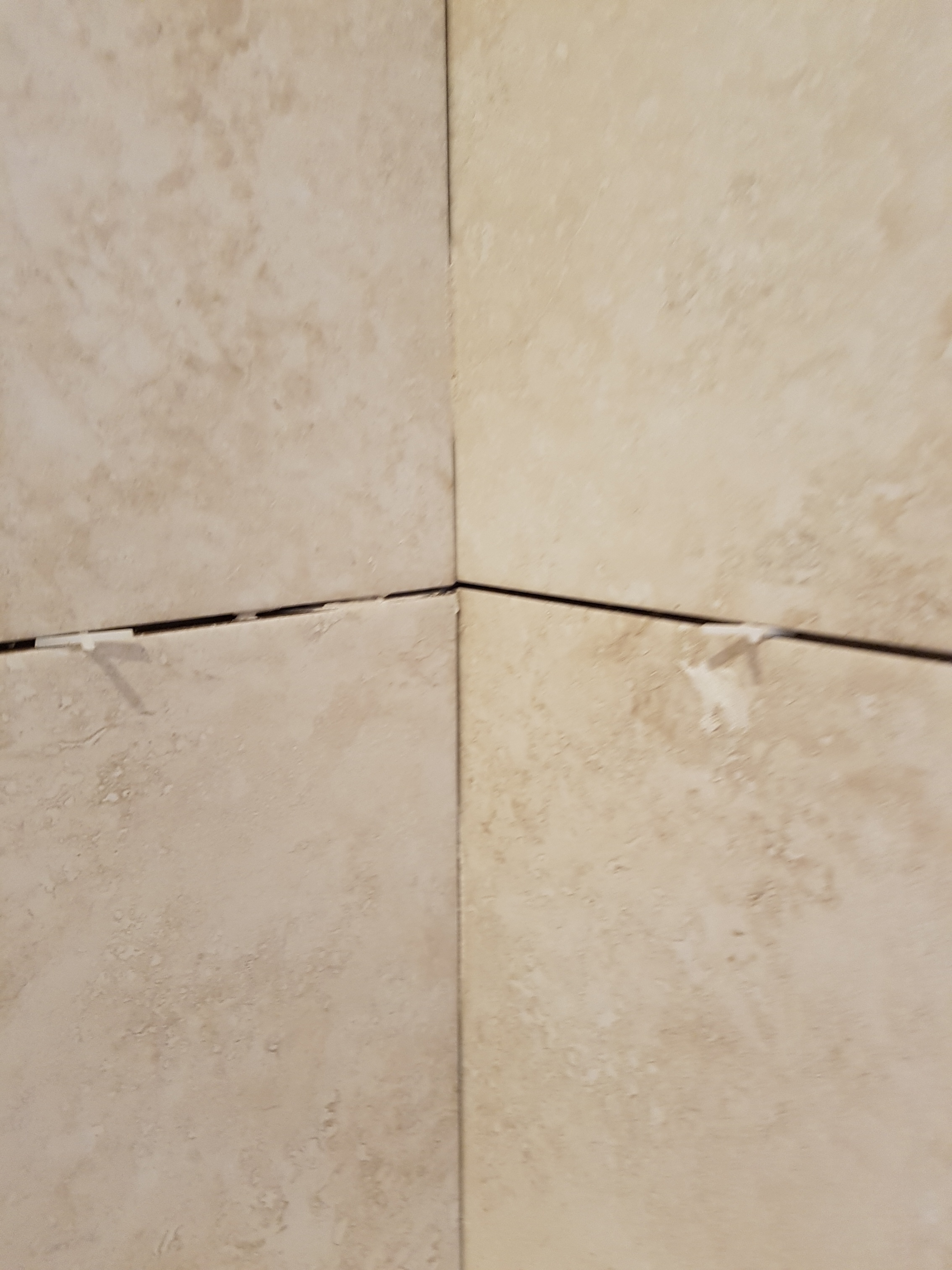

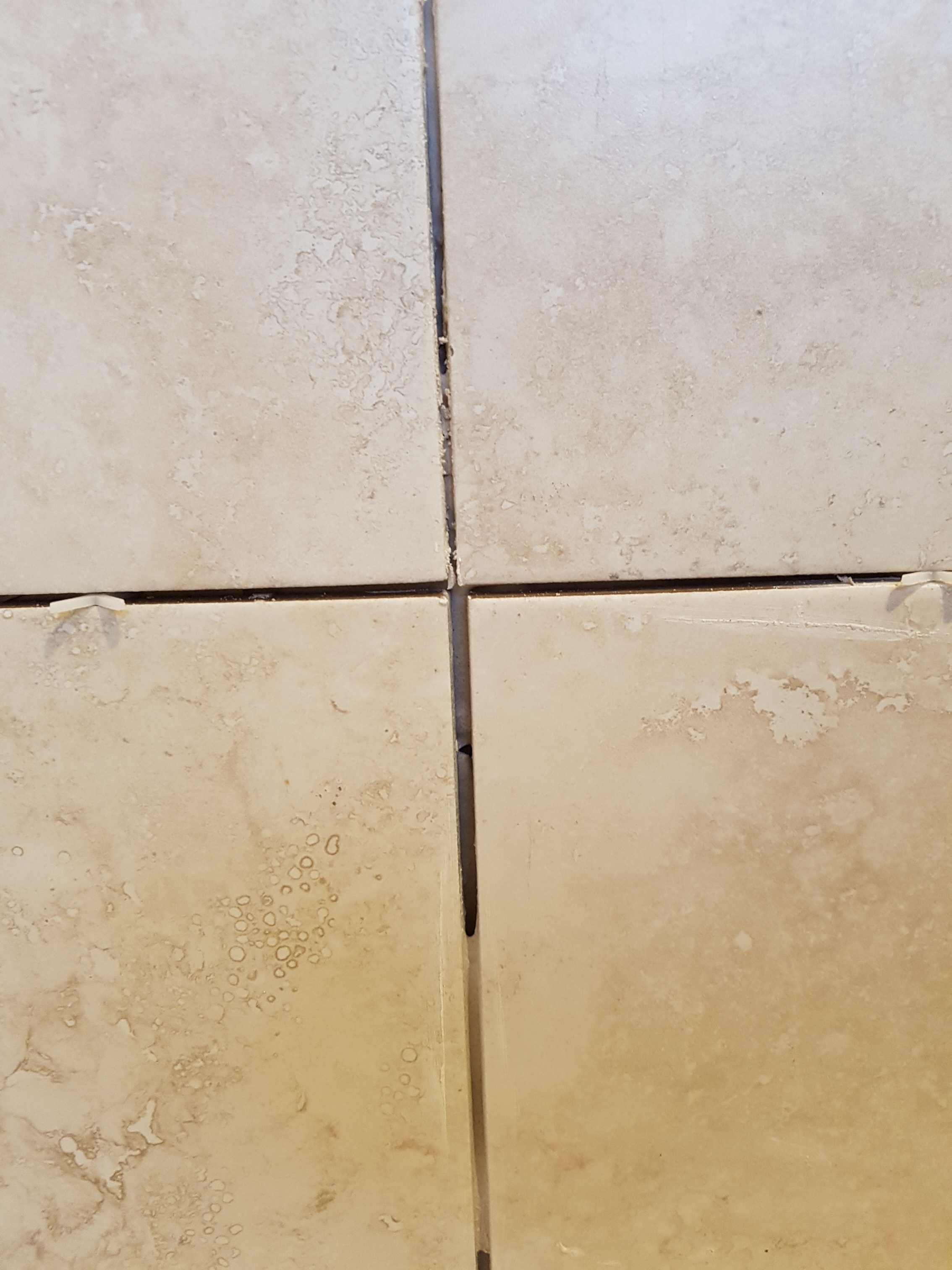

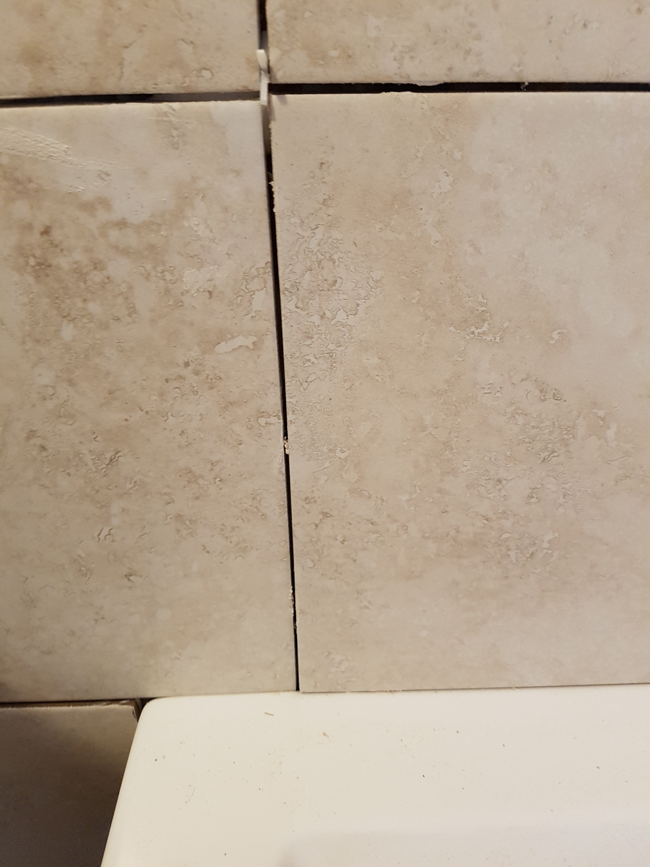

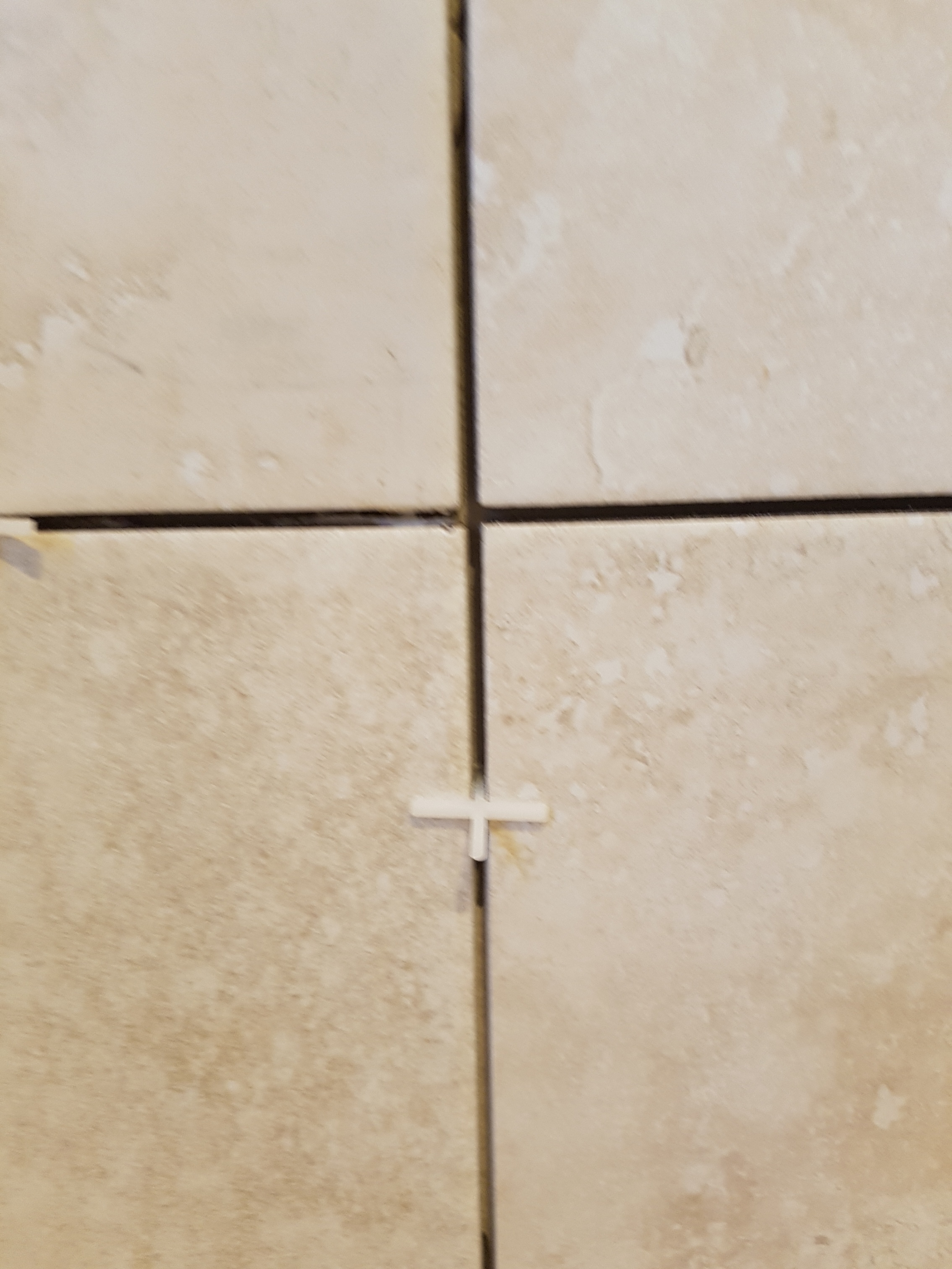

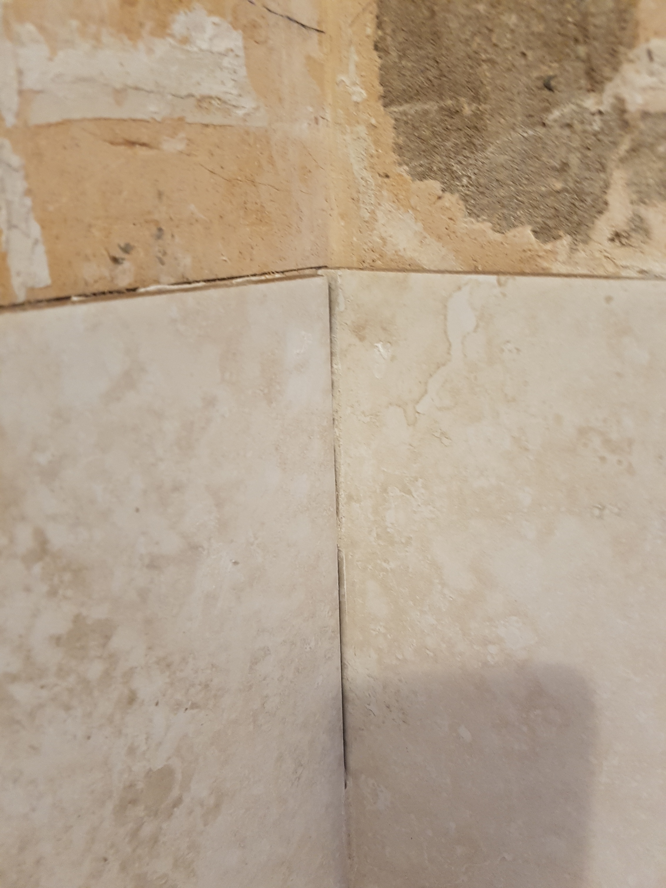

hello looking for some advice.
we had our tiler come and do half a days work today and i am not sure about the work that has been done so far and want to see what you all think before he comes back to carry on with the job tomorrow.
the spacing between tiles looks very uneven and some tiles don't seem to match up. also the wall corner doesn't seem to be right. Not sure if i am being over the top and it will look good when finished.
took some pictures and also picture of the adhesiveness. thank you for your help.
used is this okay to use for a bath shower wall?
your opinions would be much appreciated
Matt Bott
In my honest opinion this is not a good standard at all, i can see the tiles are not level at the bath hence the joint closing and not lining up, the corner heights look different to, wall prep is not great but hopefully a more experienced tiler could advise you further, (cheap tiles can have curves and not be the same size)
