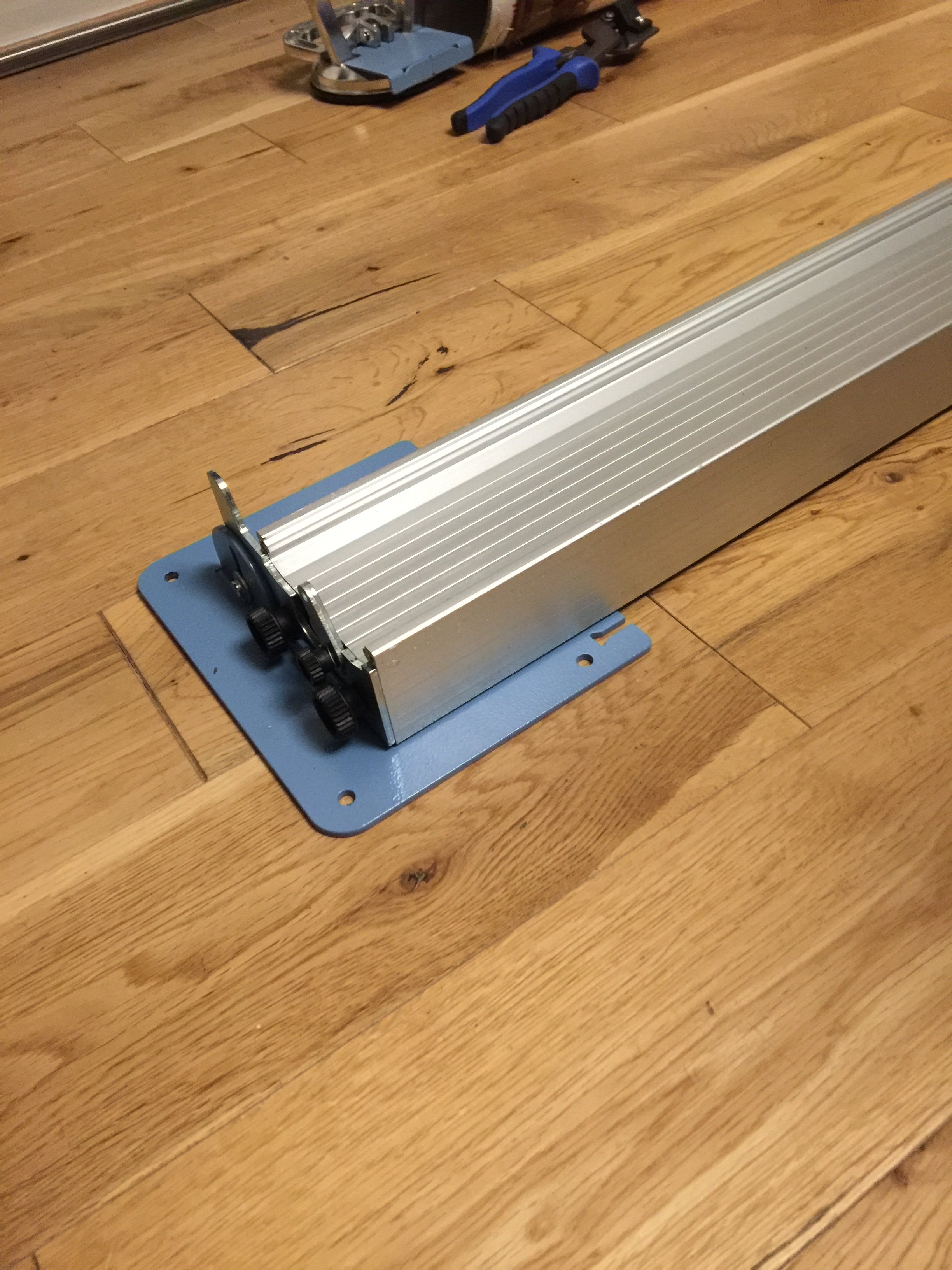

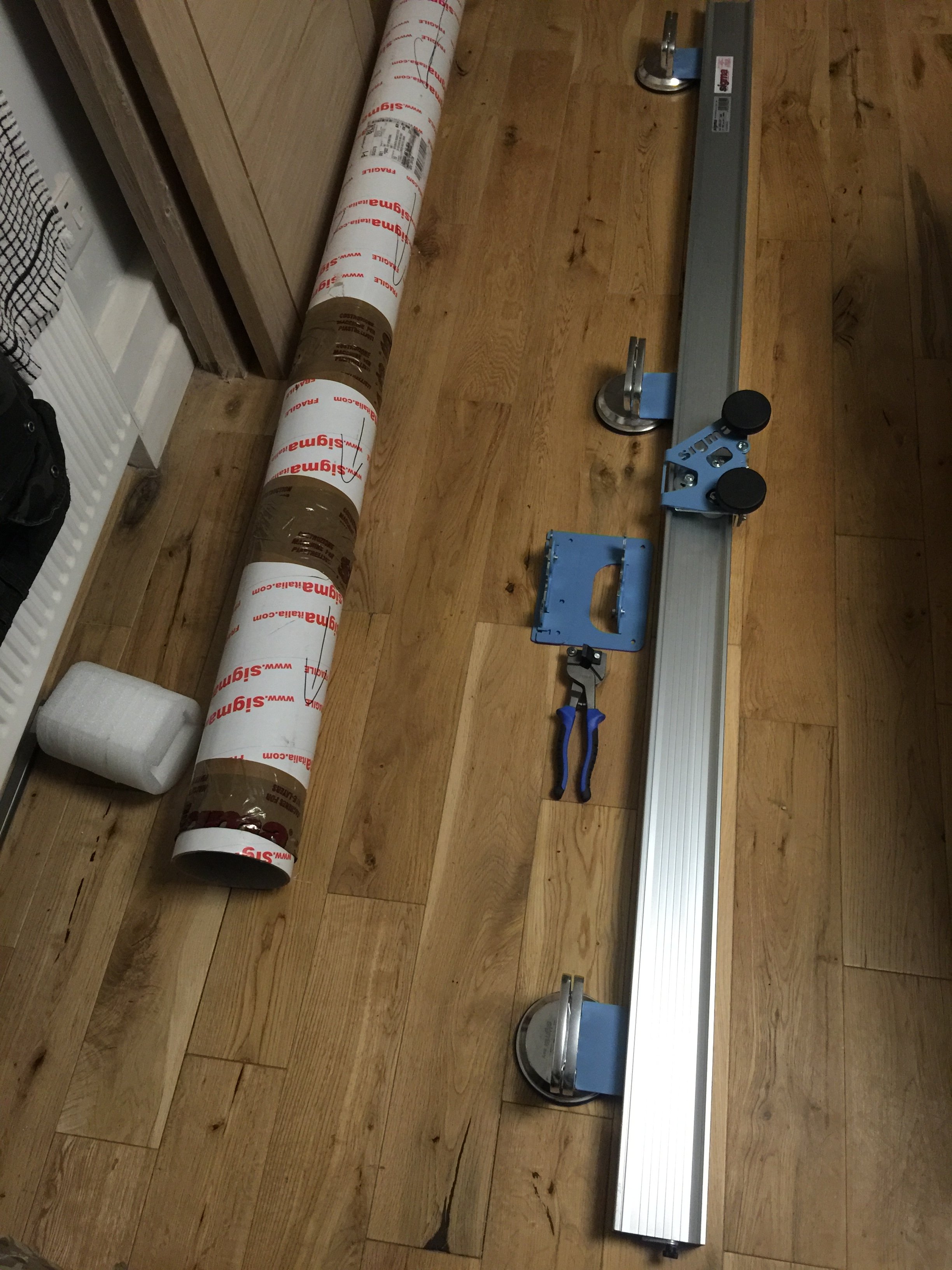

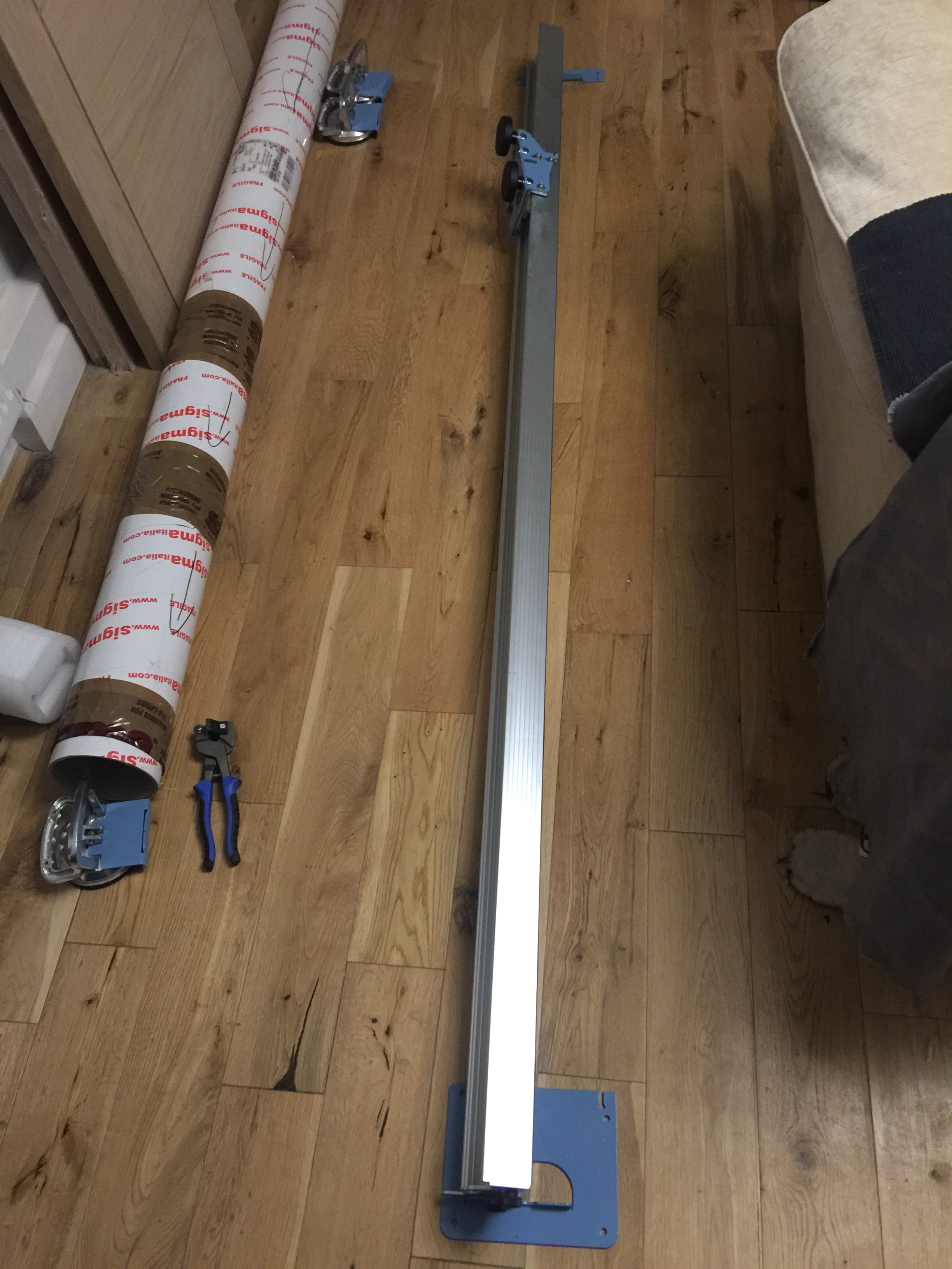

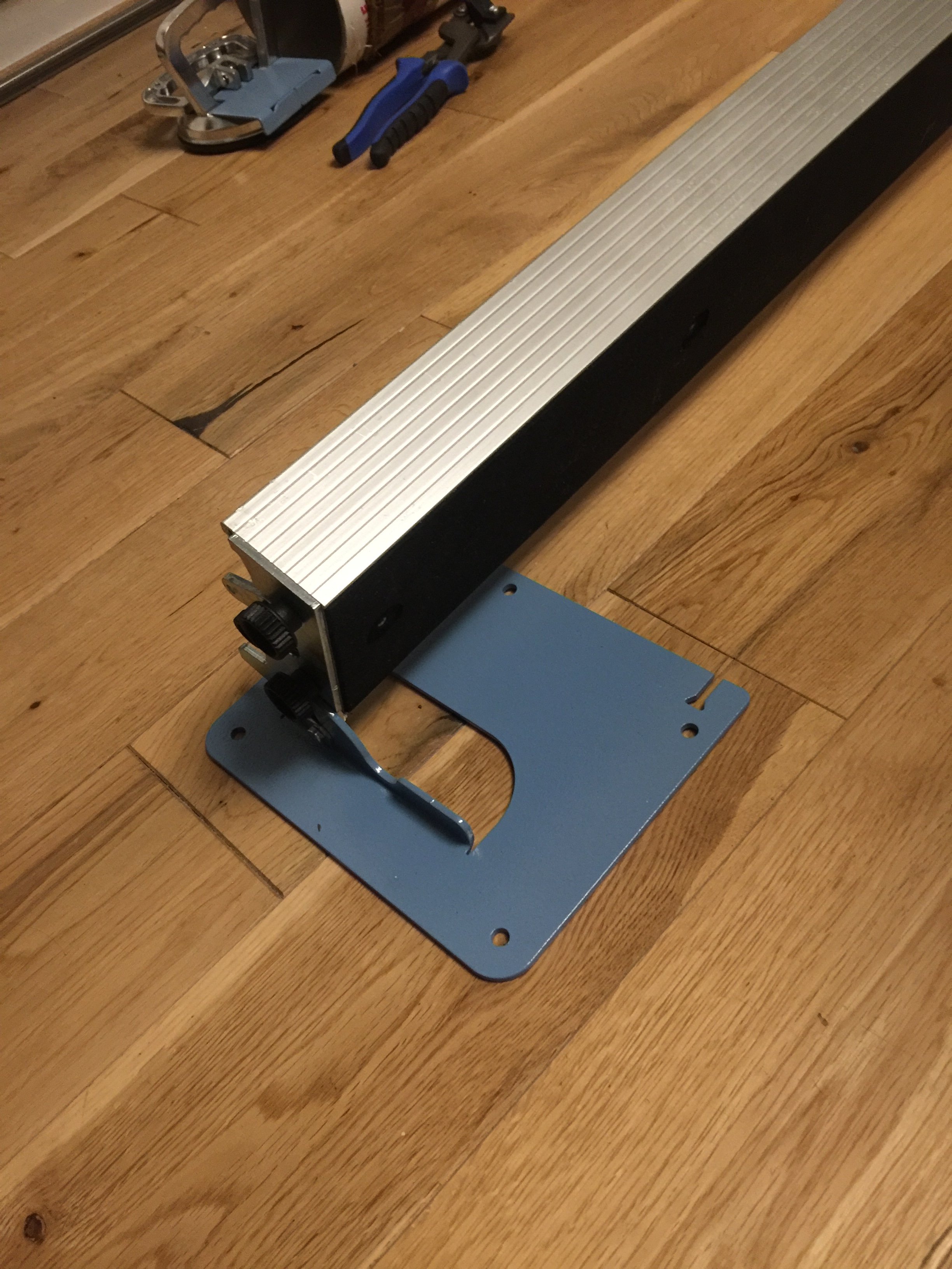

So the Easter Bunny came early this week and dropped this off to me,
and as I've got an 1800 x 900 on Wednesday, I reckon it might come in handy.
It's the Kera cut 8DE 2010 extendable rail with fitting kit.
Looking forward to giving it a whirl. 🙂
I have used one and also have one on the way Marc! It's a great piece of kit and while some may argue in favour of the Raimondi, I find the Sigma kit to be the same as the cutters - sturdy, simple and dependable.
Raimondi is good, but over-engineered in my opinion.
(You'll want the wind-in breaker - Art 41D for anything over Porcel-thin thickness though)
That makes me smile Mark, I know of some who say the same of Sigma, being over engineered.
It is certainly sturdy and I like the way the connecting bar is constructed.

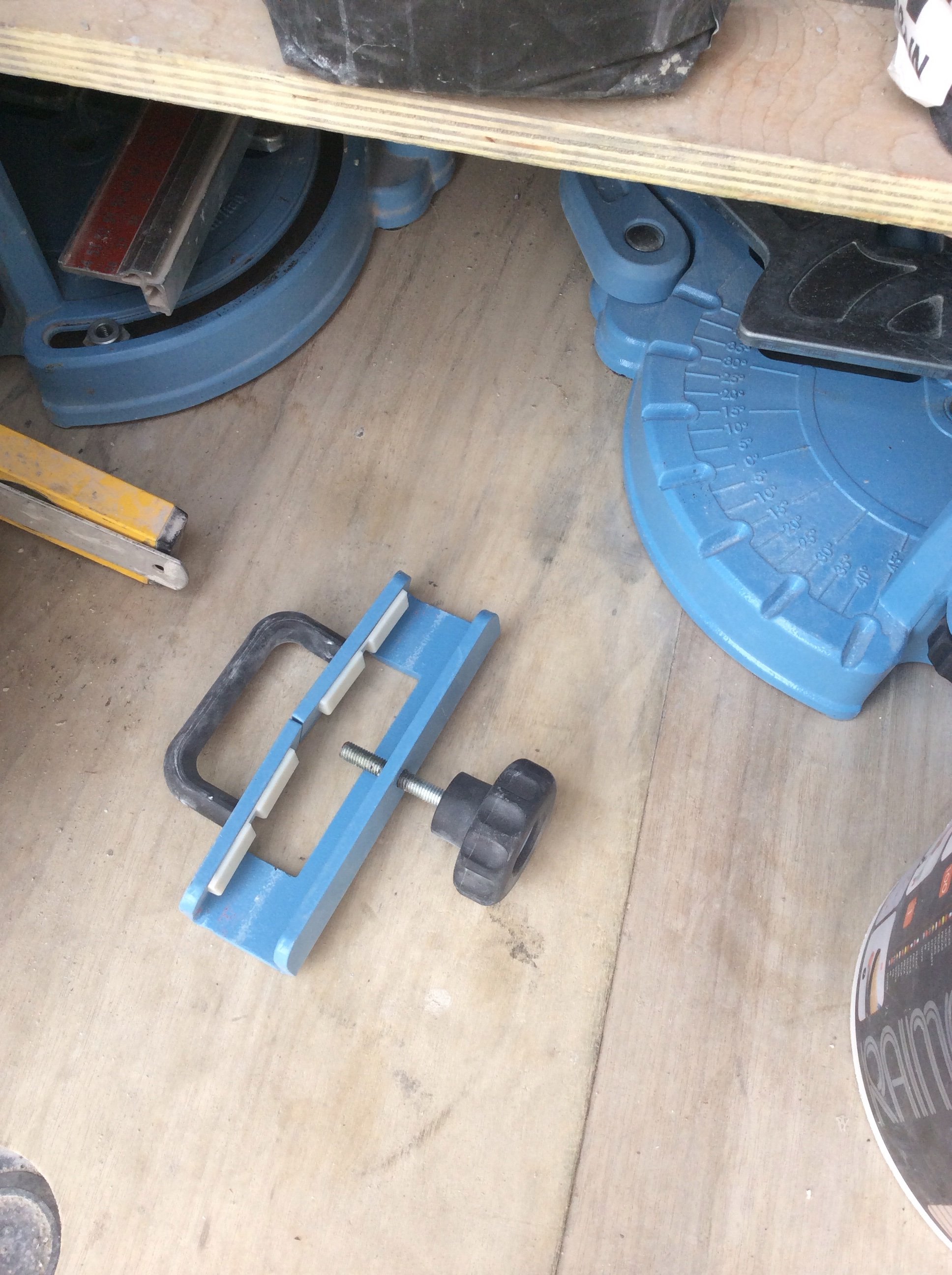

The breakers that come with it are pathetic tbh, and the Montolit version would be a much better option imo.
I've comfortably broken 12mm with those, and for less than £50 I think they're worth every penny.
I'll probably go the whole hog tho and get the heavy duty breakers that Montolit do, I like the interchangeable base plates.
