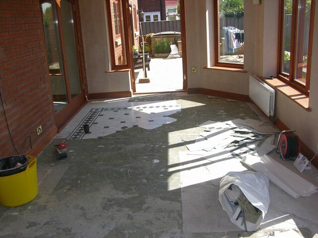

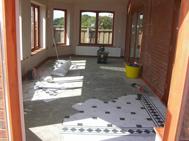

conservatory pics before i tile it
F
formula one

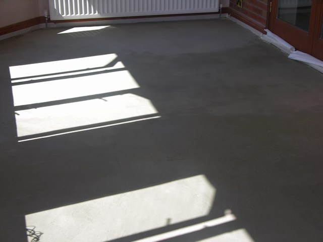

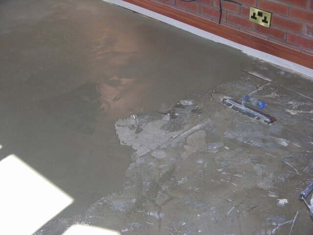

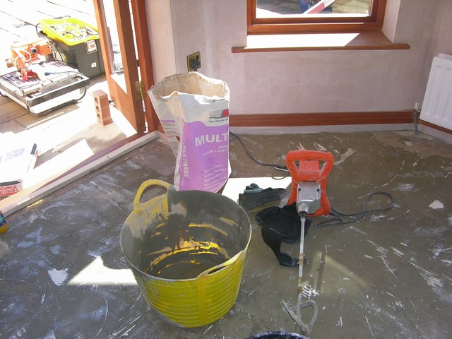

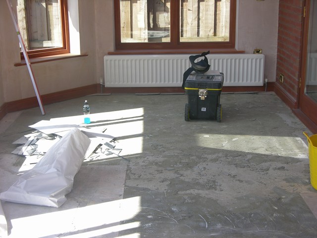

going today to lay the self leveling compound will post more pics when the job is done🙂

Re: conservator pics befor i tile it

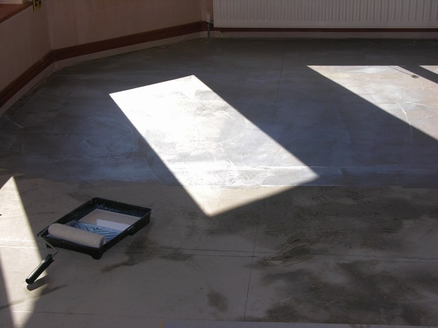

how thick will your self level be ? i've not used the stuff yet. looking forward to the pics

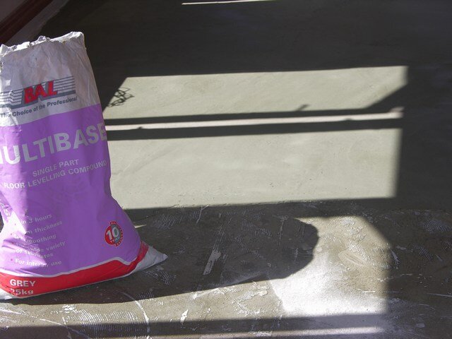

i went for a 1m cover the floor was not that bad in the end 25 foot by 10 foot i used
bal multibase floor leveling compound and bal pva post the pics up of the tiles going sunday to start laying them 🙂 steve f1
I hope that was a mis-print there f1 mate..lol lol..bal pva...tut tut.......dave....
Fantastic images F1...I'm loving this tutorial for the newbies.Let's just hope the customer dosn't insist on BAL Microcolour Emerald grout !just to spoil the party..lol
lol im not doing green thats for sure never ever :icon9:
dave it was palace multi purpose primer and boading agent i used

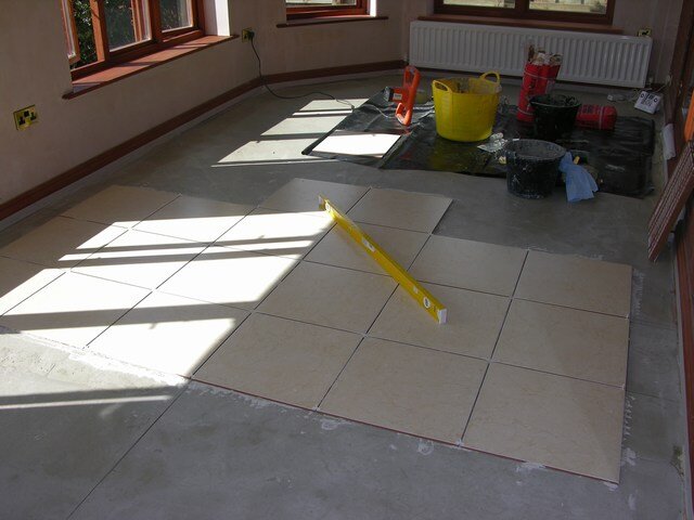

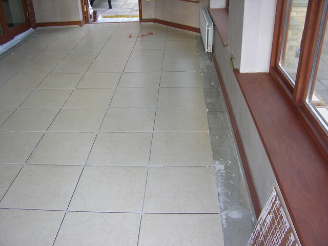

tiles going down are crema marfil 45cm by 45

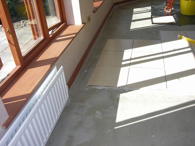

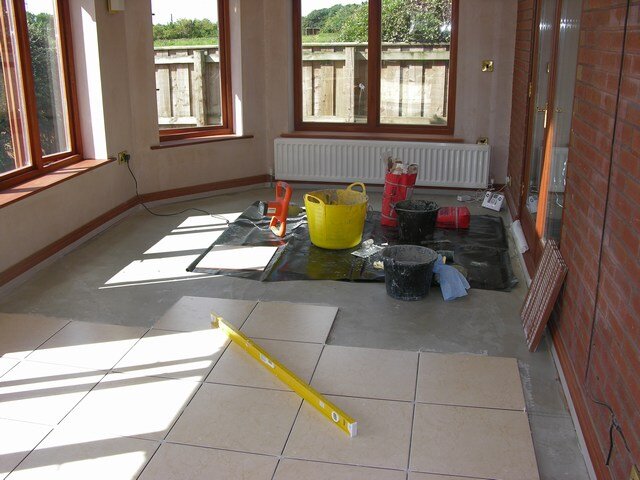

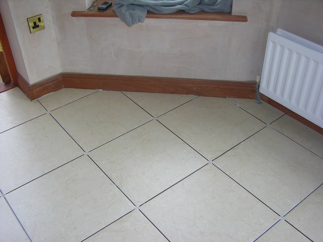

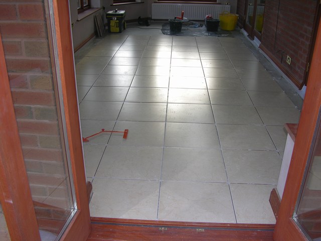

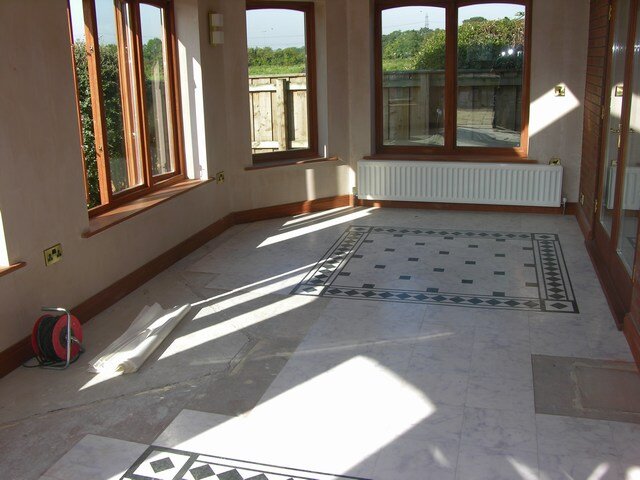

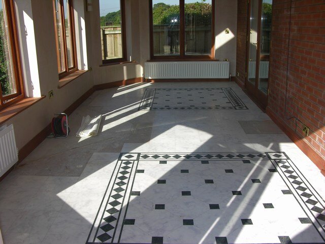

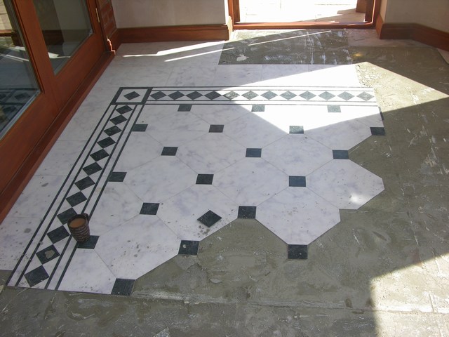

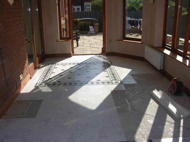

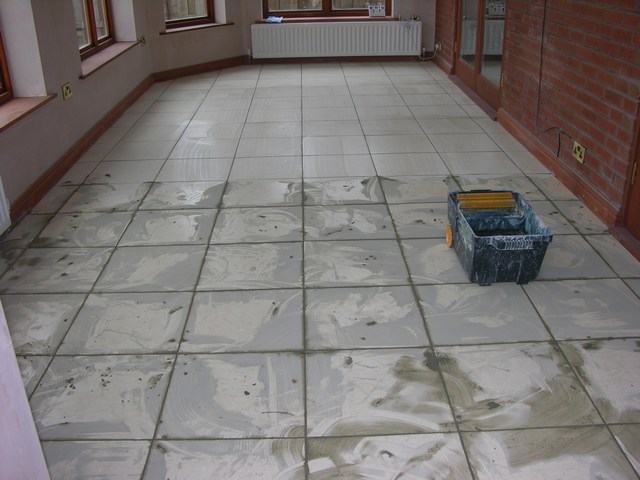

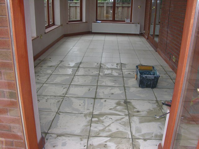

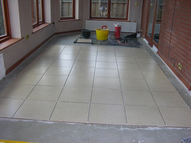

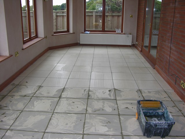

well the tiles are going down some more pics of the job and yes im working mon :icon8:

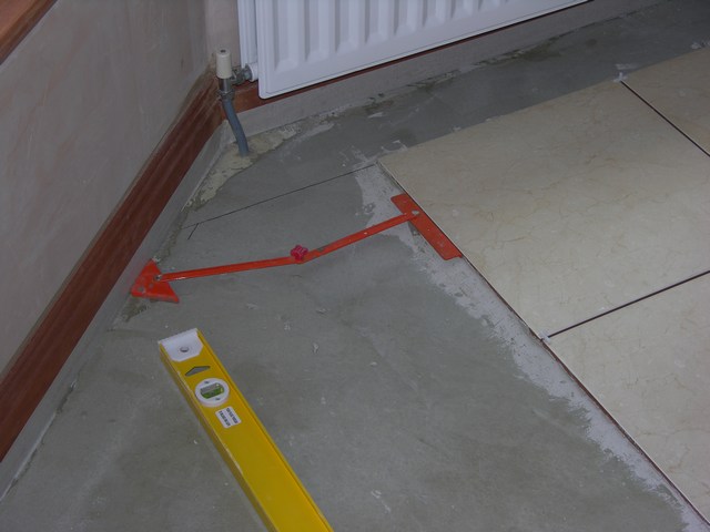

Looks like a nice job there F1. Is that one of those funky RUBI angle finders I see there? They obviously work!
Grumpy
yep if u not got one get one Grumpy best bit of kit in the tool box for floors🙂 steve f1
do you not put the cuts in as you tile? i find it much quicker that way and easier than trying to serrate in small spaces

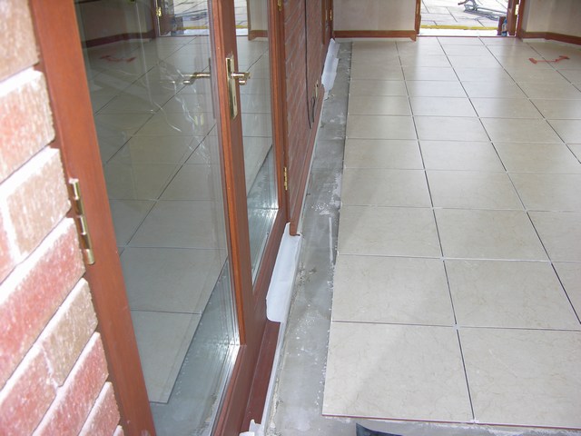

formula one, I noticed you seem to have put masking tape around the skirting boards which I presume is for protection. how would you get this off once you have finished tiling? This is a newbie asking, so pardon my ignorence.
Tony
Looking good there Steve, very neat on the cuts, As wayne says put the cuts in as you go along, the best way is to dry lay the last full row of tiles, then cut all the edge cuts in and number them, take up all of the full tiles and the cuts and trowel all the adhesive in then lay the the full tiles back down and the cut tiles against the wall, much quicker and easier, stops messing about trying to get the trowel and adhesive in the last edge bit.
Keep up the ggod work
wayne i have 5 days to finish this job so no rush i dry cut then mix my adhesive🙂
darren thanks mate im still trying to get it right thats why i rang you but im getting they :shades_smile:
tony i have left room for the tape to be removed befor i grout the pics may not show this :wink_smile:
Good work f1 and good comments from Darren and Wayne,Darren had run out of the angle finders when i was on the course in March still not got one but will get one asap.Keep up the good work matey.🙂
Where can you get those rubi angle finders from? looked on the net but can't find them.
Mat
doesnt need tobe rubi one..this is just as good...dave...
[DLMURL="http://www.tradetiler.com/acatalog/tilie_cutter_setting_out_and_tile_marking.html#aT5"]TradeTiler.Ltd Setting Out and Tile Marking[/DLMURL]
We sell the rubi one that steve uses at £14, look on the nett tools page, there is a link to it on the forums home page
Good work f1 mate,Bri get that angle finder mate,awesome on diamond formation floors couldn't cope wthout it.

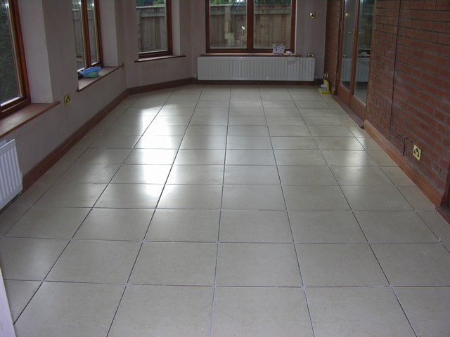

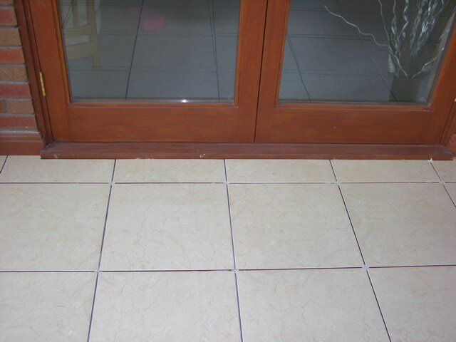

well tiles are down back tue to grout up pay day🙂 thanks for all the comments lads:wink_smile:
looks well f1 mate..post pics of finished job to compliment these .....dave...

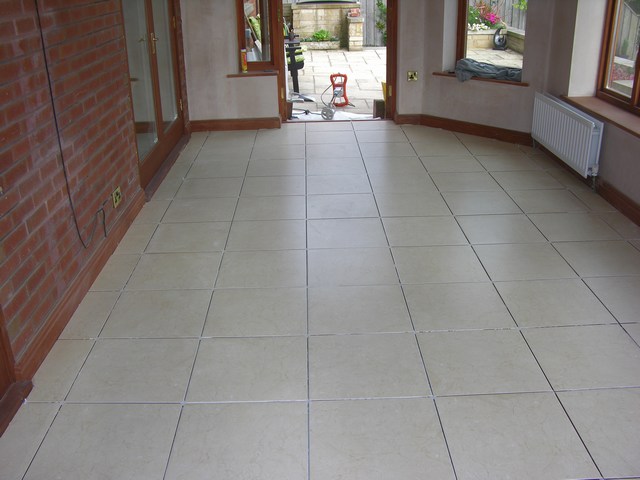

Nice work F1 any chance of showing those cuts around the radiator

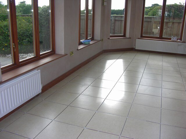

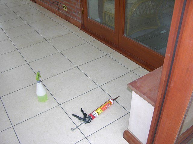

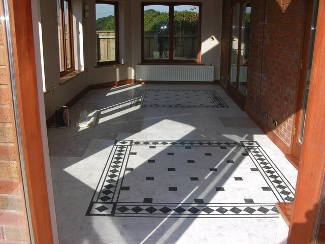

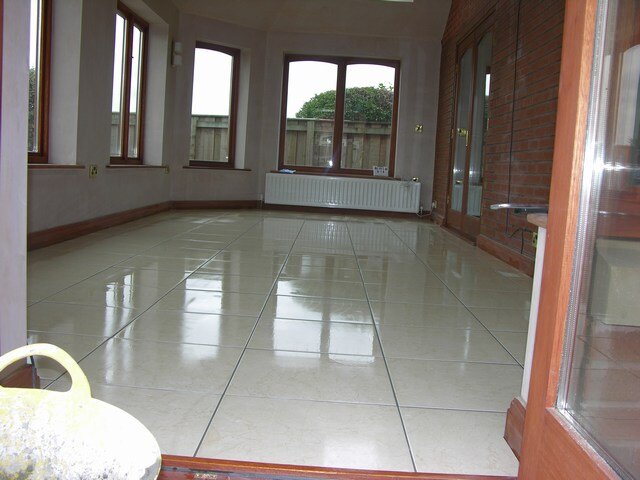

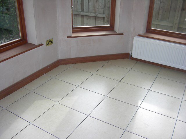

well jobs done, customer well made up must say so am i :wink_smile: bathroom wed :icon8: give me floors lol🙂 :wink_smile:
