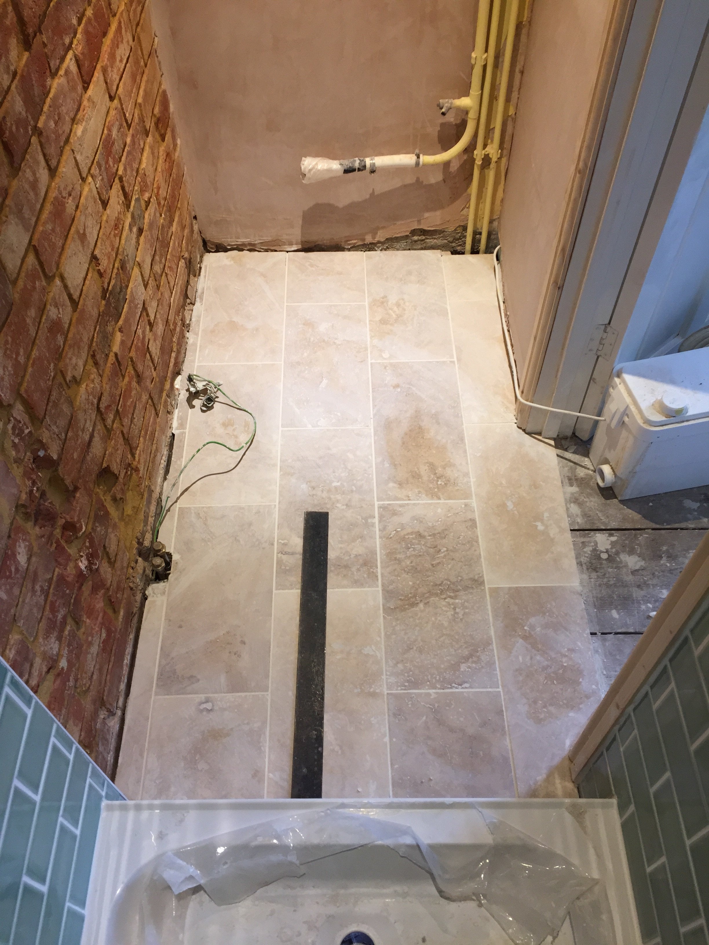

If he comes square off the back wall chances are the tiles will be short to the furthest point away on the door wall So something has to give.
I completely understand that you have to have some unequal cuts somewhere, but they should have been under the shower tray and in the back wall, both of which would have been hidden.
He initially set out his laser line along the brick wall showing equal cuts along the length of the wall. For some reason he then used the back wall as a base line which cause the tiles to be off.
The shower tray is square to the two longest walls. It's just the back wall (furthest wall in the photo that is slightly out.
If you were to have done the job yourself, and on the basis the two longest walls are absolutely parallel, wouldn't it seem logical to use these walls to set out rather than the back wall.
The tiler is a nice guy and if I'm being unreasonable then I may contribute to the rectification costs.
Another couple of photos to show the room appears perfectly square.
I'm sorry to say put putting down a square like that proves nothing.
it appears the tray has been installed square off the door wall. There is boxing on the opposite shower enclosure wall which I presume is to hide pipe work and make the opening the correct size for the tray. That is not to say that the long brick wall is square like you possibly think. Get a long stright edge say 2m and but that hard against the tiles on the boxing. does that brick wall run true?
To be honest what ever you do you are going to have something that doesn't line up. Once you place the toilet against that back wall, the pan is going to go at a funny angle.. unless of course you build boxing behind it and square the toilet with the shower... but hang on, you're then going to see the top of the boxing run out... and so on
I notice you don't have any waste for the basin. I assume you're going to run this along the wall and in to the macerator behind the toilet... is that waste going to be boxed in?
You're looking at it in it's worst possible state as the room clear. By the time the WC and basin are installed you're going to see much less of the floor and other items to confuse the eye and not see just how un-square the room is.
If you wanted everything to run true then the room should have been altered beforehand. You have chosen to use the brick wall as a feature and as such everything should have been engineered off that. Be it with dot and dabbing plaster board or building studwork... altering door frames etc if need be. However seeing as you are tight for space as it is I guess that wasn't an option.
I'm not saying what your tiler has done is what I would have done, as unless I was in the room figuring out just exactly what walls were out and which aren't then it's a hard for anybody to say if he went with the least offensive layout. How you've used the square doesn't show us much as it's been used incorrectly like I say.
The quality of tiling looks OK from the pictures... the Silicon job not so sadly.
The biggest mistake the tiler made was not to involve you in the set out......However that's not always possible.
The thing is that he did, showing equal length cuts along the brick wall which would be hidden by boxing. This would have allowed almost a full width tile in the door way.
For some reason he decided to do it differently by setting off from the wall opposite the shower tray. He admitted he could see them going off line but continued anyway, so there was little I could do.
With everything in the room there won't be much of the floor to be seen, so I'm tempted to just live with it although I just find it frustrating when you pay good money and aren't happy with the outcome.
Agree the Silicon in the wall tiles is not the best, but I will try and sort that myself as I have time and patience on my side!
Taking them up is just going to remove this visual "mistake" and create another, it is running visually square to the door wall and once you've filled the brick wall side up with your sanitry stuff it's not going to look out of square as much. Your room is definitely out of square without a doubt, I personally would have set out differently with it being square but everyone is different! I think it's a mistake pulling them up to move it around 30mm or so as this will make the doorway look out by quite a bit and that's going to be a bigger eye sore and look like a real mess up!
To your question though, your boards should be fine if you make the tiler take the tiles up.
Thanks - I think I may just try and live with it.
Out of interest, why would the door way look odd if they are re-laid? If they were to be re done, I.e. twisted to the right by 30mm, the tiles by the doorway would be narrower on the right, and probably unchanged on the left. This would mean they would then roughly equal sizes and in my mind, look normal. Or am I completely missing something?
Thanks again for everyone's help!
With everything said, if you knock the tiles round 30mm then the broken grout lines will then look out visually looking into the room. Which could be a bit more unsightly.
It's a tight space, as CR has said, once it's all fitted up you will not see any deviation.
It's rare that any room is 100% square and true. Personally I think your tiler has done a reasonable job.
Find a straight line in the door way and set your square down. If it runs true to the grout lines there, then there is no doubt your room is wonky donkey.
think i would live with it.How often do you have a shower facing the screen? If it was mine, i would like the grout line to look the best whilst A ...sat having a dump. but that wont happen as the wall your loo is going on is the one you say is not square. B ... The threshold, which looks ok from the pic,
