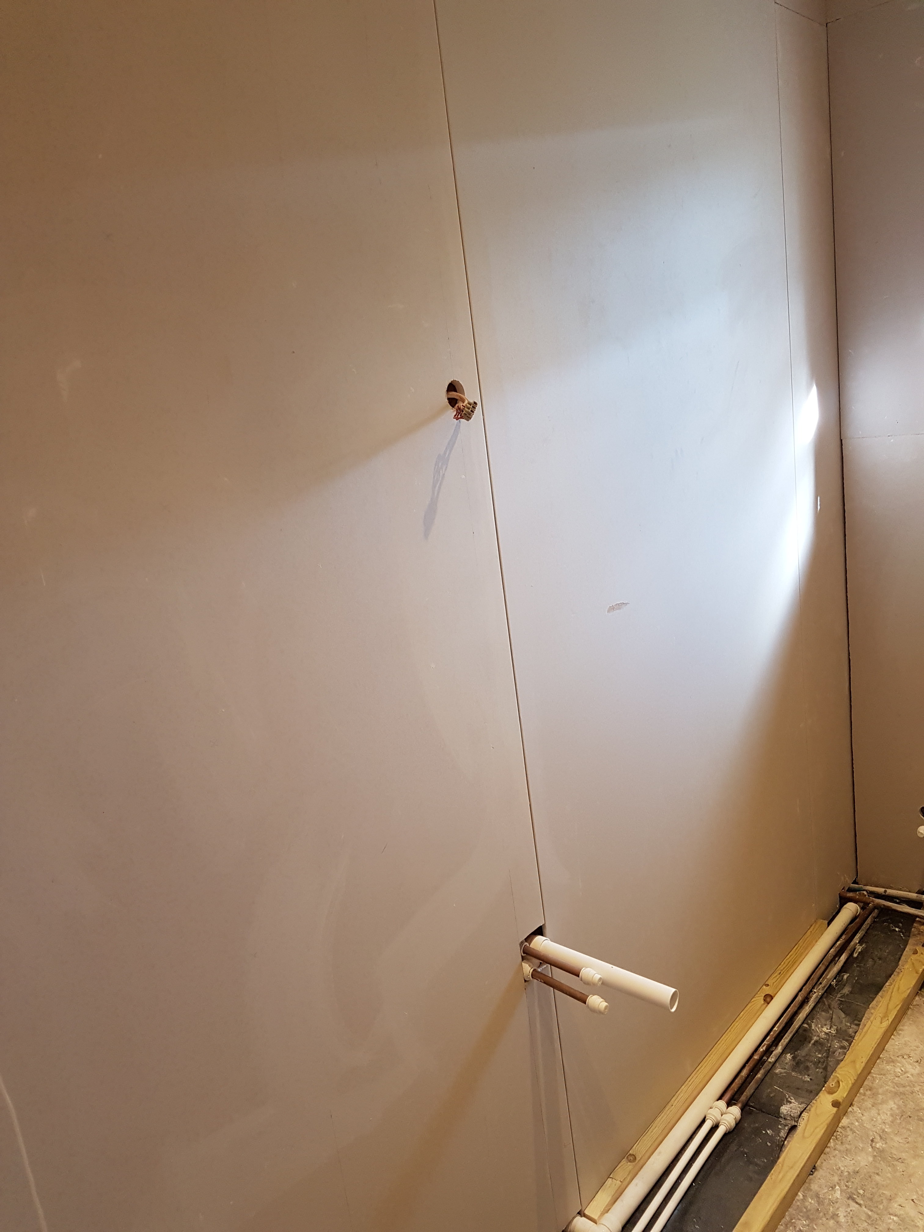

Boarding done. Went okay I think. Two bits of worry to me are in the pictures. Anything I can do about them? One I've messed up the corner and it's folding away. The other the paper just seems to be coming away from board, don't know why?
You have fitted the boards the wrong way around. The Ivory face should be visible. Some say it doesn't matter, but I've seen similar failures when this has been done in the past. Your boards look soaking wet too and at this time of the year it can take a while for it to all dry out depending how wet the drywall adhesive was and the humidity in the room.
Plasterboard sheets dot & dabbed correctly. However on the second sheet you can see one small wet patch where the paper face just 'shed' off the board when wiped.
I thought that, Mrs old man helped me and I said to him it says put other way round and he said one side for artex and other for plastering or some rubbish! Knew it should have gone on the other way round but how can I tell someone who should know that!!!
So the bubbles will go when adhesive dries?
