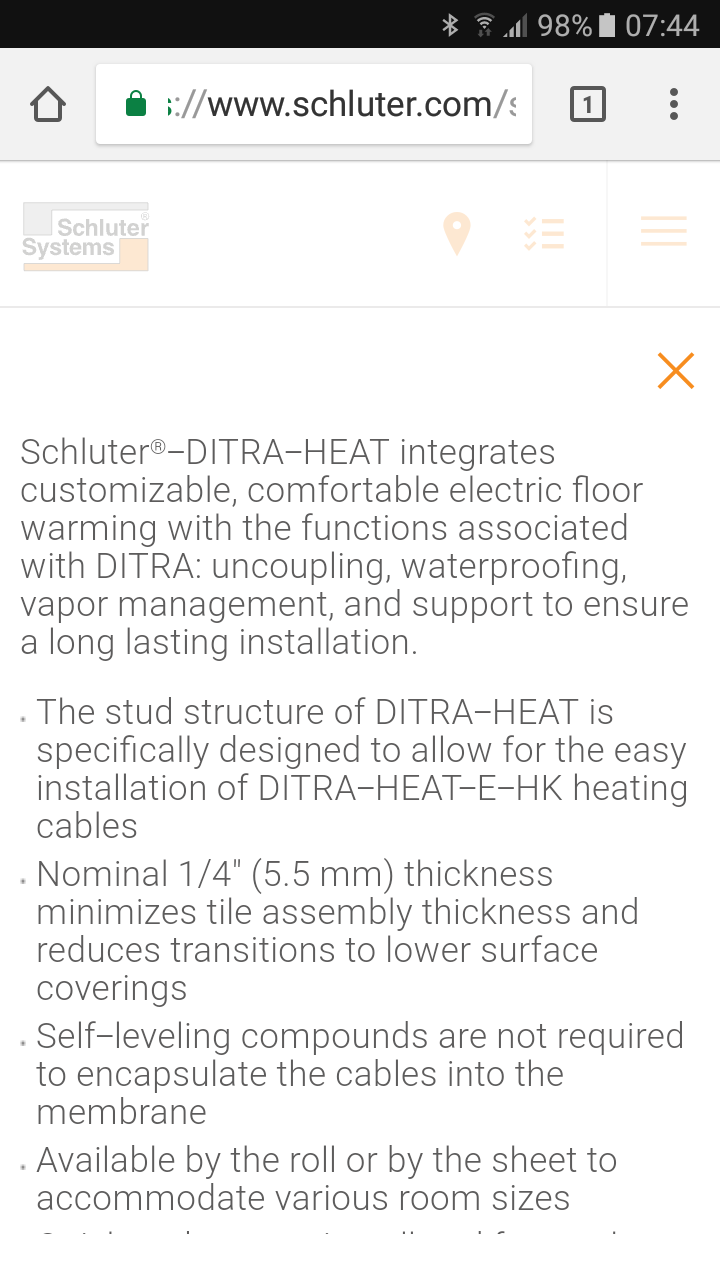

I wouldn't be so sure ditra heat is waterproof because I don't think you can use sealing band like ditra 25 the sheeting itself is but the joints won't be
Screenshot_20170407-074405.png Do they need to update their information or did they not cover that aspect on the course?
Please enclose a picture of how you waterproof ditra heat and which of the products you use I brought this up with them already
You only need to tape the joints for waterproofing,
and taping the joints for use on a green screed is not required unless a sensitive stone is being used.
