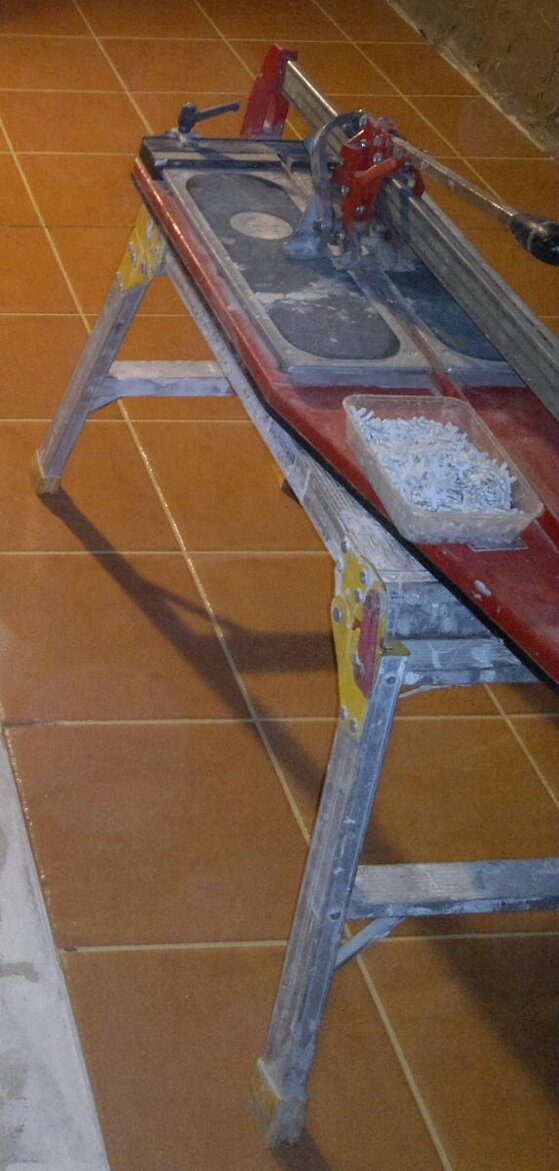

900mm all nice and shiny, will upload some pics of the 750mm thats seen a lot of action soon.

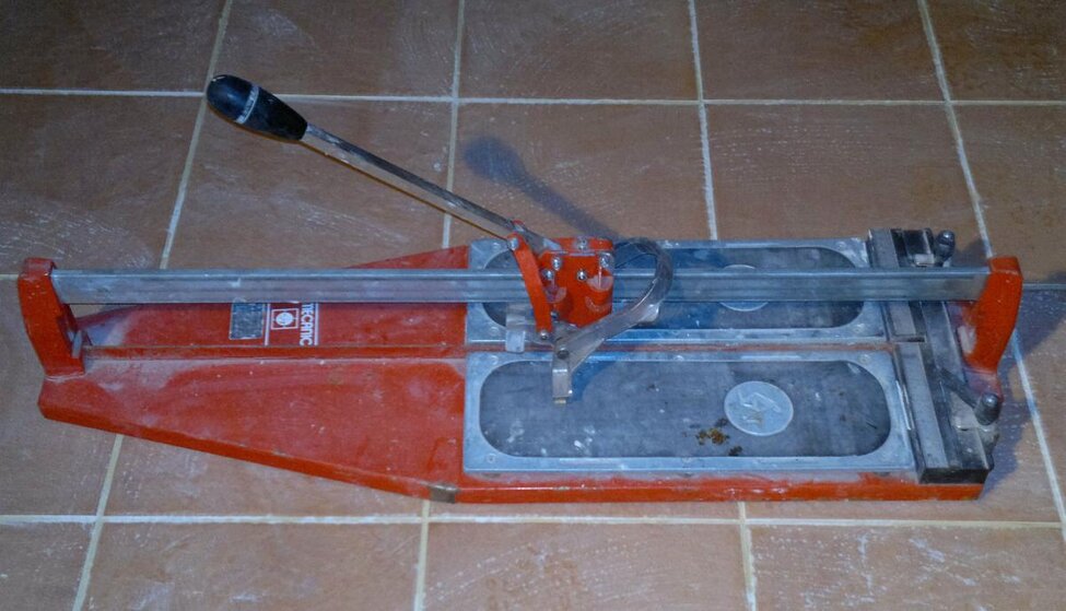

I have three old electric cutters from Tomecanic been great cutters over the years still use them more than my dewalt when using tiles

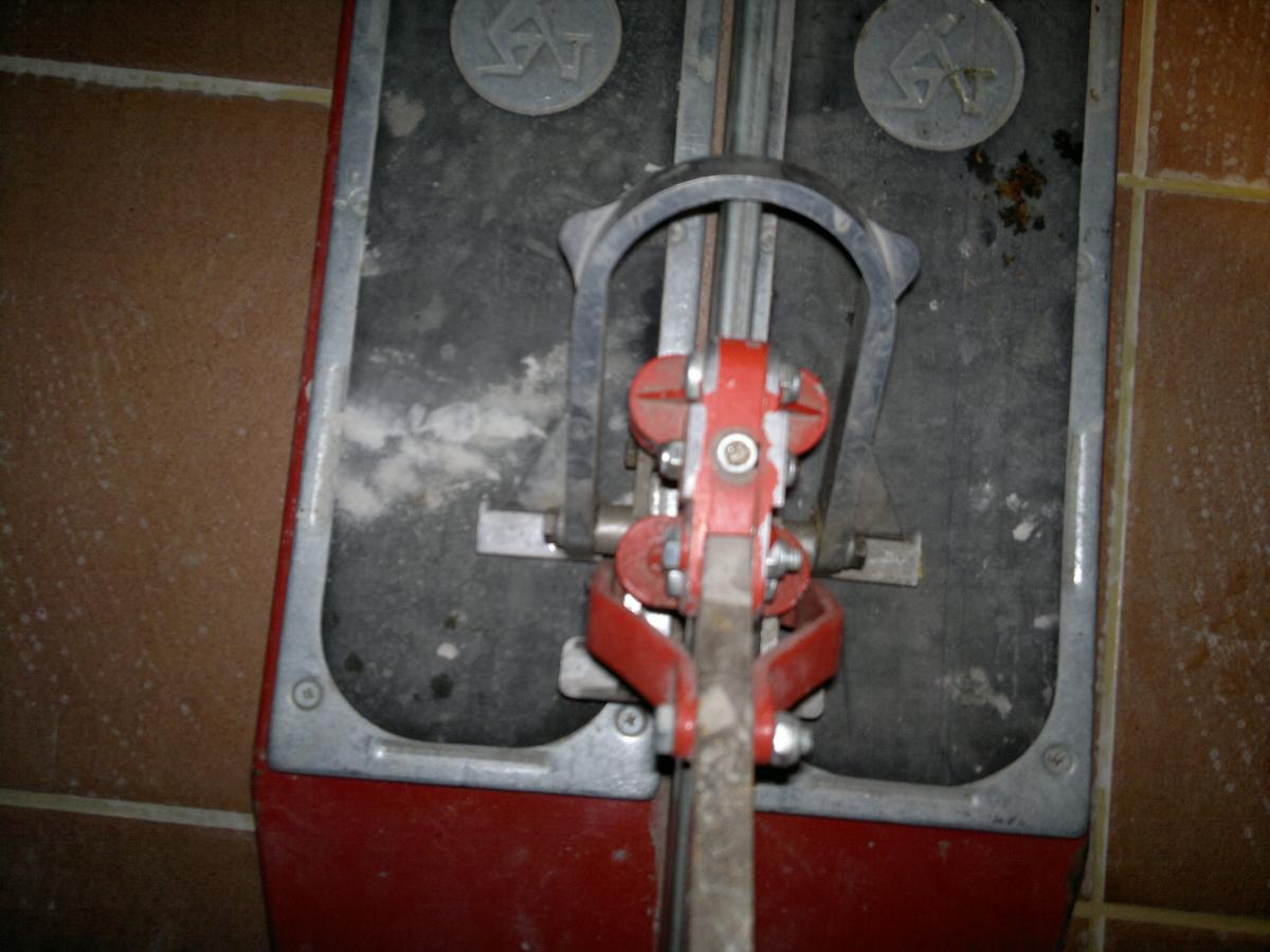

27092011472.jpg30092011477_1.jpgAbout a years worth of abuse.
Forgot to mention the wheels on these machines last an eternity.
