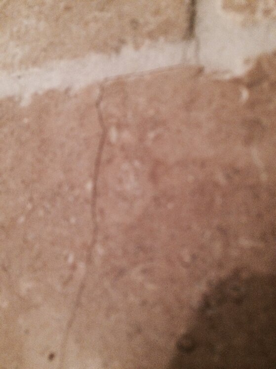

Hi, after some advise if possible! I laid a natural limestone floor in my house over piped underfloor heating. It's a pump screed that had been down for roughly a year and tested super dry on a moisture meter. It's a new system boiler system . So after a year I fitted the heating system turned it on and roughly over a week and a half took it through its paces before shutting it off and leaving to cool for 3 days. I then used keracol primer 2 coats. Before putting the limestone tiles down fully surrated to the floor using the h40 Eco ideal adhesive. I then used bal super flex grout. I left the heating of for 2 weeks after then turned it on at its lowest on both boiler and underfloor heating. I've had about 6 tiles completely crack! Has anybody had anything similar or may have an idea because this one has truly confused me! Never had an issue like this before! Any help would be appreciated!

Anthracite screed. No membrane used was told by the rep it wasn't needed. It's not in one area there just randomly broke mainly at the edges where there is a gap. I've lifted two there stuck well had to smash it to get it out there is a fracture in the screed under one but I don't understand why this didn't happen when I ran the heating up before.

when I originally ran the heating up I had 2 hairline cracks appear. One where the pipes are brought into the room and one where the sink pipes come out the floor but no others. The tile where the pipes come in had cracked but I can't understand how if it is the screed underneath why didn't it crack originally but when its tiled cracks within 24 hours of the heating back on at low burning

you might find when the floor was not tiled it defused the heat very quickly through the screed now tiled the heat needed to get through is higher .and the layer between the screed adhesive and tile is not vented but sealed with the tile so the screed is getting a lot hotter causing cracking
Looks like your going to have a bit of work to do to rectify your work!
From the photo and your info the screed had cracked in places so the signs were there and the correct substrate preparation should have been approved - using an uncoupling membrane. However the cracks may continue to develop so it may be ongoing.
