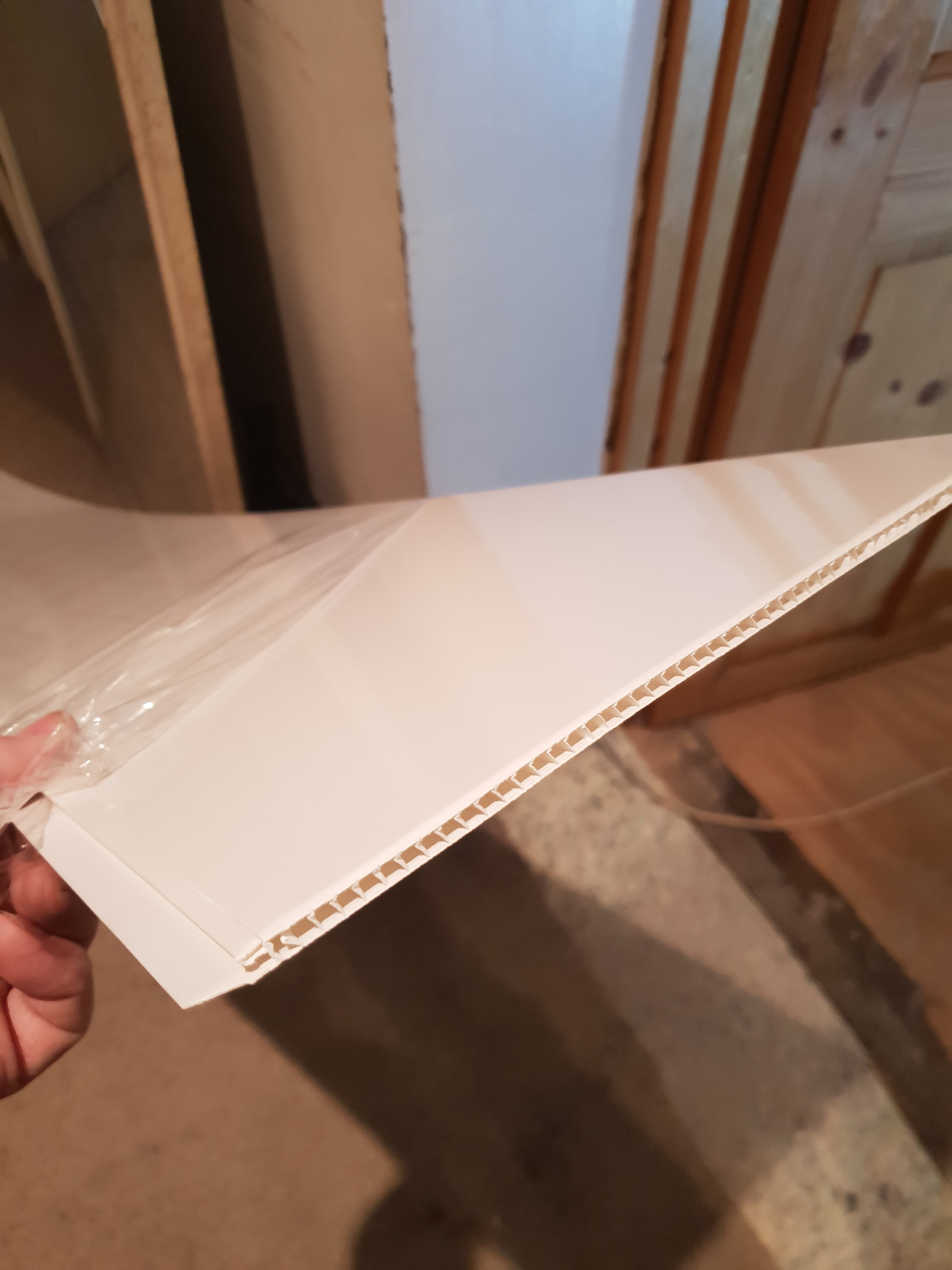

Sticking Pvc to tanking
Been on to mapei they said speak to pvc supplier.speak to pvc supplier and they said speak to mapei lol.

All I want too do is stick this on the ceiling that's it. Will only be 1200mm pieces.
