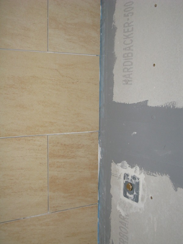

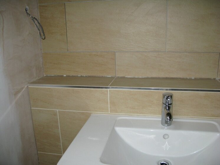

Hi Guys and Ladies,
I am cracking on with my first big job. I have tiled the main wall behind the bath and wonder if I should at this stage Silicon the corner prior to tiling the adjoining wall, the tiles are 10mm porc and I have the feeling that once I tile the other wall, the silicon will not find its way around the bend and into the corner. Similarly, should I silicon the join between the wall and the shelf prior to grouting? I am probably being anal, but want to get it right. Picture attached shows the corner I am referring to.
Thank you in anticipation.
Steve H

Siliconing the wall now is fine, the gap on your shelf looks a bit on the wide side, 3 mm is about right to get a nice clean Silicon line, if its too wide then the Silicon can look unsightly.
:thumbsup:
As said ,will not hurt doing some now,if you feel it would give you more confidence in the works,nothing worse than doing a job and having a niggling feeling about some part of it but I would do afterwards
