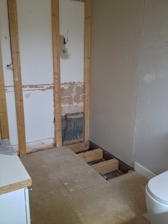

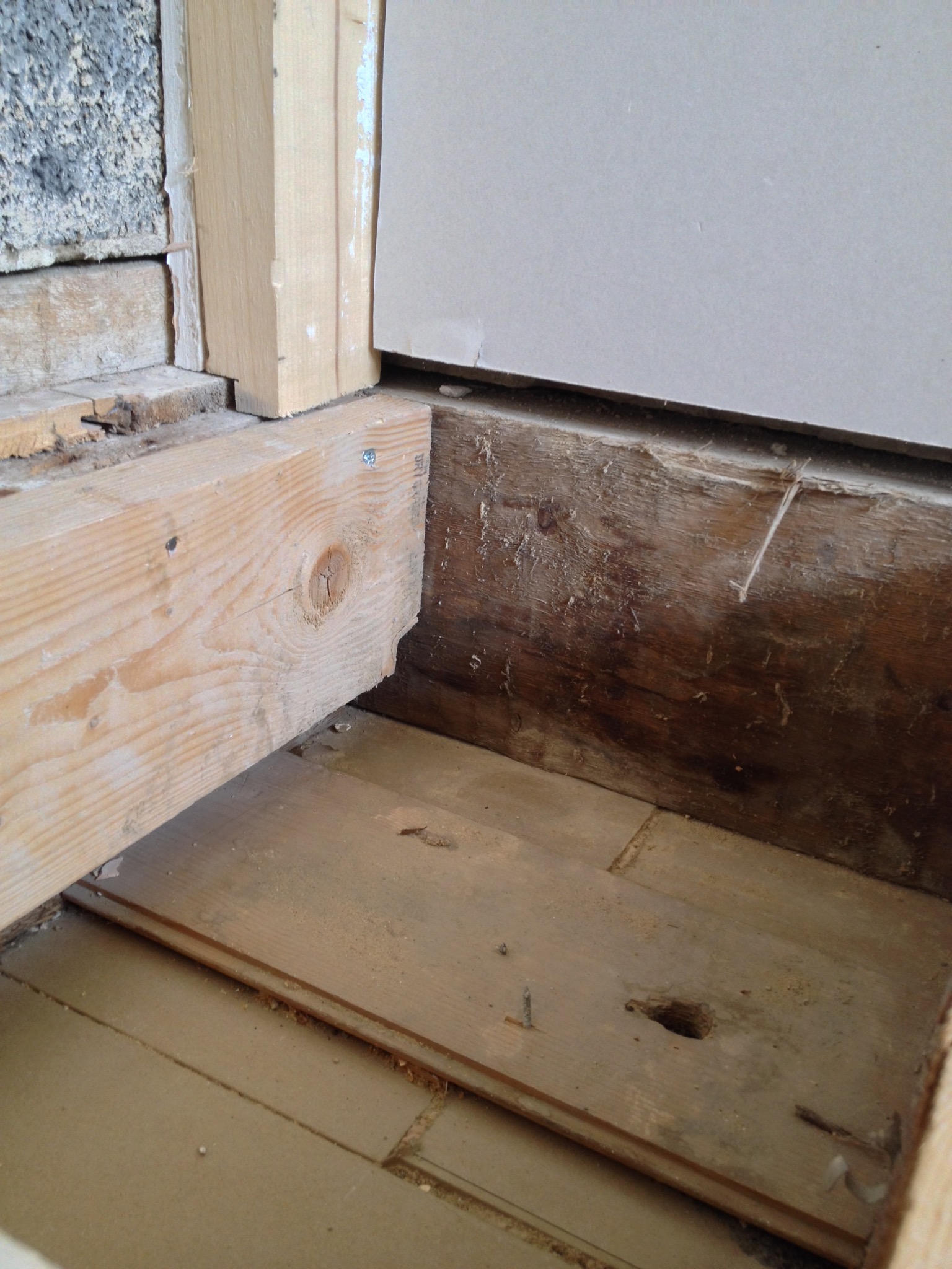

Just finishing off kitchen and will be looking at tackling this, it's been sat for a year now and the misses has had enough.
I want a tiled floor( not chosen yet)over hardi Backer board as floor at the moment is chipboard. Shower former of some sort to lay mosaic tiles 1200x1000 mm (save me cutting mitres to create slope) hopefully flush with the main tiles. Going to tank the whole area with probably Aqua seal tanking system.
A glass panel 2m high x 1200mm with some sort of led lighting strip run up edge.
Shower I'm looking at is hp/ combi digital exposed, Mira or aqualisa.
Not finished walls off yet on two sides, one is plaster board and other is just a few studs up at moment.
Some pics
Any help would be much appreciated
Regards. Scezy

I would just like to take it a step at a time. Prepping floor(what to put on top of chipboard, what height will this take me to. Which shower tray former would be best at that size and for mosaic tiles as they would be easier for me to fit.
Supporting former and getting it right height to match other bathroom tiling.
Also best thing to finish stud wall off.
This should keep me going for a while, I'll also look at using maps I tanking kit,think I've got a £5 voucher for there.

PCS delta boards on walls and floor, delta wet room former, available in many styles and sizes and can be cut down. Then once you have fitted all that, seal all joints and fixings with your chosen tanking tape / paste. That would be my choice. Assuming your tiling the lot ?
